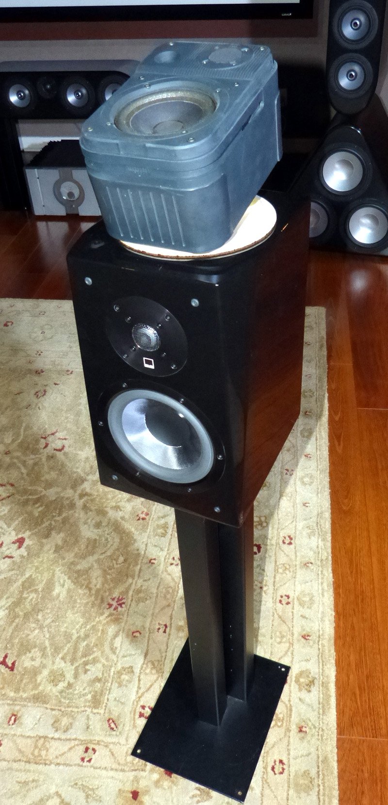

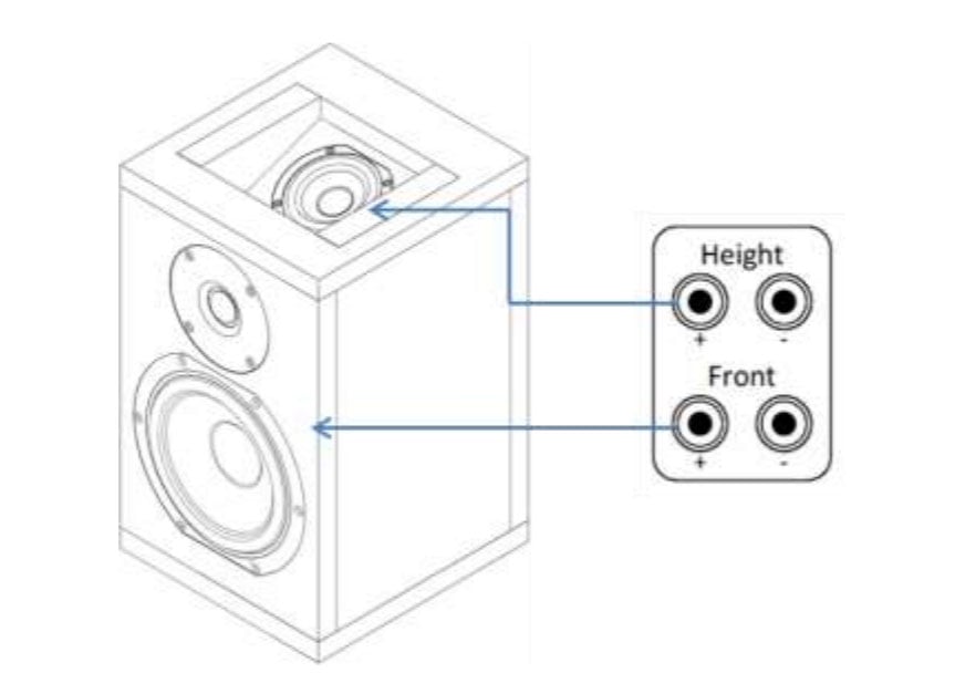

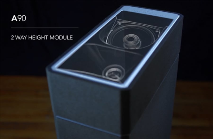

Atmos-enabled speakers (aka. Bouncy house speakers) are ALWAYS a compromise to discrete speakers properly placed on the ceiling. However, if mounting ceiling speakers is NOT an option, then, by all means, you should try the bounce approach if you want to still take advantage of the Atmos height channels. You can experiment (as illustrated here) with a pair of small bookshelf speakers  lying around by placing them on top of your front speakers titled at about 20 deg as depicted in the Dolby diagrams. Make sure to apply bass management at 200Hz to Atmos height speakers to help reduce localization. Check the owners manual for your AV receiver as this is often automatically done when you select Atmos-enabled speakers. If you like the results, then consider getting the companion Atmos modules to your front/rear speakers for a better match tonally and aesthetically. Companies like Definitive Technology, KEF and Klipsch have come a long way with their 2nd generation Atmos-enabled speakers in utilizing similar driver topologies to their companion speaker compared to the first generation 3" paper whizzer cone woofer some manufacturers originally licensed from Dolby.
