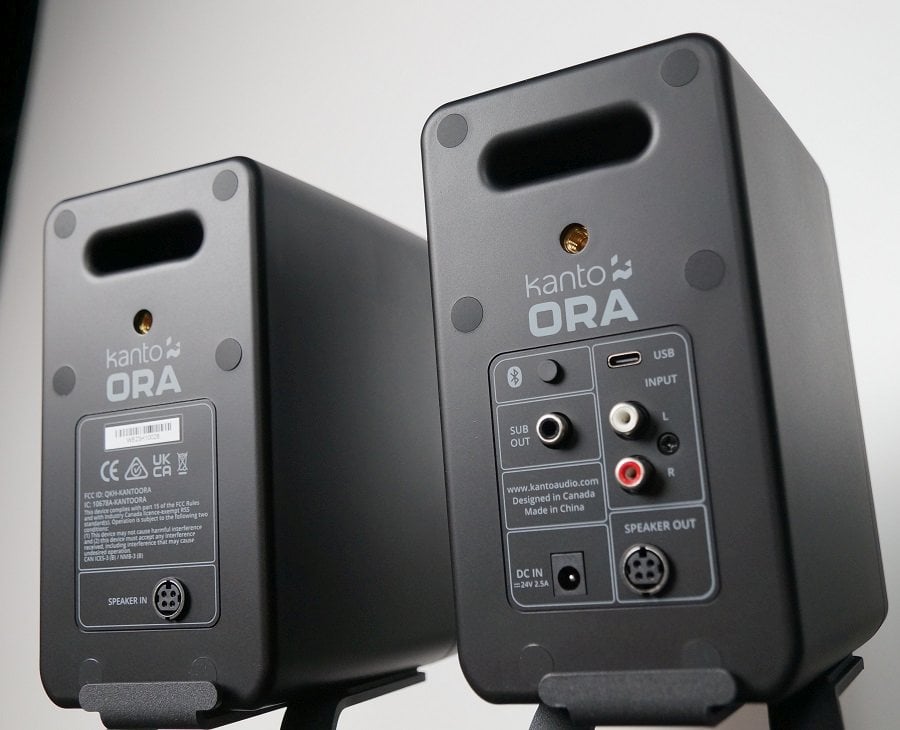

- Wired Connectivity: Stereo RCA, USB-C, single RCA output (Subwoofer)
- Wireless Connectivity: Bluetooth 5.0

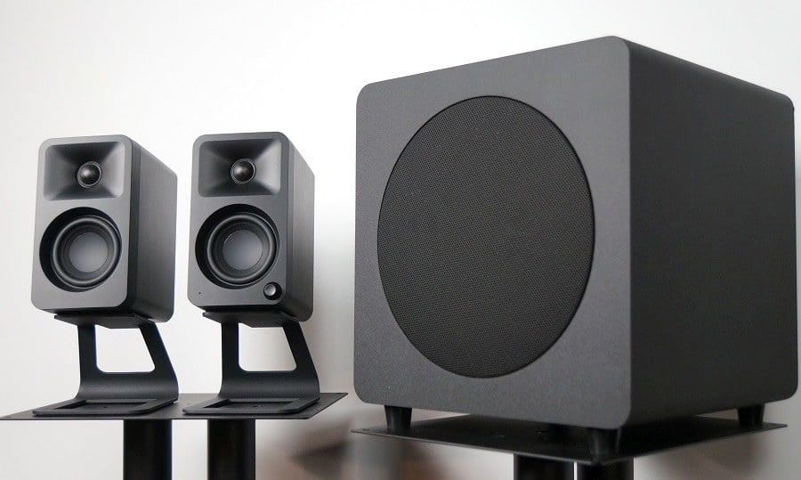

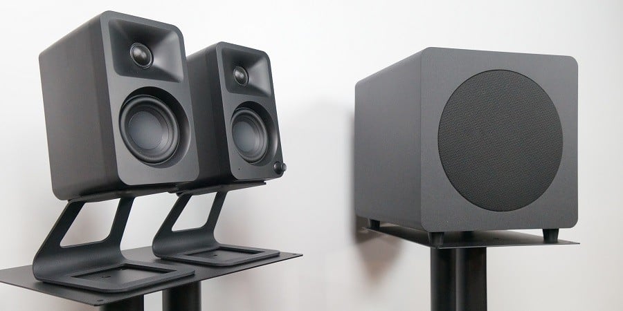

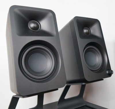

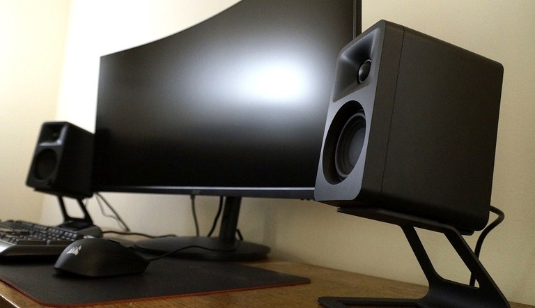

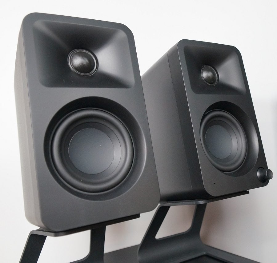

Kanto ORA Desktop Speakers & sub8 Subwoofer Appearance
The ORA speakers look pretty typical for desktop speakers. They don’t look like luxury items, but they don’t look at all bad either. They are just small black boxes that have a satiny sheen. The housing is just plastic, but it is tastefully designed. There are no grilles to hide the drivers, but the speakers have such a uniform color and texture that shouldn’t be a problem for people who want a minimal appearance. The tweeter dome and woofer cone have the same satin black as the rest of the enclosure, and there are no visible screws that complicate their aesthetic at all. Kanto also sent some speaker stands that are optional purchases. They do look as clean as the speakers and compliment them nicely.
The sub8 is also small and unremarkable in appearance, and that is what most people will want. I imagine most people will place it under their desks, so its appearance will matter much less. It uses the textured vinyl wrap of many other budget speakers. The cone is hidden by a thick perforated metal grille that is not removable. Overall, the styling of these speakers and sub is fine and will certainly not deter any would-be buyers.

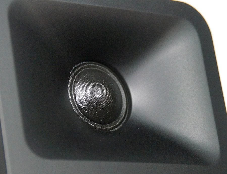

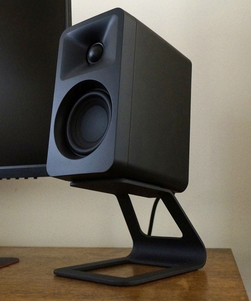

Let’s begin our dive into the design with the tweeter. The ORAs use a ¾” silk
dome tweeter mounted in a shallow waveguide. Silk domes can be a very good
diaphragm material, and the smaller diameter will allow it to play up to higher
frequencies than typical 1” or larger tweeters. Good silk dome tweeters are not
hard to come by, so a lot of the effectiveness of this tweeter will come down
to the geometry of the waveguide. A good waveguide can create an even sound
over a wide listening area, but optimizing waveguide shapes is not an easy
task. If Kanto executed the design correctly, the width of the tweeter’s sound
dispersion will have a good match to the woofer at the crossover point, and the
waveguide will hold a steady dispersion out to the top of audible frequency
bands.

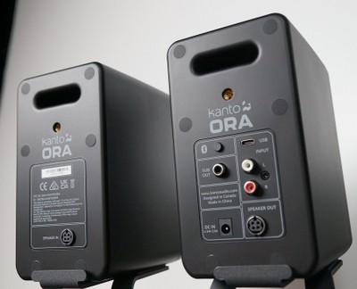

Connectivity is OK. Left and right RCAs comprise the analog inputs, and USB Audio comprises the digital input for the wired domain. USB audio uses a USB-C input, but Kanto does not supply a USB-C cable. It would have been nice if the ORAs came with a USB-C cable along with a USB-A adapter, but oh well. The ORAs can also connect wirelessly with Bluetooth 5.0. Aside from the wireless connectivity, this is almost the bare minimum wired connectivity needed for a system like this. Optical S/PDIF would have been a nice addition here, but the connectivity options should suit the majority of systems of those people shopping for desktop speakers. The ORAs also have a subwoofer output. When the subwoofer output is connected, the ORAs will automatically high-pass everything above 100Hz with a 24dB/octave filter, and send the filtered signal to the subwoofer. That is a great idea for a loudspeaker with a 3” woofer, and it should greatly increase the dynamic range of the system when the ORAs are relieved of low-bass duty. Users should be sure that whatever subwoofer they connect to the ORAs has an upper-frequency response that can extend to 100Hz; not every sub can do that.

enclosure is made from plastic. The external panels do not feel very thick, but
there does seem to be an internal structure within them. There are no feet for

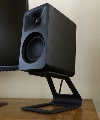

the cabinet. Kanto has some pretty good optional desktop speaker stands with
rubber matt pads that the ORAs can rest on (The S2 and SE2). One speaker of the pair

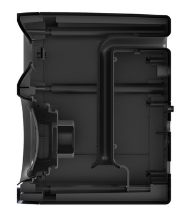

The ORAs are ported speakers, and they have a dual-flared rear-mounted slot port that takes a 90-degree bend within the enclosure.
The front panel control consists of a single knob. Pressing and holding the knob turns it on or off, and a front-mounted LED indicates the power state as well as the input that the ORAs are using at the moment. Pressing without holding changes the inputs with green indicating RCA inputs, yellow indicating USB audio input, and blue indicating Bluetooth input. Rotating the knob changes the volume, of course.

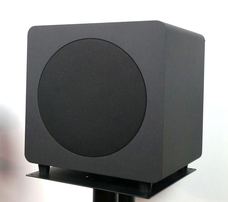

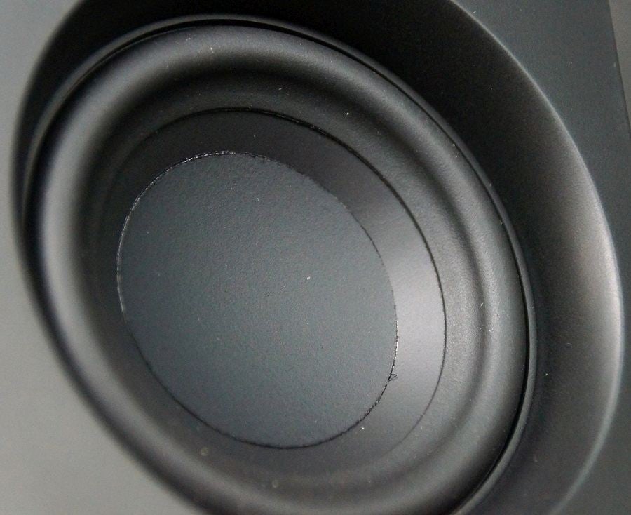

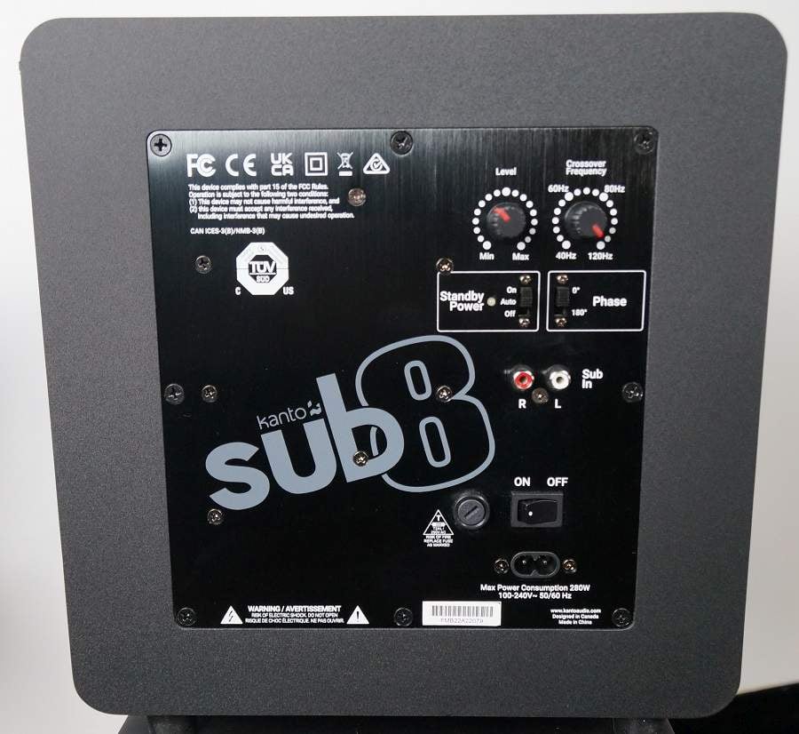

Moving on to the Kanto sub8 subwoofer, it is a simple design that prioritizes small size. As such, it opts for a sealed enclosure. That might deprive it of some deeper bass output, but serious deep bass power was never really in the cards for such a small subwoofer anyway, so that was a smart call. It uses an 8” paper cone woofer powered by a 150-watt RMS class-D amplifier. Its connectivity is comprised of left and right RCA inputs. For controls, it has an on/off/auto switch, a volume knob, and a low-pass filter knob that ranges from 40Hz to 160Hz. If used with the ORA speakers, users should set the high-pass filter to 160Hz.
The enclosure is an approximately 11” cube that uses ½” MDF panels. The lengthwise edges are rounded. It uses a durable textured vinyl finish that we see on many other low-cost speakers. It’s not a bad finish, and it doesn’t leave fingerprints. The woofer cone is wisely covered with a non-removable metal perforated metal grille that really protects the driver. This is smart because this sub is very likely going to end up under users’ desks where feet will be swinging around. The fragile cone is well-protected against accidental strikes on the grille. The cone is also protected against curious children and pets. The feet are some rubber cones that give the sub a 1” clearance.
Internally, the driver is sectioned off from the amp by a panel that makes the sealed cavity even smaller than it looks. This is strange, but it may be that the smaller volumetric area is more optimal for this driver. Usually, bass drivers are starved for space for optimal operation, and DSP must be used to iron out their response because of the small space.

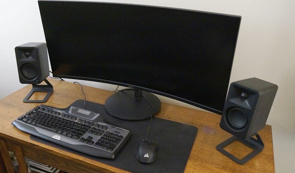

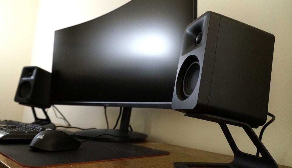

Most of my listening with the Kanto ORA speakers and sub8 subwoofer was done in an office room with the speakers placed about three feet in front of me on an office desktop. I used the Kanto SE2 desktop speaker stands to angle the speakers to face my listening position. A desktop environment is not the ideal space for speakers, but it is an intended environment for the ORAs that many users will place them in (those who want to get the best sound out of a desktop environment should refer to our article: Audioholics Guide to Getting Good Sound Out of a Desktop Sound System). I decided to evaluate the ORAs in the conditions that they will probably be used in by most owners. The ORAs are intended to be placed near a back wall (Kanto recommends 20-25cm or approximately 8-10 inches of distance from the back wall) to properly load port output but not so close as to over-boost the bass. No equalization was used. The sub8 was placed on the floor to the side of the desk.

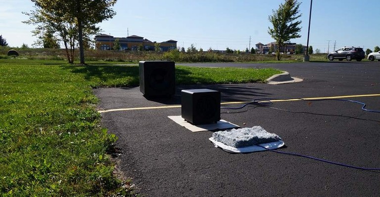

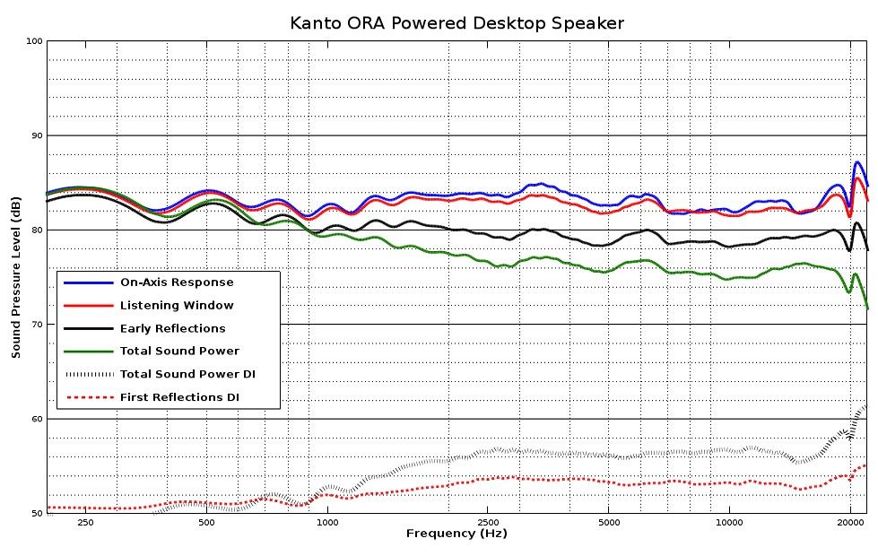

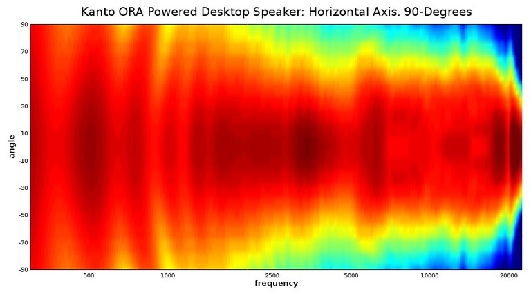

The Kanto ORA desktop speakers were measured in free air at a height of 4 feet at a 1/2-meter distance from the microphone, and the measurements were gated at a 5-millisecond delay. In this time window, some resolution is lost below 500Hz and accuracy is completely lost below 250Hz. Measurements have been smoothed at a 1/24 octave resolution.
The above graph shows the direct-axis frequency response and other curves that describe the Kanto ORA’s amplitude response in a number of ways. For more information about the meaning of these curves, please refer to our article Understanding Loudspeaker Measurements Part 1. The measured response shown here is very good. The on-axis response and the listening window adhere to a +/-2dB window out to 20kHz. Mid to upper treble seems to hang back around 2dB from the midrange and lower treble, and that might give these speakers a very slightly relaxed presentation from total neutrality. This response is so flat that room acoustics and listening position are going to make a larger difference on the tonal balance than the response of the speaker itself. The directivity indexes are extremely good, and the ORAs have a very uniform response at most angles. Automated room correction software loves directivity indexes like these, so programs like Dirac Live could really take the tonal balance to the next level on the ORAs. The response is so even on all of these curves, we can’t even tell where the crossover frequency might be. This graph tells us that the ORAs are very tonally balanced and accurate loudspeakers, MUCH better than typical desktop speakers.

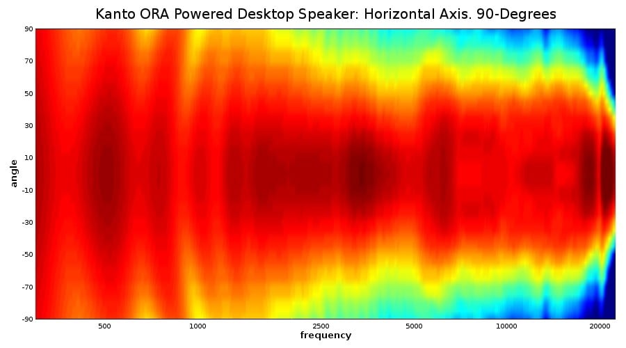

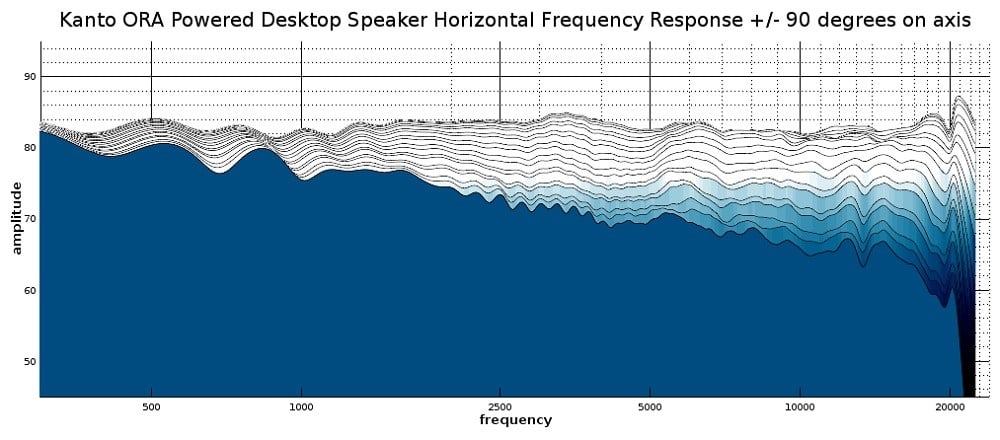

The above graphs depict the speaker’s lateral responses out to 90 degrees in five-degree increments. More information about how to interpret these graphs can be read in this article: Understanding Loudspeaker Review Measurements Part II. Here we get a more detailed look at the exemplary horizontal response of the Kanto ORAs. As would be expected of such small loudspeakers, these have a fairly wide dispersion. They cover a wide angle with a very flat and tonally neutral response. One interesting characteristic to note is that even though the tweeter is set in a shallow waveguide, it does not start to disproportionately narrow in dispersion in upper treble as we see so often. This tells us that the waveguide is doing its job throughout the entirety of the tweeter’s bandwidth. It beautifully matches the directivity of the woofer while keeping the tweeter from collapsing its dispersion at the top. This waveguide is the result of some top-notch engineering.
The above polar map graphs show the same information that the preceding graphs do but depict it in a way that can offer new insight regarding these speakers’ behavior. Instead of using individual raised lines to illustrate amplitude, these polar maps use color to portray amplitude, and this allows the use of a purely angle/frequency axis perspective. The advantage of these graphs is they can let us see broader trends in the speaker’s behavior more easily. For more information about the meaning of these graphs, we again refer the reader to Understanding Loudspeaker Review Measurements Part II.
Here we get a good look at how well-controlled the ORA’s dispersion is. The tweeter’s beamwidth seems to hover around a pretty consistent 50 degrees. The woofer wants to spray acoustic energy out at a wider angle and is essentially omnidirectional below 1kHz. This is what we would expect of a 3” woofer. Again, it is impossible to tell what the crossover frequency between the woofer and tweeter is from this graph, and that is evidence is smart engineering.

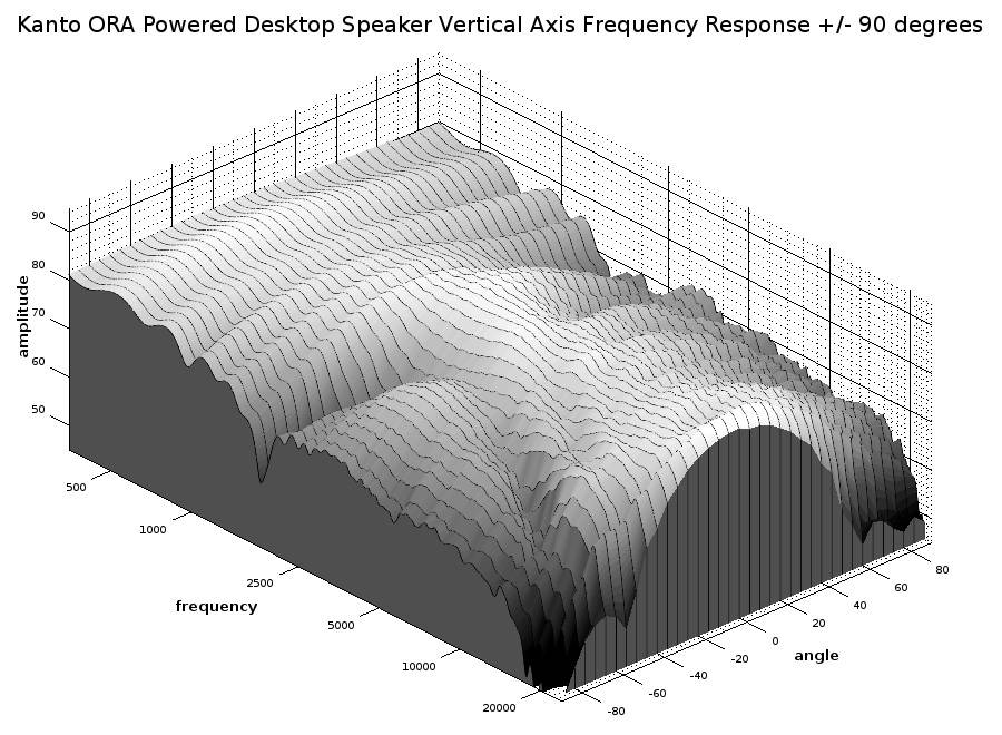

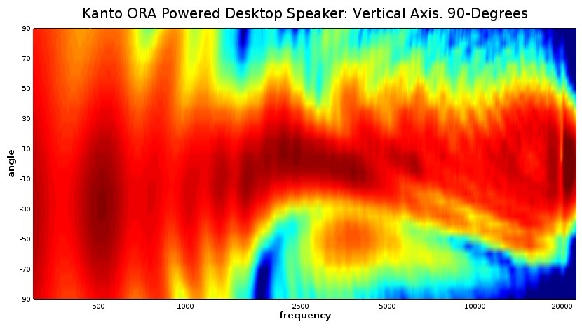

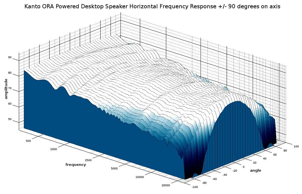

The above waterfall graph polar map shows the ORA’s response behavior along its vertical axis where zero degrees is directly in front of the tweeter, negative degree values are below the tweeter, and positive degree values are above the tweeter. Here we get a look at the nature of the ORA’s crossover. It is an unusual one. It looks like there is a low-order low-pass filter on the woofer, so its effects carry on into treble and quite high frequencies. The tweeter would have a much higher-order filter, at least in some range, if only to protect the tweeter. I wouldn’t be surprised if it had changing order slopes within the filter since DSP makes such sophisticated filter types possible and easy to implement. The crossover frequency looks to be around 2.5kHz. The vertical dispersion seems to be relatively wide, so this is not a loudspeaker that you have to absolutely listen dead at tweeter height for the best response. It keeps a good response from about -15 degrees below the tweeter to +20 degrees above the tweeter. One design aspect that makes this wide vertical range possible is the distance between the tweeter and woofer is very short, so phase cancellation around the crossover frequency is mild.

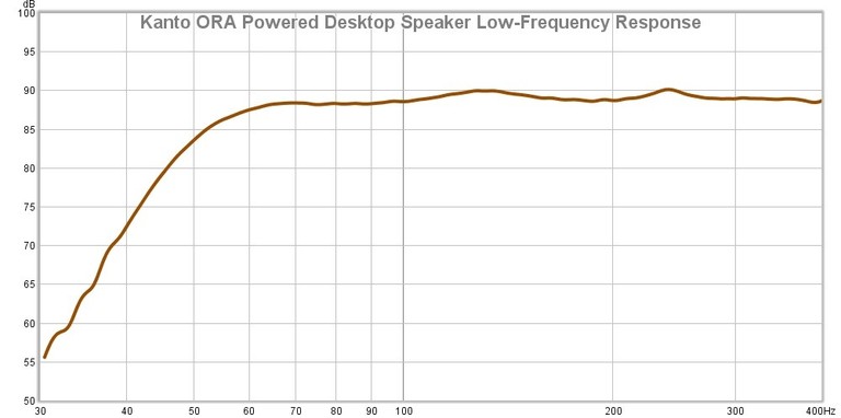

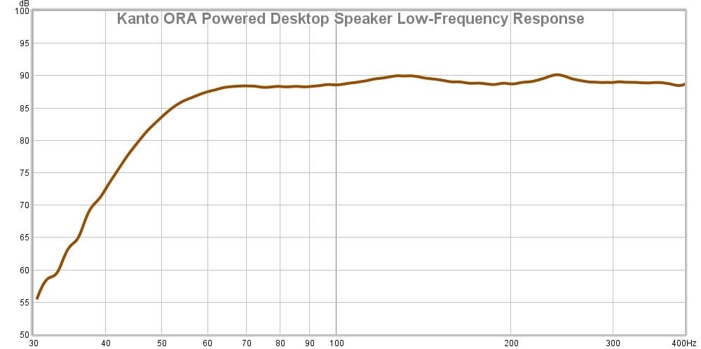

The above graphs show the Kanto ORA’s low-frequency responses that I captured using groundplane measurements (where the speaker and microphone are on the ground in a wide-open area). As with upper-frequency ranges, this is terrifically neutral. This confirms my surprised finding in listening that the ORAs have a solid response down to 50Hz: an astonishing response considering these have a 3” woofer. Of course, they do not have much headroom at 50Hz, and I would still recommend a subwoofer, but if a sub cannot be accommodated and loud listening isn’t needed, these will actually have some reasonable bass.

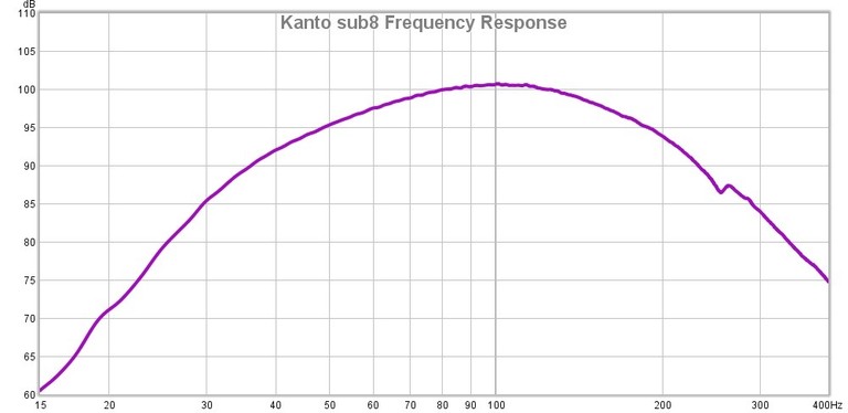

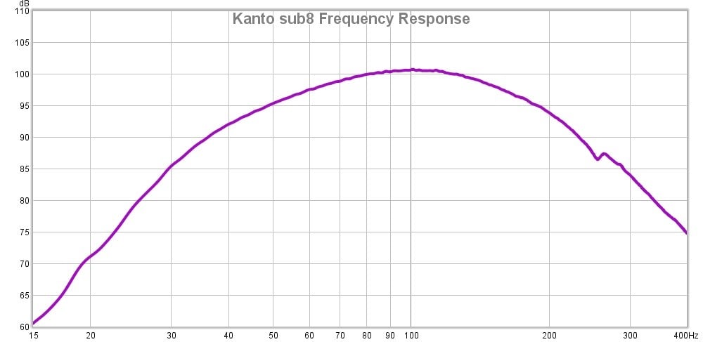

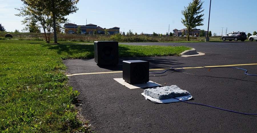

Testing on the sub8 was conducted with the microphone facing the woofer at a 1/2-meter distance with measurements scaled back to a 2-meter distance by subtracting 12dB. The temperature was recorded at 75F degrees with 85% humidity. The subwoofer’s gain was set to maximum, phase was set to zero, and the low pass filters were set to maximum.
The above graph shows the measured frequency responses for the Kanto sub8 subwoofer. Kanto didn’t try to smooth out the response much with equalization, but that is OK since room acoustics will ruin it all anyway, especially when you consider that this sub will likely end up in smaller rooms which is especially devastating on the linearity in low frequencies. What we see is a pretty typical sealed enclosure response with perhaps some slight filtering on the low end in order to protect the woofer. In my office, not a large room at 11’ x 12’, I had strong bass down to 40Hz and usable bass down to 30Hz. That is decent for a small, sealed 8” subwoofer.

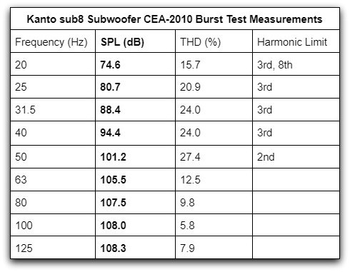

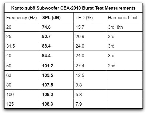

The above CEA-2010 measurements are short-term bursts that show the subwoofer’s clean peak SPL before heavy distortion sets in. Our measurements have been referenced to 2-meter RMS, which is 9dB down from the standard requirement for the measurements to be shown at 1-meter peak. However most publicly available CEA-2010 measurements are shown at 2-meter RMS, so we followed that convention.
The numbers posted by the sub8 aren’t
gargantuan, but they are respectable for a small sub for a desktop application.
It should be remembered that users are not likely to be seated more than a
meter from this sub in practice, so it will normally be used in the near field.
Using a sub in close proximity does a lot to boost its output at the listening
position. This is also the smallest subwoofer I have measured by far. Users who
want bigger output will need to make room for a much larger sub. The similarly
priced Dayton Audio SUB-1500 can produce a lot more output, but it is over five times larger in
size. Besides that, as a complement to the ORAs, as I said before, the sub8
seems to be a good match for their dynamic range. So yes, you could get a more
powerful sub, but its output would be disproportionate relative to the ORAs (I
suppose that is not a bad thing if you like really hot bass). A sub8/ORA system
is a good match. This burst test data gives the Kanto sub8 an Audioholics’
Bassaholic ‘Small’ Room Rating, meaning it should be able to handle a room of
1,500 cubic feet or less. For information on how the room ratings are
determined, please read our article “Bassaholic
Subwoofer Room Size Rating Protocol”.

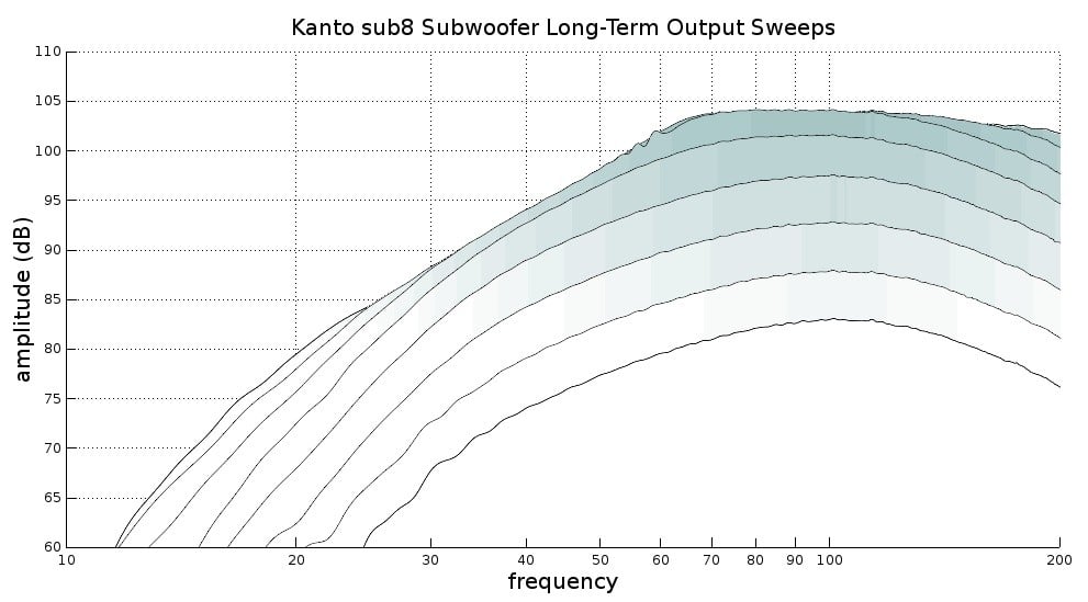

Testing for long-term output compression was done by first conducting a 20-second sweep tone where 50Hz hit 90 dB with the subwoofer 1/2 meter from the microphone (graph has been scaled to 2 meters for easy comparison with our other review measurements). We then conduct further 20-second sweeps by raising the gain by 5dB until no more output could be wrung out of the subwoofer. These tests show us the long-term continuous headroom that the subwoofer is capable of.
The sub8 exhibits a surprising amount of mid-bass in these tests and can sustain nearly 105dB at 60Hz and above. Using the sub8 with the ORAs takes a big load off of their back, and I noted a qualitative change in sound at almost all volume levels when the speakers were high-pass filtered and the sub was included. At the highest levels, compression does alter the response shape a bit, but harmonic distortion would be a much more audible artifact of pushing the sub that hard. We can see that the sub8 reverts back to a more traditional 12dB/octave roll-off as it begins to override its filters at high drive levels.

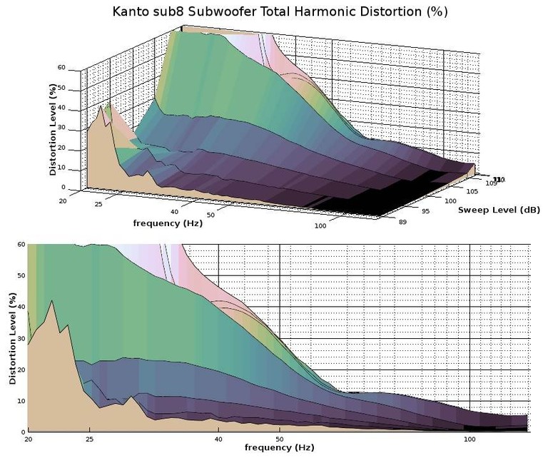

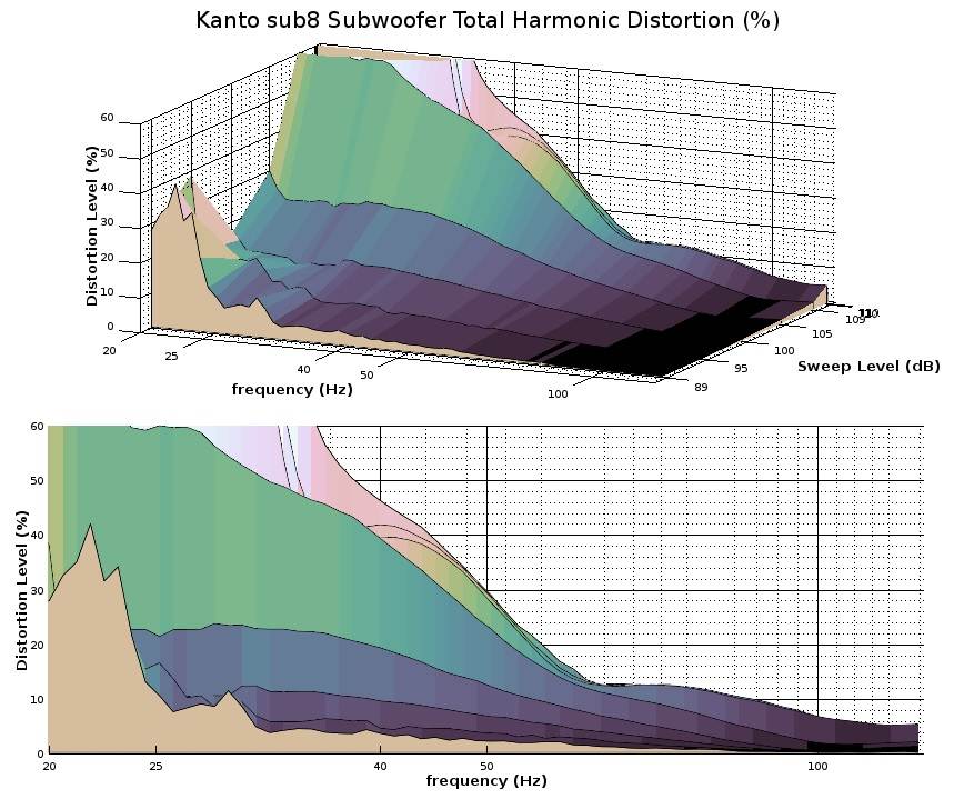

The above graphs show the corresponding total harmonic distortion to the long-term output graphs. Essentially, they depict how linear the subwoofer remains for the corresponding drive level seen in the long-term sweeps. The quantity being measured is how much of the subwoofer’s output is distortion and is shown here as a percentage.
While we can see the sub grows rather uncomfortable at high drive levels, we can also see that at nominal drive levels, it is pretty well-behaved, hovering below 10% THD down to 25Hz. In this graph, it looks like distortion increases in the low-end in the lower levels sweeps, but what is happening is that the noise floor of the testing environment is relatively high compared to the output of the sub at deep frequencies, so much of what is being reported as distortion at the 89dB and 95dB sweeps around 20Hz is just background noise. At higher drive levels, distortion from the sub starts to take off just above 60Hz, which is a relatively high frequency for that to occur, at least for the subs that we normally review. The demands of deeper bass on a sealed system dramatically increase to sustain the same output. Excursion needs to quadruple to hold the same SPL for every lower octave in a sealed system, and the sub8 isn’t using a tremendously high excursion driver, so what we are witnessing in this graph is the uphill struggle against physics. This all being said, in my normal use of the sub8 with the ORAs, I didn’t notice any significant audible distortion.

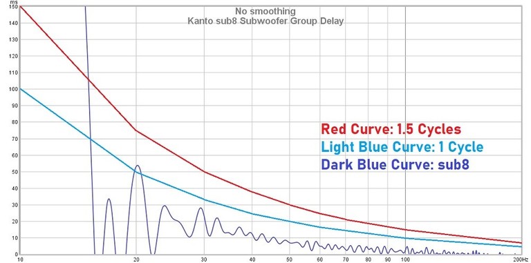

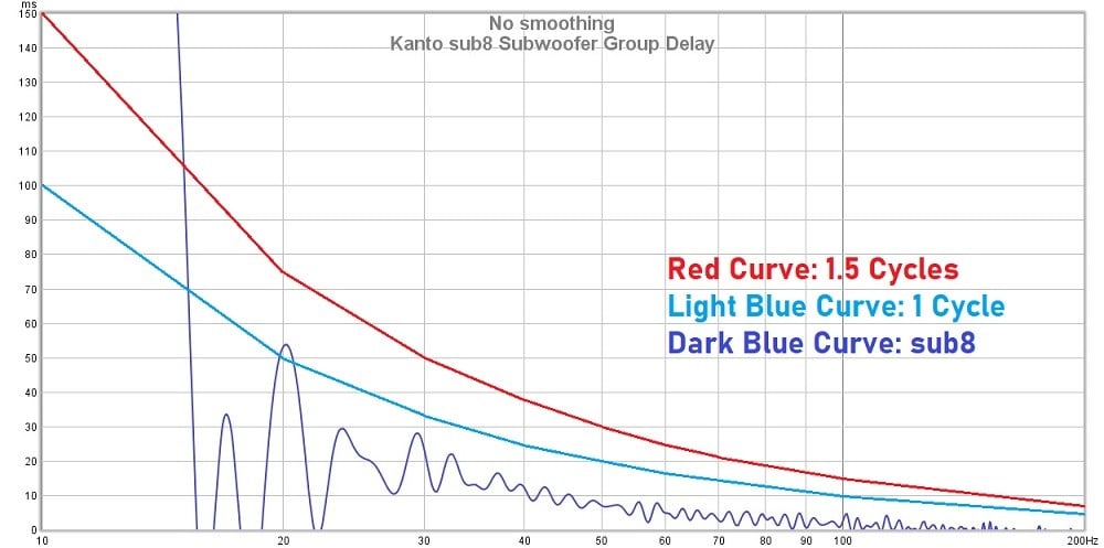

Group delay is the measurement of how much time it takes for individual frequency bands of an input signal to be produced by the speaker. It can indicate that some frequency components are developing slower than others or are taking longer to decay. It is generally thought that 1.5 sound cycles are needed for group delay to be audible at bass frequencies, although there is an argument that group delay should remain under 20ms to be completely unnoticeable, but that is likely meant for mid and upper bass frequencies.
The group delay exhibited by the sub8 is quite good. It stays below our worst-case scenario of 20ms down below 40Hz. Below that range, it is just too deep to matter, especially when we consider how rapidly output drops below that range. This is the opposite time-domain behavior that we see from typical desktop audio system subwoofers, which have very high port tuning frequencies that bring lots of delay into relevant frequency bands. It is even worse with bandpass systems that have gross amounts of latency well into mid-bass regions. The sub8’s group delay would make many higher-end home theater subwoofers jealous. With good placement, the sub8 can sound very sharp.

I found the Kanto ORAs and sub8 to be a great fit for my situation since I had an ultrawide monitor with a 34” width that didn’t leave much deskspace for speakers. I would imagine that situation is becoming increasingly common as more people are going for wider monitors. Monitors with 32:9 aspect ratios are growing in popularity, and these usually have 45” to 49” widths. This makes smaller speakers such as the ORAs even more relevant, since few desks could fit an ultrawide monitor alongside some full-sized bookshelf speakers. And what is more, the ORAs have their own DAC, preamp, and amplifier built-in, so there is no need for desk space for additional gear.
