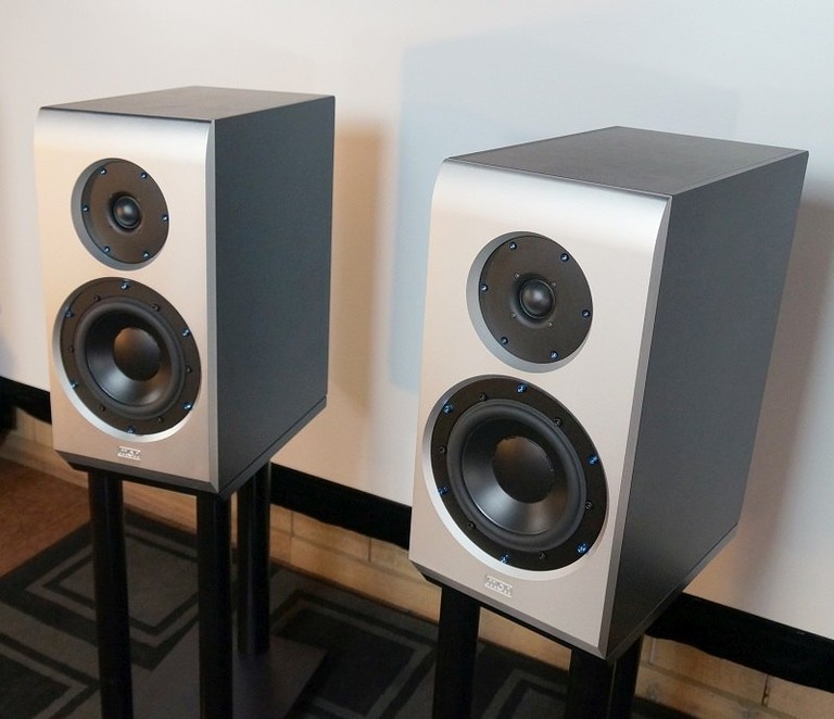

While the SuperMon Isobarics are stylish and classy-looking speakers, they aren’t the kind that will disappear in a room without notice, so people who do not care for the appearance of speakers will not like how prominent they will be. They do not come with grilles to hide their ‘speakerness.’ They are bound to be noticed by guests and will be a point of discussion unless they are placed in a room with so many high-end luxury pieces that they wouldn’t stand out. These are large aluminum stand-mount speakers, and even the stands that they come with are very posh. The stands are some heavy-duty aluminum constructions with three massive legs that come down to a thick base with a slightly chamfered front lip. The base rests on top of large aluminum feet that are tipped in a broad conical spike. The spikes rest in some saucers that protect the floor, and even the saucers are glistening solid metal pieces that look swank.

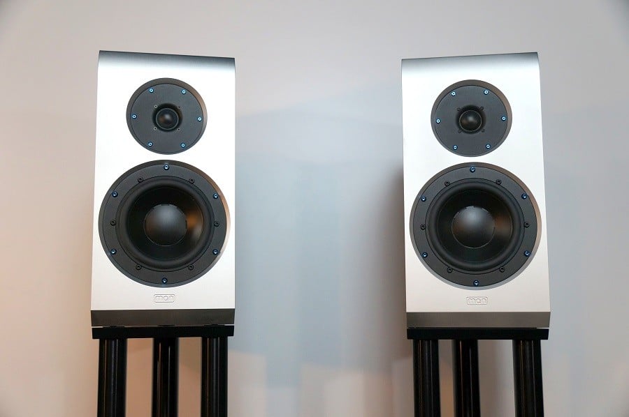

SM pair5
The speakers themselves have an unapologetically metallic presentation. That is not a bad idea since much of what the buyer is paying for is the specialized metal enclosure. The front plate can be had in different colors other than metallic grey, and MonAcoustic can work with customers to find a preferred color. The front baffle is flat except for some mild rounding at the top edge and a shallow beveling at the lower edge that continues into the top plate of the stand. The drivers are somewhat recessed into the front baffle. Both the plate of the tweeter and the trim ring of the woofer are anodized black to match the black dome and cone of the drivers. No attempts are made to hide the machine screws, and that gives them an industrial chic aesthetic that would make them easy to blend in with any modernist interior decor. As speakers go, I think they look great, but the appearance of the SuperMon Isobarics will be divisive; those who like the sight of speakers will love them, but those who prefer speakers to be subdued and out-of-sight will likely abhor them.

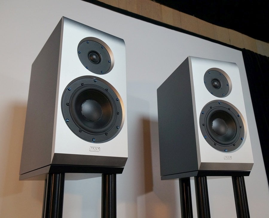

SM domeThe SuperMon Isobarics are very involved loudspeakers from an engineering perspective, so there is a lot going on to discuss. Let’s start our discussion with the enclosure design since that is the first thing that would be noticed about the speakers. The enclosure is made from aluminum; a lot of it. The front baffle is 1” thick and the side panels are ⅖” thick. Leather seals are used for resonance elimination, and melamine foam is used for tuning isobaric resonance and port output harmonics. It adds up to 80 lbs., the heaviest stand-mount speakers I have dealt with yet.

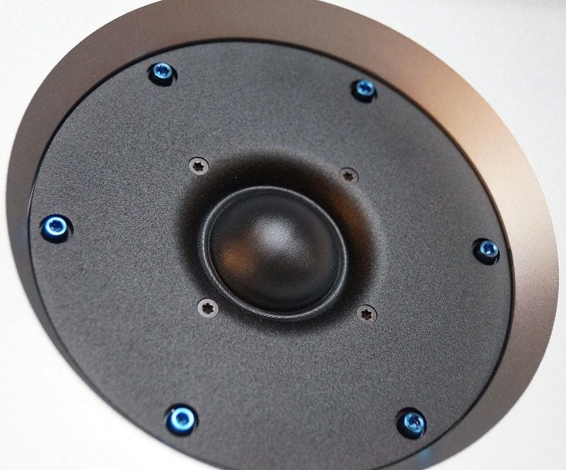

The tweeter used is the SEAS Exotic T35. This is a heavy-duty 1.5” fabric dome tweeter with a 600Hz free-air resonance and 100 watts of long-term power-handling ability- numbers that indicate this is a very beefy dome tweeter. The Exotic T35 lives up to its name by using an AlNiCo magnet in the motor system. AlNiCo is a metal alloy with the word deriving from Aluminum-Nickel-Cobalt. It is much more expensive than traditional iron ferrite magnets (mainly due to the difficulty in sourcing cobalt), but it isn’t as subject to induction effects or modulation distortion.
SM cone2

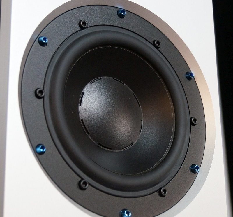

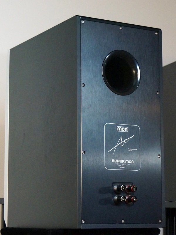

As its name indicates, the SuperMon Isobaric uses an isobaric woofer system. The SuperMon Mini also uses this system, so we will simply quote our description from that article:
Isobaric derives from Greek and means the quality of having equal pressure. For an isobaric loudspeaker design, the equal pressure refers to an air mass suspended in a chamber that is sandwiched by two active drivers which are moving in phase. So the SuperMon Isobaric’s other driver is hidden and is mounted behind the exposed woofer at a halfway-deep point in the enclosure, and the two drivers enclose a sealed pocket of air between them. The reason to use this design is to get deeper bass from a small cabinet. The effect of having a pocket of air with unchanging pressure between two drivers is that the system retains a lower resonant frequency in a smaller cabinet by doubling the moving mass yet halving the compliance. It is like using one driver with a heavier moving assembly but a larger and softer suspension; it will have a low resonant frequency although at the cost of efficiency. The efficiency cost is minimized with an isobaric system since it halves the impedance and sensitivity.
The SuperMon Isobaric doesn’t fully load the woofers using an isobaric equal pressure system. The exterior woofer crosses over to the tweeter at 2.7kHz, but the rear woofer is low-pass filtered at 130Hz. The rear woofer also loads a large port mounted on the back of the speaker so the outer pressure that it is subject to will not be the same as the pressure load on the front-mounted woofer. That means it is not entirely an isobaric system, but it does take advantage of isobaric loading in the range where it counts for most, in the lowest frequencies. The exterior bass driver is the AudioTechnology 6A77, a high-performance 6” driver made in Denmark. The interior driver is a German-made Eton bass driver. Both are premium drivers known with a good reputation among loudspeaker designers. Likewise, the crossover circuit is using premium components such as heavy-duty Mundorf capacitors and air-core inductors to ensure the highest tolerance filters with the least amount of losses.
SM rear4

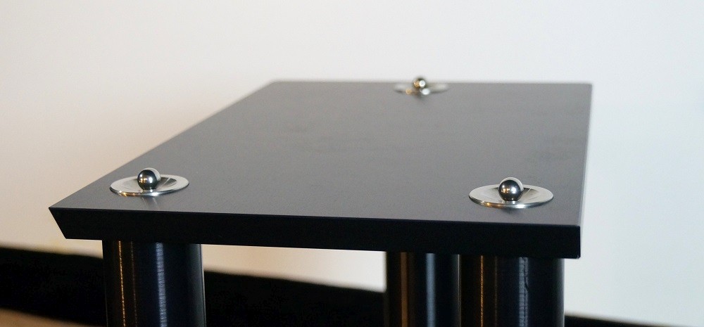

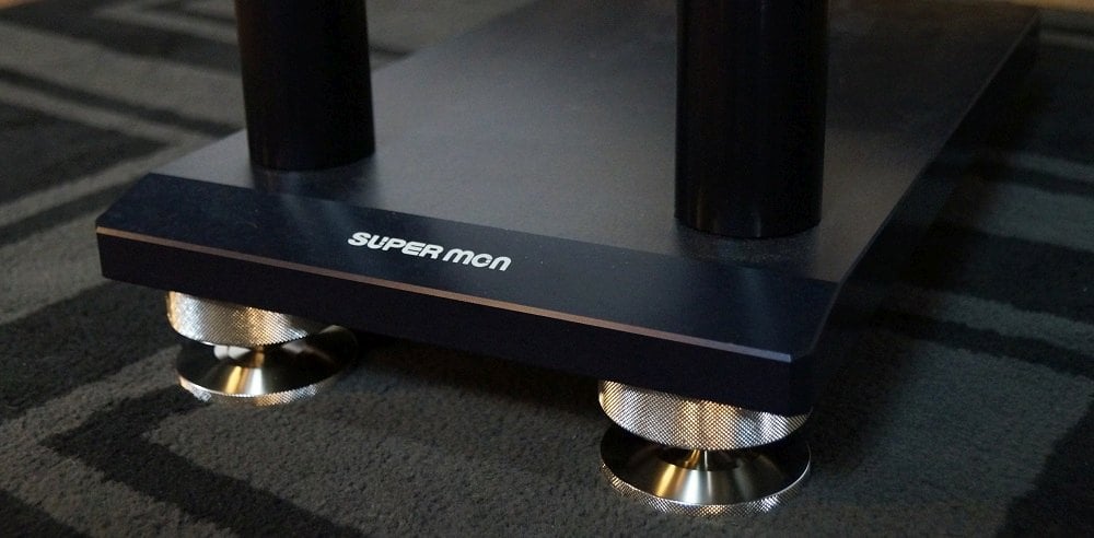

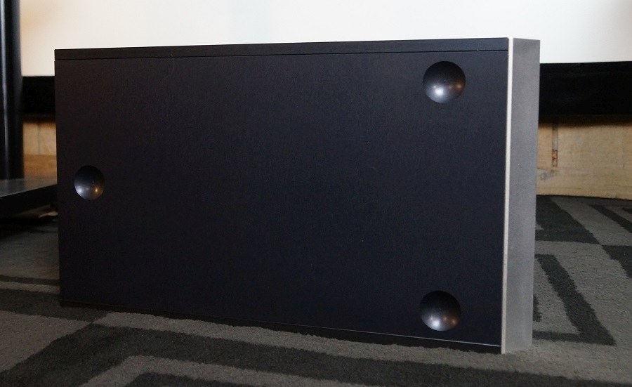

The SuperMon Isobarics come with their own stands, and the way that the speakers rest on the stands is interesting. The underside of the speakers and the top of the stands have three matching concave cavities. The speakers each come with three ball bearings that are seated in the concave recesses. The bearings are slightly larger than the combined depth of the recesses so they give the speakers a small rise above the stand. This gives the SuperMon Isobarics a stabilized wobble on the top of the stand. I assume the benefit is supposed to be some kind of damping for lateral movement caused by driver motion. I wouldn’t guess that this feature has any real audible benefits, but it is nonetheless a cool way to be mounted on top of a stand. One problem with it is that the clearance between stand and speaker does not allow enough room for fingers, so it can be a potential pinch point for someone lowering the speaker into the stand itself. My method for dealing with this was placing some thin paperback books flat on the stand, then lowering the speaker on the books, and then slide the books out so the speaker would be gradually lowered onto the ball bearings. The stand has three thick legs going to a base. The base rests on the ground on some massive spiked feet. The spikes rest on some hefty metal floor pads that have some inverse conical divots that the spikes can be slotted in. The overall stand itself is a heavy-duty contraption, and, at 62lbs., weighs more than many floor-standing speakers alone. That's a whopping 142lbs (80lbs speaker and 63lbs stand).
SM bottom
SM Stand Top bearings
With high-power handling drivers, a large enclosure, and a large port, the SuperMon Isobarics should be very capable in dynamic range for stand-mount loudspeakers. Given the premium components used at every turn, it should offer a very high-fidelity experience as well. Let’s now find out how all of this over-the-top design pans out in some listening sessions…

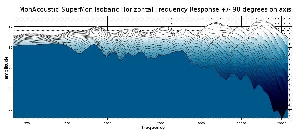

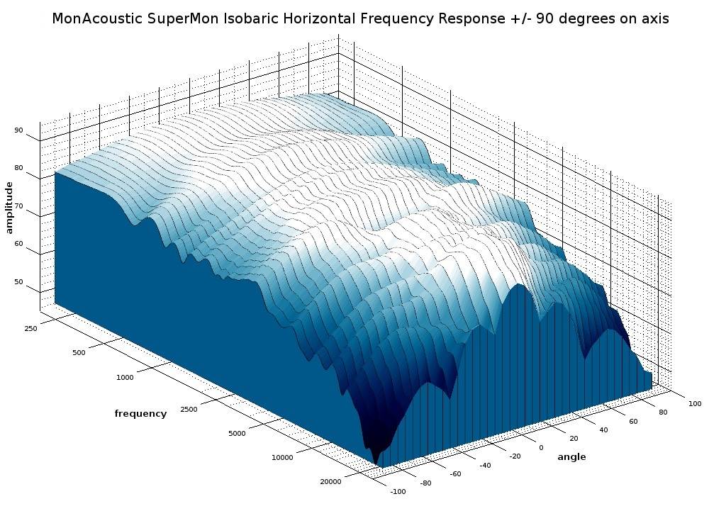

The SuperMon Isobaric was measured at a height of 4 feet at a 1-meter distance from the microphone, and the measurements were gated at a 5-millisecond delay. In this time window, some resolution is lost below 600 Hz and accuracy is completely lost below 300 Hz. Measurements have been smoothed at a 1/12 octave resolution.
SuperMon Iso 3D waterfall response
SuperMon Iso 2D waterfall response
The above graphs depict the speaker’s lateral responses out to 90 degrees in five-degree increments. More information about how to interpret these graphs can be read in this article: Understanding Loudspeaker Review Measurements Part II. The overall response shown here is not bad but there are some oddities. Firstly, the treble at and around the on-axis angle seems to be a bit hot above 5kHz. By the 20-degree off-axis angle, it is level-matched with the lower frequency range, but as we move inward toward the on-axis angle it does become a bit elevated, perhaps 3dB hotter than the average below that range. I didn’t notice an especially hot treble in my listening, but I didn’t listen to the speakers at an on-axis angle. The mid-range from 500Hz to 3kHz is generally well-controlled, and that is where the heart of most music is, so it was important that the SuperMon Isobaric got that right. There seems to be a slight lowering of amplitude below 500Hz that may have contributed to the weakness in bass that I heard, at least before I equalized them, but the main explanation for that will follow when we examine the groundplane measurement of the low frequencies.

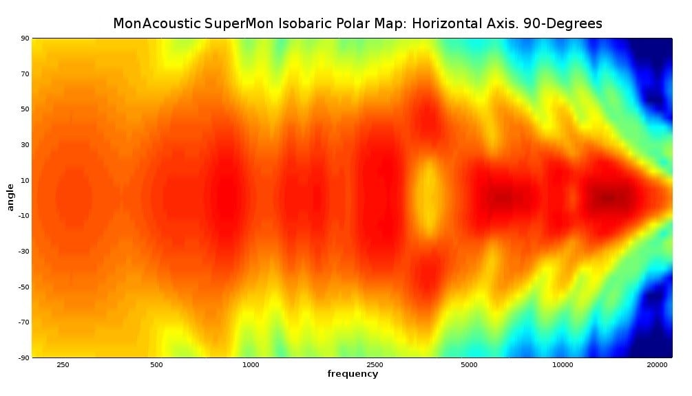

SuperMon Iso Polar map
The above polar map graphs show the same information that the preceding graphs do but depict it in a way that can offer new insight regarding these speakers’ behavior. Instead of using individual raised lines to illustrate amplitude, these polar maps use color to portray amplitude, and this allows the use of a purely angle/frequency axis perspective. The advantage of these graphs is they can let us see broader trends of the speaker’s behavior more easily. For more information about the meaning of these graphs, we again refer the reader to Understanding Loudspeaker Review Measurements Part II.
The SuperMon Isobaric’s front radiation pattern is a bit ragged but generally is fine with no major bursts of energy or nulls at off-axis angles. One unusual feature is that we can see a small dip on and around the on-axis response just above the crossover frequency. This suggests that there is not perfect phase alignment between the tweeter and woofer, at least on-axis with the tweeter. In that same region, there is also some extra off-axis energy. This is occurring at the tweeter level, and this attribute would certainly change with height, so a higher or lower angle might correct this minor error. Something else interesting to note is that the tweeter manages to keep a somewhat wide dispersion out to a relatively high frequency. At 1.5”, the SEAS Exotic is a large dome tweeter. Typically these kinds of tweeters will begin to constrict dispersion at relatively low frequencies. This tweeter does constrict its dispersion somewhat above 5kHz, but it doesn’t get really narrow until above 10kHz. The listener could be listening at a 30-degree angle and still be met with high treble. It’s would be an unusually broad angle of high-frequency energy for a large dome, except that it seems as if the tweeter had been voiced a bit hot to achieve this effect.

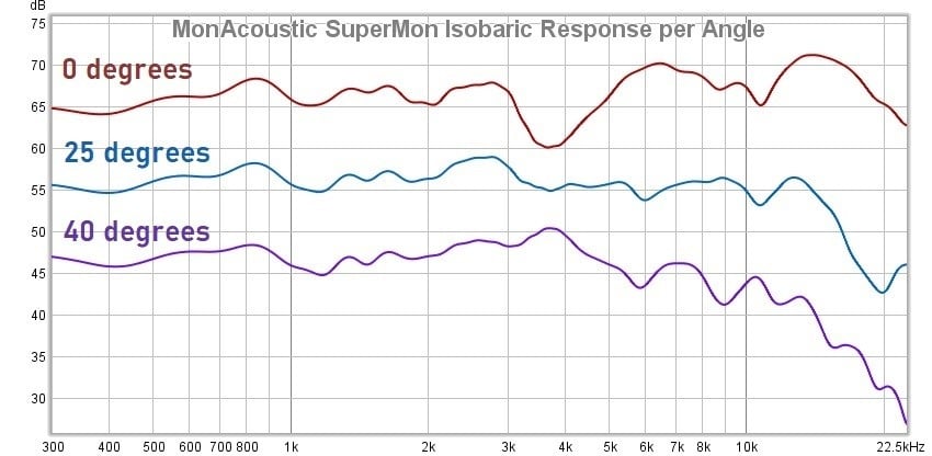

SM iso response per angle graph
The above measurements compare the on-axis response of the SuperMon Isobaric to a couple of off-axis measurements. We are doing this to illustrate the optimum toe-in angles for those users who are looking for the most neutral sound. As we saw in the polar map, the on-axis angle has a null around the crossover frequency indicating a phase conflict, at least for the point in space where we measured. Moving off-axis smoothes out the irregularities from the on-axis angle and can yield a fairly neutral response. From 20 to 30 degrees, the response becomes relatively flat, which can be seen on the 25-degree curve. Moving even further off-axis, we can see the tweeter’s dispersion narrow, and the higher frequencies become rolled off. Listeners are likely to end up in a neutral response angle if they position the speakers to straight face forward in a parallel aim with no-toe-in angling. I would recommend users start with this type of placement in setting these speakers up.

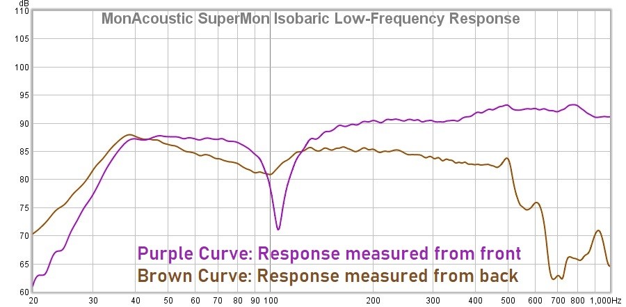

SuperMon Iso low-frequency response
The above graphs show the SuperMon Isobaric’s low-frequency responses that I captured using groundplane measurements (where the speaker and microphone are on the ground in a wide-open area). There are two curves here: the purple curve is the speaker measured with the microphone 2 meters in front of it, and the brown curve is measured with the microphone 2 meters behind the speaker. One feature of the front-measured response that leaps out is a high-Q dip just above 100Hz. While that may have contributed to the lessened bass response that I heard, what I heard was not quite a null, but rather an overall attenuation of low bass. This null occurs in front of and on the sides of the speaker, and I would guess that the isobaric loading design of the speakers creates some kind of sharp cardioid null. Rear-generated output by the port would help to fill it in somewhat in-room. The cause of the reduced bass is better explained by the overall lowered output below that null. Everything below 100Hz looks to be at least 3dB softer than the range above the null. Something else to note is that this speaker is tuned quite deeply for a stand-mount speaker. The response extends well below 40Hz before it even begins to roll off. That is more like the bass extension that we typically see from floor-standing speakers, not stand-mount speakers.

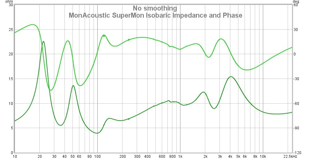

SM Impedance
The above graph shows the electrical behavior of the SuperMon Isobaric. These are unusual impedance curves, to say the least, but they aren’t bad or especially problematic. The only spot of concern is 100Hz, which dips down to 4 ohms along with a very steep phase angle. That is going to be rough for a cheap amp, but no one who buys these $25k speakers is going to pair them up with a cheap amp, so there isn’t anything to be concerned about here. One unusual feature we see is evidence of two resonances in the low frequencies; one for the port tuning at 35 Hz, and another at 100Hz, which is presumably related to the isobaric design. The tweeter’s impedance seems relatively high for a dome tweeter, and I think that is due to some resistor padding in the crossover circuit on the SEAS Exotic. I measured the sensitivity to be 88.5dB for 2.83v at 1 meter, and that is pretty close to the manufacturer’s spec of 89db. This is about the sensitivity I would have expected of a large stand-mount speaker, so no surprises there. Any decent amp should be able to make these speakers get loud. However, I would recommend a somewhat beefy amp for those who want to give the bass more muscle via equalization, which I think will be a lot of owners.

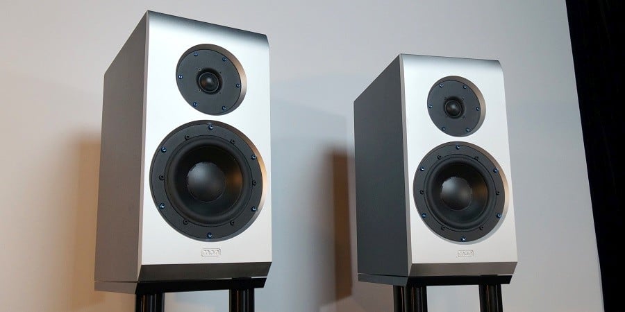

SM Mon badgeOn top of the missing bass, the frequency response at and around the on-axis angle is a bit rough in treble frequencies. Listening to the speaker head-on can be piercing with certain content at times due to the prominent treble. This is easily solvable by listening with only a mild to no toe-in angle where the response becomes fairly neutral at the listening position. Nonetheless, I have had plenty of less expensive speakers that didn’t have this problem. I believe the root cause is that if the tweeter were level-matched with the woofer at an on-axis angle, its off-axis energy would be fairly low, and it would end up with a mismatched dispersion with respect to the woofer. So Mon Acoustic chose to have better off-axis behavior at the cost of a smooth on-axis response. While this issue is solvable for a single listening position by merely repositioning the speaker to an angle of response that suits the listener’s ears better, it is not easily addressed with equalization for a broader listening area.
With my complaints out of the way, let’s now get into compliments. With EQ’d bass and correct placement, the SuperMon Isobarics can sound terrific. They do take some work to get there, but they can certainly get there. The effort involved in attaining a great sound from these speakers will inevitably be a turn-off for some people, but there are those audiophiles for whom that would actually be a draw. The soundstage and imaging are excellent. The speakers can have a good dynamic range if given enough power to compensate for bass equalization. The midrange performance is generally good out of the box on and off-axis, and, as we noted before, that is where most audio content lie. I enjoyed listening to them once I had them set up optimally for my tastes.
Outside of their sound, the build quality of the SuperMon Isobarics is nearly as good as can be had. It would be difficult to make a more inert, dense enclosure. Perhaps a thick marbled stone would be even more enduring and massive? Or maybe a denser metal like titanium? But to have a large stand-mount loudspeaker built out of aluminum is pretty over-the-top. The Isobarics feel like they look too. Picking one up is akin to lifting a boulder. At 80 lbs. each, users will need to be careful when handling these speakers. As we said about the SuperMon Minis, if taken care of, these speakers could potentially last a very long time. The soft components are going to be the limiting factor in the lifetime of these speakers, but if they are kept in a climate-controlled environment without experiencing too many temperature extremes or humidity cycles, then these speakers could last many decades.
Their appearance is pretty stunning- as any fully metal loudspeaker would be. Owners looking for a speaker that looks high-end without being over-stylized have a great choice in the SuperMon Isobarics. These are not speakers that will meekly blend in with the decor; these are speakers for audio lovers to proudly display. Visitors will notice them, and they will likely be the subject of conversation.
