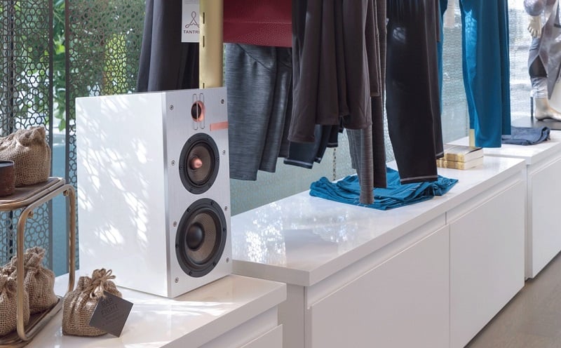

The Starke IC-H1s arrived nicely packaged in a leather trimmed soft case which itself was inside a traditional cardboard box with foam inserts. The nice packaging and white cotton gloves do nothing for sound quality but are a nice way to provide some pride of ownership while reinforcing the purchase decision. With some speakers, I must extensively experiment with positioning to get them to image well and disappear. The Starke speakers did that in both rooms with minimal positioning effort. Not that extra effort does not provide extra rewards, it does, but the first tries in each room were quite good.
Once the speakers are out of the packaging, you can appreciate their clean, modern design. The finish on the aluminum panel and automotive grade gloss paint on the cabinets would be welcome on speakers that cost several times that of the IC-H1. Overall, they reminded me of Focal speakers with their combination of clean design, fit and finish. That said, I would have liked some more options, starting with the option for a protective grille.
The bridge over the tweeter is a good start, but some additional protection would be a nice option if they are placed in an area with lots of young fingers. I would also like to see some other finish options other than gloss black or white. These are stylish speakers and I would suspect that those who are attracted to them may have some more color in their homes.

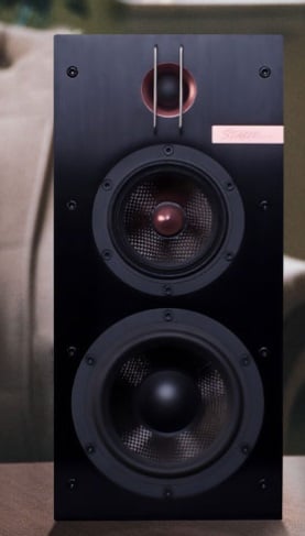

I found the fit and finish of the Starke Sound IC-H1 Elites to be excellent. The front baffle is made from ¼” thick 6061 aluminum alloy with a brushed finish. The vertical brush strokes complement the tall, narrow footprint of this “Reference Compact Speaker” as it is referred to by Starke Sound. The IC-H1 Elite’s three drivers are exposed on the baffle with just a pair of small metal bridges running vertically in front of the tweeter to protect it from accidental impact. A small copper colored metal badge with the Starke name. The black, fabric dome tweeter is slightly recessed from the baffle and surrounded by a “pinnacle ring”, which happens to look a lot like what most of us would call a waveguide. Both the midrange and woofer cones have an attractive woven pattern, with the midrange being the attention getter with a shinier surface and copper colored phase plug. The carbon in the woofer is a different weave making it less reflective and the woofer also uses a more traditional dust cap.

The IC-H1 Elite is the smaller of the two stand mounted speakers in the Halo line at 24.2 pounds, 15.1 inches high, 7 inches wide and 10.1 inches deep. The side walls of the cabinet are angled inward, making the rear slightly narrower than the front, presenting a trapezoid shape when viewed from above. This eliminates a pair of parallel walls and their accompanying parallel interior surfaces, reducing standing waves. A gentle downward slope of the top panel eliminates another pair of parallel surfaces, but the front and rear walls appear to be parallel with each other. One of the first things I noticed about the speaker when I saw it was the front baffle which is made from ¼ inch thick 6061 aluminum alloy. This makes for a very stable mounting platform for the drivers. The rest of the cabinet is made from high-density fiberboard laminated over medium density fiberboard. Dan described the interior of the IC-H1 as asymmetrical and heavily braced, and my non-scientific knuckle test on various parts of the cabinet shows it is indeed solid. The rear panel has a small, flared aluminum port near the top and an aluminum plate toward the bottom with a single pair of speaker terminals. All the drivers are connected to the aluminum baffle with highly compressed Poron foam gasket to provide a seal and dampen vibrations.
The one-inch silk dome tweeter is a proprietary Starke Sound design, as is every driver in this speaker. Dan Wiggins was extremely proud to explain that Starke designs each driver to obtain maximum performance for its intended use. In order to make sure the benefits of the designs are not lost in the manufacturing process, Starke also makes all of its own drivers for improved quality control and, importantly, in today’s world, this has the added benefit of reducing supply chain issue. All the drivers incorporate “Linear Motor Force” (“LMF”) driver technology. As explained by Dan, this results in a flatter Bl curve. The Bl curve shows how much force the magnetic motor strength is exerting (typically displayed along the vertical axis of the chart) at any given excursion point (typically displayed along the horizontal axis of the chart). This helps with improving dynamics and reducing distortion by reducing the variables that arise as the driver moves throughout its range of motion. The architecture of the LMF assembly includes a dual-gap magnet design which has the voice coil travelling through multiple gaps in which the design is overhung for the individual magnetic rings but underhung for the overall structure.
Other than the eye-catching phase plug, the four-inch midrange looks fairly normal. In speaking with Dan, he explained that the carbon fiber is over molded with a polymer rather than utilizing a more common laminate construction methodology. Dan states he has found the over mold process to provide a more uniform bonded surface. I asked why use a hybrid material and he explained that while the carbon fiber cones are extremely lightweight and stiff; they need to be damped. In this conversation, Dan differed from the now popular approach of making drivers as light as possible. He believes there is a proper weight range for each driver and they can be too light. The over mold process provides damping and brings the overall weight within the desired range. The 5.25 inch woofer is also carbon fiber, but appears to be a slightly different material.
