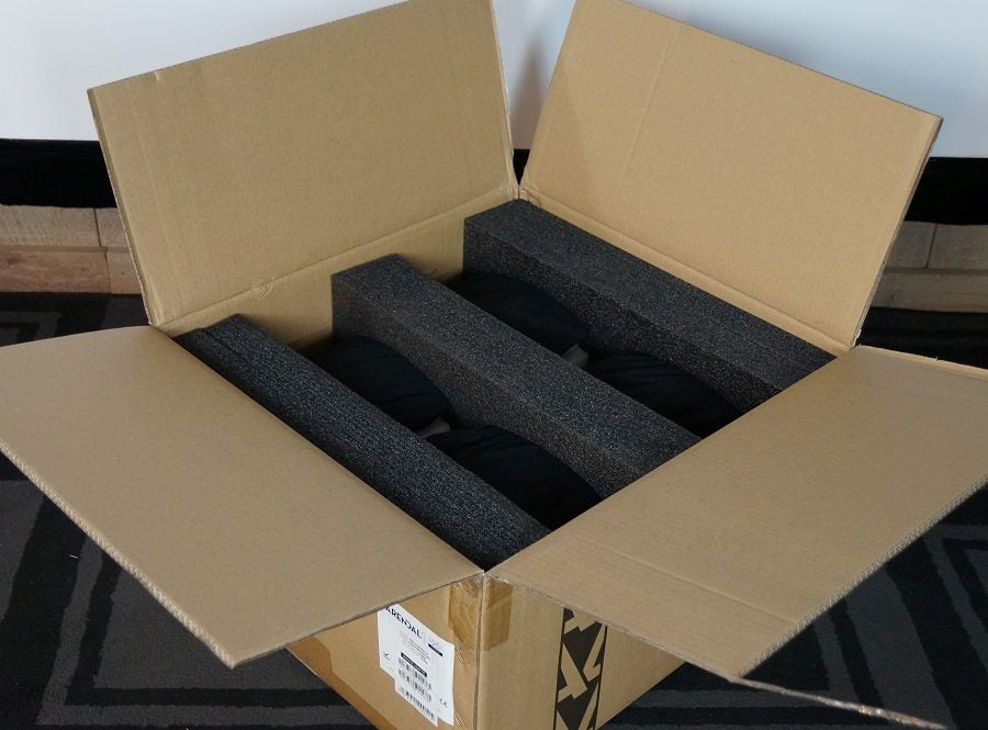

The Arendal 1961 Monitors box arrived wrapped in a thick plastic jacket with the edges covered in security tape. Within the box, the speakers were nested in thick foam blocks with a center block supporting piece. The speakers were covered in cotton fabric sleeves to protect them against moisture and scuffs. Overall, the packing is very good as we have come to expect from Arendal.

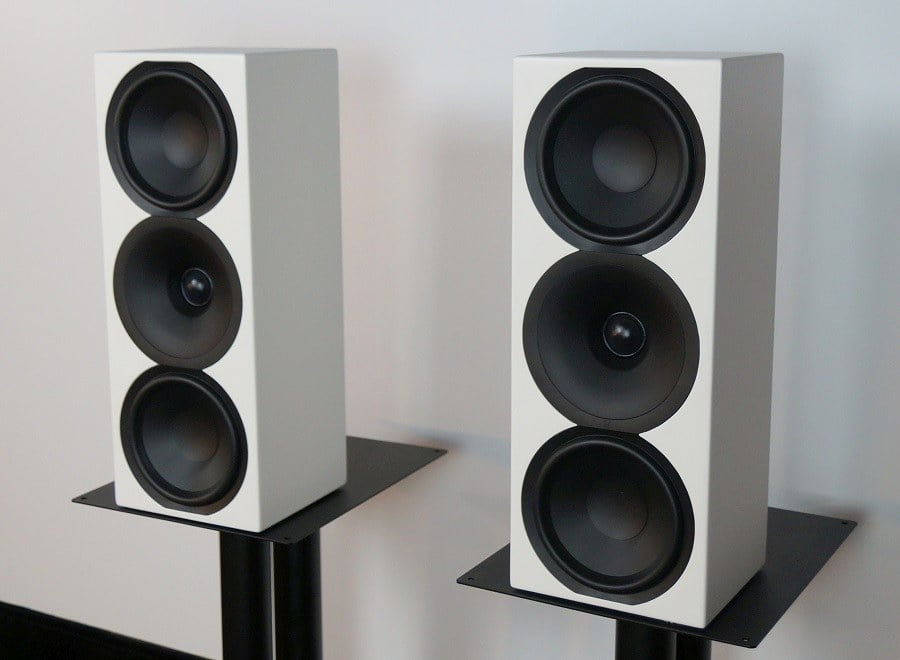

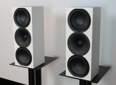

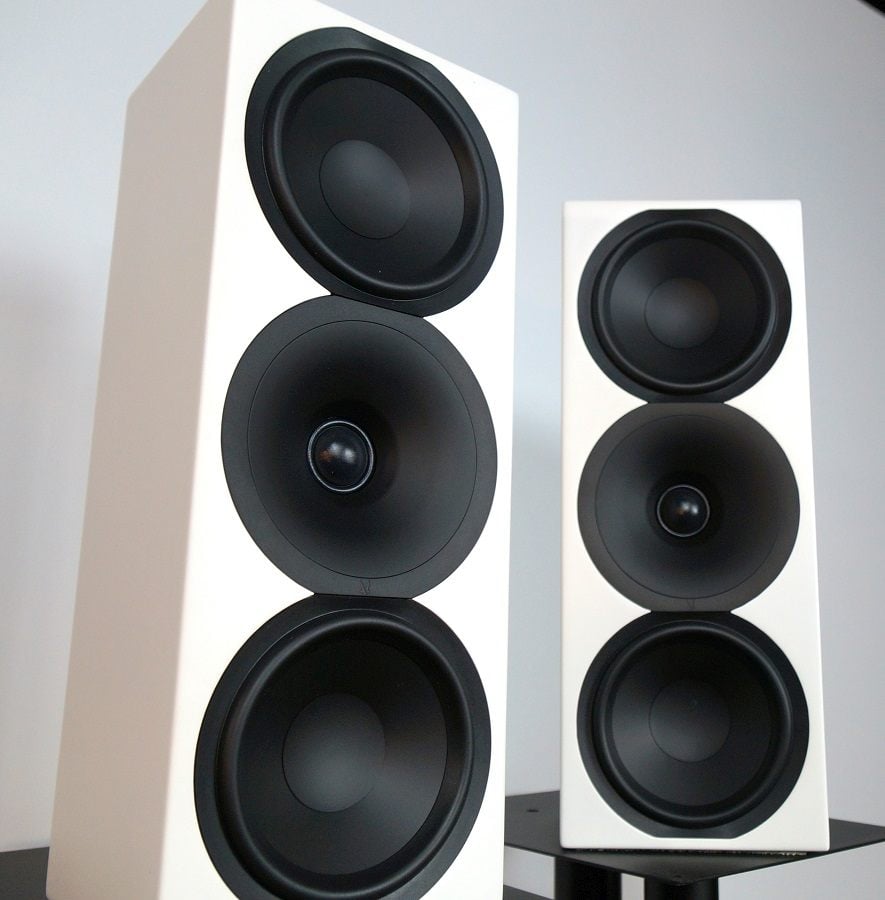

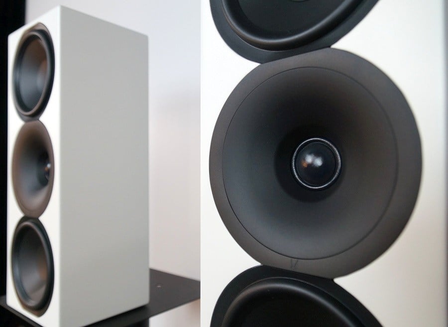

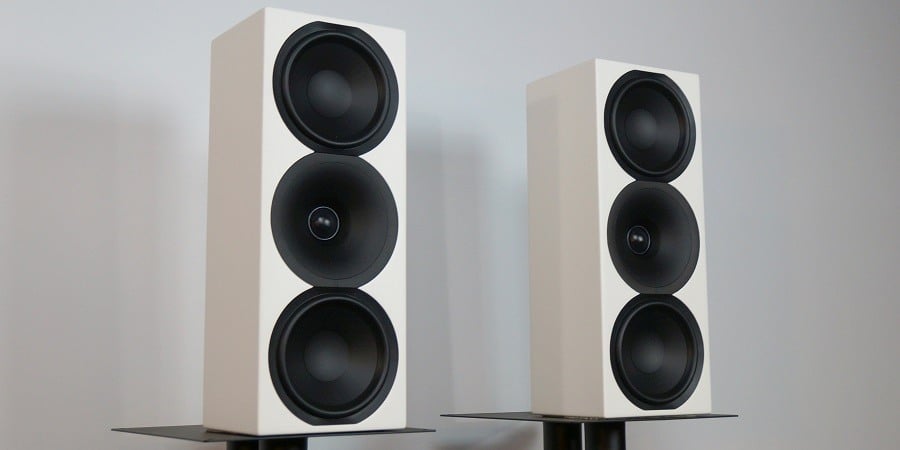

Once unboxed, the 1961 Monitors present themselves as some nice, clean-looking stand-mount speakers. They can be had in black or white matte finishes, and I received them in white. The finish is of a good quality- not as satiny as the 1723 matte finishes but still smooth. Some aspects that contribute to the clean appearance are the slight rounding of all edges and corners as well as trim rings around the driver frames to hide the screws. The woofers have a smooth concave geometry that also adds to the clean, uncluttered styling, and the spherical geometry of the tweeter waveguide assists in this respect as well. All of this detail can be hidden by the grille, which blanks out the front of the speaker, but I do think the 1961 Monitors look better without the grille. As stand-mount speakers, they are relatively tall, and that might draw some attention over typical bookshelf speakers, but the clean styling does a lot to alleviate that. Thanks to the rear-mounting elements, they can also be used as on-wall speakers, but they would protrude out a bit versus other in-wall speakers because of their 6” depth.
I think that their simple, clean styling would make them a good fit in a wide variety of environments, and even more upscale interiors. The industrial design here is sensible and restrained, and I can’t see many people having problems with their aesthetics.

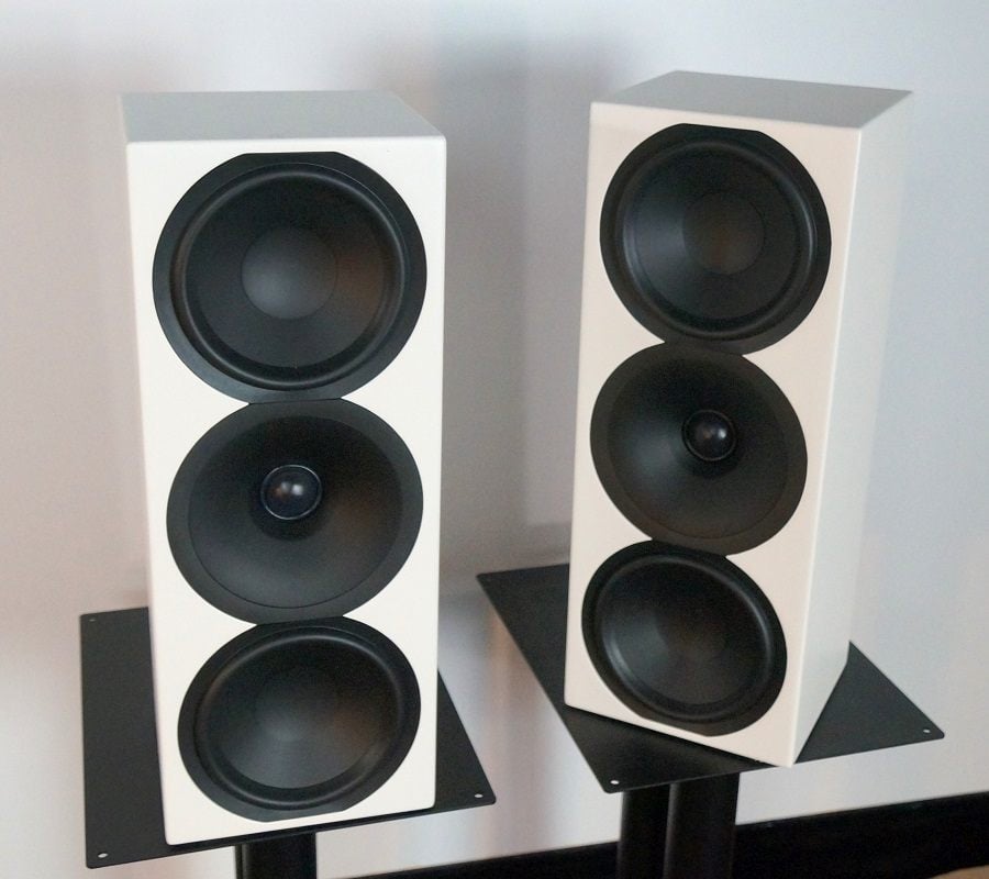

The 1961 Monitor is a stand-mount or wall-mounted speaker for instances where users want a bit more dynamic range than the usual bookshelf speaker but do not want a full tower speaker. A speaker like this would be good for a small dedicated home theater or a moderately-sized living room setup. They might also do well as side or rear surrounds in a moderately large home theater. The inclusion of the second woofer really helps, because the woofers in the 1961 series aren’t very large. It uses 5.5” diameter woofers, but a 5.5” woofer only has about ⅔ the cone area of a 6.5” driver. However, two 5.5” woofers have almost as much cone area as an 8” woofer. The advantage of using multiple smaller woofers over a single large woofer is that the smaller woofers can reach higher frequencies with a lot more linearity than large cones. Since the 1961 Monitors have a 1,500Hz crossover frequency, that wouldn’t be a huge advantage, but it’s nice to know that any bending or break-up mode of the cones is being filtered out well below any point where they could become even slightly problematic. Another advantage of multiple smaller drivers over one large driver is that the system now has multiple motors to help disperse heat instead of a single motor, and that can help to reduce heat-related problems like thermal compression.

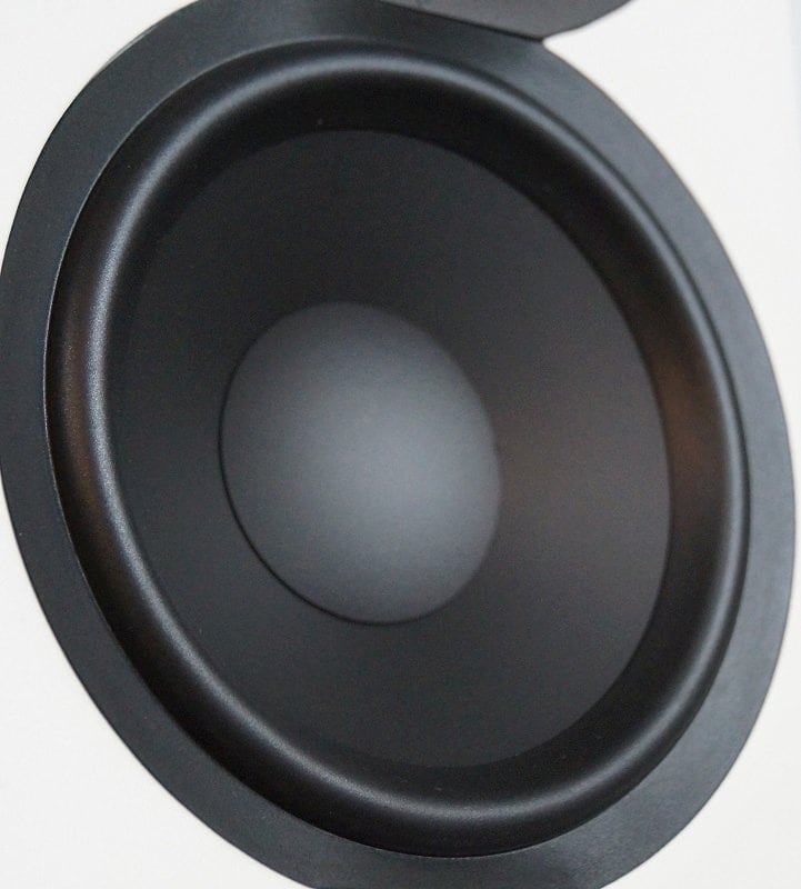

The woofer cones themselves are made from a long fiber pulp with a proprietary coating, and such a composition should be light, stiff, and well-damped. The motor is designed extensively with FEA modeling for high excursion without sacrificing a lot of sensitivity. A great deal of work was put in not just modeling the electromagnetic circuit but also the suspension components and the result is a 5.5” woofer with 6.5mm of one-way linear throw, an excellent level of linear excursion for the size. Arendal uses an aluminum voice coil instead of copper. While copper is more conductive than aluminum, it is significantly heavier, and Arendal has determined that the greater conductivity is not worth the weight penalty. Arendal has used copper in the shorting ring to combat induction-related nonlinearities. Many manufacturers use aluminum for shorting rings since copper is more expensive, but copper is more effective towards this end, so these decisions were driven by achieving performance targets rather than cost-cutting.

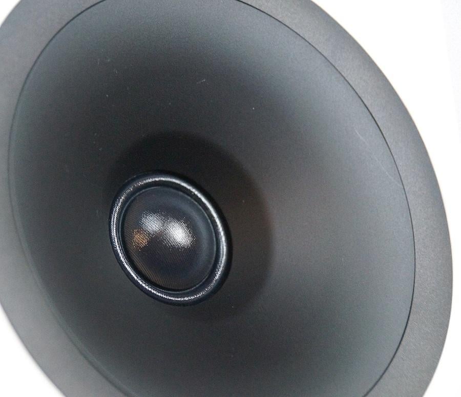

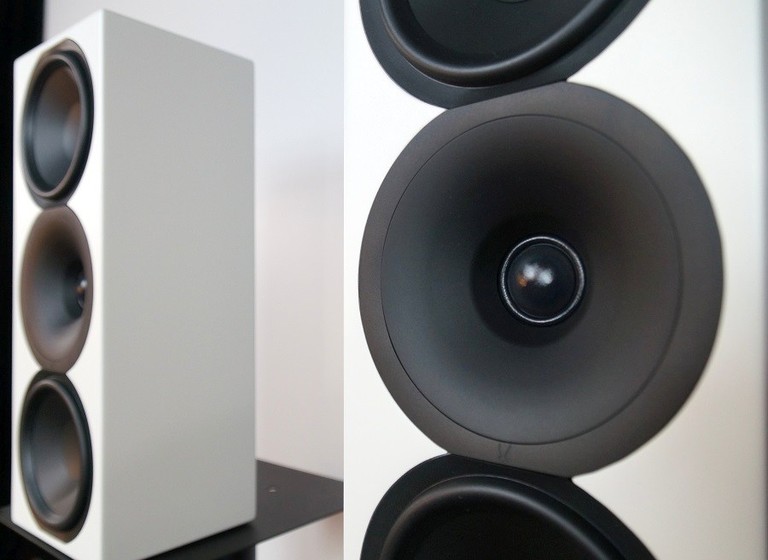

The tweeter is a 1.1” synthetic soft dome loaded into a spherical aluminum waveguide. The waveguide should help control dispersion by constricting the lower end of the tweeter’s band but also widening the high end. This is done so that the dispersion remains more consistent than what normally occurs for dome tweeters without a waveguide, which is a very wide dispersion at their lower end that ends up becoming narrow at the top of the tweeter’s frequency range. The 1961 tweeter has most of the same design features as the 1723 series, including copper and aluminum shorting rings, ferrofluid cooling, an aluminum heatsink, and a damped rear chamber to mitigate resonances from backwave radiation. The one respect in which it departs is that the 1723s use neodymium magnets while the 1961s use ferrite. Neodymium is much more powerful for the same mass, but it is also far more expensive. Manufacturers can still make a powerful motor magnet out of ferrite, but it takes a lot more of it.

subject of driver integration, the MTM (midwoofer-tweeter-midwoofer)
arrangement of the drivers will make vertical placement important here, because
MTM loudspeakers tend to have a lot of off-axis cancellation on the plane where
the drivers are aligned. That means users will want to set up the speakers so
that the tweeters are aimed at the listeners’ ear level. If the tweeter is
aimed too high or low with respect to the listeners’ ears, there will be a
major deficit of energy in the woofer’s bandwidth, which happens to be a very
important frequency range. We will take a close look at how much vertical
coverage this speaker offers in the measurements section.

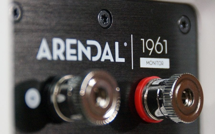

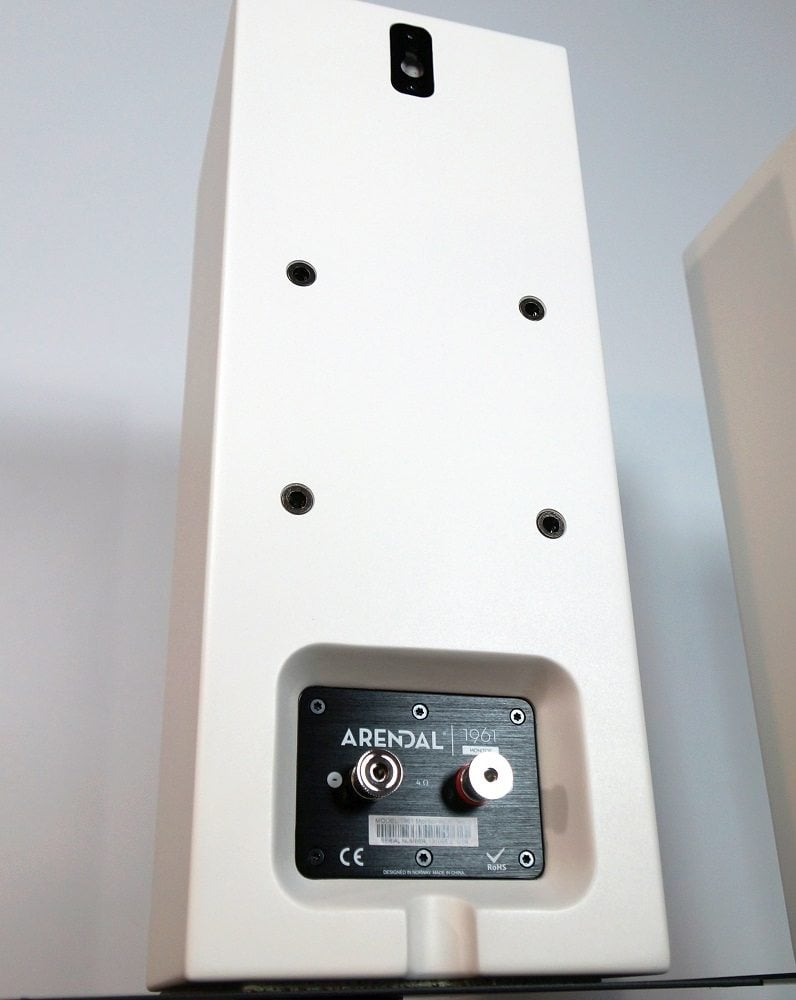

The enclosure is sealed, so the 1961 Monitors are definitely going to want to be paired with a subwoofer. Sealed enclosures do not normally produce much deep bass, especially in loudspeakers with so much cone surface area relative to the box size. Arendal makes it pretty clear that these are intended to be used with a sub on their product page, so that shouldn’t be a problem for anyone. The cabinets are made from high-density fiberboard (HDF) rather than MDF. HDF is a tougher material that will likely last a lot longer than MDF. It does give these speakers a heft at 23 lbs. The front baffle is 1” thick and the side-panels are ¾” thick. The cabinet is jam-packed with acoustic stuffing, so there shouldn’t be much problem with internal panel resonances. There are no feet, but Arendal provides some soft rubber adhesive pads that can be optionally applied.

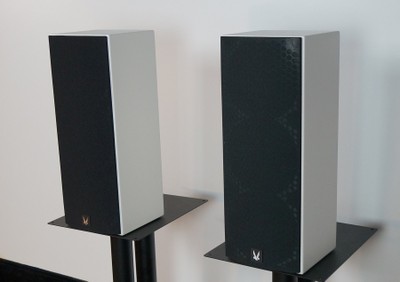

There is a keyhole-slot-mount for those who want to put the 1961 Monitors on the mount with a simple screw, or users can also use the VESA mount holes for more flexibility and angling in their on-wall mount positioning. There is a slot underneath the binding post plate where wire can be routed for mounting them flush against the wall. VESA mounts can allow these speakers to be mounted high and angled, and that can come in handy for systems for height channels, but ceiling mounting is not possible.

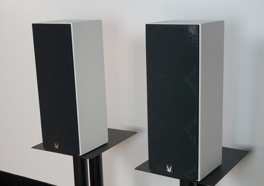

The grilles are curved plastic pieces that have acoustically transparent fabric draped with a perforated lattice. They will probably cause some mild acoustic diffraction but likely not enough to impact the sound in any significant way. They use magnetic adhesion to stick on the front baffle, and you do have to give them a good pull to remove them. The curvature plus the lattice structure really enable the grilles to protect the speaker diaphragms. It wouldn’t be easy to damage the drivers when the grilles are applied.

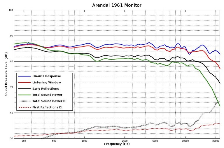

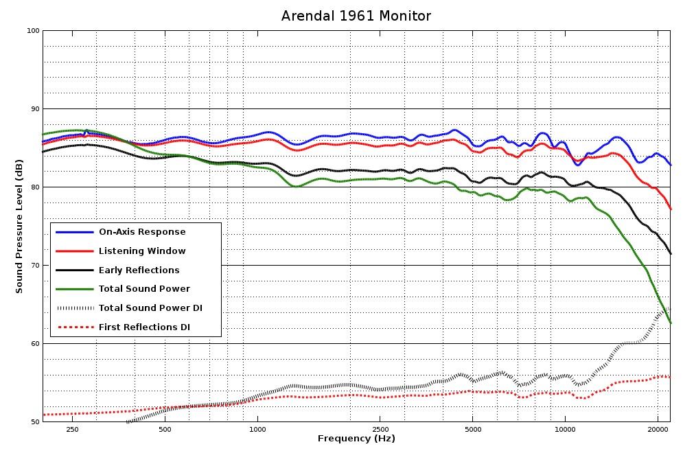

The Arendal 1961 Monitor was measured at a height of 4 feet at a 1-meter distance from the microphone, and the measurements were gated at a 4.5-millisecond delay. In this time window, some resolution is lost below 600 Hz and accuracy is completely lost below 300 Hz. Measurements have been smoothed at a 1/24 octave resolution.

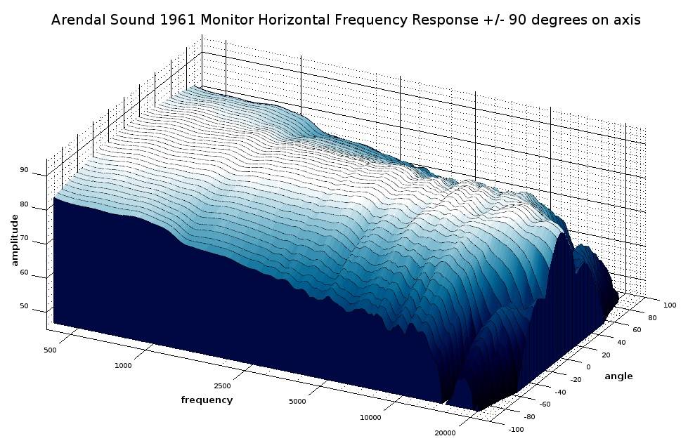

The above graph shows the direct-axis frequency response and other curves that describe the 1961 Monitor’s amplitude response in a number of ways. For more information about the meaning of these curves, please refer to our article Understanding Loudspeaker Measurements Part 1. This is an excellent showing by the 1961 Monitors with a superbly flat response that stretches from upper bass out to 10kHz. The on-axis response in upper treble becomes a tad rocky, possibly due to throat diffraction in the waveguide, but even then, off-axis response is still good although it does narrow considerably above 15kHz. These small errors in upper treble are inconsequential since there is not much content up there nor is human hearing very sensitive in that range. The off-axis response holds a terrific correlation to the on-axis response as well as the listening window as can be seen from how much the early reflections curve and sound power curve resemble the on-axis and listening window curve. These measurements just tell a lot of good news about the 1961 Monitors and no real bad news.

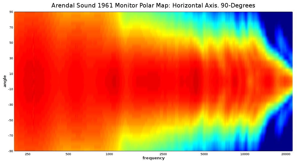

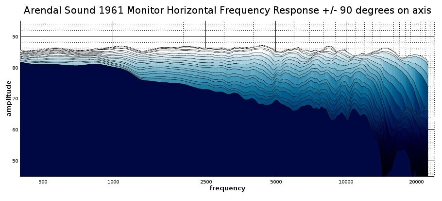

The above graphs depict the speaker’s lateral responses out to 90 degrees in five-degree increments. More information about how to interpret these graphs can be read in this article: Understanding Loudspeaker Review Measurements Part II. Here, we get a closer look at the 1961 Monitor’s controlled directivity. The woofers’ transition to the tweeter is seamless, and I see no evidence of the crossover circuit, which itself is evidence of a terrific crossover design. All of the off-axis responses correlate highly with each other, and that means that this speaker will sound the same over a wide swath of its coverage. It also means that the acoustic reflections will not depart from the direct sound from the speaker, so this is a speaker that does not need a room with heavy acoustic treatments to sound good; indeed, it should sound good in a normally furnished room, so no extra acoustic treatments needed in most cases. We also get a closer looking at the nature of the tweeter’s beaming, and users who want to get hit with treble all the way past 20kHz should listen within 10 degrees of the on-axis angle. This response as a whole is beautifully neutral. This is a loudspeaker that accurately reproduces the source signal. The 1961 Monitor could easily be used as a studio monitor to mix and master content because it’s accurate enough to let you know exactly what is happening in your mix. No frequency range is disproportionate with respect to anything else.
The above polar map graphs show the same information that the preceding graphs do but depict it in a way that can offer new insight regarding these speakers’ behavior. Instead of using individual raised lines to illustrate amplitude, these polar maps use color to portray amplitude, and this allows the use of a purely angle/frequency axis perspective. The advantage of these graphs is they can let us see broader trends in the speaker’s behavior more easily. For more information about the meaning of these graphs, we again refer the reader to Understanding Loudspeaker Review Measurements Part II.
What we can see from this polar map of the 1961 Monitor is its outstanding controlled directivity from just above 1kHz to past 10kHz. Most of the midrange and much of the treble keep a very even keel with the angle. Below 1kHz, the woofers are too small in diameter to constrict dispersion. Arendal’s speakers with larger woofers can be seen to constrict dispersion down to lower frequencies, but even their 1723 Monitor with its 8” woofers only gain a few hundred Hz of tighter dispersion over the 1961 Monitors with their 5” woofers. While upper treble dispersion does begin to narrow a bit above 10kHz, it’s a testament to the efficacy of the tweeter’s waveguide that it can maintain an even dispersion pattern to as high of a frequency as we see here. The performance exhibited in this graph is very good overall.

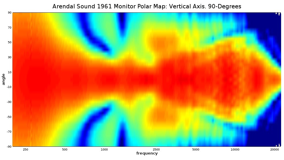

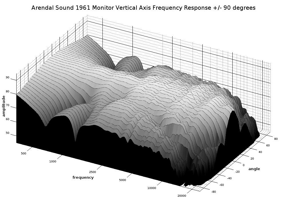

The above graph shows the 1961 Monitor’s response behavior along its vertical axis where zero degrees is directly in front of the tweeter, negative degree values are below the tweeter, and positive degree values are above the tweeter. If we squint, we can see many of the attributes of the frequency response of the waterfall plot reflected in this graph, especially within the tweeter’s frequency bandwidth. However, the woofers’ bandwidth is changed dramatically. The most important difference is the off-axis dips between 500Hz and 1.5kHz where the distance difference between the woofers causes cancellation nulls at outer angles. To put it another way, the woofers are playing the same signal, but at off-axis angles, the far woofer has a time delay versus the near woofer to the microphone (or listener), and this delay of an identical signal causes a phase mismatch where the pressure waves cancel out each other, much like how sound cancellation in active noise reduction headphones work. This is an audible artifact if the user listening at these angles, but that is not likely, since they mostly kick in at fairly high and low angles with respect to the tweeter. The horizontal dispersion is much more consequential than the vertical dispersion since most people will be listening at around the same height but not the same lateral angle.
The above graph shows the 1961 Monitor’s vertical response in a polar map. Here we can get a better sense of the width of the vertical angle to which this speaker holds a consistent response. The 1961 Monitor offers about a +/- 20-degree angle from the speaker center where it will yield an even response. Listeners at angles higher or lower than this will start to lose big chunks of the mid-range due to the cancellation nulls. As we mentioned above, it is unlikely that anyone will be listening outside of that vertical angle range, so anyone who is concerned about how tightly MTM designs can constrict the vertical listening angle does not need to worry about the 1961 Monitors. These speakers provide a wider angle of optimal vertical listening than most MTM designs.

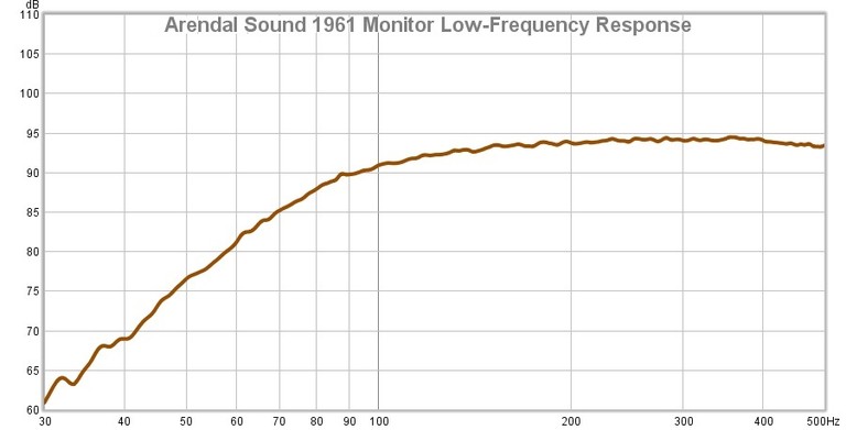

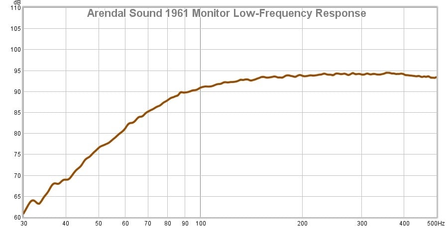

The above graph shows the 1961 Monitor’s low-frequency responses that I captured using groundplane measurements (where the speaker and microphone are on the ground in a wide-open area). The response is very smooth down to 90Hz where it begins the traditional 2nd-order 12dB/octave rolloff downward that is typical of sealed loudspeaker designs. Everything is ordered and well-controlled with no surprises in this range. The 1961 Monitor doesn’t really do deep bass which is no surprise, but its higher bass range reproduction is very even and balanced.

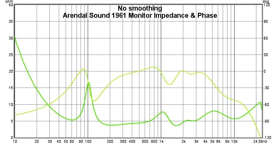

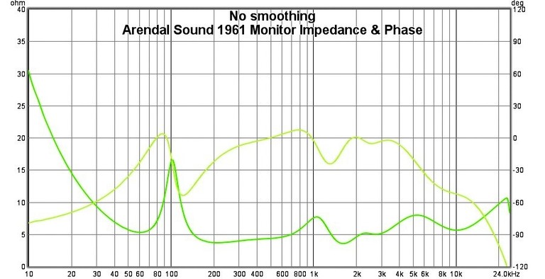

The above graph shows the electrical behavior of the 1961 Monitor. There isn’t much odd here, but one nice feature is that it maintains impedance in a pretty steady range above 150Hz. This is a solidly 4-ohm speaker, much like Arendal specifies. This impedance load might be a handful for a cheap receiver amp to drive at loud levels for prolonged periods, but any reasonably built amp will have no problems with this electrical load. The good news that we can see in this graph is that there is no bad news. I measured the sensitivity to be 88dB for 2.83v at 1 meter, and that is pretty close to the manufacturer’s spec of 87dB. This is a good sensitivity for this class of speaker, and you don’t need a monster amp to make it get loud. Although, with a recommended amplifier spec of “up to 250W RMS,” bigger power will yield a wider dynamic range.
