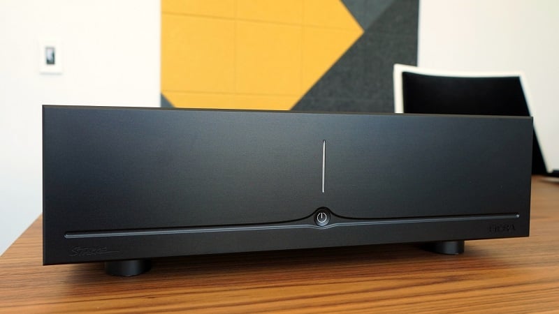

The Starke Sound Fiera4 is a new amplifier and a follow-on to the now retired AD4.320 amplifier. The Fiera4 is a good amplifier for its price. While there is some higher value competition, the overall performance is exceptional, build quality is excellent, and sound quality is good enough for a high-performance home theater. Currently this amp is on a labor day sale for $1,299 which raises its value. Read on to see why.
Fiera4
While you may see me pick some nits here and there I did not find any of these issues to be particularly audible. I recommend you consider the Fiera4 if you are in the market for such an amplifier.

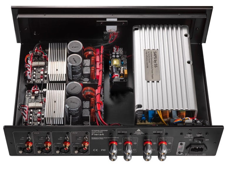

Fiera4 Interior
The Fiera4 is a new take on an old amplifier that was called the AD4.320. The new amplifier appears to be part of an expanding commitment by Starke Sound to Class D amplifiers. Where the old amplifier relied on a heavy linear power supply, the new amplifier uses a switching power supply. One of the biggest advantages of switching power supplies is the ability to have a universal power supply that works in any country. These supplies allow manufacturers to reduce their sku’s to just one instead of two power supplies (which may actually entail several various parts and sku’s). I have long been a fan of good switching supplies because they also allow you to create a “stiffer” power supply that sags less with load (though one net effect of that is that it may create a hard knee or cut-off at which the amplifier power supply simply shuts down from over-current). Switching supplies also often have much lower noise than linear supplies, with the ripple being many times lower. This is an enormous advantage in ultra-low noise amplifiers. Other noted upgrades include:

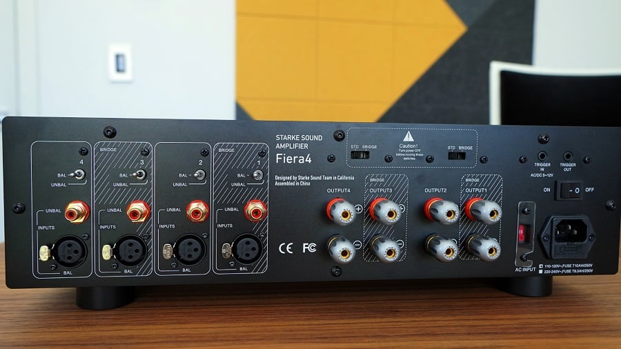

The amplifier contains both single ended and balanced inputs with a switch to choose between the two. Quality of the input jacks is excellent for this price point. The binding posts are a hallmark design of Starke, made of beryllium copper alloy, and again, are of excellent quality (I actually commented to Starke about how much I liked these binding posts). The amplifier is a standard three rack units tall or 5.5 inches, weighs a spritely 19lbs (which I love), and has an aluminum faceplate and backplate with steel chassis. While an aluminum chassis is a more luxurious option, it would have increased cost substantially, and at this price, steel is pretty common. Thermals seemed well controlled in the amplifier as I noticed no heat concerns while testing the amplifier.

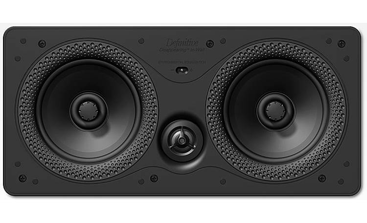

I used this amplifier to replace my Pioneer receiver powering my Definitive Technology DI6.5LCR in-wall speakers. There are five of these speakers in my family room as part of a 5.1.2 ATMOS system. I used three of the four channels to power my LCR speakers. I like to turn this system up, it’s a fun room to blast music and dance. I’ve noticed some compression and possible clipping in the past, at least when getting the volume up there. By adding the Starke, there was less compression, suggesting the receiver may have been part of the problem. While the Fiera4 doesn’t put out substantially more power than the Pioneer, the Fiera4 can take a huge load off the receiver and may provide over double the real-world power to each speaker. I haven’t had a lot of time to listen in this arrangement, but overall, I am impressed so far and plan to do the rest of my listening tests in this configuration.

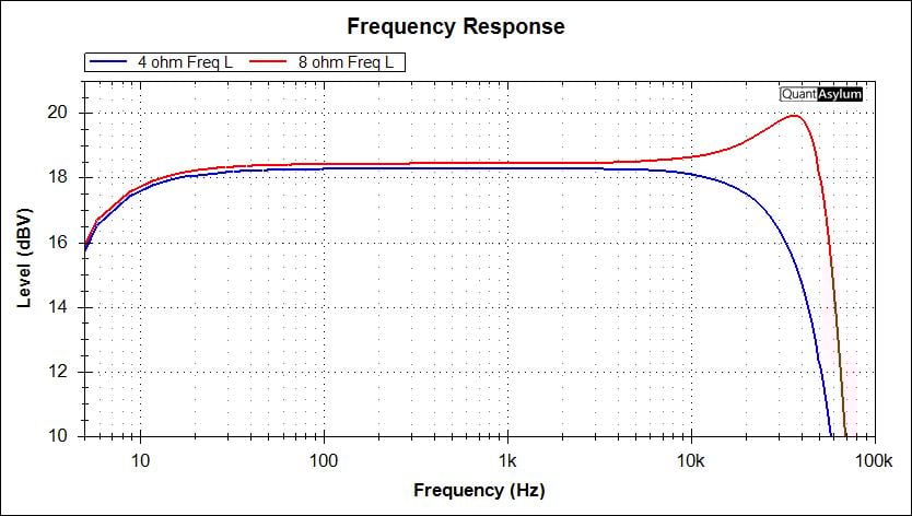

I measured gain as 21.4 dB with a balanced input and 27.4 dB with single-ended input. This gain was apparently chosen as a compromise between the 19-20dB of gain seen in professional amplifiers and the 26dB of gain seen in consumer gear. The advantages of a lower gain are not small, it does actually reduce the system noise by the same amount that gain has been lowered, so in this case, a system SINAD should now improve by 4.5 dB. It also becomes possible that consumer gear would struggle to drive this amplifier to maximum output. It took a 2.0-volt input to drive the amplifier to 108 watts output. As noted, the amplifier is capable of 130 watts. If your receiver cannot provide a clean 2.2+ volt output, you may not be able to drive this amplifier to clipping. In practice, we are talking about less than a 1dB difference in output.

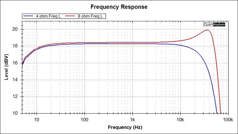

Frequency Response
Fiera4 Frequency Response 4_8
Fiera4 Frequency response at 8 and 4 ohms
First let me apologize for the scaling. It was not possible for me to rescale this around 0dB, given how I tested it. However, with a little mental math, you can see that we have a line that is hovering around 18.4dBV over most of the range. At 8 ohms, we see the frequency response increase around 10khz, hitting a peak at 35khz by +1.6dB. At 20khz, the rise is like half a dB or so. Just a note, the high-pass filter seen in my measurement is inherent in my measurement device. It is -1dB at something like 7-8hz, suggesting this amplifier is at least that good.

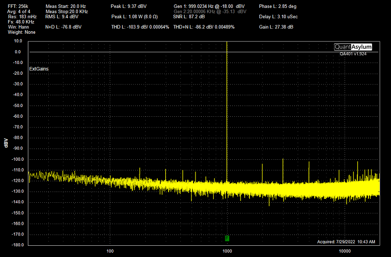

As you can see from the 1-watt FFT, it shows little signs of power supply noise. There are some spurs evident at 180hz, 290hz, etc. THD+N is .00489% or around -86.2dB. The Signal-to-noise ratio at this level is 87.2dB unweighted. This would come to a signal-to-noise ratio, unweighted, of 109.1dB at 130 watts RMS. A-weighting brought this up to 111.4 dB at full power. This is really decent noise performance.

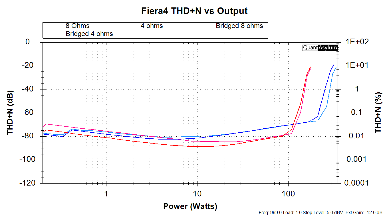

THD+N vs Output
 Fiera4_THDN Sweep 4_8 and Bridged
Fiera4 THD+N vs power sweep at 4, 8-ohm STD and Bridged
Looking at the THD+N sweeps, which show how THD+N changes with power level, we see the amplifier meets the power specs well. Note that the noise was elevated in this sweep below 10 watts because the Class D amplifier noise was preventing an automatic attenuator from engaging like it should have. You can see this in the 4-ohm measurement and bridged measurement at 4 ohms where it kicked in for a brief period and then kicked back off. This attenuation circuit allows for an accurate assessment of THD+N at low levels. This is a common issue with the Quantum Asylum and only affects measurements taken with the sweep. The main interpretation of this graph should really be to identify the point where clipping begins, shown as a knee in the response. The 8-ohm sweep shows a knee around 85 watts rms at .01% THD+N, it is around 158 watts RMS 8 ohms at 1% THD+N. This matches the spec of 130 watts RMS at .1% THD+N. At 4 ohms, we see the knee begin around 210 watts RMS at around .07% THD+N, and hits 250 watts RMS at 4 ohms at 1% THD+N.
I want to make a note on bridging. Here, the value of bridging is only in lower impedance loads. Into an 8-ohm load, this adds no meaningful boost in power and only adds noise. This is because the 8-ohm output is more voltage limited, not current limited. However, into four ohms we double the current and so now we see both a voltage and current limit issue, so the bridge feature seems to give about twenty-five watts more output. Still not meaningfully more, but into two ohms, which I did not test, we would likely see a more substantial increase in power. If you have speakers with a difficult load, it is possible that bridging channels is worth it. Otherwise, I do not recommend using that feature.

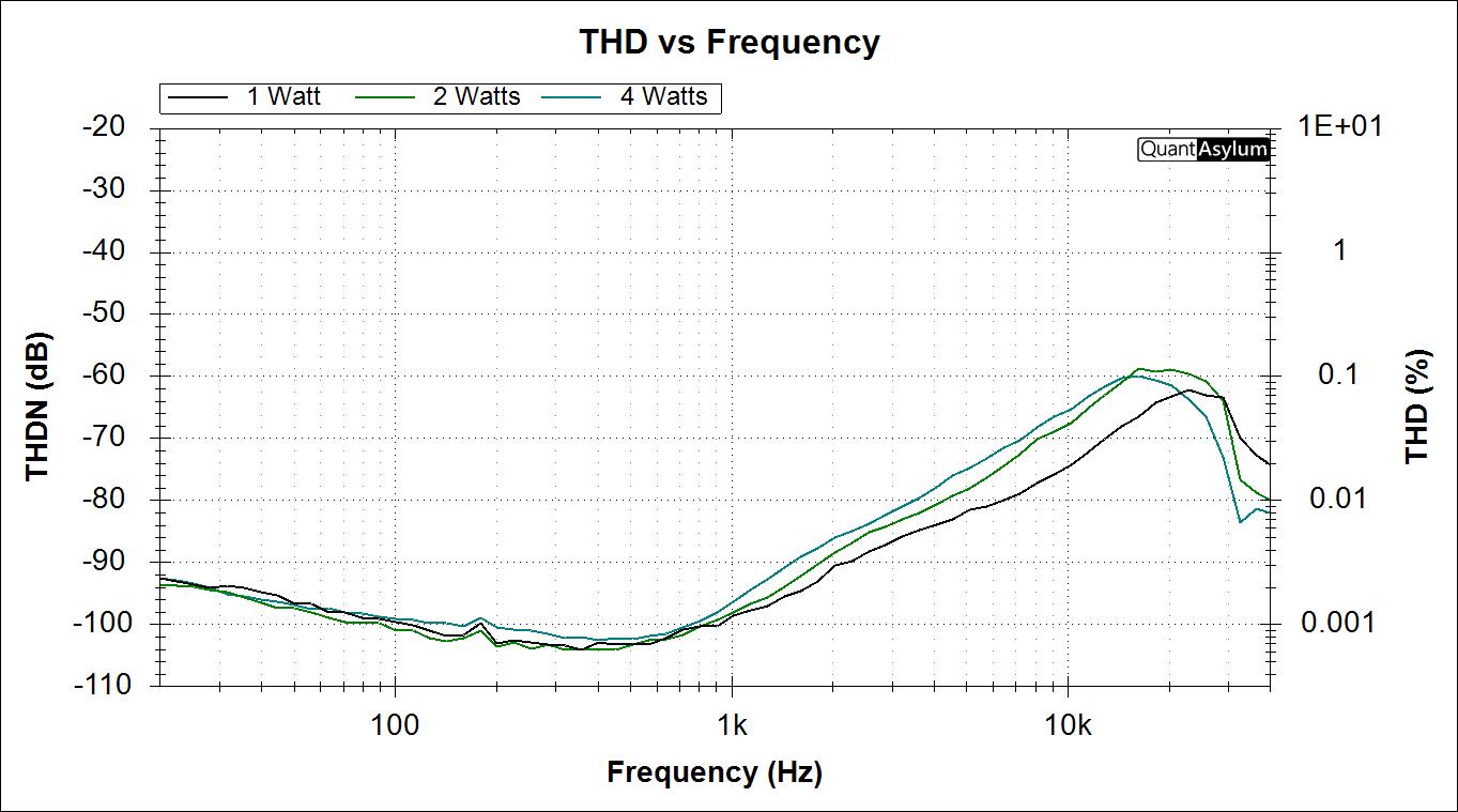

THD vs Frequency
Fiera4 THD vs Freq
Fiera4 THD vs Frequency (note the inaccurate THDN label, ignore)

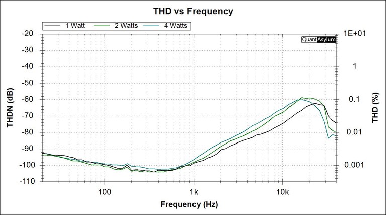

Because distortion is controlled by feedback in an error correction loop, the gain bandwidth product limits the range over which you can apply such correction. Modern Class D amplifiers are adding higher order feedback loops, but we see the best of these implementations more in amplifiers from Hypex and Purifi. As Bruno Putzey noted in a recent email exchange, we need to be careful how we use the feedback gain within the usable bandwidth. If we get 1dB of error correction at one frequency, we must have 1dB of error at another. Best to push that error up toward less or inaudible ranges. We also must remember that a harmonic at 10khz is 20khz, 30khz, 40khz, etc. Only one of those is audible and not very. By 20khz, we are talking about harmonics that are well outside the audible range. So, pushing the error outside the audible range makes sense, and it means we should look at how low distortion is within our more sensitive hearing range rather than worry too much about what is happening at or above 20khz. In my measurement, we see that distortion is around .001% between 100hz and 1khz, rising after that. By 5khz, we see that distortion has risen to .005% at 1 watt, but it is a higher .05% at 4 watts. By 20khz, we see distortion has risen dramatically to .1%. I only measured at 1, 2, and 4 watts to show how this rises with doubling in power. I cannot measure at higher power levels without triggering the attenuator, which would then cause noise of the QA401 to rise and make some aspects of this measurement inaccurate. Assuming this rise is linear until clipping, we can get a good sense of how distortion rises over frequency as power goes up. Now you are probably asking, is this satisfactory performance? It is ok, it is not terrible performance, but we know that better is possible. This behavior is consistent with the TI chipset that is being used and it is on par with what we would see from an Icepower or Pascal amplifier (at least in terms of shape, those offer lower absolute distortion levels). In fact, we have seen this same behavior on the best measuring Class D amplifiers, and while they may have lower absolute distortion levels, they still rise dramatically. Having picked this nit, it is unlikely this distortion is horrifically audible, or audible at all. This is a more academic problem than a meaningful sound quality issue. In fact, the engineer behind this amplifier, Dan Wiggins noted at the outset that his design choices were about ensuring an amplifier that sounds best in ways that matter for how it is used and listened to, not purely for academically perfect measurements. Mission accomplished. I would also wonder if the distortion of the speaker would still swamp the distortion of the amplifier here. While distortion rises to as high as .1%, we know a lot of tweeters would be at .5% THD or higher at those same frequencies. I was listening to these on a speaker that uses compression drivers which are known to have generally higher distortion than dome tweeters would have at these lower volume levels. A compression driver typically has around 1% THD at something like 90dB, but it will still be 1% at 100db or even 110dB. A dome tweeter might be as low as .1% THD at 90dB, but it would quickly rise by 100dB and could not even do 110dB. Which is all to say, as a reviewer and in trying to be fair and objective, I do not think this represents state of the art performance and I wish it performed better here. However, I also know why it performs like this and how many other amplifiers show comparable results. Being more realistic though, I also suspect this is not that audible. Those systems where this might be audible probably would also be more expensive and better suited to higher end amplifiers.
