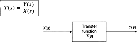

The Transfer Function by Matthew Poes
The transfer function of a piece of electronics fully encompasses everything coming out of that piece of electronics. Nothing can hide. If you look at the difference In the transfer function between a piece of equipment using two different cables and there is no difference in the transfer function, then nothing changed. If nothing changed, there cannot be an audible difference.
In other words, for a cable to make a difference, it must either change the signal or fail to change the signal (as compared to some base reference). If it changes the signal, it’s flawed. If it fails to change the signal, then a difference assumes the base reference cable used in testing is itself flawed. If there is no difference, there is no difference. Our ears are not needed to know if that is true.
While we know that cables have enough differences in their electrical properties to make very small differences in the transfer function (which we can argue about audibility all day), I have never seen evidence that audiophile cable companies are somehow providing superior measuring cables as compared to the best commercial stock used in professional settings (i.e. Belden and Mogami).

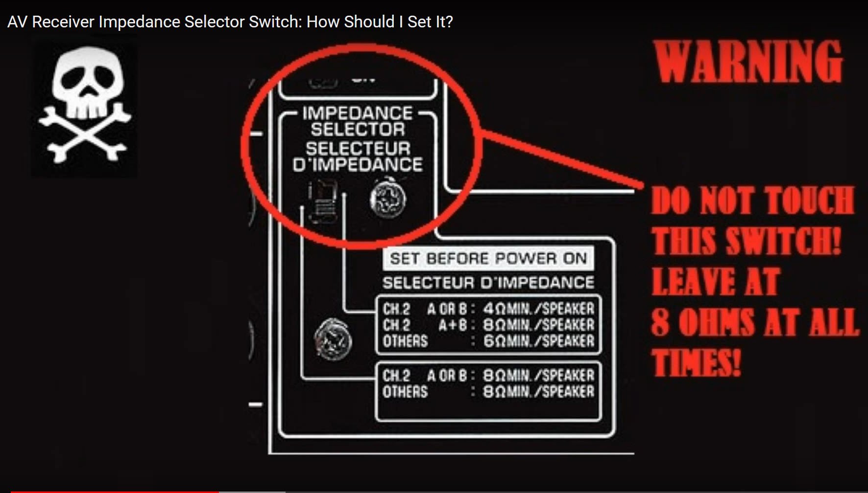

mind is some AV receivers not being able to drive 4-ohm difficult speaker
loads, due to insufficient current drive. However, even in those outlier cases
of inadequate current drive amplifier stages, no special cable is going to fix
that problem. If you want to drive a difficult speaker load, you will instead
need an amplifier with higher current capability. All of this is well known. No

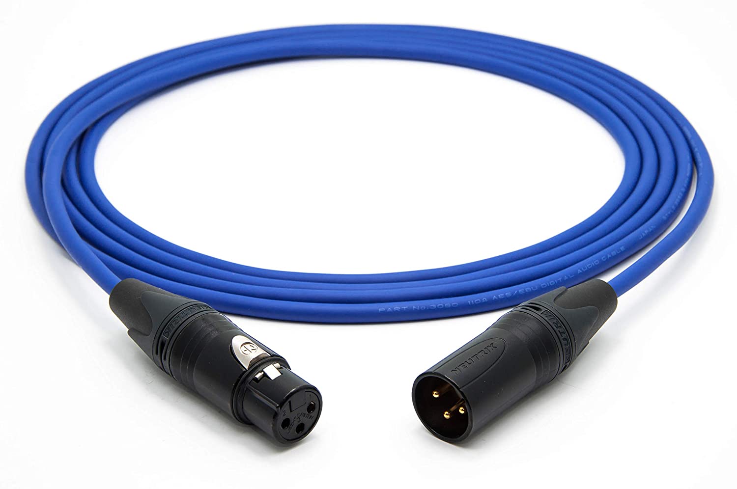

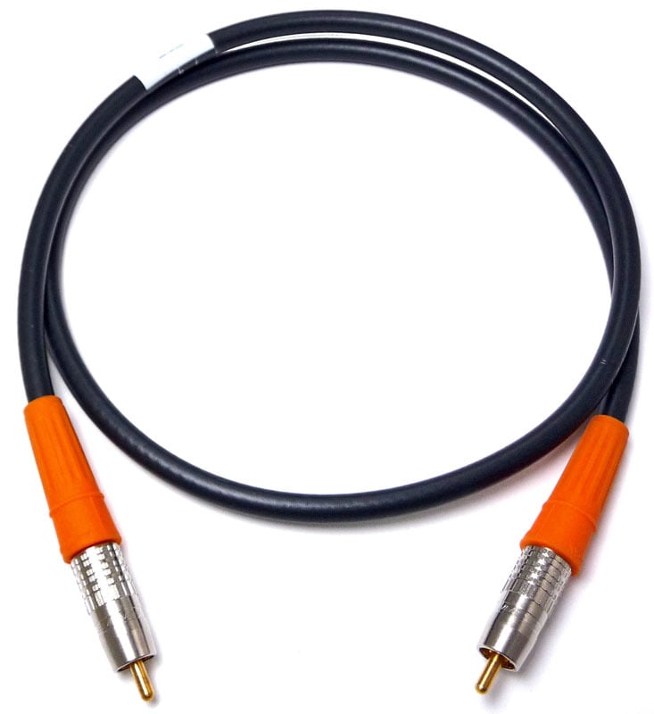

Cable science is well understood in every discipline of engineering, including audio. Audio frequencies (20Hz to 20kHz) are in fact the easiest to design cables to since we are dealing with a very limited bandwidth where cable characteristic impedance is not an issue and long lengths of cables work just fine if resistance is kept low for speaker cables and proper shielding and low capacitance is followed for long run analog interconnects. For digital audio interfaces a cable with the proper characteristic impedance (110 ohms for AES/EBU and 75 ohms for S/PDIF) is vital for long runs to prevent impedance mismatches and associated reflections which can cause errors and loss of data that the interface error correction may not be able to deal with. These are examples of industry standards for audio/digital interfaces and corresponding interconnects. Beyond adhering to these standards, "cable synergy" is not needed, nor desired for accurate signal transfer.
Mogami 110ohm AES (left); RG59 75ohm COAX (center); Belden 1694A 75ohm COAX (right)
An ideal analog audio cable should transmit the audio signal unadulterated. Nobody will argue the ideal cable is NO cable at all or a superconductor with no loss tangents. "Cable synergy" would imply the cable itself is NOT ideal. It's NOT transparent, it's not lossless Instead, it's acting as a tone control to alter the signal between connecting components. Why would any audiophile want this? Most audiophiles cringe at using tone controls on their preamps so why would they use them in the form of connective cabling? The best and most effective frequency shaping in a system is done in the digital domain with room correction below the room transaction frequency (300-500Hz) in concert with multi-sub and positional EQ and with passive room treatments above the room transition frequency to control excessive reflections. With audio interconnects and speaker cables, we are at best looking at 10ths of a dB change out to the frequency extremes between good and super-conductor good cabling which is below the threshold of audibility for anyone but Kryptonian hearing.

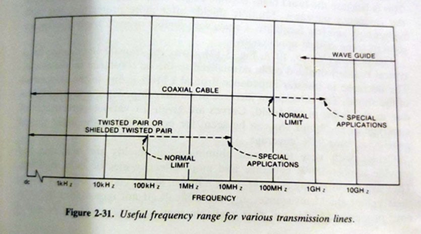

Useful Frequency Range for Various Cables per Noise Reduction Techniques in Electrical Systems, Henry Ott

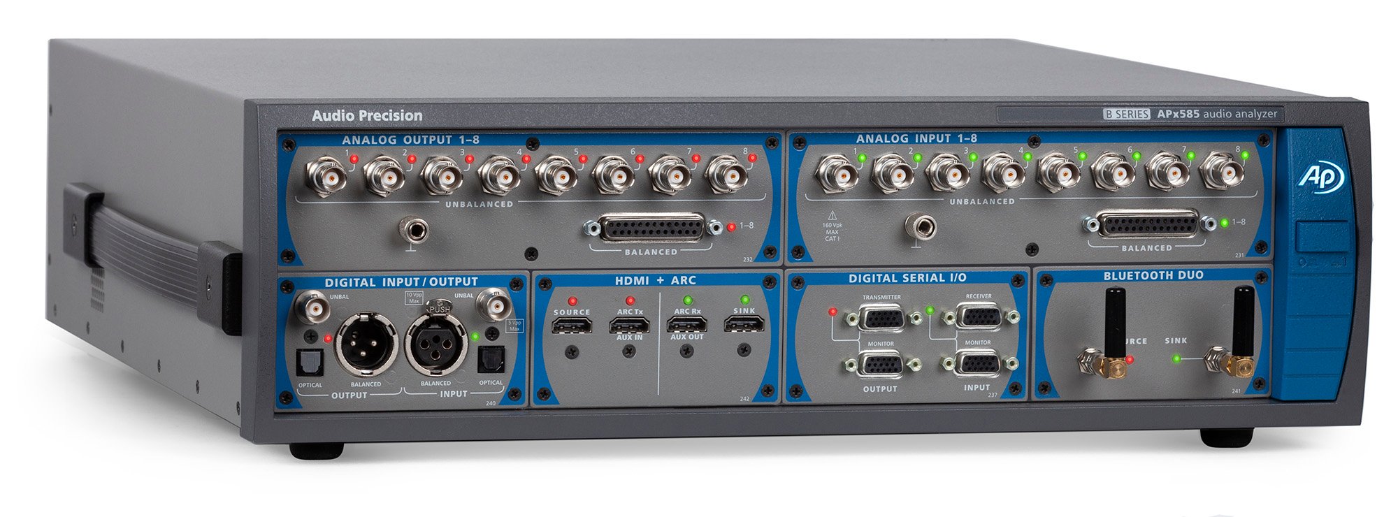

Editorial Note About Audio Precision Test Cables:
Audio Precision stresses the importance of using quality cables to ensure noise free measurements. However, they define a "high quality" cable as being properly constructed per common engineering standard (ie. shielded coax with proper characteristic impedance). They mention that one of their cables is based on Mogami cable stock. There is NOTHING magical about Mogami cables. They are just well engineered cables often used in recording studios.

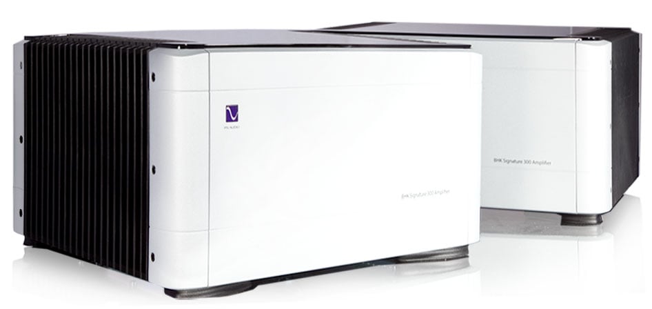

PS Audio BHK 300 Monoblock Amplifiers (MSRP: $14,998)
PS Audio: Thanks for writing, and while I know AudioQuest does much high-level testing of their gear (and I cannot offer specifics there, with apologies) yes it is the case that our most profound and valuable test is our ears. Here are a few words from Paul regarding synergy, curation, and value. I hope it helps!

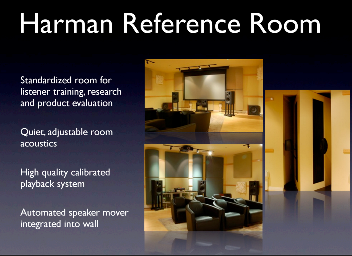

The Science of Sound & Controlled Listening Tests
Dr. Floyd Toole and Dr. Sean Olive lead pioneering research at Harman regarding the science of predicting subjective listening test preferences based on how loudspeakers measured. In their research, they found the best way to control biases was to conduct Double Blind Testing as sighted tests tended to bias the outcomes based on appearances, expectations, or brand recognition by even the most disciplined listeners. I've always argued that the rigor of a true DBT is only needed when the sonic differences between two or more stimulus are small, however, Floyd and Sean have proven otherwise in their peer reviewed AES contributions and I acquiesce as my "feelings" don't meet the rigor of their peer reviewed research. In fact, because our auditory memory is so short, just 200-300ms, and because many commonly used DBT methods, like ABX, do not prime the subject to the specific differences, their sensitivity to change are low among sensory testing methods. Considering that the sonic differences between cables is at best case minuscule and at worst case, nonexistent, the need for a controlled DBT to discern differences is indisputable. A controlled DBT is the only way to eliminate the human biases and to better discern small differences in stimuli without introducing the placebo effect where a listener is expecting to hear a difference. These methods must be as rigorous and controlled as possible, eliminating any source of extraneous variance. Fast A/B comparisons are also necessary to remove auditory memory limitations. But, most cable comparisons are almost never conducted in this manner. Instead, they are often compared sighted infused with hyperbole of what you "should hear" before the comparison is actually conducted. This is called preconditioning the listener and it's a successful sales tactic when executed by a skillful practitioner. Further, they often argue that long listening tests are needed to fully appreciate the differences. In fact, what this does is confuse the listener with too much novel information. Auditory memory is too short to be able to sort these differences in a reliable manner.
One cannot declare "synergy" simply by trusting their ears as the primary test metric especially if the listening test is NOT done with any scientific rigor to eliminate biases. With that said, how can an audiophile sleep at night knowing that a company achieved the "best synergy" with their products by testing only one brand of cable? What if there was a better brand offering "better synergy"?
