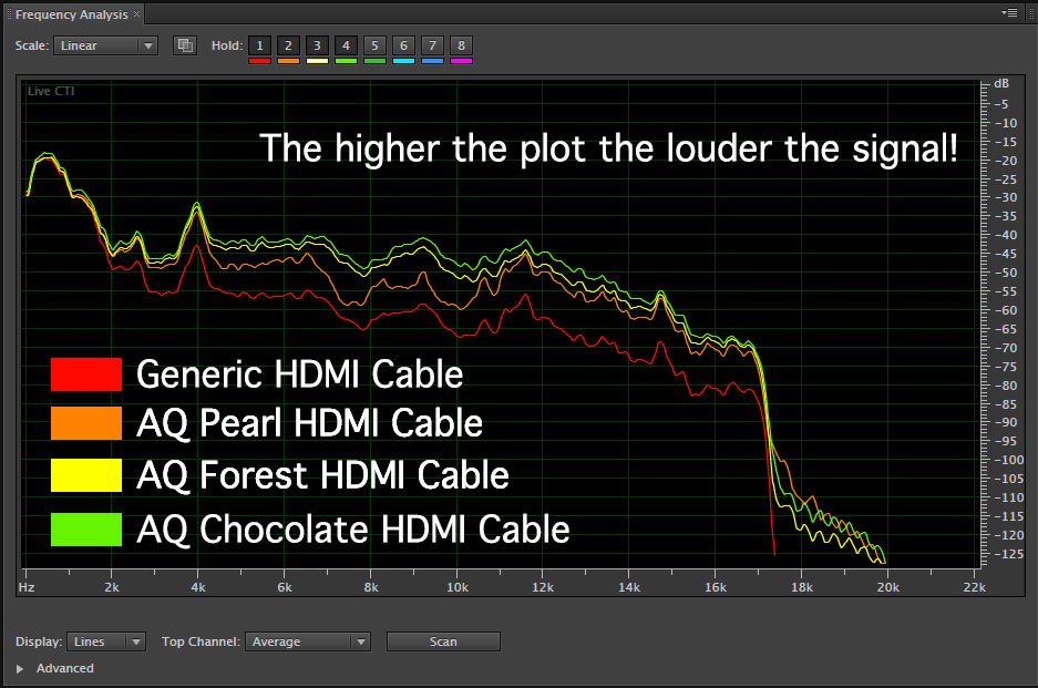

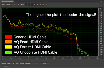

Let's start with a summary of events.  Mark Waldrep, aka Dr. AIX, is the company founder and Chief Engineer of AIX Records and one of the leading advocates for true HD-Audio.  He recently came across a YouTube video, hosted by Home Entertainment by D-Tronics and featuring AudioQuest Regional Sales Manager David Ellington, which purported to show the audible difference of replacing a generic HDMI cable with AudioQuest Pearl, Forest, and Chocolate HDMI cables by playing a sound clip recorded through each cable.  Mark measured the sound clips from the YouTube video, which you can see in his blog post.
The measurements were subsequently confirmed by user "amirm" in this forum post.
Each successive AudioQuest cable was louder by several dB and toned-shaped in a way that simply couldn't have come from switching cables alone, implying purposeful manipulation with the intent of convincing customers to buy a cable that did not do what it was advertised to do.

It's important to note that HDMI cables transmit digital signals, NOT an analog waveform.  This means the cable either works or doesn't.  There is NO scientific proof that an HDMI cable can alter the sound of the signal being transmitted.  Good cables pass the entire signal uneventful.  Bad cables will either cause an interruption in audio (aka. audio drop out, or a snowy picture).  We covered this in great detail in our detailed article: The Truth vs Hype in HDMI Cables and related YouTube Video embedded within the article.  As a result, we place very little credibility in manufacturers that claim otherwise and you should as well if your goal is pursuing the truth in audio and video NOT deceptive marketing practices.
unless an HDMI cable is damaged there will be NO audible  difference

Audioquest HDMI levels vs frequency
Figure 1 – The spectra of the tune played in the AudioQuest promotional video on YouTube courtesy of realhd-audio.com
Note: it's impossible for an HDMI cable alone to cause a level shift in signal.

William Low has also made subsequent posts in the comments section on a Stereophile page republishing the open letter under the username "WELquest".  He acknowledges that the advertising is fraudulent, but re-asserts, "neither David nor AudioQuest had any part in the decision to make a video, or in the production of the video."  He also states that, "because in person, the cable differences are subjectively obvious, the very surprising video, while seeming dubious, did not seem completely implausible."  Again, the audio clips in the video had differences of 8dB between the generic and "Chocolate" cables between 4kHz-17kHz according to Mark Weldrep's measurements.  Again we must reiterate an HDMI cable alone CANNOT be responsible for a level difference!
