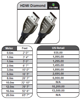

We completely understand why we get this question so often. There are a lot of choices on the market, and a lot of marketing hype. Just checkout the image below, you are paying anywhere from about $400 to $240 dollars per foot! On a side note, that's not anywhere near as much as the WEL Signature speaker cable from Audioquest, which is $3,800 per foot!!
I was going to buy a new car, but I bought an HDMI cable instead.

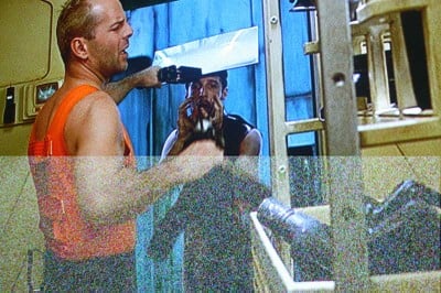

When a cable carries the signal properly, you are getting all the information. There is no hidden, better signal to be wrung out with a cable that costs as much as a used car. This is undisputable science. If an HDMI cable isn’t working properly, the consequences will be obvious, bordering on terrible. You may see sparkles, frozen portions of the picture, and get intermittent dropouts.

This is what a bad HDMI cable looks like. Pretty obvious, isn't it?

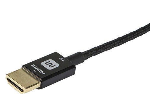

they’ve brought some interesting technology from RedMere to the market. When I needed a 50’ HDMI run, I chose a
RedMere cable from Monoprice. Redmere
is an active technology that uses power from the HDMI port to transmit signals
over distance using much thinner cables.
With a traditional cable, I may have needed to use something with 22
gauge conductors. In other words, a
thick, heavy cable that would be difficult to bend around tight corners and
could put a lot of strain on the HDMI port of my projector. My 50’ RedMere
cable used thinner, 28 gauge wire making the whole cable thinner, lighter, and
easier to bend around corners, which is great when you’re crawling around a hot
attic with fiberglass in your ears.
