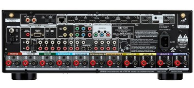

On the video side, it supports the latest technologies and offers eight HDMI inputs and three outputs that support 4K Ultra HD 60Hz video, High Dynamic Range (HDR10), Dolby Vision, Hybrid Log-Gamma (HLG) 4:4:4 Pure Color sub sampling, and BT.2020 pass-through. The new AVR also boasts HDCP 2.3—the latest copy protection standard—on all HDMI ports, which allows users to enjoy copy-protected content uninhibited. Incorporating eARC (Enhanced Audio Return Channel) which ensure you have the latest performance and connectivity options for the future. The AVR-X3600H also supports the transmission of immersive audio from TV apps to the AVR with a single HDMI cable for simple setup. Certified by the Imaging Science Foundation, the AVR features a full suite of video calibration controls (for use by an ISF technician), along with ISF Day and ISF Night video modes.

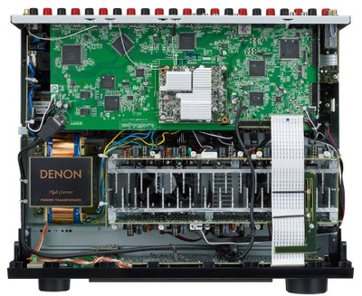

Power and Expandability
The AVR features 9 channel amplification and is also capable of processing up to 11.2 channels to drive a 7.2.4 speaker setup when used alongside external 2-channel amplification. It looks like the power supply of the X3500H and X3600H models are identical between both units, but Denon did beef up the heat sink area and added a cooling fan to accommodate the extra two channels of internal amplification. The power is still shared off the same size power supply but the overall power consumption rating on the back has gone up slightly from 600 watts to 660 watts.

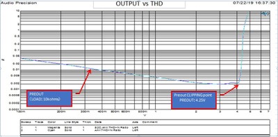

With the AVR-X3600H configured to reroute the main front L/R internal amplifiers, the preamp is physically disconnected from the power amp. This allows the preamp stage full capability of delivering up to 4Vrms unclipped when connected to external amplification as can be seen in the following output vs distortion plot courtesy of Sound United Engineering.
Editorial Note about Front L/R Channels Preamp Disconnect
Front L/R channel preamp disconnect ONLY happens in a 11CH speaker configuration. If you have simply 9.1 channel configuration (5.1.4) or less, and you want to drive front L/R speakers out of external amplifier, or L/R/C, or L/R/C/SL/SR speakers out of external 5 channel amplifiers, internal amplifiers will not be disconnected.  There is no selecting or sensing mechanism to allow that unless you activate 11.1 channel Amp Assign mode and select Front L and R for preouts.
Denon 3600 preout voltage
Denon AVR-X3600H Preamp Output Voltage vs Distortion
