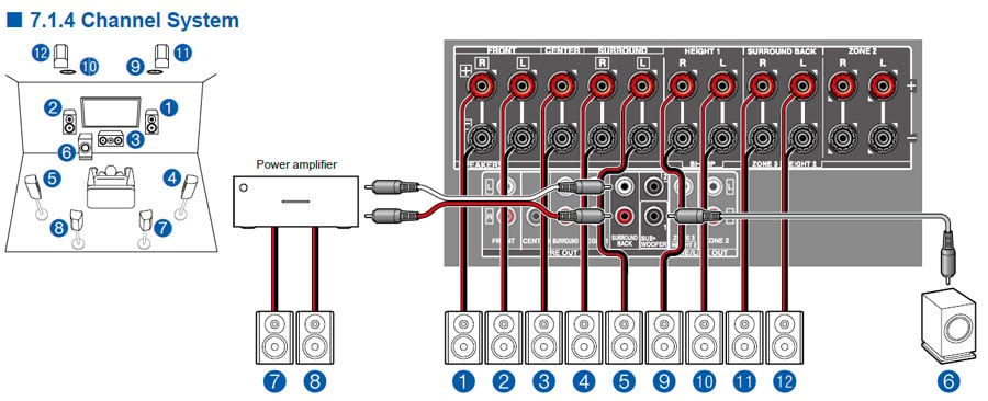

- 11.2CH pre-outs so it supports 7.1.4 with external amplification for Atmos, DTS:X

- Great Preamp section for using external amplification
- 11 channels of processing for 7.1.4 speaker configuration

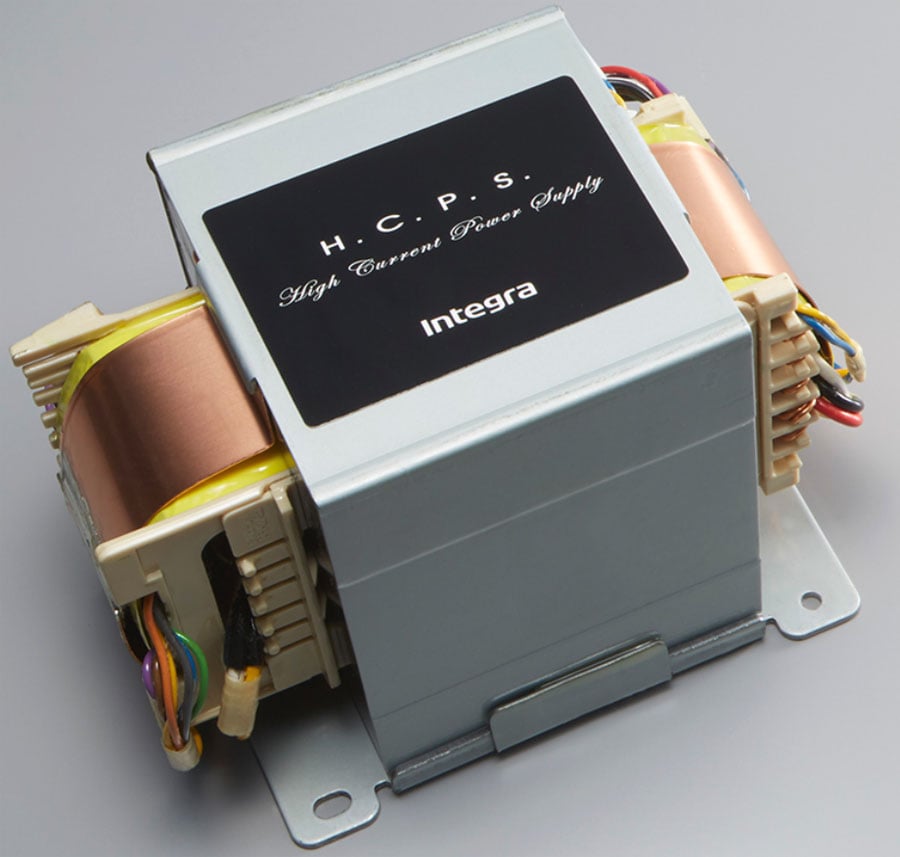

The DRX-4.3 is rated for 100wpc (2CH driven) across all 9 amplified channels with the ability to expand to 11 channels of processing via an external 2CH amplifier. The amplification section is traditional Class AB with a linear power supply and 2 very large fans flanking the rather smallish heatsinks. That's a lot of transistors to cram into a single heatsink like this, which is common these days for Dolby Atmos / DTS:X AV receivers. Realize just a few years ago, these same-sized products had only 7 internal amplifiers. Now receiver companies are cramming 9, 11 and up to 13 channels into similar-sized products. If you were planning on running a 7.1.4 speaker configuration using this AVR, you'd have to add an external 2CH amplifier to power the surround back channels. Unfortunately, you can't reassign the front channels to the surround backs so if you want more power to the fronts, I'd recommend getting a 5CH amplifier to power the front LCR's and surround back channels. This is an especially good recommendation IF you're running 4 ohm speakers for the front soundstage to take some of the pressure off this workhorse.

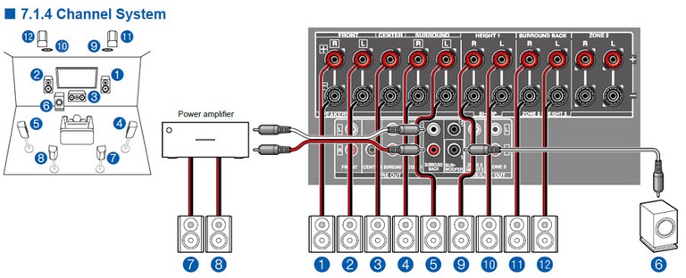

5CH Amplifier Recommendations: Outlaw Model 5000, Monolith 5X
Preout for Surround Back to run full 7.1.4 Speaker Configuration
$1,400 is a big chunk of change to throw down on an AV receiver and quite frankly, in this price class, sister companies to Integra offer more brawn than the DRX-4.3 via the Onkyo TX-RZ830 (currently on sale for $549) and for a little less money, the Pioneer VSX-LX504. However, the Pioneer and Onkyo units have fewer integration features, such as three 12v trigger outputs and multiple IR inputs. Is the DRX-4.2 or DRX-4.3 worth their price of admission? Read the review to find out.

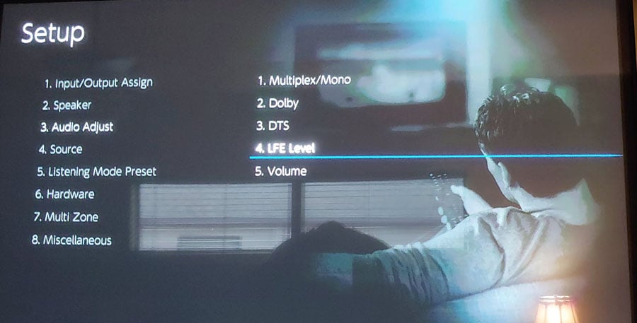

Integra Setup
I haven't looked at an Onkyo/Integra OSD in probably 10
years and I have to say I really liked the interface a lot. It was basic, yet
very functional and intuitive to use. I literally found everything I was
looking for in the initial setup without having to hunt down into the sub
menus.

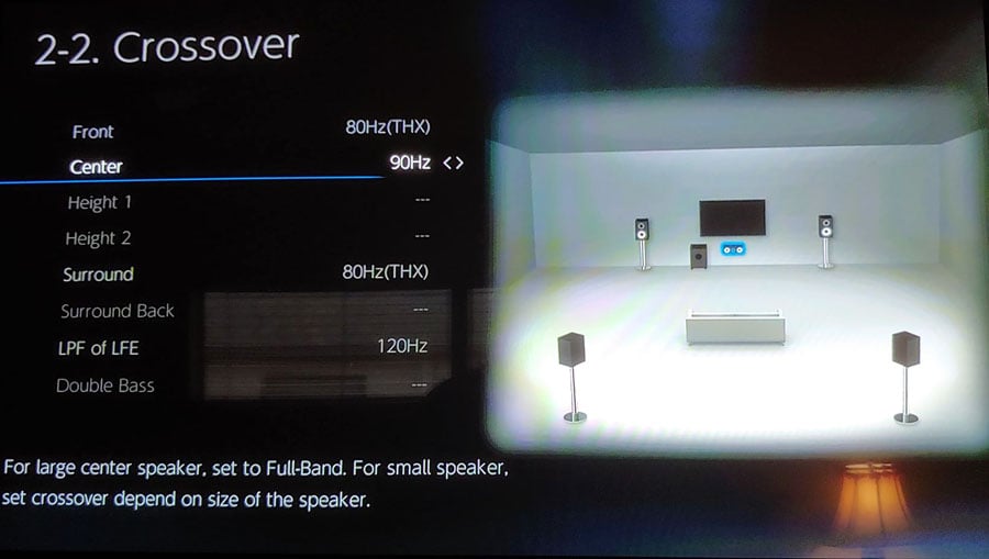

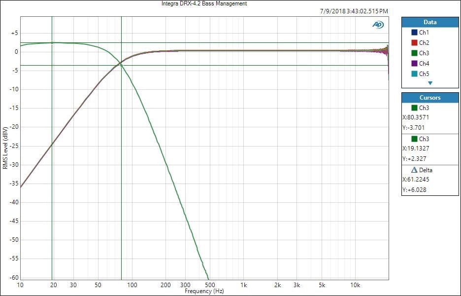

One thing that really impressed me about the DRX-4.3 is its comprehensive bass management and speaker configuration options. Each speaker group can have independent crossover settings and if you set the mains to "small," ALL other speaker groups default to "small," which is how it should be. Channel trims were adjustable in .5dB increments, distance in .1ft step size, and Integra included LFE crossover adjustment and level control, something some competitors like Yamaha completely dropped from their AVR's. Having LFE level control is really useful to tone down the LFE effects on bass heavy Blu-ray or DVD mixes without having to actually turn the sub level control down. In most cases, we recommend setting the LFE crossover to 120Hz to NOT truncate any bass the producer intended to go to the .1 channel from multi-channel mixes. The only thing I wasn't crazy about during manual setup was that the test tone generator cannot be lowered via the master volume control. It just turns on in BLAST mode, which depending on your room size and speaker sensitivity can be quite loud and uncomfortable. I typically like to see the ability to adjust master volume level with all trims initially set to 0dB. Then, I adjust the master until the mains read 75dB at my primary listening position and calibrate the rest of the channels to that reference with the subs boosted a few dB of course.
Integra DRX-4.3 Bass Management Setup

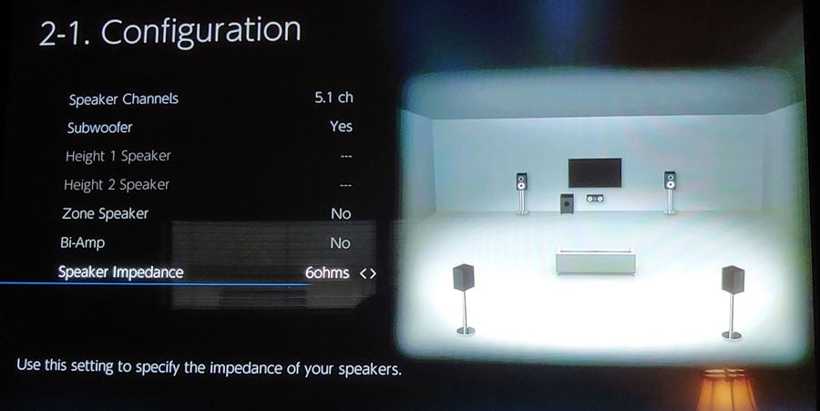

Impedance Switch - Leave it Alone!
Like most AV receivers these days, two of the nine internal amplifiers can be reconfigured for bi-amping the front channels if your speakers are bi-amp capable. I don't recommend using this feature since the power supply isn't big enough for your speakers to really benefit from it, especially if you're running the internal amps to power the other channels simultaneously. Integra included the dreaded impedance switch in the configuration menu and we highly recommend leaving it on the default 6-ohm setting regardless of actual speaker impedance. Setting it the 4-ohm setting will significantly drop the available output power of the receiver, as you will later see in our test report. It's only there for one purpose: to clip the amp sooner so it will generate less heat by being tested at a lower power level for 4-ohm UL certification purposes. This receiver has two giant fans and lots of nanny controls already built-in aside from the impedance switch. Don't further choke the power by enabling the low setting of this "feature."
Integra DRX-4.3 Configuration Menu

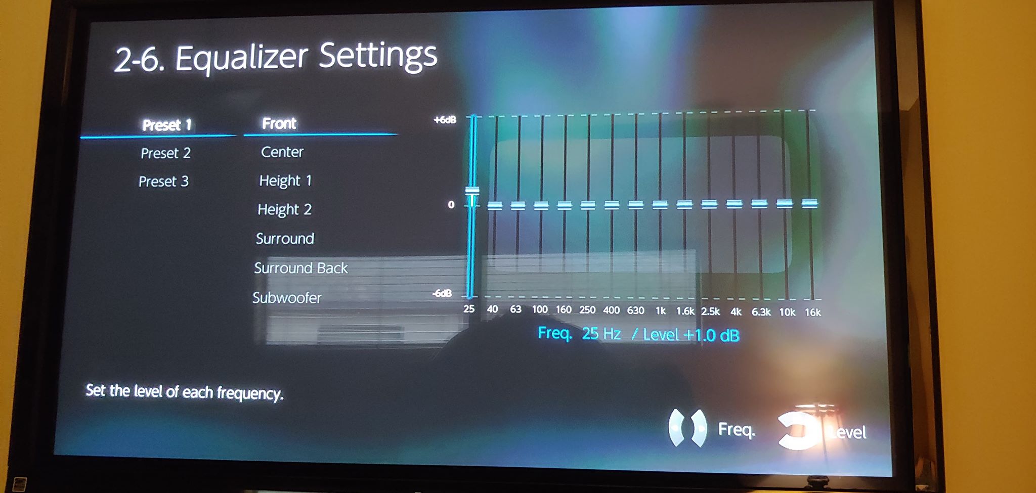

Integra DRX.4.2 GEQ
I continue to scold Denon for including manual GEQ's in their AVR's instead of a PEQ, so it looks like I must do the same now with Integra. This is just such a waste of a potentially great manual calibration tool. A much more useful approach which would especially help for bass calibration and tuning would be to replace this with a PEQ to allow for adjustable frequencies and bandwidth. At least Integra gives you GEQ down to 25Hz compared to Denon's lowest adjustment of 63Hz. I did find the 25Hz and 40Hz adjustments somewhat helpful in tuning my subwoofers in my configuration.

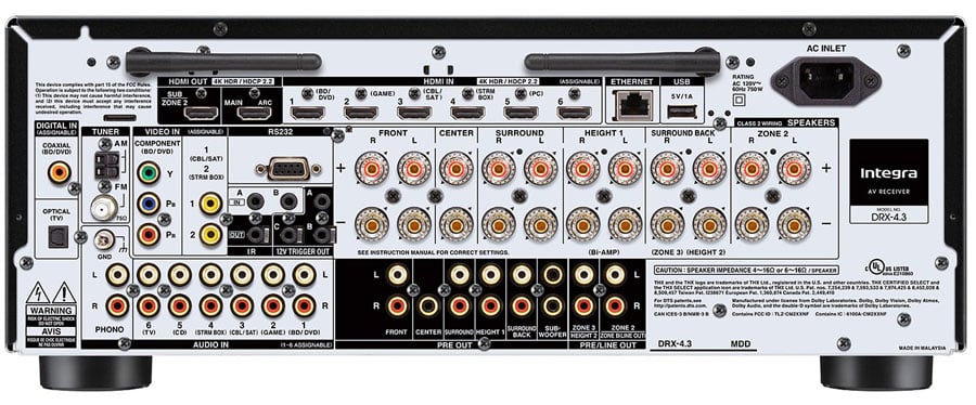

Integra DRX-4.3 Backpanel - note wireless inclusion replaces HDBaseT
The white background really does make the silkscreening easier to read compared to black of the predecessor model, another nod to the brand’s commitment to helping installers in the field. The Integra DRX-4.3 has 9-channels of built in amplification (with 5-way binding posts) but 11.2 channels of processing, which is great for those wanting to expand their systems to a full 7.1.4 speaker configuration. For such installs, I'd recommend getting a meaty 5CH amplifier from Outlaw or Monoprice to use for the front LCR channels and surround backs and let the Integra power the rest. The DRX-4.3 has two subwoofer outputs but they are unfortunately parallel connected and don't offer independent channel trim and delay settings. This receiver has 7 HDMI inputs (front HDMI limited resolution) and 2 outputs while the DRX-4.2 also comes with HDBaseT connectivity, which is a unique feature to some Integra AVR products. Legacy component and composite video cable is still supported which is nice since we are seeing these connections disappearing on most products these days.

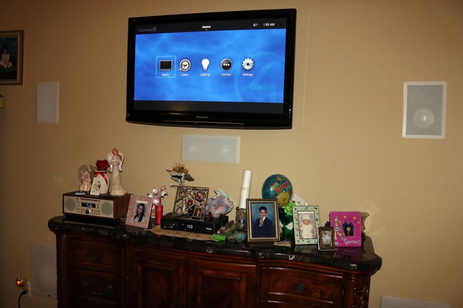

As I indicated earlier, my AV equipment for my bedroom
system is located in my theater room upstairs. Up until I installed the DRX-4.3,
I had my Marantz UD7007 Blu-ray player located in the bedroom with a direct
HDMI connection to my Panasonic 42" THX Plasma display with coax going
upstairs to my AV receiver which was limited to 5.1 Dolby Digital and DTS.
Replacing my old but trusty Marantz SR6004 AV receiver was tough for me but I
wanted to modernize my connections. The Integra DRX-4.2 allowed for this by
converting my HDMI sources to Ethernet via the internally built in HDBaseT

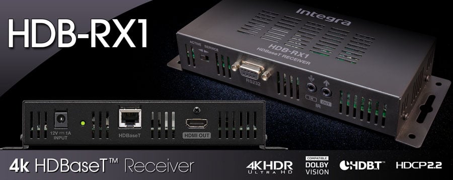

transmitter. A single Cat 5e Ethernet
cable run through my drywall between both rooms allowed me to terminate to the
Integra HDB-RX1 HDBaseT receiver ($400), which is certified to transmit
4K/60p/4:4:4 video at full 18Gb per second to your display. Most inexpensive
HDBaseT systems are limited to 10.2GB per second so it was nice to see Integra
didn't cut corners here. In fact, they claim this is one of the first products
to support 18.2GBs.
I only tested HDBaseT at 1080p resolution since that was the maximum resolution of my Plasma display. Over a period of a few months, I had my Amazon FireStick, Marantz UD7007 Blu-ray and FIOS DVR connected to the Integra DRX-4.3 and I'm happy to report the HDBaseT connection to my display was flawless. I never experienced video dropouts or loss of resolution. This is a pretty bulletproof solution for anyone not able to run an HDMI cable between their AVR and display device. This device allowed me to place my source devices back into the same room as the AVR while also allowing me to now enjoy high-resolution audio on my Blu-rays since I had a direct HDMI connection between my Blu-ray player and receiver instead of using coax like I was using on my older receiver.

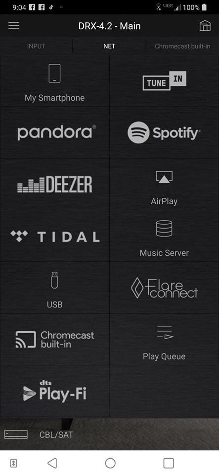

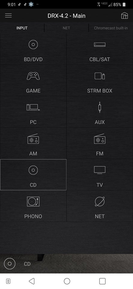

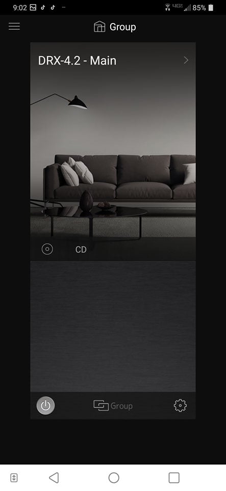

Streaming & App Control
Integra Control Pro App
The Integra DRX-4.2 and DRX-4.3 have too many features for me to cover completely in this review. However, it's worth noting that both models employ a very high-quality DAC section from AKM (AK4458) and supports virtually every hi-resolution and lossless format including: 2.8 or 5.6 MHz DSD, as well as gapless playback of FLAC, WAV, ALAC and WMA files. It has Chromecast Built-In with Google assist and Apple Airplay 2 support is coming via a firmware update. With Amazon Music, Spotify, Pandora, Deezer and TuneIn built-in, you can select a station and search for music available on these services via the Integra Control Pro & Integra Music Control app (for Amazon Music) on your phone. The free apps puts a range of streaming options at your fingertips, from universal hi-res audio via network-attached devices to internet streaming services to music on your smartphone and tablet. It even has Works with Sonos so once the receiver is connected to Sonos Connect, any music or source can be sent from the Sonos app to it.

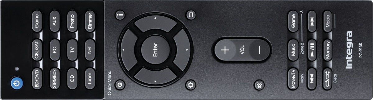

The only negative feature I'd gripe about is the rather Spartan remote Integra ships with this receiver. However, this is somewhat remedied by using the free App control, which gives you streaming, source selection, audio adjustability and volume control of the receiver from anywhere in the house as long as it's configured on your network. The App does offer almost complete control of the receiver including source selection, audio adjustability and most importantly access to the OSD on your display to navigate through the onscreen setup menu. This is useful if the AVR is located in a remote area from your TV where IR signals won’t reach. One feature that is often buried on Atmos AV receivers is the option of turning on/off center spread when using the DSU to upmix 2CH sources. This can be done using the Quick Menu button, then scrolling down a bit into the options for those that care to fiddle with this.

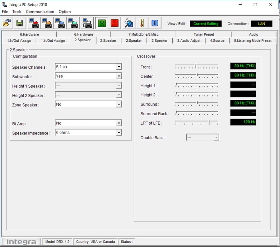

Custom Installers will appreciate the PC Setup app which is currently designated for dealers only, but Integra is working on hosting it for consumer use in the future.
Integra PC Setup App
Once you have the App installed on your PC, you simply enter the IP address of your Integra receiver and load it up. The setup features are extensive and allow you to tweak everything in the AVR, including EQ, speaker settings, audio settings including EQ, the ability to turn center spread on/off for the DSU, etc. I have two minor gripes, one being the tabs being poorly labeled (ie. 4 2. Speaker tabs that should be better labeled to reflect what they are for such as speaker level, bass management, THX settings, etc) and the other being the interface is sometimes slow and unresponsive. Regardless, it's still a very useful setup tool especially if your AVR is in a different room than the speakers and display it is connected to.

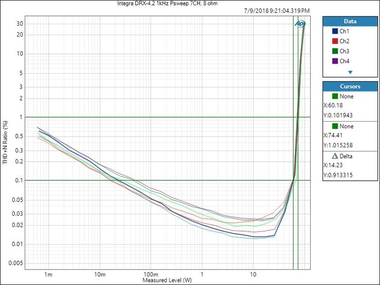

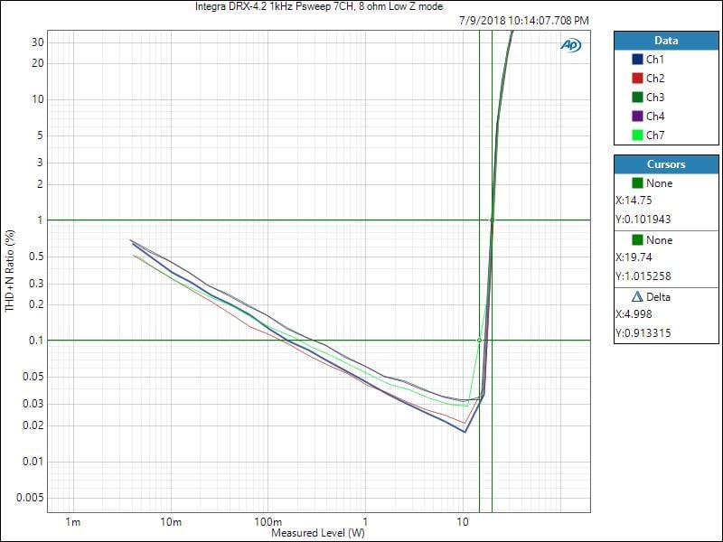

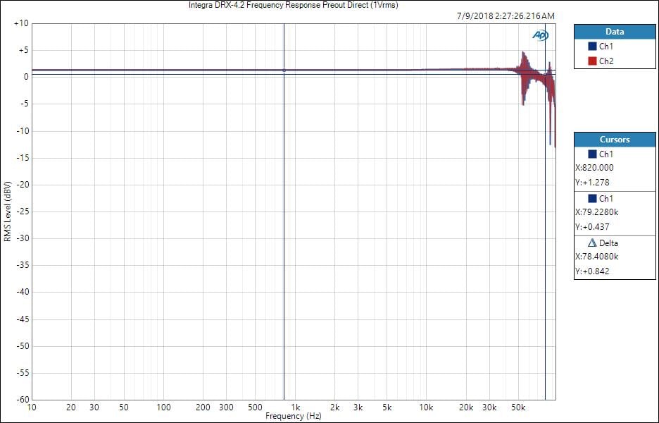

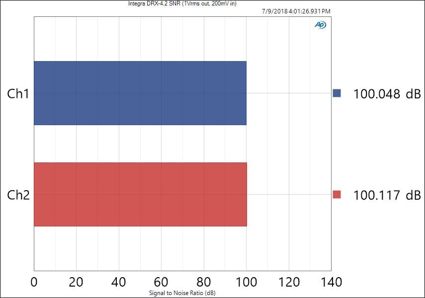

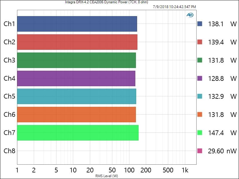

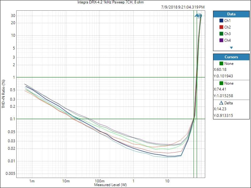

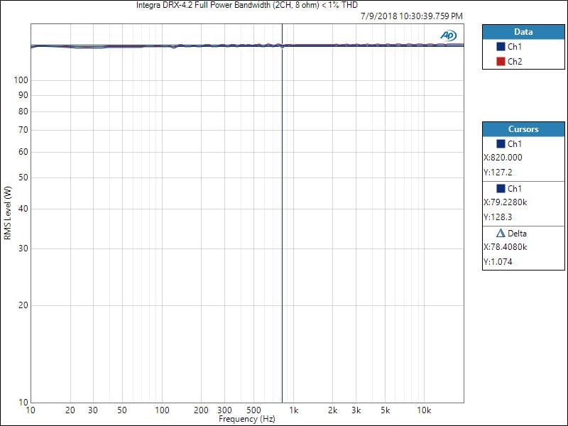

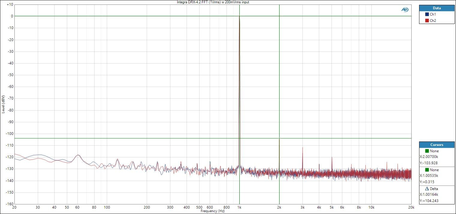

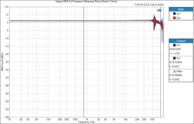

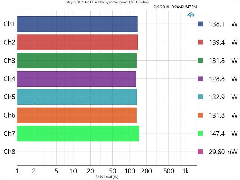

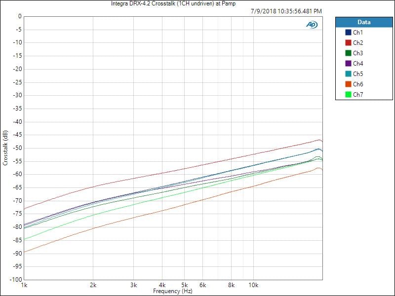

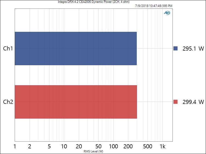

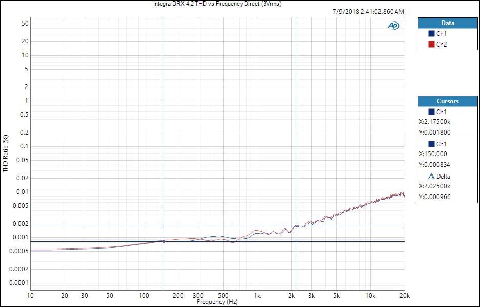

Integra DRX-4.3 Measurement & Analysis
All measurements were conducted using our Audio Precision APx585 8 Channel HDMI Audio Analyzer. The Integra DRX-4.3 was defaulted to high impedance mode (8-ohms or more).
For more information about how we measure power amplifiers, please see:
Basic
Amplifier Measurement Techniques
Integra DRX-4.2 Bench Test YouTube Report
Integra DRX-4.3 Preamplifier Measurements

At 1Vrms output, the FFT of the DRX-4.3 was very good when driven with an analog input signal as indicated by the 2nd order harmonic being 104dB below the fundamental. This was about 5 dB worse when driven with an HDMI signal at the same output level however.
Integra DRX-4.2 Preamp Out FFT Distortion Analysis @ 1Vrms
Integra DRX-4.2 Frequency Response - Pure Direct
Direct mode produced a flat frequency response within the audio band 20Hz-20kHz with a CH-CH deviation of +-0.13dB. The -3dB point out was out to about 78kHz and I noticed some peculiar ringing above 50Khz that even the folks at Integra were puzzled by.
Integra DRX-4.3 THD vs Frequency Response - Pure Direct
The Integra DRX-4.3 has very low distortion via the analog outputs even when driven to 3Vrms it was less than .01% THD+N. This receiver has all of the right ingredients to be used as a dedicated pre/pro if you choose to add external amplification.
Integra DRX-4.3 Bass Management Frequency Response
Bass management was excellent on the Integra DRX-4.3 with perfect slopes and cutoff frequencies specified by THX certified products. I set the HPF and LPF's to 80Hz and measured the -6dB point of the LPF to be 80Hz with a 24 dB/oct slope and -3dB of the HPF to be 80Hz with a slope of 12 dB/oct. The only anomaly I found in speaker setup on the bench was the SBL and SBR were slightly out of phase with the other channels so I had to add 0.1ft distance to compensate for preouts and 0.4ft distance if DSP was engaged. I've never seen this behavior before in an AVR so I'm not really sure of the cause but it's a fairly minor point of concern.
Integra DRX-4.3 Signal to Noise Ratio (1Vrms) - Pure Direct
The DRX-4.3 preamp output exhibited a very low noise floor (92dB unweighted, 100dB A-wt) with 200mVrms input drive and 1Vrms out. This is excellent.

Integra DRX-4.3 CFP-BW (2CH) Power Test - 8 ohms
With two-channels driven, the 100 watt/ch rated DRX-4.3 delivered 128 watts/ch for full bandwidth 20Hz to 20kHz at < 1% THD into 8-ohms.
Integra DRX-4.3 1kHz ACD (7CH) Power Test - 8 ohms
The DRX-4.3 was able to output 74 watts/ch at 1% THD and 60 watts/ch at 0.1% THD with 7CH driven. This is pretty respectable for a moderately priced AV receiver.
Integra DRX-4.3 Dynamic (7CH) Power Test - 8 ohms
Integra DRX-4.3 Dynamic (2CH) Power Test - 4 ohms
The DRX-4.3 performed well for CEA 2006 short dynamic burst tests by delivering 295 watts/ch with 2CH driven at 4 ohms, 1% and over 138 watts/ch with 7CH driven at 8 ohms, 1%.

*The Integra DRX-4.3 had very touchy nanny circuits to protect it from overheating. I knew when I saw the big fan and smallish heatsink, this would be the case. Although I was able to measure some impressive 4-ohm power figures, the DRX-4.3 was unable to sustain those figures for more than a few seconds without current limiting kicking in along with the very quiet fan. This would limit output voltage to 13Vrms or 40 watts/ch (4-ohms) and the only way to restore nominal operation was to unplug and power-cycle the receiver, after you let it cool down for a bit.
Integra DRX-4.3 1kHz ACD (2CH) Power Test – 4-Ohm Setting DON'T USE!
Whatever you do, do NOT set the impedance switch to 4-ohm or you limit power in a similar fashion ALL the time. In fact, in the 4-ohm setting the DRX-4.3 was only able to deliver about 26 watts/ch whether it was driving 2 or 7 channels. Integra made this switch WAY too accessible which is unfortunate as I'm sure it will increase the chances of consumers setting it incorrectly thinking they will get more power when in fact they will get much less.
Integra DRX-4.3 CH-CH Crosstalk (1CH, Undriven)
With ACD except for the one under test, the DRX-4.3 provided > -45dB of CH-CH isolation at 20kHz on the worse channel. This was a decent measurement though I’ve measured better on competitor products. The stereo front/left right CH-CH crosstalk measured about 5dB better which is good stereo separation is most critical for the front channels in terms of audibility.
