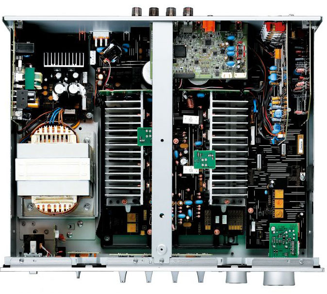

Yamaha A-S801 Inside View with Top Panel Removed
The fact that the A-S801 has a solid amp section isn't the end of the story. Yamaha included a digital section employing an ESS Technology 32-bit ES9010K2M Sabre DAC capable of supporting native DSD resolutions (2.8 MHz / 5.6 MHz) and PCM (384 kHz / 32-bit) via a USB-B as well as coax and toslink digital inputs. Yamaha took it one step further by employing its own clocking scheme to reduce jitter. Analog purists will be happy to hear that the A-S801 includes a MM phono section for vinyl playback.

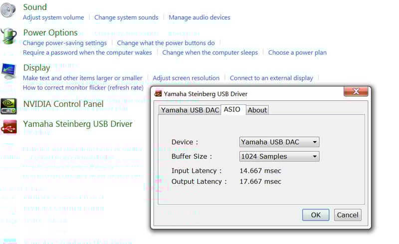

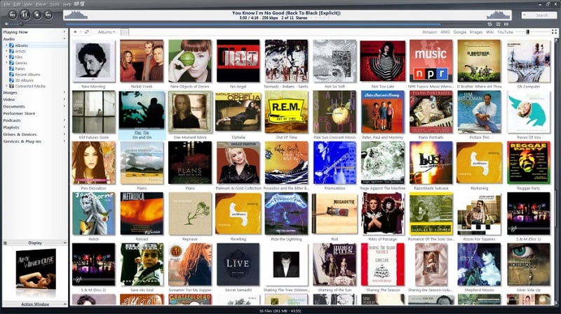

Yamaha Steinberg USB Driver (left pic); JRiver Screenshot (right pic)
Configuring the JRiver media center and getting it to properly playback my HD audio files on my HDD was an exercise in patience and perseverance worthy of its own article.

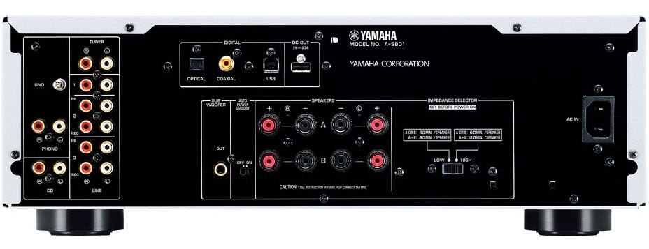

Yamaha A-S801 Backpanel View
The A-S801 has a detachable two-prong power cord that is convenient for installation purposes and for audiophiles that pray to their cables and want to use esoteric alternatives as expensive tone controls. You see that impedance selector switch on the backpanel? Don't touch it! Leave it at its factory default ‘high’ setting regardless of the speakers you connect, or else you will be starving your speakers of power just to validate a UL heat dissipation test that is required to list 4-ohm capability on the silkscreen.
The A-S801 utilizes high quality gold-plated RCA line level connections and 5-way speaker binding posts. You can connect two pairs of speakers to the A-S801 and they are wired in parallel to avoid the sonic degradation that happens when you connect two pairs of speakers in series. Just be warned if you do connect two pairs of speakers and use them at the same time to make sure they are 8-ohm nominal impedance, since the amplifier will see the parallel equivalent load of 4 ohms in this scenario.

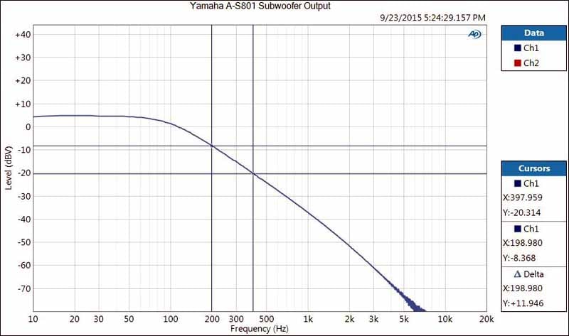

The subwoofer output does NOT have independent volume control and has a fixed 2nd order Low Pass Filter (LPF) response just shy of 100Hz. In my setup, I dialed the internal crossover of my sub down to about 60Hz and was able to achieve a great blend with my speakers, which were running full range. As long as you select a crossover frequency about 20Hz away from the built-in Yamaha one, you won't run into the deleterious effects of uneven frequency response near the crossover point that can happen in the pass band when cascading two filters at the same crossover frequency.
The A-S801 sports USB-B, optical and coax digital inputs. I tested both with excellent results and was able to play back high-resolution 192kHz/24 bit audio on both without truncation.
There are no preamp outputs on this unit. So if later you want to repurpose the A-S801 as a preamp only and add more powerful external amplification, you're out of luck.

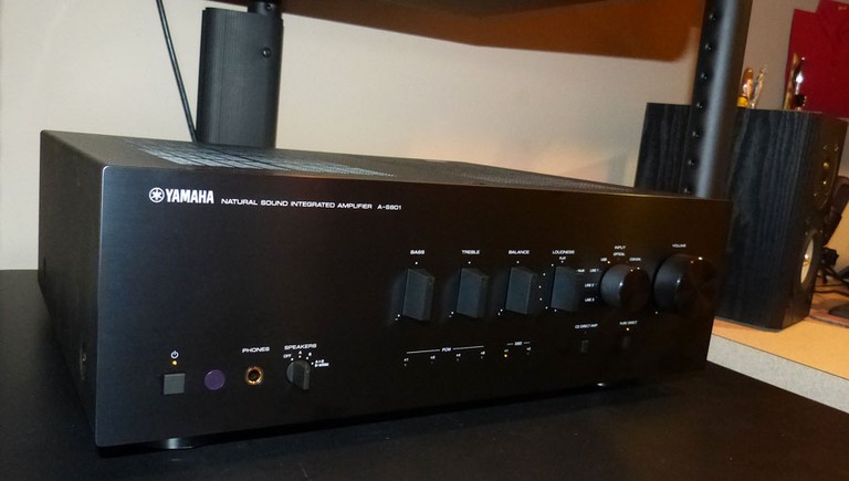

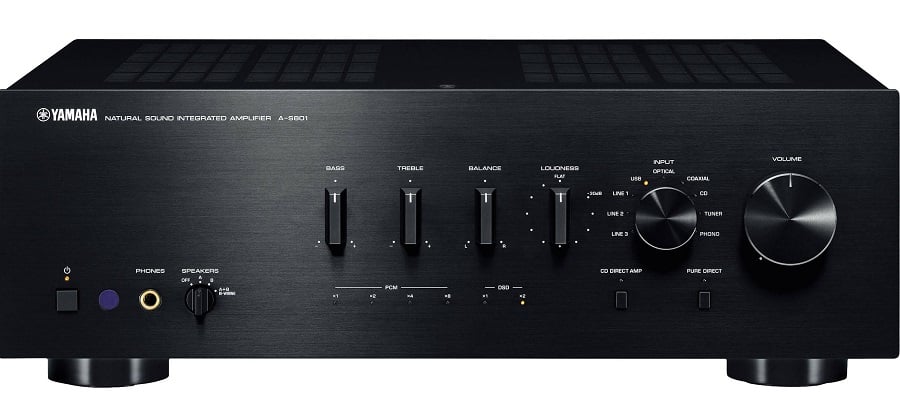

Yamaha A-S801 Frontpanel View
The front panel of the A-S801 isn't lit up like a Christmas tree like today's modern AV receiver. Instead it's simplistic but functional. You've got an amber LED for power, input selection and DAC sampling rate. Oddly there is no LED indicator on the volume control, which is an unfortunate omission. It's difficult to see the indent on the volume control since it's the same color as the actual physical knob. Putting an LED here would have served better functionally and aesthetically in my opinion.

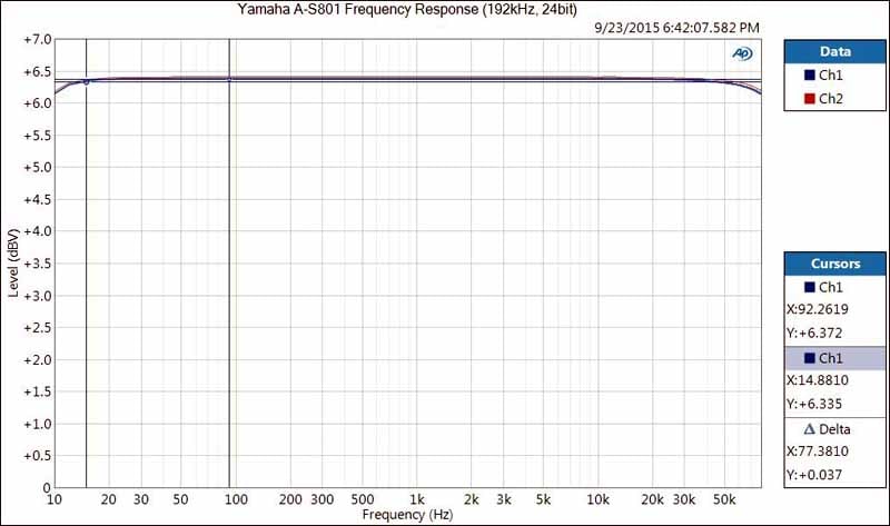

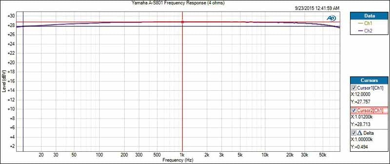

Frequency Response
All measurements of the A-S801 were done in pure-direct mode bypassing the tone and balance controls unless otherwise noted.
Yamaha A-S801 Analog Frequency Response Direct Mode
Whether I measured the A-S801 via analog input or with a 192kHz/24bit test signal on the COAX digital input, I found ruler flat frequency response from 10Hz to 80kHz - .6db. Via the analog inputs, I measured +-.043dB Ch-Ch Deviation and a vanishingly small +-.008dB when using the digital inputs. This is excellent.
Bass Management
The A-S801 bass management in pretty primitive but I found it very useful that Yamaha included a filtered subwoofer output.
Yamaha A-S801 Frequency Response with Bass Management Engaged
The -3dB point of the HPF seemed to be about 95Hz with a 12dB/oct rolloff. Yamaha specs this at 100Hz. Personally I would have preferred it set to 80Hz or not filtered at all since most folks using a sub will simply engage their subwoofer’s internal crossover anyways. As previously mentioned, I recommend either bypassing your subwoofer crossover filter offsetting it +-20Hz than this filter to mimimize interactions between the two.

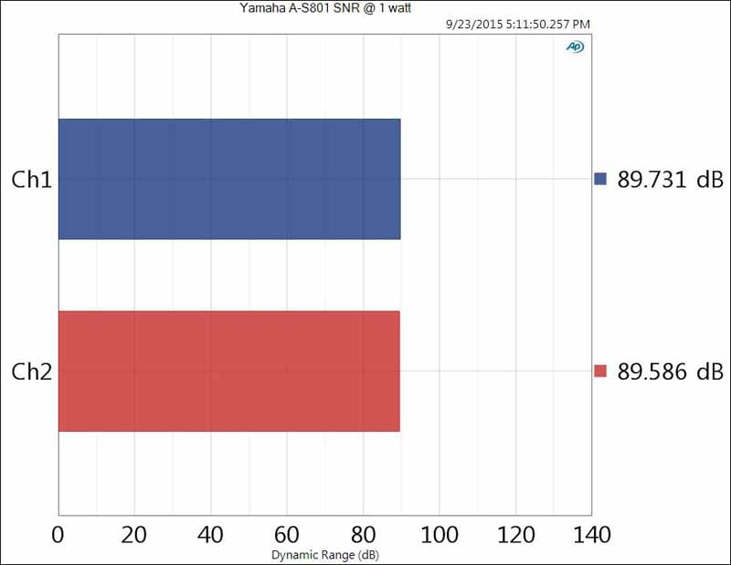

Yamaha A-S801 Signal to Noise Ratio @ 1watt (CCIR filter engaged)
With a 200mVrms input, I measured > 89dB at 1 watt output and >93dB with A-wt filter engaged. This is a great result and demonstrates why I felt the noise floor on this product was completely inaudible.

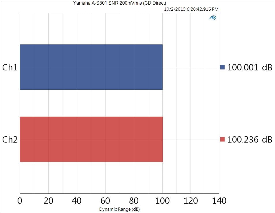

Yamaha A-S801 Signal to Noise Ratio 200mVrms output (CD Direct, A-wt)
Yamaha specs the A-S801 to deliver 99dB (A-wt) or better SNR via the CD analog direct path driven by 200mVrms.  I was able to verify this claim as you can see in the above graph. The CD Direct engaged did improve the SNR by about .5dB.  It's not much of a difference and likely not audible given how quite the product is in any mode, but hey it's something that is verified with measurements.
The DAC performance isn't quite as pristine as the analog section but it's still good nonetheless.  At full digital scale (0dBFs, 2Vrms out), SNR was >100dB A-wt.  This translates down to 83dB at -20dBFS or 200mVrms output.

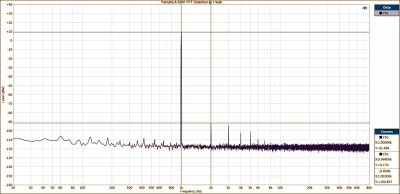

Distortion Performance

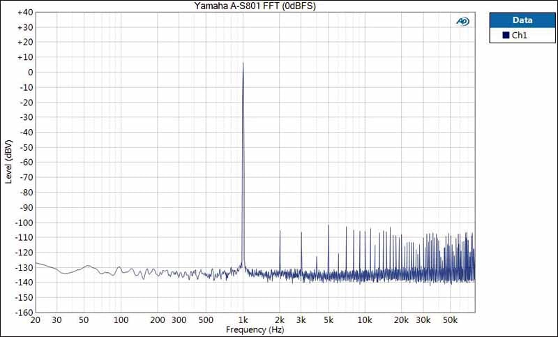

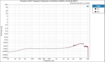

Yamaha A-S801 FFT Distortion Analysis (0dBFs)
I ran the USB-B digital interface at digital full scale (0dBFs) which yielded 2Vrms from the analog outputs to see how the ESS Sabre DAC section performed.  You can see the residuals above the 1kHz fundamental along with quantization noise were in the -103dB or lower range.  While this result isn't SOTA in terms of the best of the best DAC performance, it's still respectable and within the performance limits of the ES9010K2M spec sheet for DNR and THD+N as follows:  DNR=116dB, THD+N=-106dB@1kHz, -60dB.

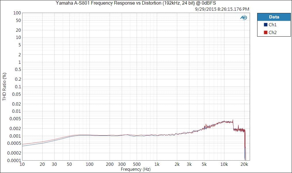

Yamaha A-S801 Distortion vs Frequency (0dBFs, AES17 filter engaged)
Again I verified the distortion limits of the ES9010K2M DAC per their data sheet as being under .005% THD+N for the entire audio band. Yamaha appeared to implement this DAC to reach within its theoretical limits of performance.

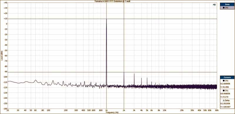

Yamaha A-S801 FFT Distortion Analysis (1 watt)
The amplifier section of the A-S801 behaved quite well as you can see in FFT distortion analysis at 1 watt. The distortion byproducts were > -100dB below the fundamental. Even when driving the amp section to its 100 watt rating, I measured the distortion byproducts > -90dB below the fundamental. This is very solid performance.

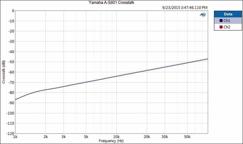

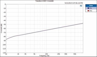

Channel to Channel Crosstalk Performance
Yamaha A-S801 Crosstalk Tests (One Channel Undriven)
The crosstalk sweep tests I ran on the A-S801 produced very good results. At 1kHz the channel-to-channel isolation was about -90dB and –60dB at 20kHz. I consider anything less than -40dB @ 10kHz acceptable and the A-S801 beat that with 25dB to spare. Incidentally, measured stereo separation of the A-S801 was about 20dB better at 1kHz and 15dB better at 10kHz than specified by Yamaha.

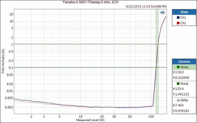

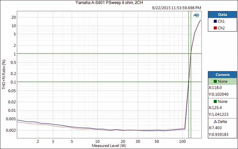

The A-S801 produced respectable output on the continuous sweep tests. For 8 ohms, two channels driven, output was around 105 watts/channel and 185 watts/channel for 4 ohms under 0.01% THD+N (well below clipping).

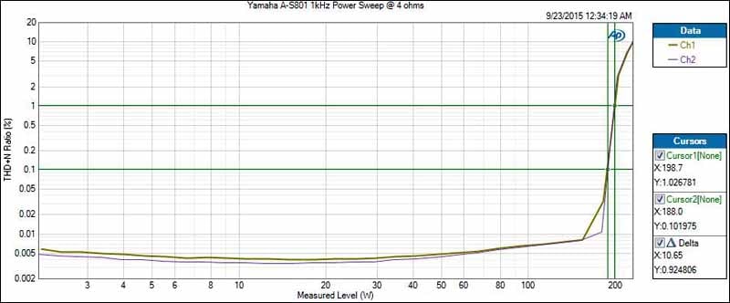

Yamaha A-S801 1kHz Power Sweep Test
Top Pic: 8 ohm load, 2CH;  Bottom Pic:  4 ohm load, 2CH
The Yamaha A-S801 belted out some great power numbers with 125wpc at 1% THD+N and 118wpc at  0.1% THD+N with both channels driven into 8 ohms.  Into 4 ohm load, the A-S801 mustered 188wpc at 0.1% THD+N and about 200wpc at 1% THD+N with both channels driven.
There is a dreaded impedance switch on the back of the A-S801 that reduces the output power of this unit for certification purposes only. We recommend leaving it at the default 8 ohm setting and NEVER changing it.
For more information see: A/V Receiver Impedance Selector Switch

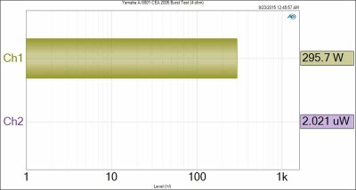

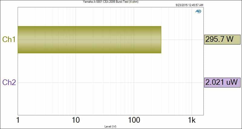

Yamaha A-S801 Dynamic Power Test (1kHz, 4 ohm load, 1CH driven)
The CEA-2006 burst tests simulate musical program material to illustrate dynamic capabilities of the amplifier. The A-S801 produced 260wpc into 4 ohms with both channels driven and almost 300 watts with one channel drive. At 8 ohms, I measured 165 watts which would give this amp > 2dB of headroom based on its 100 watt rating! There's something to be said about good 'ol fashion Class AB amp design with plenty of heatsinking.

| 2 | Dynamic PWR | 156 watts | 8 ohms | 1% |
| 2 | Dynamic PWR | 260 watts | 4 ohms | 1% |
| 1 | Dynamic PWR | 165 watts | 8 ohms | 1% |
| 1 | Dynamic PWR | 295 watts | 4 ohms | 1% |
Yamaha A-S801 Power Measurement Table
Our test results validate Yamaha’s power specification for both channels driven and proved that it had plenty of reserves for dynamic power demands. It also demonstrated excellent stability with 4 ohm loads so don't be afraid to pair it with lower impedance speakers.
