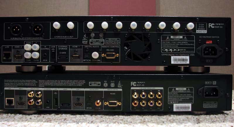

Oppo BDP-93 & BDP-95 Backpanels
Backpanel Views of Oppo BDP-93 (bottom) & BDP-95 (top)
Both players have the same complement of I/O's (two HDMI, one component, composite, toslink, coax, Ethernet, etc) though the BDP-95 adds dedicated unbalanced and balanced stereo analog outputs.  The Oppo BDP-93 does NOT have dedicated stereo analog outputs.  Users wanting to run analog stereo to a second zone from the Oppo can do so only if they are not already utilizing the dedicated multi channel outputs.
The 8 channel preouts of the BDP-95 are also spaced further apart and horizontally arranged into one long row instead of two rows like the BDP-93.  Both players analogue outputs are color coded to better mark corresponding channels.  Both players also sport detachable power cords, though the BDP-95 is of three-prong type while the BDP-93 is two-pronged.  The BDP-95 grounding scheme requires a 3 prong power receptacle for its balanced analog outputs to maintain a truly differential signal path from input to output and thus improving Common Mode Rejection and further reducing the noise floor.

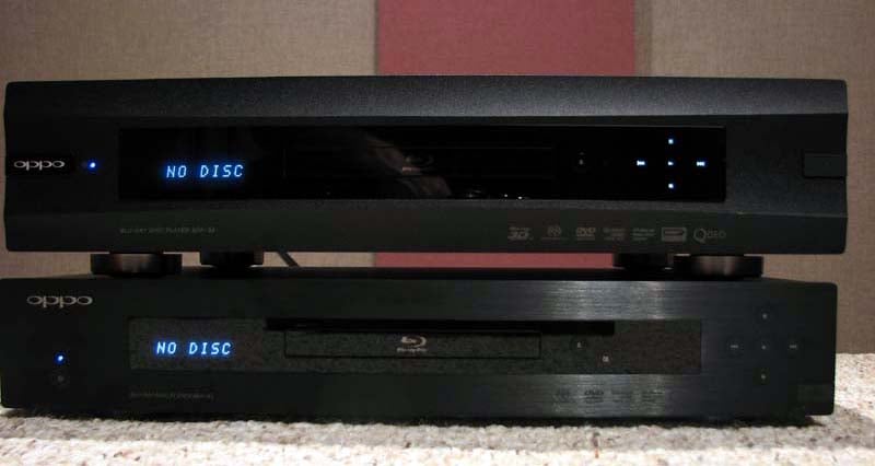

As you can see in the above photo, the BDP-95 is slightly taller than the BDP-93.  Both players measure 16-7/8" wide by 12-1/4" deep while the BDP-93 is 3-1/8" high and the BDP-95 is 4" high.  The BDP-93 also weighs in at 10.8lbs while the BDP-95 weighs an impressive 16lbs.

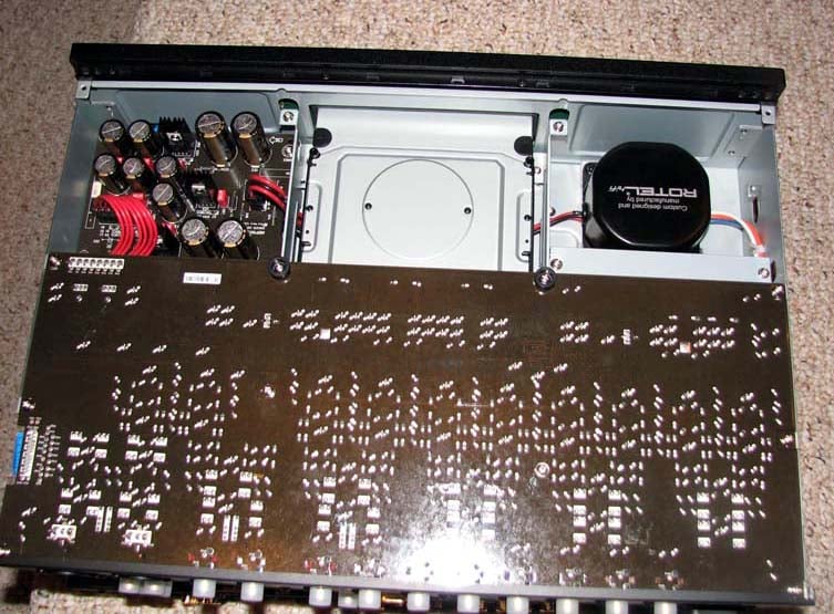

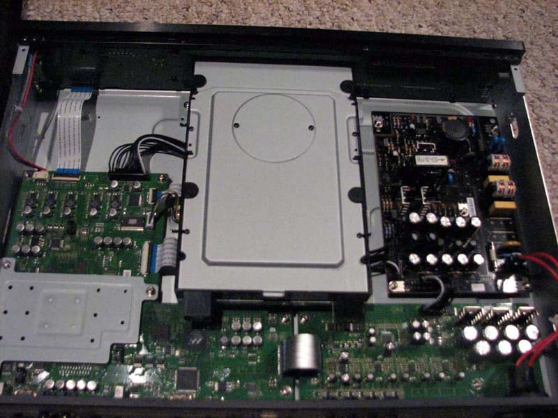

 Oppo BDP-93 Inside  Oppo BDP-95 Inside
Inside View of Oppo BDP-93 (left pic) & BDP-95 (right pic)
We honestly weren't expecting such differences in build quality between the two players.  Once we popped their hoods, the BDP-93 seemed hollow in comparison.  It was almost as if they were two completely different players.   Both players utilize identical video circuitry while the BDP-95 gets a significant audio upgrade by implementing premium ES9018 Sabre32 DAC's and a dedicated analog power supply with a Rotel built toroidal power transformer.  Both players share the exact same transport which was kind of a bummer to us.  We would have liked to see a slightly beefed up disc drawer for the BDP-95 if for no other reason than high end appeal.
