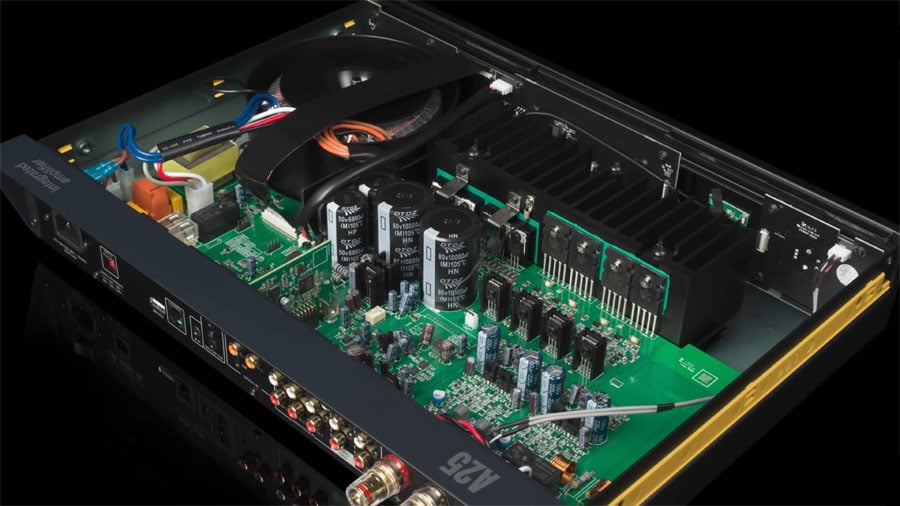

Arcam A25 Internal view
Arcam A25 Internal View
The Arcam A25 employs a Class G amplifier topology with a large torodial power transformer and 2 x 6,800uF, 50V capacitors for the low rails and 2 x 10,000uF, 80V capacitors for the high rails. This allows the amplifier to maintain high efficiency at any power level compared to conventional Class AB designs.

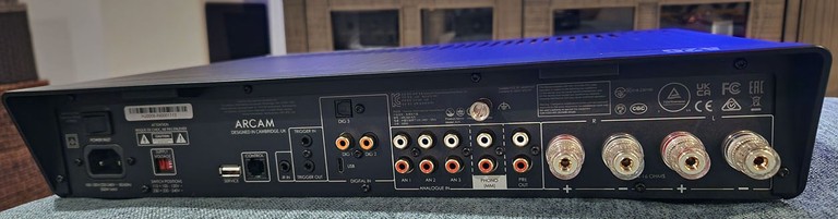

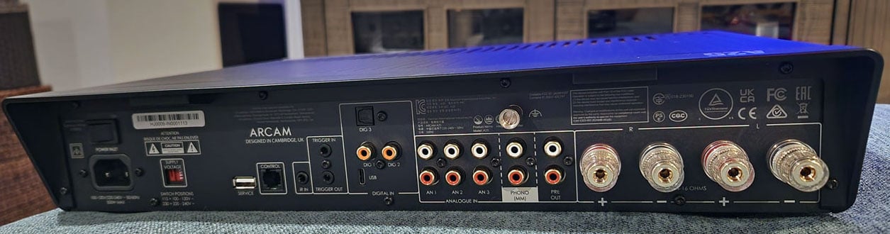

Arcam A25 Backpanel View
A backpanel view of the Arcam A25 integrated amplifier reveals connectivity options for 4 sets of analog inputs (1 phono MM) and 1 set of analog outputs, two digital coax and 1 toslink inputs, 1 USB-C, a pair of high quality WBT style 5-way binding post speaker terminals, a detachable power cord receptacle, IR and 12V triggers.

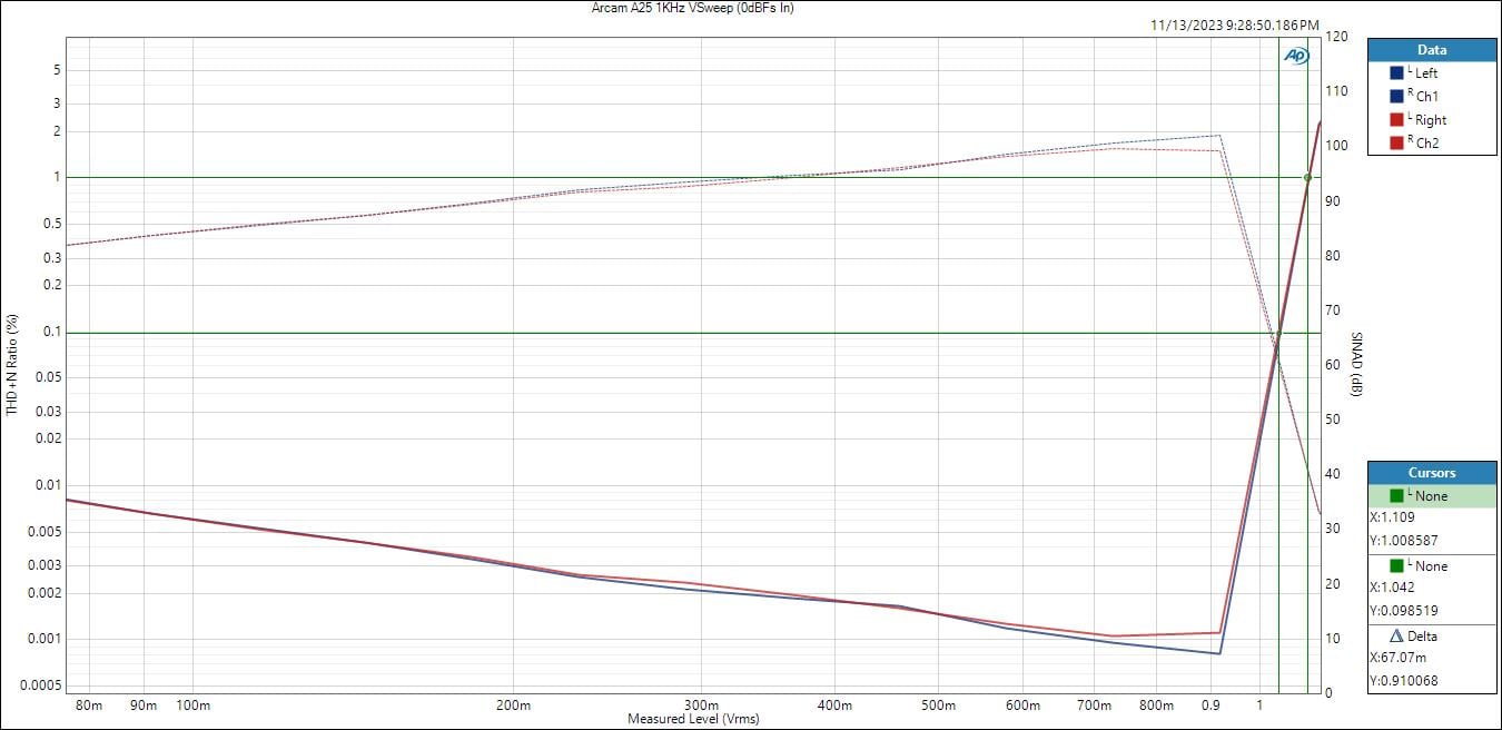

The Arcam A25 preamp outputs have exceedingly low noise and distortion (> 100dB SINAD) but the drive is insufficient if used in conjunction with most power amplifiers to reach full gain. The A25 clips at an alarmingly low output voltage of 1Vrms. I discussed this with Arcam engineering and they told me the preouts were mostly intended to be used as left/right subwoofer outputs to supplement a system with more bass if needed. However, this seems a bit odd considering the preouts have no bass management facilities or level/delay controls. Arcam informed me that they run the volume control at a high voltage level to keep the noisefloor extremely low and then back off the output to optimize drive level for the internal amp section. This was quite evident if you carefully observe the excellent SNR and distortion from the power amp section measurements in this report.
A25 Vsweep
Arcam A25 Preout Output Voltage vs Distortion

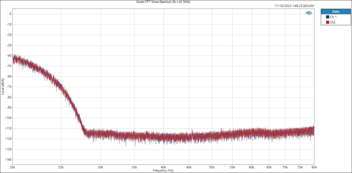

A25 FFT Noise
Arcam A25 FFT Noise Spectrum (fs = 44.1kHz)
With a 44.1kHz digital input, I checked the stopband attenuation and found it to have a smooth rolloff below ½ Nyquist as expected with no residual out of band nasties. This is good housekeeping.

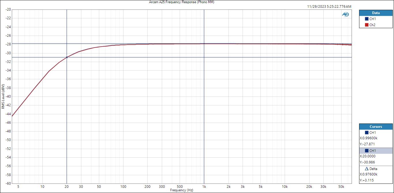

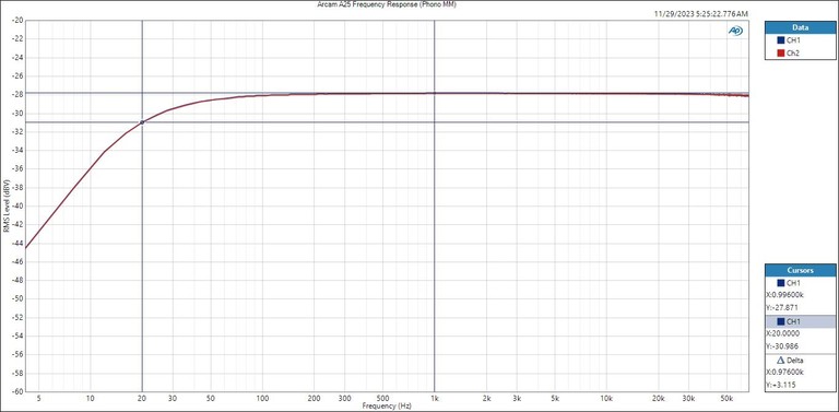

The Arcam A25 has a Moving Magnet (MM) phono preamp. Using the original 3-time constant RIAA curve, I EQ’ed the APx585 source to get the expected flat response of the phono preamp. The phono input was driven at 1mVrms and up to 5mVrms to determine frequency response, distortion and linearity.
 A25 Phono Frequency Response
Arcam A25 Phono Frequency Response (1mVrms input)
I was a bit surprised to see some roll off at low frequencies (-3dB at 20Hz), but my measurement were confirmed with Arcam engineering. As I increased drive level to 5mVrms, the -3dB point rose slightly to 24Hz.

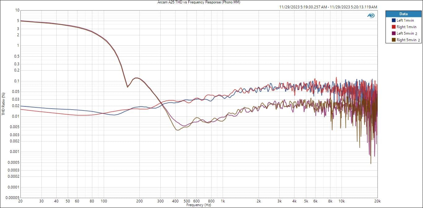

 Arcam A25 Phono THD
Arcam A25 Phono Distortion vs Frequency Response (1mVrms vs 5mVrms input)
The distortion (< 0.09% THD+N) looks good across the entire audio bandwidth for the A25 phono preamp when driven with 1mVrms input but rises dramatically below 200Hz when driven with a 5mVrms input. MM cartridges typically produce 3-6mVrms output so you may want to check with your dealer on the particular cartridge you use on your turntable when mating with the A25 for optimal bass performance. Arcam could certainly improve the performance of their phono preamp section in future iterations of this product. However, it’s most likely users will be prioritizing digital sources with this product so it may be a non-issue for audiophiles that don’t embrace vinyl.

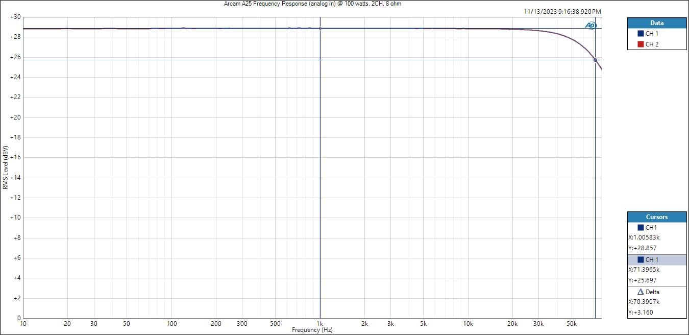

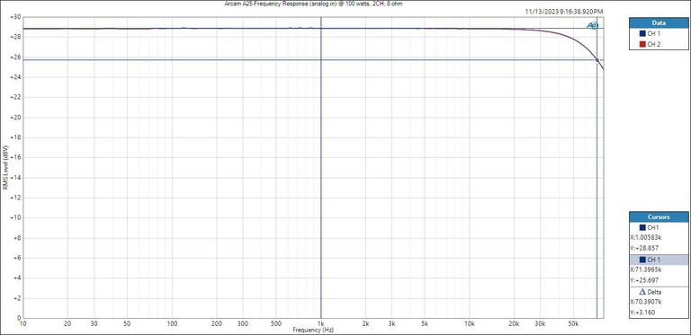

Arcam A25 Frequency Response @ 100 wpc, 8 ohms
The Arcam A25 exhibits ruler flat frequency response from 10Hz to 72kHz (-3dB pt) when driven by an analog or digital source (Fs = 192kHz). The frequency response remains consistent with 8 or 4 ohm loads and various power levels (1 watt and max rated power of 100 watts).  I measured +- 0.058dB CH-CH deviation at full power (20Hz to 15.3khz) which is excellent.

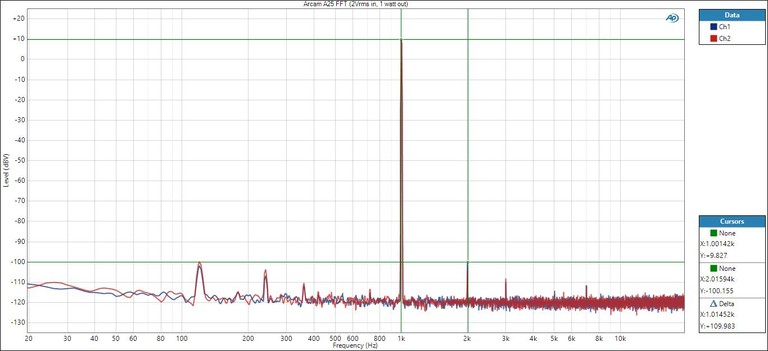

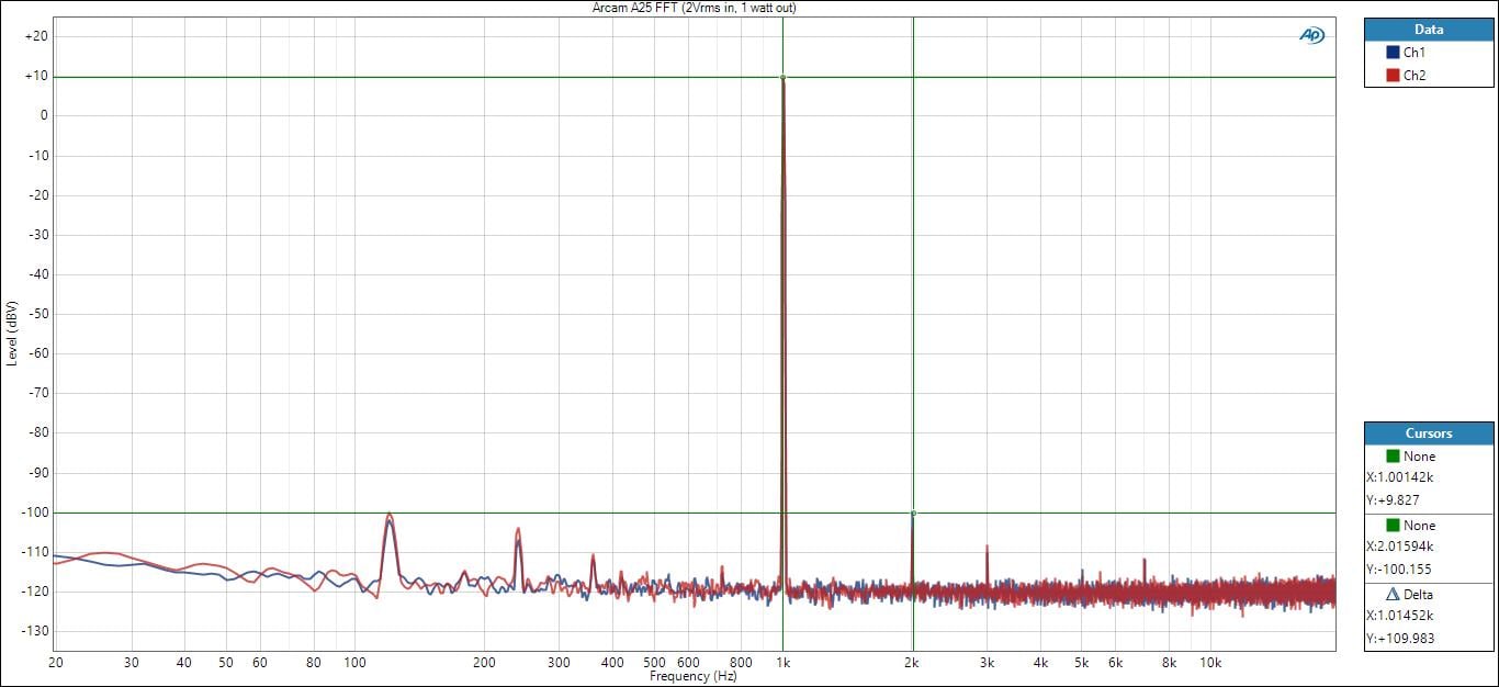

 A25 FFT
Arcam A25 1 kHz FFT @ 2.83Vrms (1 watt, 8 ohms)
The Arcam A25 exhibited a bit of power supply hum after the rectifier circuit but it was down -100dB which is inaudible. The FFT from the amplifier output is nice and clean with 2nd harmonic down -109dB below the fundamental when driven with 2Vrms on the analog inputs. Curious when the same test was repeated with a 0dBFs signal on the COAX input, 2nd order harmonic rose to -95dB below the fundamental. Rest assured that low level details will not be masked by any audible harmonic nasties from this amplifier.

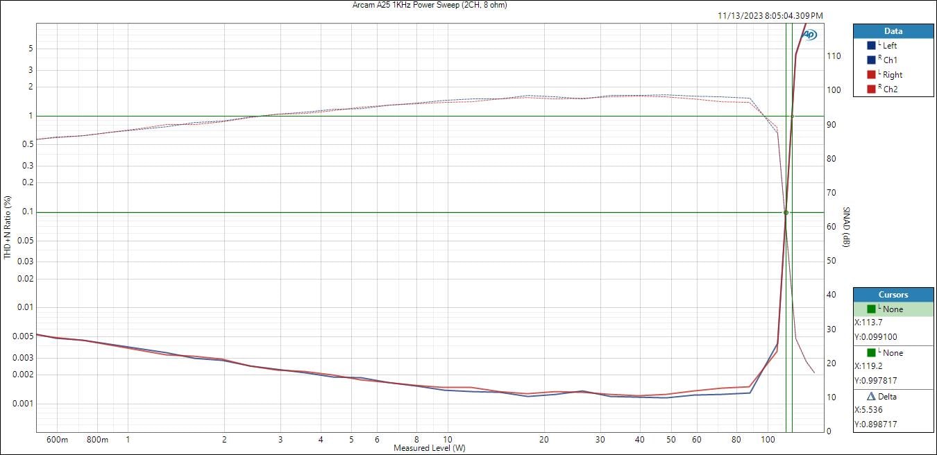

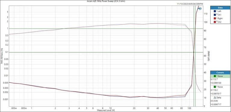

A25 Psweep 8 ohms
Arcam A25  1kHz PSweep (2CH) - 8 ohms
The Arcam A25 exhibited impressively low distortion from the amplifier section as you can see with SINAD approaching 100dB below 80 watts. With 2CH driven, the A25 delivered 113 watts/ch at 0.1% THD+N and 119 watts/ch at 1% THD+N into 8-ohms. You can see the slight bump in distortion around 25 watts where the A25 switches from low to high rail. It’s almost unnoticeable even on my Audio Precision analyzer.

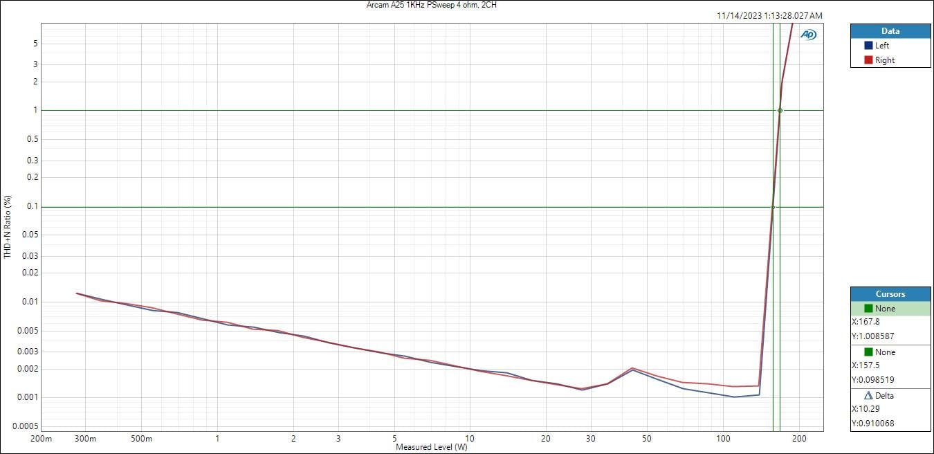

 A25 Psweep 4 ohms
Arcam A25  1kHz PSweep (2CH) - 4 ohms
The A25 maintained impressively low distortion even when driving 4 ohm loads. With 2CH driven, the A25 delivered 157 watts/ch at 0.1% THD+N and 167 watts/ch at 1% THD+N into 4-ohms. The rail switch is a bit more obvious in the 4-ohm test but still imperceivably low. Arcam did a good job with this power topology.

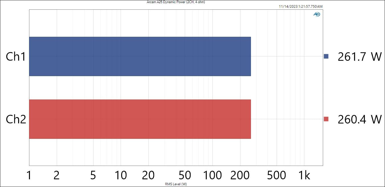

A25 Dynamic Power
Arcam A25 CEA 2006 Dynamic Power – 4 ohms
The Arcam A25 exhibited impressive dynamic power test results able to deliver 155 watts/ch into 8-ohms and 260 watts/ch into 4 ohms. That’s almost 2dB of dynamic headroom over its rated power. Impressive. Most impressive.

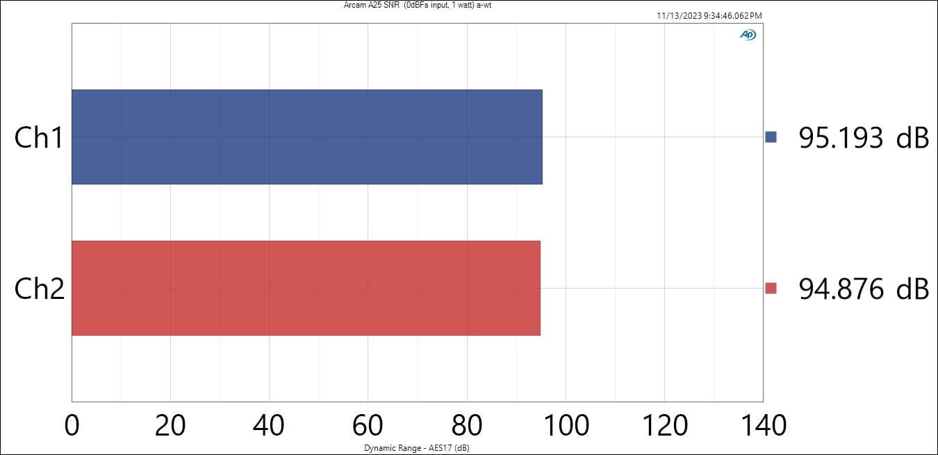

 A25 SNR Coax
Arcam A25 SNR @ 1 Watt (a-wt)
I always measure amplifiers at 1 watt so that apples to apples comparisons can be made between different products that have different maximum output capabilities.  If you want to know the SNR at rated power, then you simply take the 1 watt rating and add 20* log (V*R)^1/2 / 2.83) where V = Vrms and R is the load. With a 0dBFs input signal, I measured 95dB (a-wt) at 1 watt (8 ohms) which is a superb figure. This is an extremely low noise floor I rarely measure in power amplifiers costing substantially more than the A25. I tested the analog circuit path with 200mVrms in at 1 watt output and observed 90dB (a-wt) which again is just excellent.

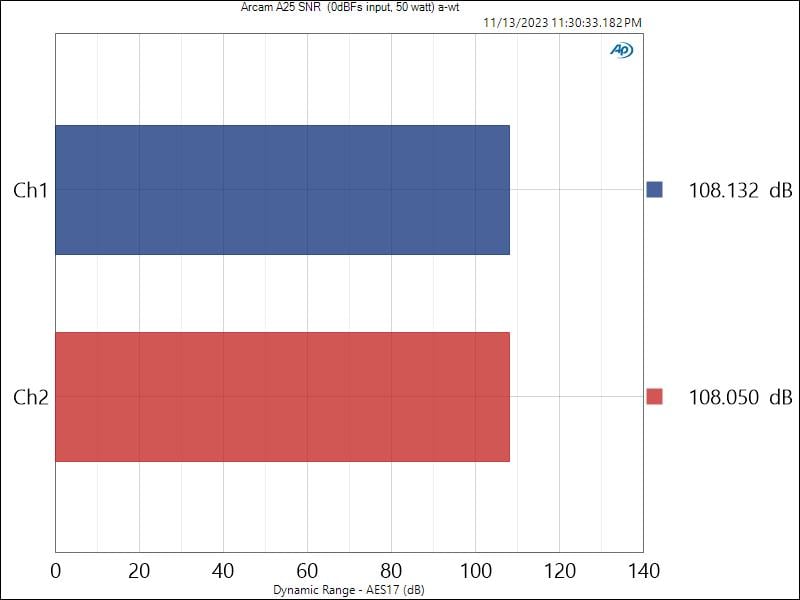

 Arcam SNR Spec Coax
Arcam A25 SNR @ 50 watts Per Spec
Arcam spec of SNR is 110dB (A-wtd, ref. 50W, 0dBFs input). I recreated this test scenario with a digital source of 0dBFs and measured 108dB which is about 2dB shy of their spec but still a phenomenal result, nonetheless. Arcam also provides a spec of 106dB SNR via the analog inputs under the following test conditions (A-wtd, ref. 50W, 1Vrms input). I measured 105.7dB which is pretty much spot on.

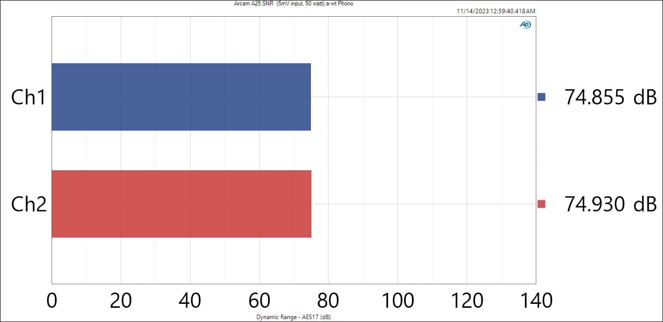

Arcam SNR Phono
Arcam A25 SNR @ 50 watts from Phono Input
Through the phono preamp, SNR was 73dB with a 5mVrms input and 1 watt output and maxed out to 75dB at 50 watts. Arcam specs this at 80dB under the same test conditions, so I'm unsure why my measurements came up about 5dB short. Irregardless, this is a decent measurement for a phono stage but not among the best I’ve measured.

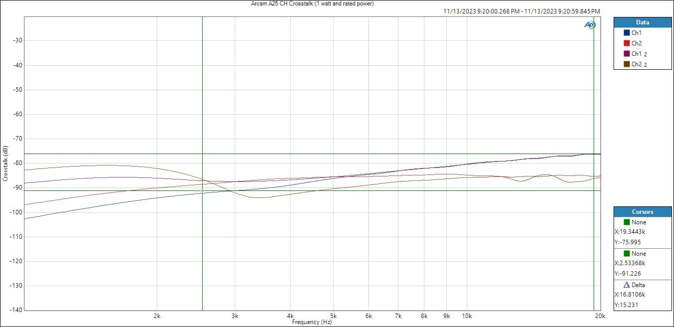

 Arcam A25 XTALK
Arcam A25 CH-CH Crosstalk (1CH, Undriven)
The channel-to-channel crosstalk of the A25 was very good measuring at > 85dB at 1kHz at full rated power and 75dB at 20kHz. I find anything > 60dB at 20kHz to be acceptable and the A25 beats that by a healthy 15dB.
