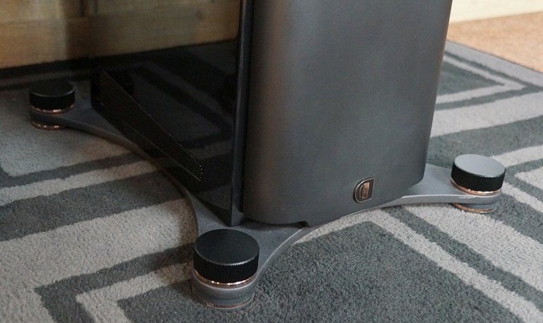

The base is a thick steel plate with some hefty feet sticking out from the corners. The feet have some brass rings above and below the plate as well as polished brass spiked feet which is a nice touch of class. The binding post plate is a brushed black metal plate with gleaming chrome binding posts joined by a similarly polished jumper.

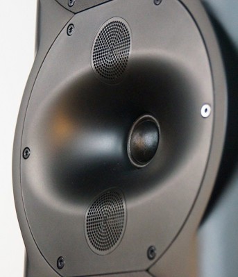

On the surface, it looks like a 3-way speaker in which a dome tweeter is nested between two midrange domes and four 7” woofers, but this is not a conventional WMTMW speaker. Instead, the drivers form an array where they largely work with each other rather than in their own separate frequency bands, so there are a lot of overlapping bandwidths in the crossover filters. This is done to create an acoustic beamforming effect where all the drivers sum up on an intended listening angle and subtract elsewhere. In order to accomplish this, the drivers in the array do not operate at the same amplitude levels or even the same phase angle. In fact, to make the beamforming work, the spacing of the drivers must be precise, both in height and width, but also in depth, and this is why the midrange drivers are mounted ahead of the tweeter in spatial positioning. The advantage of this beamforming is a whole lot of output delivery to a specific direction without needing to throw sound everywhere at a high level. Perlisten calls their beamforming array the DPC waveguide where DPC stands for Directivity Pattern Control.
The beamforming restricted angle occurs on the vertical axis in the R7t speakers. The performance targets for this speaker are a wide horizontal dispersion and a narrow vertical dispersion. The reason is that any room with multiple listening positions is likely to be spread out on a horizontal plane but unlikely to be spread out much on a vertical plane, so it’s a good idea to have a full sound projected out over a wide angle horizontally so all the listening positions are met with a high-quality sound. It is also beneficial acoustically since it has been shown that lateral acoustic reflections from sidewalls can enhance the spaciousness of the sound, and many people find that to be pleasing. On the other hand, it can be beneficial to restrict the vertical dispersion angle. There is an argument that vertical reflections can reduce a sense of spaciousness (by diminishing inter-aural cross cancellation), although that is based on research conducted for larger room acoustics such as auditoriums and it isn’t certain how valid that is for domestic living space-sized rooms.
Normally, speakers just use a waveguide on the tweeter to restrict vertical dispersion, but the problem with that is it only affects the tweeter’s bandwidth while the woofers and midrange drivers are usually projecting sound out at a wide angle in all directions. Some manufacturers place the midrange in a horn or use very large woofers, but either solution necessarily makes the speaker very large. Through the ingenuity of beamforming, Perlisten has found a way to restrict vertical dispersion over a much wider bandwidth without needing the speaker to be gigantic. Perlisten also does incorporate a state-of-the-art waveguide on the tweeter, but that is to control directivity in higher treble frequencies where their beamforming array isn’t active.
The central DPC array in the R7ts is comprised of three 1” silk dome drivers. The 1” drivers use some pretty beefy neodymium magnets in the motor, and that amount of force should have a tremendous level of control over the moving assembly of the domes. Silk is a common material for a tweeter diaphragm and the reason for that is because it works so well without being very expensive. It is light and stiff, and it can operate up to very high frequencies without incurring significant deformation or break-up modes. A waveguide is used to control dispersion on the center tweeter, so the beam-forming of the DPC array operates mostly over the bandwidth of the other domes as well as the bass drivers down to 500Hz or so.
Also included in forming the array are the four 6.5” bass drivers. Their cones use a material that Perlisten calls “HPF pulp,” where HPF stands for Hybrid Pulp Formulation. This is a mixture of long and short fibers as well as bamboo for a stiffener and wool for damping. This is a light and stiff cone composition that can hold a response out to a very high frequency. The motors are beefy ones, as would be expected. They use shorting rings and an aluminum coil in a large iron magnet. Some might complain that using aluminum is mere cost-cutting, but it was a deliberate decision by Perlisten for performance reasons. As we stated in the review of the S7t: “That might seem slightly counter-intuitive seeing as how copper is more conductive, but that extra electrical resistance can be made up by simply using a larger gauge wire, and the larger gauge wire has the added benefit of being better for thermal dispersion since it has a lot more surface area from which to radiate heat. What is more, even with the larger gauge wire, it is still lighter than copper, so using aluminum reduces moving mass, thereby making the driver more sensitive.” The combined surface area of the four 6.5” drivers adds up to the surface area of a 13” driver, so these speakers should be able to move a lot of air for some real potent lower frequency output.

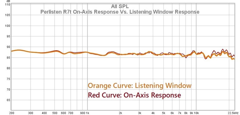

The Perlisten R7t speakers were measured in free-air at a height of 6 feet at a 2-meter distance from the microphone, with the microphone raised to an 8’ elevation that was level with and aimed at the tweeter center. The measurements were gated at 11-milliseconds. In this time window, some resolution is lost below 400 Hz and accuracy is completely lost below 200 Hz. Measurements have been smoothed at a 1/24 octave resolution.
The above graph compares the on-axis response to the listening window response. The listening window is an average of horizontal responses out to 30 degrees and vertical responses out to 10 degrees. The first thing to note about these responses is how extraordinarily flat they are. That means we are dealing with an exceptionally accurate loudspeaker. The second takeaway is how closely the listening window resembles the on-axis response. That means there will be very little change in the sound at any reasonable listening position, so these speakers aren’t fussy regarding angling or placement. Listeners will be exposed to an accurate sound over a broad swath of area in front of the speakers. Different toe-in angles may produce slight changes to the character of the soundstage, but it will not impact tonality.

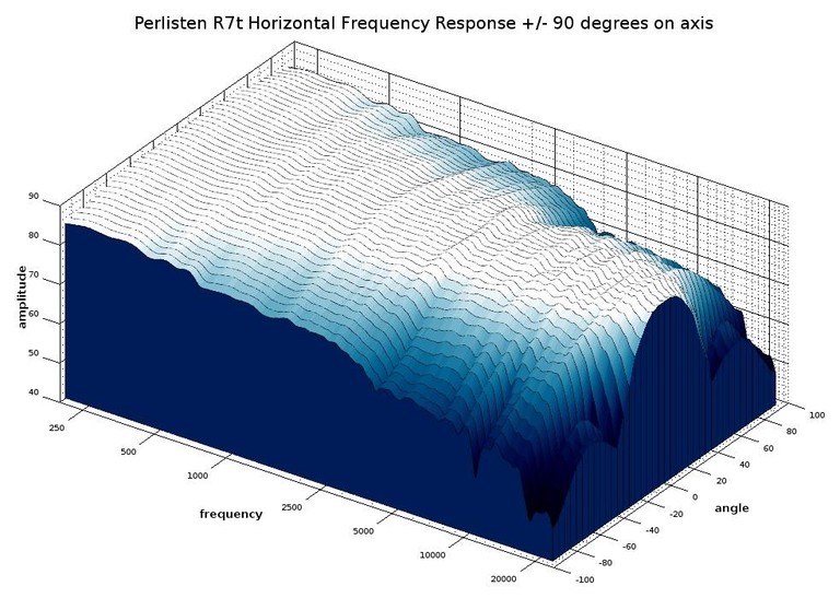

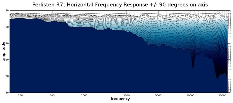

The above graphs depict the R7t’s direct-axis and horizontal dispersion out to a 90-degree angle in five-degree increments. Information on how to interpret these graphs can be read in our loudspeaker measurement article. Here we get a look at how well the R7t’s off-axis responses correspond to the on-axis response as well as each other. Again, this tells us that this speaker maintains an accurate response over a broad angle. We do see some slight directivity errors develop in far off-axis angles, but even these are so narrow and low in amplitude as to be audibly inconsequential and of academic interest only. Again, the keyword for this set of measurements is accuracy; indeed this is more accurate than most studio monitors. In fact, these speakers could easily be used for recording, mixing, and mastering in a studio environment, and they would work better in that application than most loudspeakers made specifically for that application.
What these graphs also tell us is that the R7ts don’t need a lot of expensive acoustic treatments to sound good. Since there is such good correspondence between the shape of the on-axis curve to off-axis curves, the in-room acoustic reflections will not have a dissimilar sound from that of the direct sound of the speaker itself. In other words, listeners do not have to be protected from a subpar off-axis response by acoustic treatments as they might if the speaker had problems in this respect.

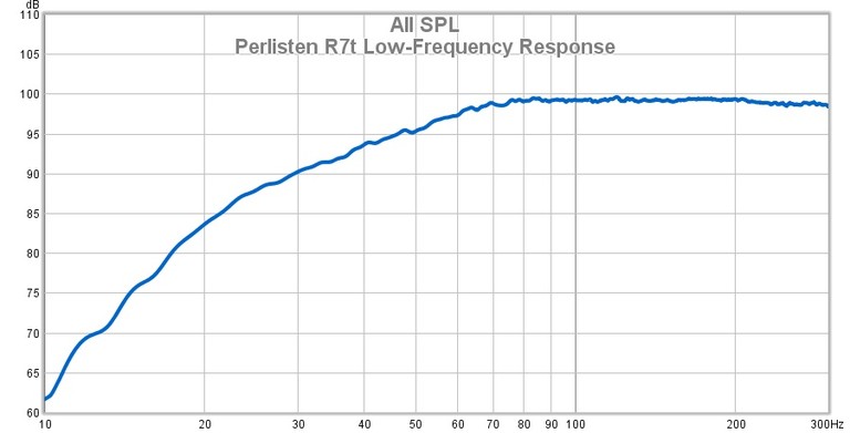

The above graphs show the Perlisten R7t’s low-frequency responses that I captured using groundplane measurements (where the speaker and microphone are on the ground in a wide-open area). Here we see a dead flat response that tapers off into a gradual roll-off down to the tuning frequency in the upper 20Hz range. Below that point, it falls off at a more rapid 24dB/octave slope typical of ported system. This is a common response target for many floor-standing loudspeakers. The reason is that room acoustics always boosts the low end to some degree, so a flat response would sound too bass-heavy in normal rooms in a home. This sort of curve should yield a more natural in-room response than a flat curve, and room gain should net a strong response down to 30Hz in most rooms. If this response still proves to be too much in a small room, users can seal the ports with Perlisten’s included port plugs. On the other hand, if users want a stronger bass response, they can always place the speakers closer to a back wall which will increase the low frequencies via boundary gain.

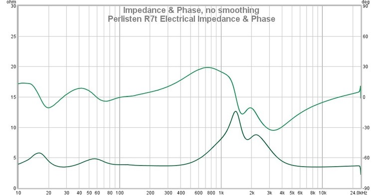

The above graph shows the electrical behavior of the Perlisten R7t. Perlisten specifies this speaker to have a 4-ohm nominal load, and that is what we see. The impedance is relatively steady instead of taking big swings in values, and that should help to make for a predictable load for amplifiers, There aren’t any dips into very low impedances nor are there any steep phase angles at lower impedances, so this isn’t an extraordinarily difficult load for most amplifiers. Entry-level amps might have a hard time driving these speakers at loud levels, but I am guessing that no one who buys these speakers will run them on entry-level amplifiers. We can see from the nadir between the saddle peaks in the low frequencies that the port tuning frequency looks to be around 30Hz.
