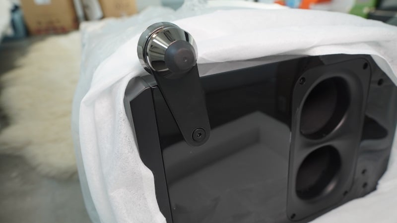

Unpacking the MartinLogan XT F100 speakers is a relatively straightforward task. With ample experience in handling large speakers, I've mastered the routine. Lay the speaker on its side or head, cut open the bottom, fold the flaps away, flip the speaker back over, pull the box up and off, and remove the foam and packing materials. To minimize physical strain, I enlisted the help of Don Dunn to move the speakers from their unpacking location. The speakers exhibit a reassuring weight that hints at their quality without being overly cumbersome; most individuals of average strength can easily set them up.

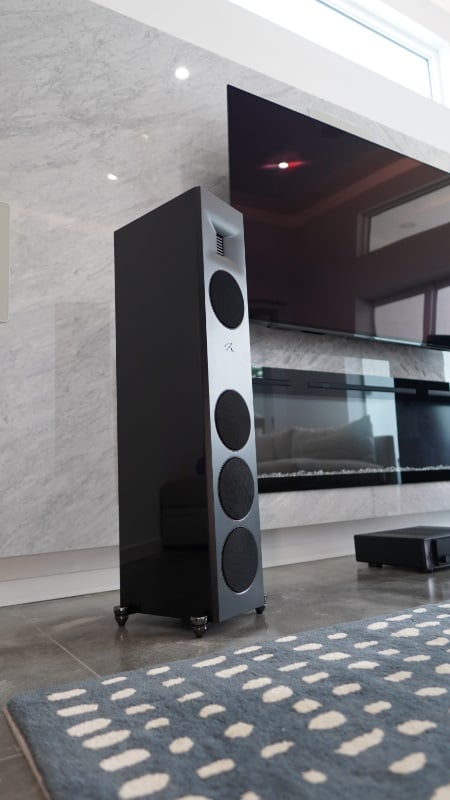

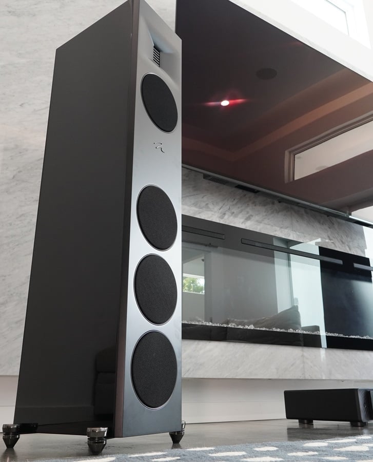

The speakers arrived in a glossy black finish. I must admit, I had requested a color other than black, as glossy black is quite common. My initial disappointment upon seeing "black" listed on the boxes quickly dissipated once I unpacked them. The finish and design of the F100 speakers were impeccable. The round grills complemented the satin black baffle seamlessly, snapping into place with a slick, dome-shaped design that didn't protrude noticeably. The gloss black enclosure boasted a flawless, machine-applied finish, surpassing the hand-applied piano lacquer finish on recently acquired home theater chairs. Unlike the lacquer, the F100 speakers exhibited no swirl marks or imperfections; it was a stunning piano black finish that enhanced the aesthetics in various rooms. Initially set up in my family room, I was so enamored with their appearance that I wanted to keep them there, but my wife had different plans, leading to the absence of tower speakers in our family room.

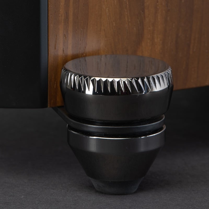

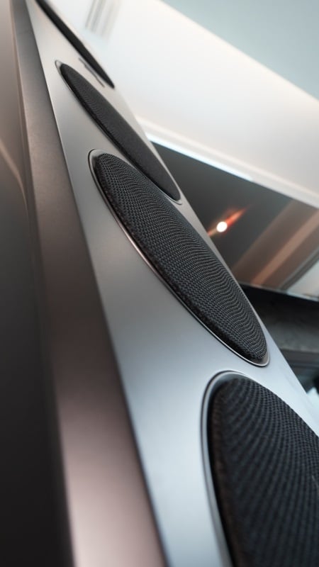

Beyond the impressive fit and finish, noteworthy details include the enclosure shape and feet. The non-flat top of the enclosure introduces an appealing design element, breaking up the monotony of a typical box shape and creating the illusion of a smaller speaker. This thoughtful design choice enhances the overall visual appeal. The outrigger feet, finished in a refined black chrome, further contribute to the speaker's aesthetic prowess.
The build quality, on par with more expensive products, stood out, impressing me with MartinLogan's ability to deliver such quality at this price point. While differences may exist in less noticeable details compared to higher-end speakers—such as potentially lower-quality ports and binding posts—the F100s didn't feel thin or cheap. Upon knocking on the enclosures, they felt solid, a sentiment corroborated by the impedance graphs in the measurement section, showing no discernible signs of enclosure resonance.

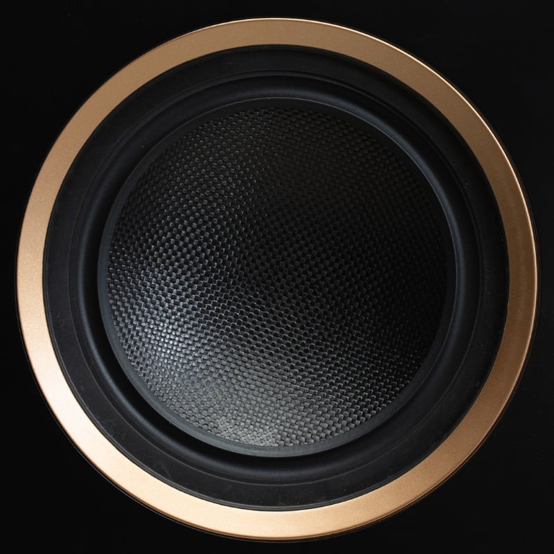

Turning attention to the drivers, MartinLogan introduces all-new components. The midrange driver, constructed with nomex-reinforced Kevlar, boasts a lightweight yet robust design, contributing to precise sound reproduction. An inverted and narrow surround minimizes reflections, addressing a common issue in driver design.

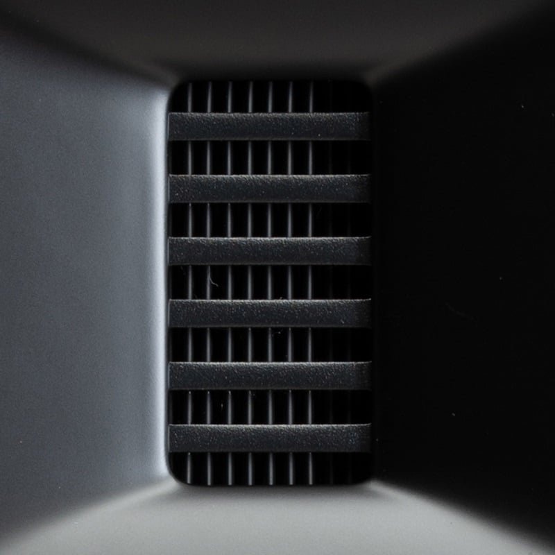

The Gen2 Obsidian Folded Motion Tweeter XT, recognized as an Air Motion Transformer (AMT) from the original inventor, features a 40% increase in surface area and a redesigned structure for enhanced performance. While this tweeter design comes with both advantages and disadvantages, MartinLogan has made notable engineering efforts to minimize potential drawbacks. The addition of a folded motion-specific waveguide improves directivity, aligning it with the 6.5-inch midrange and enhancing efficiency in the low end. This innovation contributes to improved directivity control across the treble range.

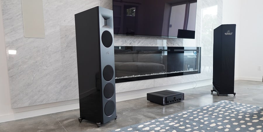

I conducted listening sessions in two distinct environments with varying acoustics and room volumes. The first room, my family room, presented a challenging scenario with concrete floors, a marble wall feature, minimal soft materials, and only a few acoustic treatments. Despite these challenges, the MartinLogan XT F100 delivered an expansive soundstage, with well-defined, extended, and tight bass. The tower speakers outperformed in-wall speakers from Definitive Technology, showcasing improved tonal balance and dynamics.
Transitioning to my dedicated home theater, a more controlled acoustic environment, resulted in a different sonic experience. The shorter decay time in this space created a drier sound with tighter imaging. The MartinLogan XT F100 adapted well to both environments, demonstrating versatility in delivering satisfying sound quality.

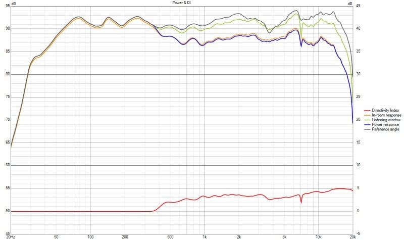

Figure 1: MartinLogan F100 Power and DI
These measurements exclusively focused on horizontal data, making all reported measures reflective of the horizontal dispersion version. For instance, the listening window pertains to the horizontal dispersion listening window. Minor discrepancies observed between the on-axis and listening window measurements indicate slight off-axis response variations. Notably, the tweeter response exhibits signs of resonances and reflections, lacking the smoothness and flatness I ideally sought. Despite these imperfections, the errors do not seem to introduce significantly audible artifacts. The relatively smooth in-room response prediction might contribute to the perceived absence of strong issues during listening sessions.
It's important to highlight that the directivity index (DI) exhibits some irregularities, impacting its overall smoothness. Nevertheless, the DI's generally linear shape implies commendable directivity matching. A minor mismatch just above the crossover point is noticeable but doesn't significantly detract from the speaker's performance. The distinctive hump centered at 2kHz likely contributes to the slightly forward sound I perceived. While not overtly objectionable, the presence of this hump was audible, particularly in the on-axis response, and seems to diminish off-axis.

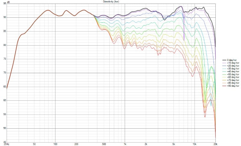

Figure 2: Horizontal Dispersion
Focusing specifically on the 90 degrees of horizontal data provides a clearer understanding of the speaker's behavior. Notably, some of the on-axis errors diminish when transitioning off-axis. Additionally, an intriguing observation is the presence of a very high Q resonance evident on-axis. This resonance might be linked to the unique design of the tweeter. Air motion tweeters, known for low distortion and high SPL, can exhibit challenging reflections across their face, resulting in distinctive high-Q resonances. Fortunately, despite their presence, these resonances do not manifest audibly, alleviating concerns about potential sonic artifacts.

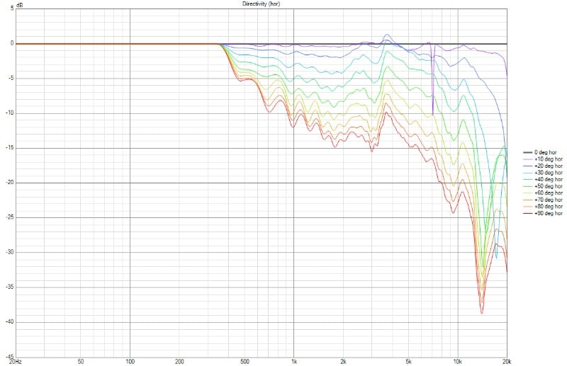

Detecting directivity mismatches in drivers can sometimes be challenging. Normalizing the data, however, proves to be a valuable technique, as it brings to light any issues in a more discernible manner. This approach aids in identifying potential discrepancies in driver performance, contributing to a comprehensive understanding of the speaker's horizontal dispersion characteristics.
Figure 3: Normalized Horizontal Dispersion
Examining the normalized horizontal data unveils a discernible shift around 3800Hz, indicative of a slight directivity mismatch between drivers. This observation aligns with the earlier findings in the DI analysis. While not a severe concern, and unlikely to be highly audible, it falls short of the optimal performance expected from top-tier speakers. It's crucial for readers to exercise caution, as such behavior is prevalent in speakers of this type and within this price range. Achieving perfect directivity often entails trade-offs, potentially including higher costs. It's essential to emphasize that in the measurements section of a review, our role is to dissect both the positive and negative aspects, refraining from making subjective judgments about sound quality.
Additionally, a dip at 15kHz is noteworthy. However, closer examination reveals that at each angle, there is a distinct center point for the dip. This occurrence stems from a diffraction effect within the tweeter/waveguide system. The shifting center point results from the varying distance between the source of reflection or diffraction, changing with different angles. The angle error is most pronounced in the initial 30 degrees, but as the angles become more extreme, the difference in distance diminishes, causing the center points to converge. This issue is a common characteristic of this type of tweeter, and the relatively high Q and frequency contribute to its presence.

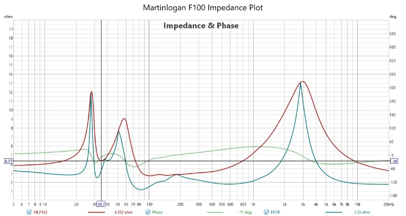

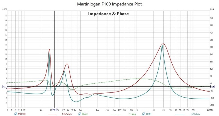

To measure the electrical impedance, phase, and EPDR, the Dayton Audio DATS V3 was utilized at the highest power level. The red and green traces represent the actual impedance and phase of the system. It's a common discussion point how the phase at a specific frequency can impact the impedance, potentially making it a more challenging load for an amplifier. EPDR, in this context, is a calculated metric that portrays the impedance load as perceived by the amplifier, factoring in the effects of the phase angle. Consider it a visual representation of the actual difficulty the load poses on a typical amplifier.
Observing the results, while the impedance registers as a reasonable 4-ohm load, the EPDR indicates a load closer to 2 ohms. This suggests that the speaker may present a more demanding load to drive. Although MartinLogan specifies the speaker as a 4-ohm load, the lower EPDR value implies that the speaker could draw more current and potentially benefit from a more robust amplifier. It's noteworthy that, despite these considerations, the speaker was successfully driven with a modest Marantz integrated amplifier without encountering any issues. Beyond this, the only other area of concern is a slight wiggle in the impedance trace at the same 150hz area as the resonance was noted in the response.
