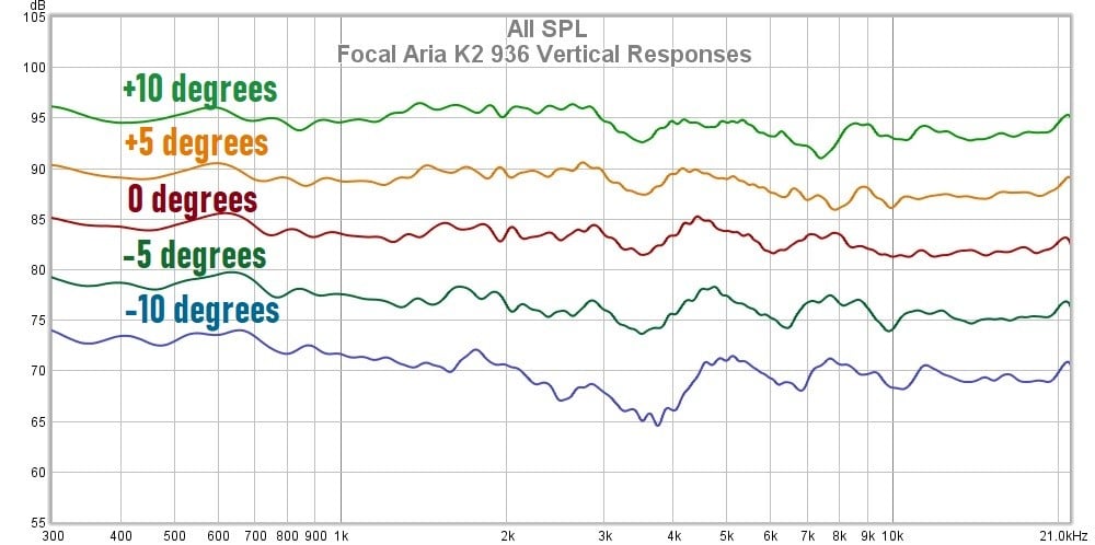

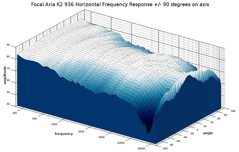

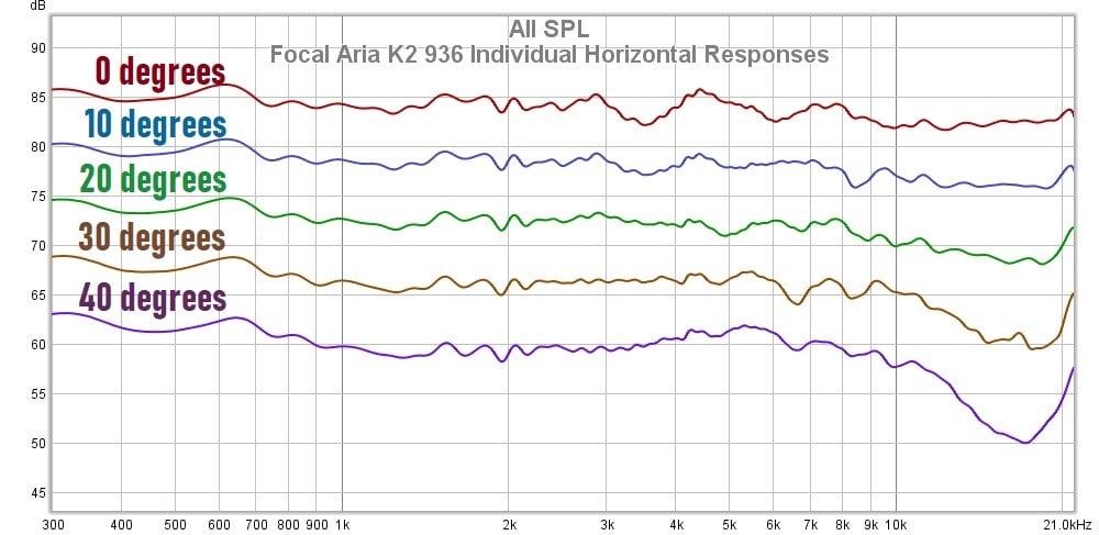

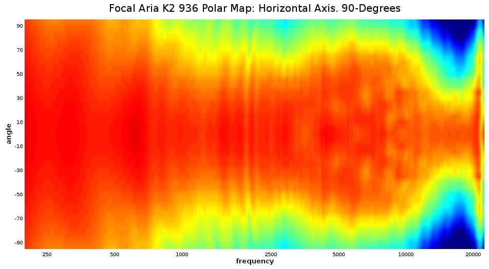

  • Very good response on and off-axis
  • Wide dispersion covers a large area
  • High sensitivity and good dynamic range

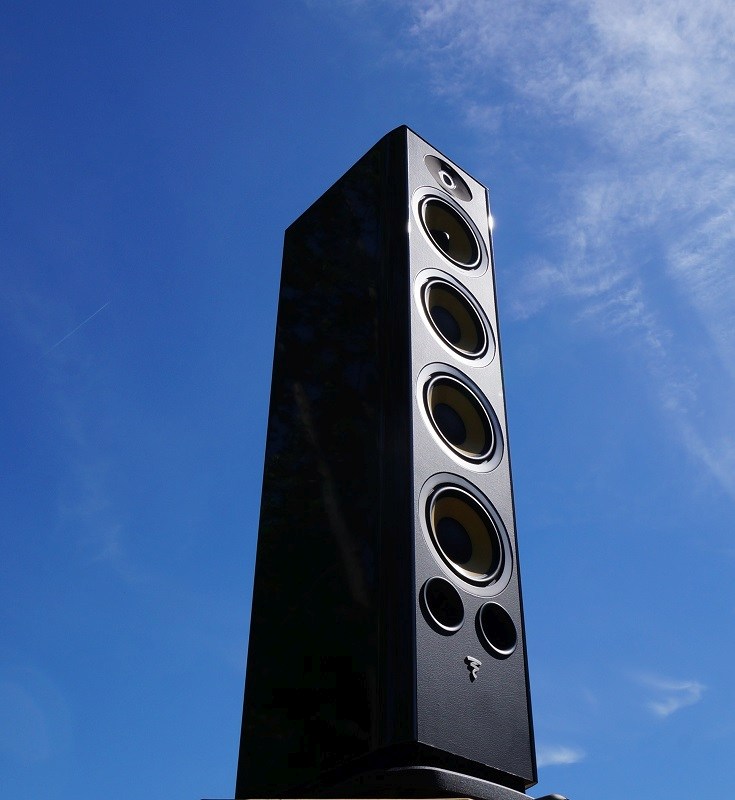

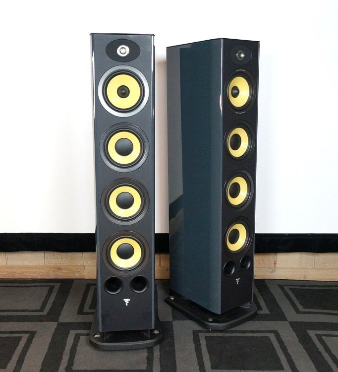

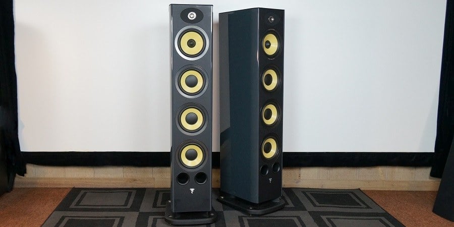

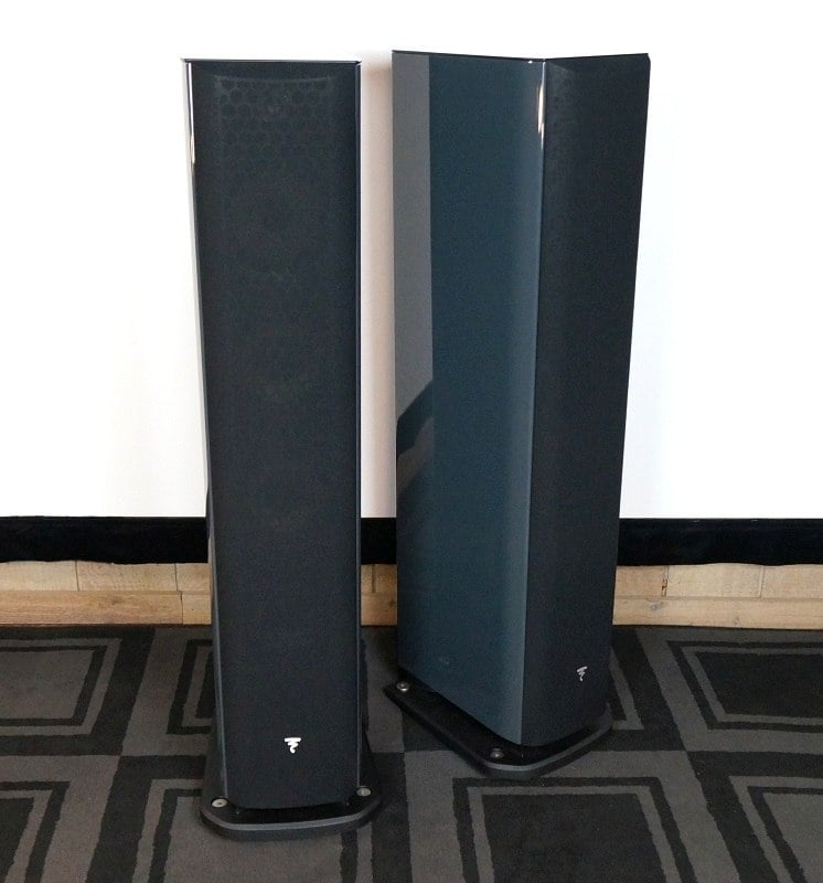

In my opinion, the Aria K2 936 speakers look very nice, but they won’t be for everyone. In many instances, loudspeakers seem to draw on automobiles for styling cues, and it seems to me that these speakers do that a bit more than most. The Aria K2 936 has a gloss grey finish that Focal calls “Ash Grey.” This is a color that I am seeing becoming popular in automobiles, a grey sometimes called “gunmetal grey,” “concrete,” “stone grey,” etc. As a limited-edition model, the Aria K2 936 speakers only come in this color. The front and back baffle comes in a leatherette finish, a material that looks and feels a lot like real leather but is actually a vinyl imitation. One thing I like about this leatherette material is that it does not catch fingerprints like gloss or smooth satin finishes. The speaker is topped with a glass surface with “Focal” printed underneath the glass at the front edge.
936 grilles4  936 pair

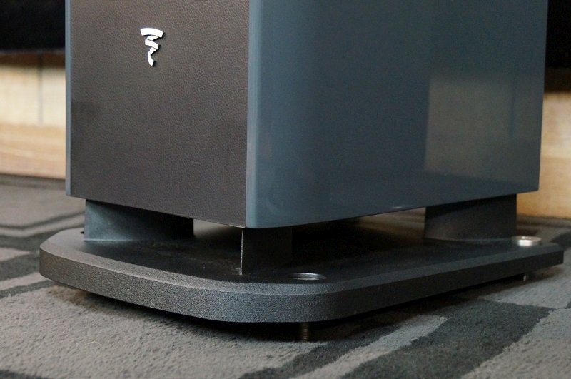

The enclosure has a subtle curvature on the side panels that is imitated in shape by a plinth-type base. The base is made from an aluminum alloy, but it looks like iron. It is a bit more rounded and also gives the speakers a slight backward lean. It uses spiked feet that can be adjusted in height using an included tool.
focal logo  936 top reflectivity

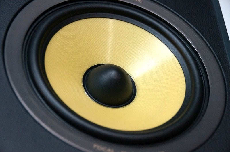

The stand-out feature of the Aria K2 936 is the bright yellow cones. They serve as quite the contrast with the black/grey surfaces elsewhere on the speaker. With the grilles on, the Aria K2 936 is handsome with a reserved manner. The grilles have a rounded shape that continues the front baffle’s curvature. Without the grilles, the speakers do draw a bit of attention to themselves thanks to the cones, but I like the extra flash that they add. Trim rings surround the drivers and the grilles use magnetic grille guides, so the front baffle has a clean look. The yellow cones with the black dust caps remind me of older BMWs with round headlights. I would not be surprised if BMW enthusiasts were subconsciously drawn to these speakers without realizing that styling cue. With the grilles on, the Aria K2 936 speakers could fit in just about any interior decor due to the muted styling, even despite the somewhat large enclosure, but I think the ungrilled speakers will be a hit or miss for most people, and I don’t think anyone will be on the fence about that aesthetic.

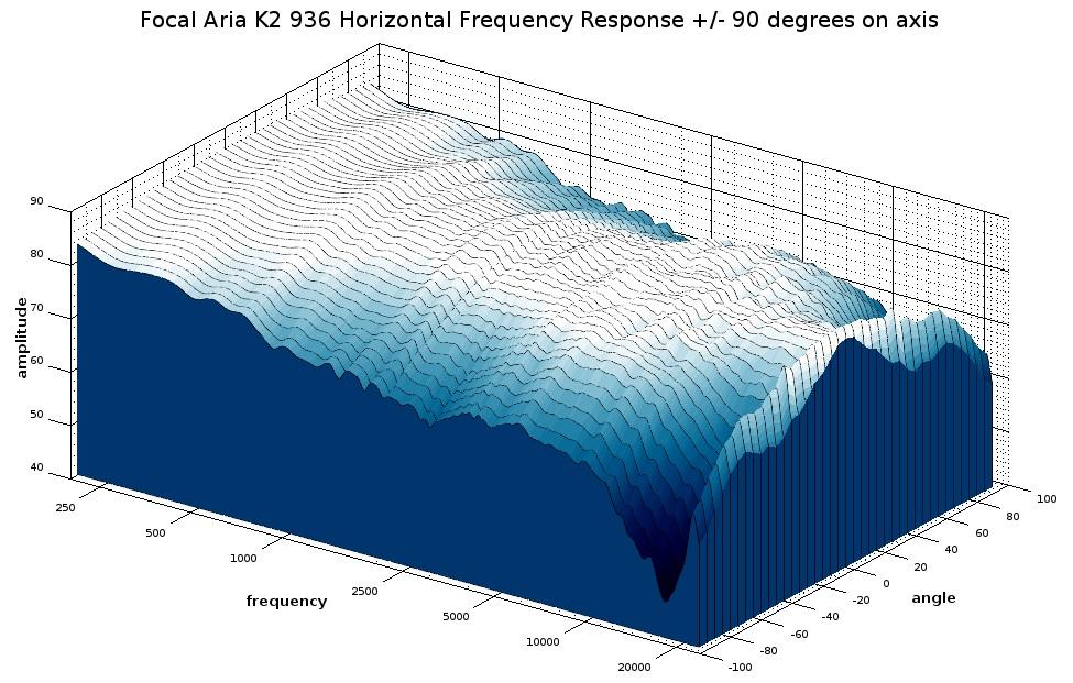

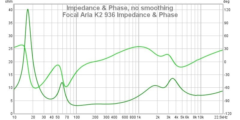

The overall design of the Aria K2 936 speakers is not radically different than traditional tower speakers, and they differentiate themselves mostly in the details. The basic design is a three-way tower with three 6.5” bass drivers, a midrange, and a dome tweeter. While that is hardly a revolutionary design, it can be a very good one if executed correctly, and the proper execution lies largely in the details. Now, let’s dive into the details and start at the top with the tweeter.

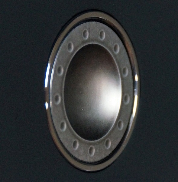

936 tweeter

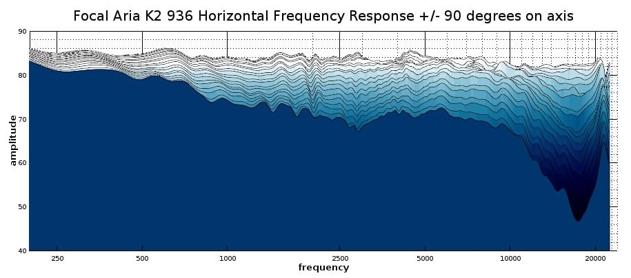

Focal uses their usual inverted dome shape for the tweeter. Focal claims that the inverted dome shape helps to narrow directivity versus normal convex dome tweeters. It also enables the use of a smaller diameter voice coil fixed directly to the dome, and this should make the moving assembly lighter and more rigid. The tweeter dome itself is made from an aluminum/magnesium alloy which should be stiff enough to maintain its shape up to a very high frequency but light enough to deliver good sensitivity. Focal touts the tweeter’s suspension using a material called “Poron,” an open-cell polyurethane microcellular foam that Focal says has better dimensional stability (and therefore lower distortion) and no degradation over time. The tweeter is mounted in a shallow waveguide that is intended to maximize horizontal directivity while minimizing diffraction.

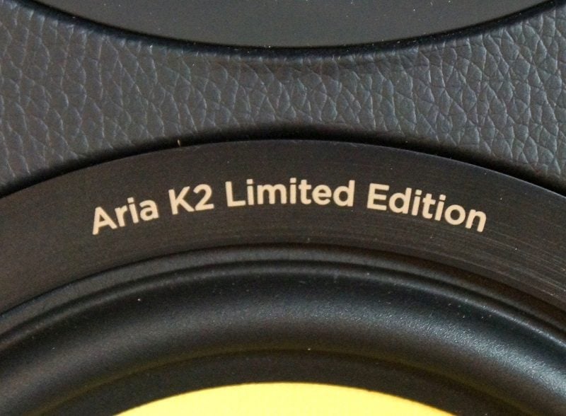

936 midrange cone

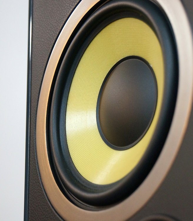

The midrange driver and bass drivers use the eponymous “K2” cone which is composed of a very light foam layer between a layer of Aramid fibers and a layer of fiberglass. This cone composition should help to tame break-up modes out to a relatively high frequency. Break-up modes are how the cone bends out of shape when it moves at frequencies that are too high for it to maintain a uniform shape. This is a serious problem in loudspeaker design because when the cone starts to deform, it can produce some very ugly sounds and ruin the fidelity of the sound. As cones become larger, the frequencies at which break-up modes occur become lower, and the Aria K2 936 has a relatively large midrange 6.5” cone along with a high crossover frequency of 3.1kHz, so it will be very important that measures are taken to keep break-up modes out of audible bands before the tweeter takes over.
936 bass cone

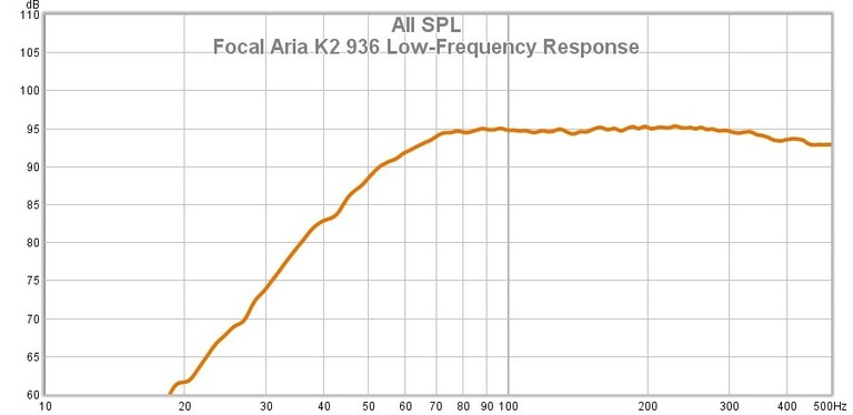

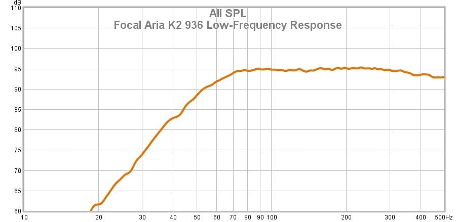

936 rearWith a large midrange cone, the K2 936 should have pretty good sensitivity and dynamic range in the midrange’s frequency band. Add to that the three 6.5” bass drivers, which have a combined area slightly greater than an 11” cone, and this speaker should not be lacking in dynamics, especially in such a good-sized enclosure. The enclosure itself has three ports. There are two front-firing ports and a larger-diameter down-firing one. All three ports are flared on both ends. The down-firing port has a 3 ¾” depth with a 2 ½” diameter, and the front-firing ports have a 6” depth with a 2” diameter. I would have guessed that the difference in ratio between the shape of these ports means that they will have different resonant frequencies with the down-firing port having a higher resonant frequency than the front-firing ports, but Focal says that the down-firing port actually has a lower tuning frequency than the front-firing ports.
The bass drivers are crossed over to the midrange at 260Hz, and the midrange crosses over to the tweeter at 3.1kHz, and that gives the midrange a fairly wide bandwidth, although Focal does not disclose the slopes of the filters. This keeps the phase rotation of crossover filters out of much of the vocal range, and that could help to keep a natural sound in singing and speech. Interestingly, Focal does not include the option to bi-amp or bi-wire the driver sections. As regular readers of our reviews will know, this isn’t a bad thing, because it avoids the potential mistakes that many users make when trying to take advantage of that ability. It can often cause more problems than the benefits it can bring. I like the high-torque binding posts that Focal uses. They make it very easy to get a tight fit on a bare wire connection.
936 base
The weighty aluminum base does a good job of planting the speaker to the floor, and these would not be very easy to tip over despite their height. As was mentioned before, they are slightly angled back, but the spiked feet can be adjusted by an included spanner to change the angle. That adjustability also means that they can be changed so all four feet can rest evenly on an irregular floor surface. There are rubber pads on the bottom of the base, so the base can rest on the floor without the spiked feet if the user doesn’t want to use the feet. There are also spiked feet covers in case the user wants to use the feet but wants something softer than bare metal spikes. The grille is held on by magnetic grille guides and wraps an acoustically transparent fabric over a plastic frame with a hexagonal mesh over the entire area. This grille actually would protect the speakers from a physical impact, but it probably causes some diffraction and wouldn’t do the speaker any favors as far as performance goes, but any acoustic disadvantages brought on by the grille would likely be minor.
