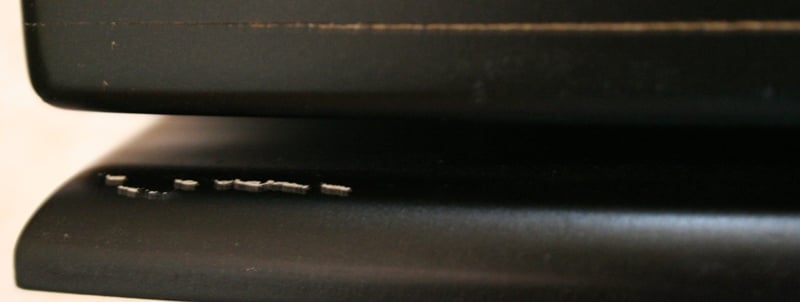

The only problem I had with the
packaging was that the foam was a little thin and weak. When I removed the
speakers, I was pretty much left with foam bits. One of the speakers also had a
bit of damage on the bottom with some scratches on the plinth. Just above that,
where the bottom of the speaker attaches to the sides looked like there was
some splitting (I noticed a bit of this on the top too). As far as I could
tell, it was just a crack and didn't seem to be separated. If I was purchasing
the speakers, I'd have it replaced but for the purposes of this review, I
didn't think the damage would affect the performance. Later on, I measured both
speakers and they did, in fact, measure the same.

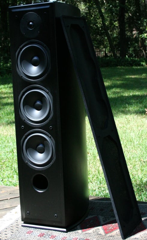

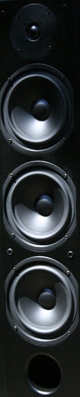

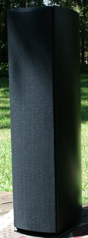

The
finish on the speakers is a flat black that feels slightly textured to the
touch but looks smooth. eD has opted to paint their speakers rather than vinyl
wrap them. All the edges and corners are nicely rounded. The front of the
speaker sports a full length grill with no additional adornments. If you want
to know who made your speakers, you'll have to turn it around. A logo somewhere
on the front would be a nice addition (even if it was under the grill). The
grill is made of MDF and is very sturdy though the fabric itself is run over a
fine wire mesh that is strong enough to keep it bowed but not so strong that
you should push against it when mounting the grill. The grill is held on by six
plastic posts that are thick enough that I wasn't worried about them breaking
off. The grill seemed to be snug enough though it did come off a little too
easily. Over time, it seemed like it might get even looser with frequent
removing..

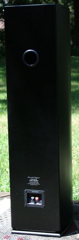

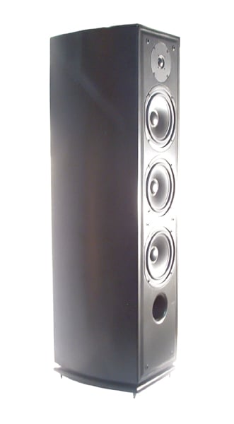

There is a front port near the bottom and a second on the back just between the tweeter and the topmost woofer. The front port is covered by the same wire mesh/fabric mix used on the grill. The back port doesn't have this. The front baffle is raised and there is a 1.3" tweeter and three 6.25" woofers flush mounted. All the drivers are black as is the speaker. If you are looking for speakers to disappear in a dark room, you could do worse than the A6-6T6. If you are looking for a good looking speaker, you could do a lot better. Then again, at $500 a pair, there really isn't all the much to complain about.
The plinth arrived already
attached. Since the plinth is the same size as the speaker, I'm not really sure
why it is there except for aesthetic reasons. Personally, I'd prefer a
removable plinth (I suppose it is removable since you can see the screws though
I wouldn't without talking with eD first) or none at all. There are metal

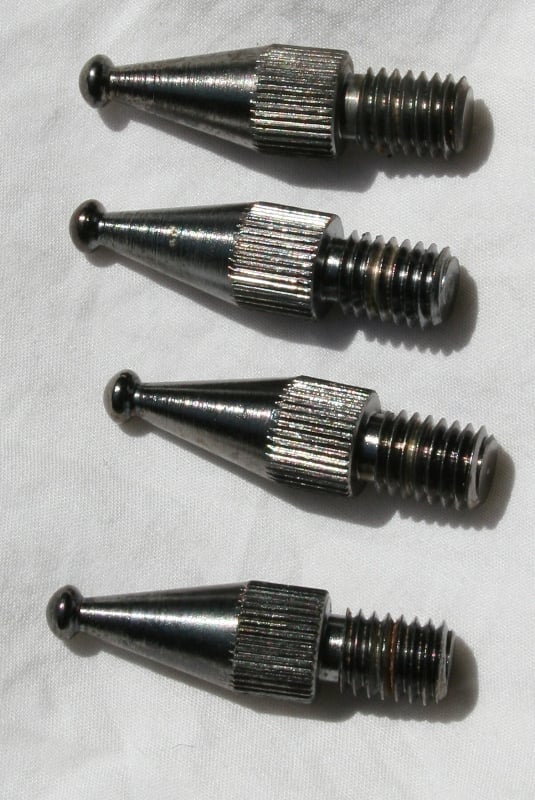

threaded inserts for the provided carpet spikes. There are no provisions for
wood or tile flooring. The spikes are of the "jester hat" variety
with a small ball on the end. They focus
enough pressure to push through to the
bottom of your carpet but they won't pierce through it. They would work well on
those little metal discs that are sometimes used by people when wanting to use
spikes on hardwood floors. The speakers aren't extremely heavy (55lbs) so if
you're careful, you might be able to use them directly on hardwood or a tile
floor, though I wouldn’t recommend it. As a carpet spike they aren't as
effective as the sharp ones. I did like the overall design, however, as they
were easy to install and had a uniform starting point. They didn't have an
adjustment nut so any adjustments you make have no way of being locked into
place.

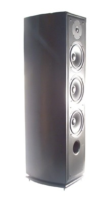

The
speakers are 40" high with the tweeter about 36.5" off the ground
(just a hair above my seated ear level). The sides are rounded which gives the
speakers sort of a bloated look (that sounds worse than I mean it). I've had
experience with a lot of different speaker designs and one thing I've found
with the ones with the rounded sides is they tend to be less sturdy. With the
carpet spikes that don't penetrate the carpet, my medium pile carpet, and
rounded sides of the speaker, I ended up with a speaker that wasn't as steady
as I'd have liked. I never got the impression that it would tip over, though,
so unless you have really active kids or a Great Dane, you should be alright.

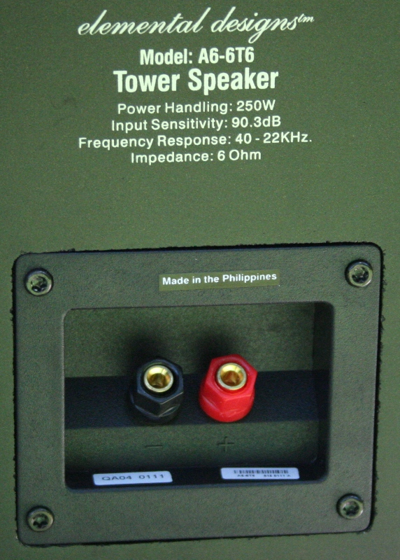

The
back of the speakers sport a single set of five way binding posts in a plastic
housing. This is pretty standard stuff including the binding posts which are of
the gold plated post but plastic top variety. You'll recognize these as similar
to the ones that are included on the back of most A/V receivers. At this price
point, 5-way binding posts are most likely a cut above the competition which
probably sport the spring type. At least you can use banana plugs with them. I
also commend eD for restraining from putting dual binding posts on the back for
bi-wiring. This would have been a ridiculous addition that would have added
unnecessary cost to a budget speaker.

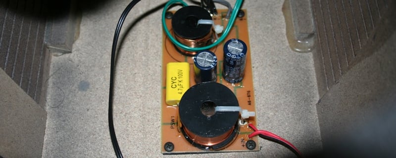

Opening the speakers, I noticed a
few things. First, the two ports vent two different chambers of the speaker.
The first chamber (from the top) includes the tweeter and first woofer. The
second chamber has the bottom two woofers and the rest of the speaker length.
The edges all have additional bracing. Each chamber has one other brace running
horizontal. Since the top chamber is smaller, this makes that one much more
inert than the bottom. This is borne out by the "knock" test which
showed the bottom chamber ringing much more.

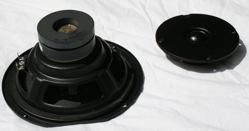

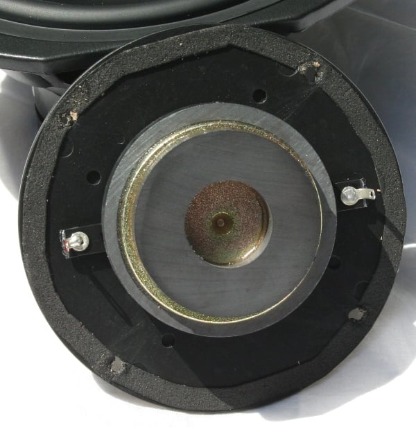

The woofers employ stamped baskets and small magnets. I was particularly surprised at how light these drivers were. The tweeter has an open back (something I haven't seen for a while) instead of a metal or plastic enclosure. Behind the drivers around the sides and back is a single piece of polyfil. The crossover contains two air core inductors, one for the high pass section and the other for the low pass section. Though they aren’t orthogonally oriented to reduce crosstalk effects, they are spaced far enough apart to minimize any audible effects. A polyester bypass capacitor is used in conjunction with two electrolytics for the HPF section of the speaker system.
Though the eD website claims the drivers are video shielded and even show the metal can usually employed for this application, there was no steel can encasing the motor. This should still provide adequate shielding if not placed directly on a CRT type TV’s. Glancing over the website, most of the information is accurate about the speakers design (including the technical drawings) though the claim that the widened base increases stability is dubious at best. If it is wider than the body, it is millimeters wider. If they really want to increase stability, they are going to have to substantially expand the base. Also, the drawing of the spikes in no way resembles what I received. In their defense, the picture of the base in the gallery clearly shows how wide the base is and the actual spikes you'll be receiving.

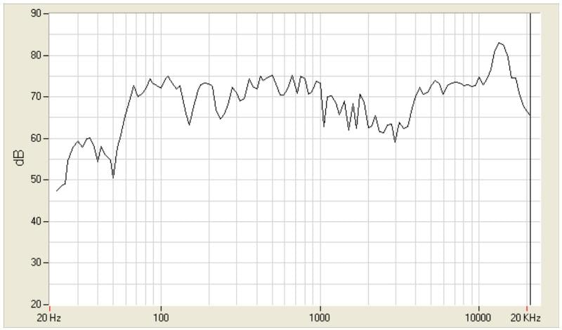

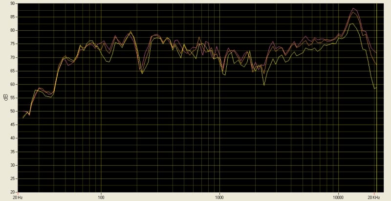

Measurements & Testing
For laboratory measurements I used the Sencore SP395A FFT Audio Analyzer and a Sherbourn 2/75B amp, I measured the A6-6T6's in room on and off-axis frequency response with 1/12th octave resolution. Like most speaker manufacturers, eD lists the frequency response of their speakers on their site. Also like most speaker manufacturers, their graph resembles mine in a "had the same father but different moms" sort of way.
A6-6T6 1 watt/1 Meter Frequency Response (1/12th Octave) On Axis
The 15kHz peak we see in the frequency response is caused in part by the diaphragm ringing. This is an issue with the geometry of the tweeter. It can likely be mitigated or eliminated by choosing a different diagraph radius and/or material. The manufacturer would be wiser to select a smaller dome tweeter of proper design as its more challenging to make larger dome tweeters retain linearity to the frequency extremes of human hearing.
A6-6T6
1/2 Meter Frequency Response (1/12th Octave)
Pink - On axis, Orange - 15 degrees off axis, Yellow - 30
degrees off axis

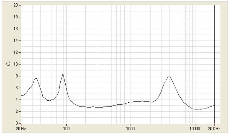

A6-6T6 Impedance
The Sencore consistently measures impedance one ohm low. From a close examination of the above impedance magnitude, it is clear the A6-6T6 low passes the woofer at 2000hz, while the tweeter is crossover over considerably higher, closer to 6000 Hz. This may be for a number of reasons, but the resultant frequency response both on and off axis clearly shows a significant droop in the overall output between 1000 and 4000 Hz. The problem with errors in this part of the frequency range is that human hearing is particularly acute in this region, and not terribly forgiving of mistakes.
The octaves on either side of 2000hz result in the greatest contribution to intelligibility more than any other two octaves in the audible range. As Paul Klipsch was known to say, “We live in the midrange”. A better crossover design would likely have minimized if not eliminated this problem entirely.
