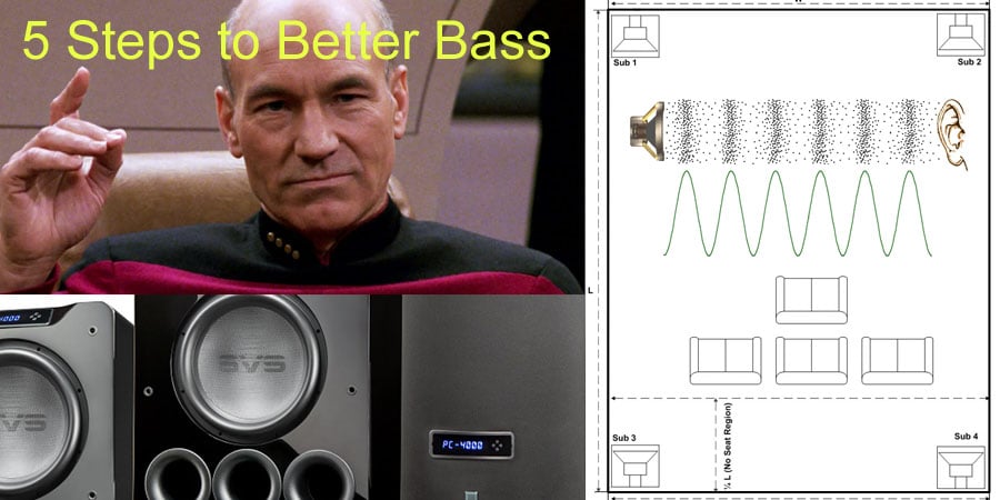

Location (preferably multiple subs) - Follow our pictorial guidelines in our Subwoofer Setup Article for suggestive placements or our Subwoofer Crawl. There are multiple locations that can work in your room so finding the right spots is worth the effort to greatly improve sound quality and depth.
Positional EQ (Listening seat location) - where you place your listening seats also determines sound quality NOT just in bass but for the overall home theater surround envelop. Keep your seating away from back and side walls if possible. Backwall placement is a maximum pressure zone where you will hear very loud but not accurate bass. If you can move the couches at least 1/4L of the room away from the backwall, you will ensure more accurate bass reproduction.
Again follow our Subwoofer Set Up Guidelines and diagrams for suggestions.- Positional EQ - Believe it or not you can equalize the sound of your speaker/sub system simply by moving your theater chairs or couches. Proper seating location can have a huge impact in the quality of bass you hear. You generally want to avoid placing your seats up against a back or side wall. We recommend locating the seats at least 1/4L (L = length of the room) away from the back wall to reduce excessive bass energies caused by build up of standing waves. Locating a seat to a sidewall will shift the balance of the sound towards the closest surround speaker while also severely impacting stereo imaging of the front left/right speakers. Instead, apply symmetry and line of sight principles when locating your couches so that every seating location has a direct unobstructed path of sound to each speaker and the front left/right speakers are equidistant for true stereo imaging.

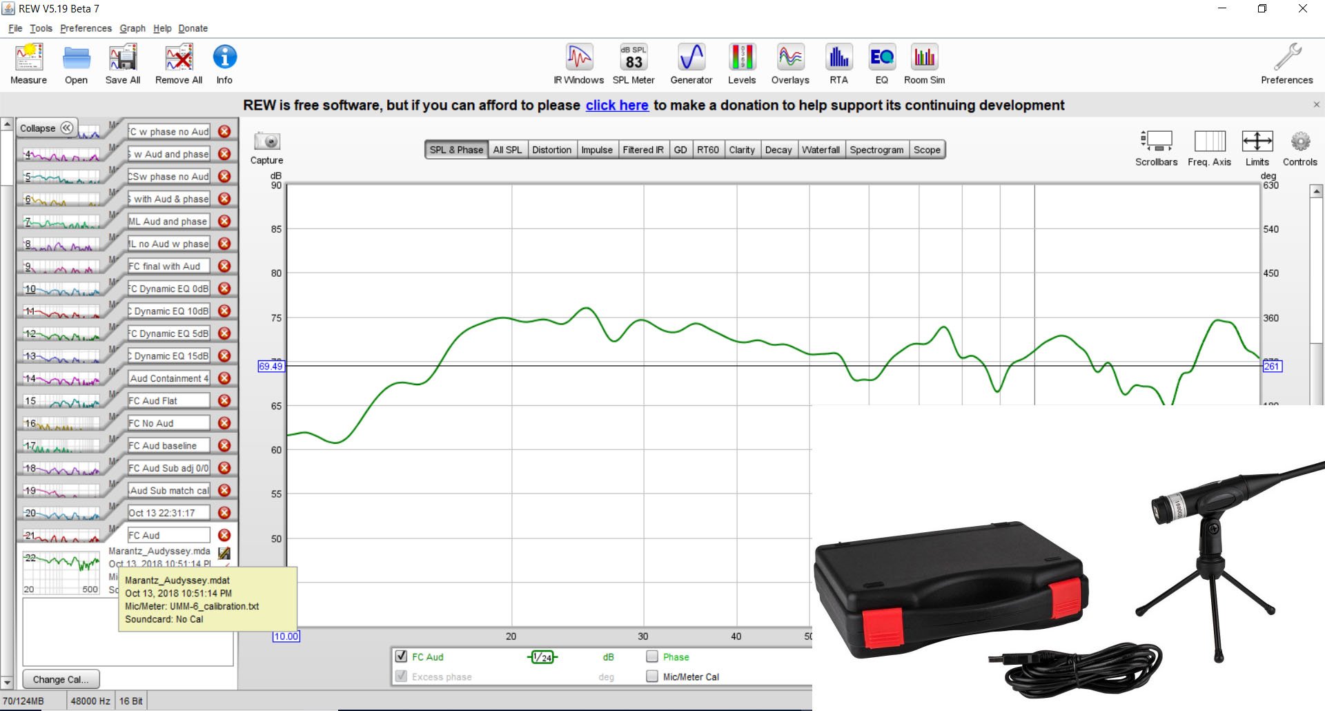

*Note 1: It is critical to use measurements to guide you towards better bass! REW is a very powerful and easy to use FREE measurement software system. Coupled with a calibrated USB microphone like the UMM-6 from Dayton Audio, you can use an objective process to tuning bass response in your room for more accurate and consistent results.
