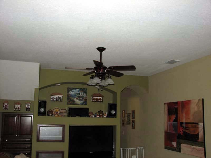

RoomI chose to perform this experiment in the Family Room system of the Audioholics Showcase home. This room is quite typical of what I’ve seen in many homes. It has 10ft ceilings and is open to the rest of the house which makes it quite challenging to get good sound in, let alone respectable bass response. For the past three years, I was using the venerable Axiom EP500 subwoofer located towards the left front of the room behind one of the couches. For a single subwoofer installation, I found this to be the best location for performance and aesthetics as the couch and blinds did a great job hiding this beast.

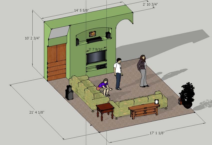

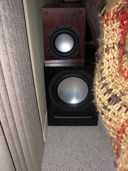

Living RoomI left my EP500 towards the left front corner behind my couch as it has been for the past 3 years. I placed one EP400 on top of it and the other EP400 diagonally located towards the back right of the room. Luckily the distance between both EP400s was relatively equal to the primary listening area making it much easier to integrate them and not have to worry about bass cancellations due to mismanaged time alignment between the two subs. I checked the phase and found they integrated best with both subs set to 0 degrees (default). I always recommend using symmetry when placing your subwoofers relative to the primary listening area.  If for some reason you can’t, then it’s usually best to average the distance between the two subs for the electrical delay in your processor and tweak from their using variable phase or EQ to better hone in your response. The electronics include the new Yamaha RX-Z7 A/V receiver, Denon DVD-2930CI DVD player, Emotiva MPS-1 7CH power amplifier, APC H15 power conditioners and a 57” Samsung DLP RPTV. All HDMI and toslink cables are Sonicwave from Impact Acoustics and all speaker cables (10awg) and interconnects are from Blue Jeans Cable.

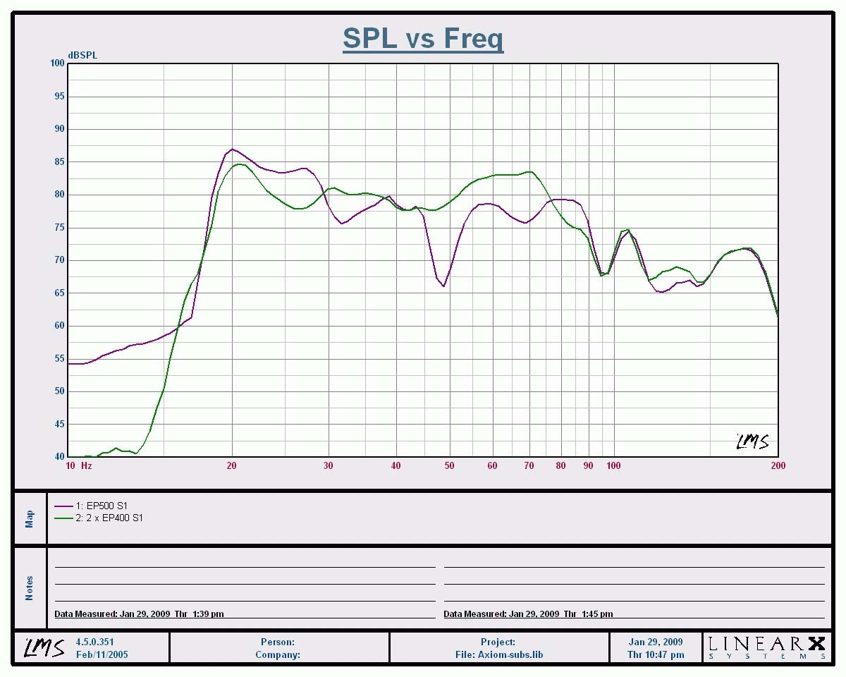

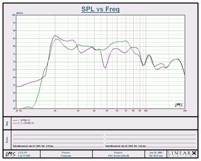

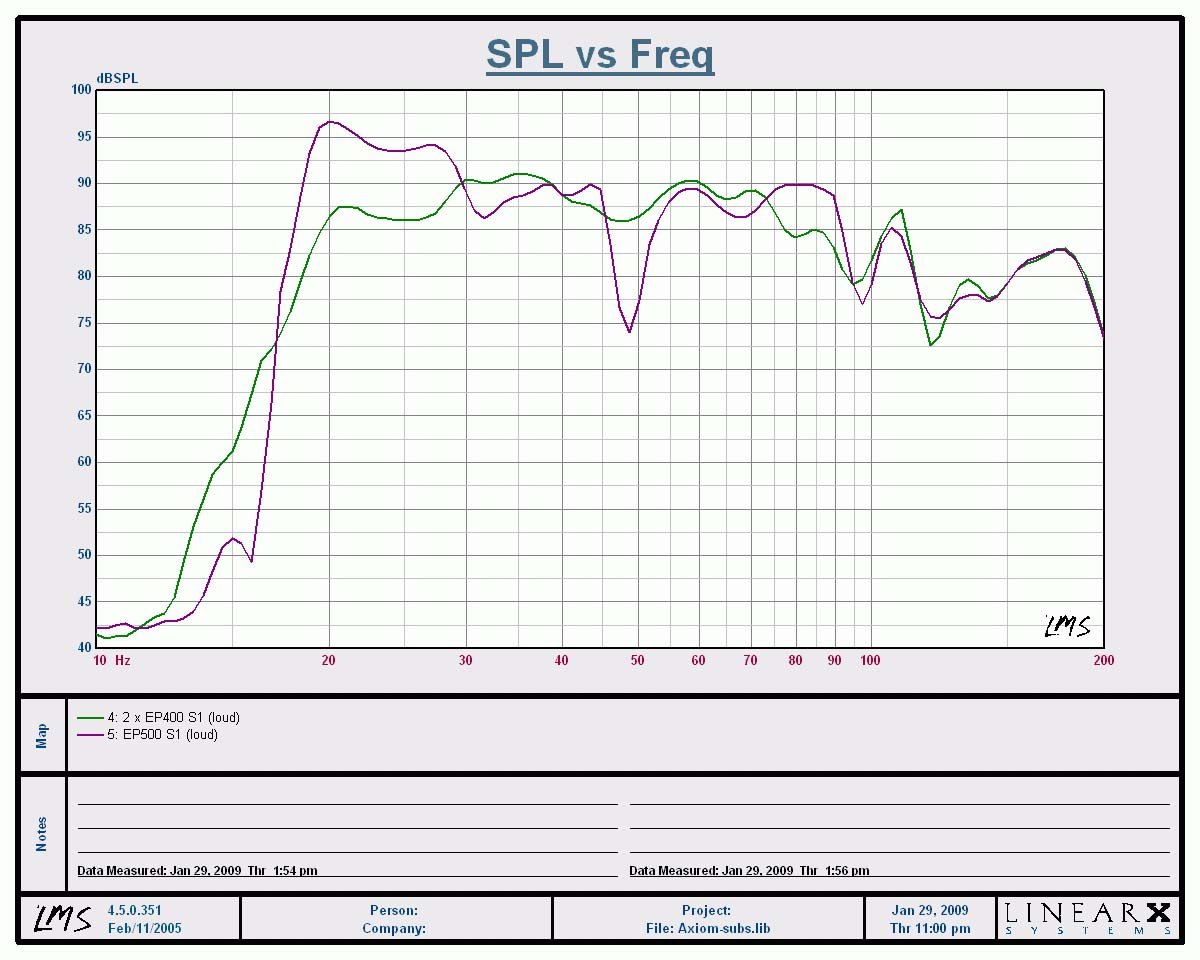

When setting up subwoofers in a home theater system, I always measure the response to ensure I am at least in the ballpark for great bass. I run sweeps using LMS or my Sencore SP495C Audio Analyzer, adjusting placement, crossover settings, phase and electrical distance until I measure the most linear response at my two primary listening positions. I tweak as needed to improve the other seats but usually if I get at least the two money seats right, the others aren’t so bad, especially with the multi subwoofer advantage.
After level matching the EP500 and two EP400s, I was ready to do a direct comparison between them integrated into my family room theater.
EP400vs500S1
EP500 vs 2 x EP400s at Primary Listening Seat
The purple trace represents the single EP500 while the green trace represents two EP400s. As you can see the dual EP400 response is much more linear across the entire frequency range. Gone is the 10dB suckout centered around 48Hz. This is a fairly narrow suckout with a Q roughly 4.8 so it’s possibly audible and really only fixable with multiple subs rather than EQ’ing. On the downside, some output was lost in the 25-30Hz region going from the EP500 to the 400s but the response was much flatter as well. Looking at the overall response of the EP400s you will notice an in-room bass response of 20Hz to 90Hz +-3dB. Not bad considering no electronic room correction was used to optimize the response.

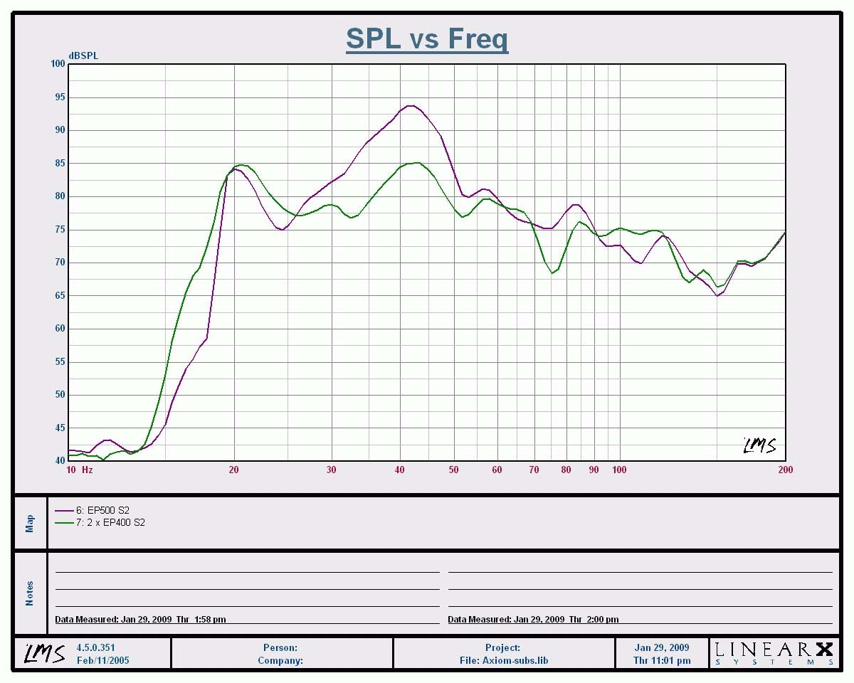

This is the mother-in-law seat we discussed earlier. As you can see in the purple trace, the bass response of a single EP500 at this listening position suffers a huge 12dB low Q (1.7) peak centered around 42Hz. This is clearly audible at that seat and makes the bass sound very boomy and muddy. While this could be tamed a bit with EQ, I’d risk adversely affecting the other seats since it’s a rather drastic problem needing a lot of cutting to resolve. The best solution of course it adding a second subwoofer as can be seen in the green trace via the dual EP400 subs. This response is much better and certainly far easier to optimize via EQ than the purple trace is.
Because I wanted to directly compare the audible sonic differences between the single EP500 and dual EP400s on the fly, I did not create a customized EQ response for both. As a result, my listening tests were conducted at the two listening positions measured above with no further changes.
EP400vs500 Loud
EP500 vs. 2 x EP400s at Primary Listening Seat LOUD
I was curious to see how the response between these subs changed at high SPL levels so I turned it up to near house shaking levels in my room. It’s rare we ever listen to higher sustained levels except perhaps during big party events which most of our guests are usually a bit too buzzed to take notice of the bass response. You can see the limiting the EP400 is doing below 28Hz to keep things clean and distortion free. To look at it another way, the bass response is only shelved down 4dB below 28Hz at these high output levels to match the rest of the bass spectrum. This is a very smooth and linear response.

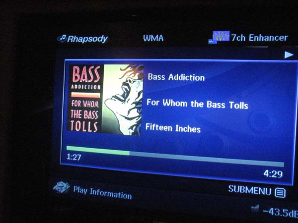

BassIt was time to go a little lower so I fired up my Rhapsody service featured in my Yamaha RX-Z7. I searched out some bass tunes popularized by teenage car audio enthusiasts back in the 90s. I am not a fan of this crap but I wanted to really test out the low end and this was the easiest way to do an instant comparison of the low end bass response. The EP500 was at a big advantage during this test. It played down lower and created a much LARGER tactile response than the dual EP400s. The single EP500 rattled my walls while the dual EP400s did so but at a much reduced level and tactile presence. Overall the bass of the dual 400s was smoother and more defined but true bass heads that listen to this type of so called “music” will prefer the bigger woof that the EP500 offers. For that crowd, I encourage you to consider an EP800 or two.
