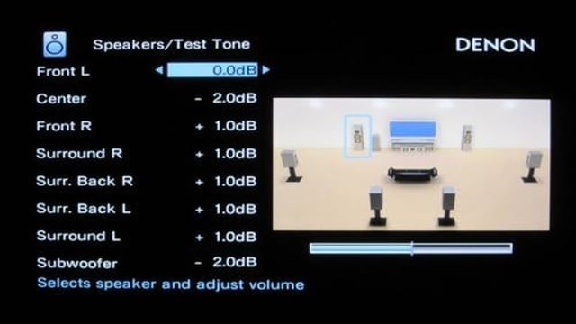

To manually calibrate speaker levels, first you’ll need an SPL meter set to C-weighting, slow. Place the meter with the microphone facing up towards the ceiling at ear height in your primary listening position. From there, set the master volume to 0dB (assuming a relative volume scale) and navigate your A/V receiver’s settings to get to its trim controls / tone generator. While in this menu, your receiver will output pink noise from your speakers, one at a time, and allow you to adjust their relative level. Fine tune the volume until your SPL meter reads 75dB for each speaker and your subwoofer…and that’s it. If you’d like an extra helping of bass, you can boost the subwoofer level 2-3dB to adjust for preference. Likewise, you can also bump up the center channel a dB or three if you have trouble hearing dialog.
Level control / tone generator screen of a Denon A/V receiver.
