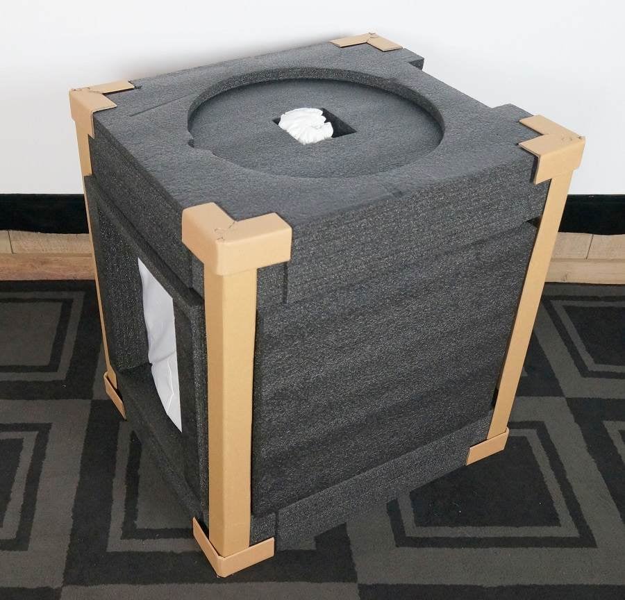

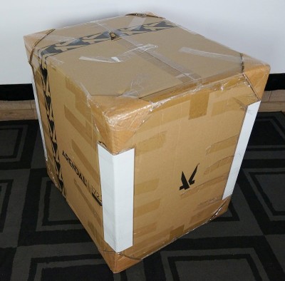

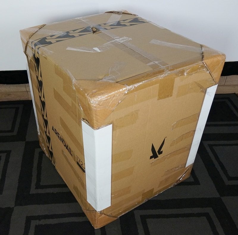

As usual for Arendal, the 2S arrived at my doorstep with excellent packing. The box was wrapped in a multi-layer black shrink wrap with security tape around the edges. There were dense cardboard edge protectors on both the inside AND outside of the box, as well as corner protectors inside and outside. Inside the box, the sub was surrounded by thick polyethylene foam blocks covering all sides of the sub instead of just the top and bottom that we traditionally see. The sub itself was wrapped in a silky fabric drawstring sack as we see with other Arendal products. The packing also came with a pair of white cotton museum gloves to unpack the sub without getting fingerprints on it. Outside of shipping items in wood-crated boxes or aluminum flight cases, Arendal’s packing is the best in the business, but it must be good to survive the rigors of parcel shipping.

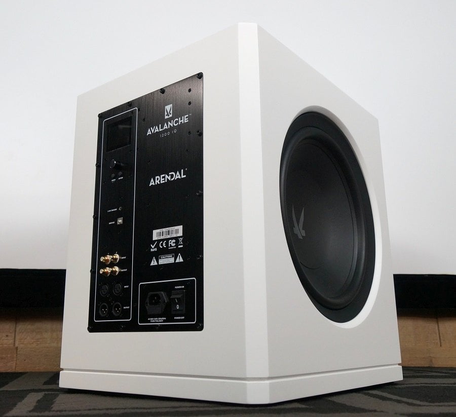

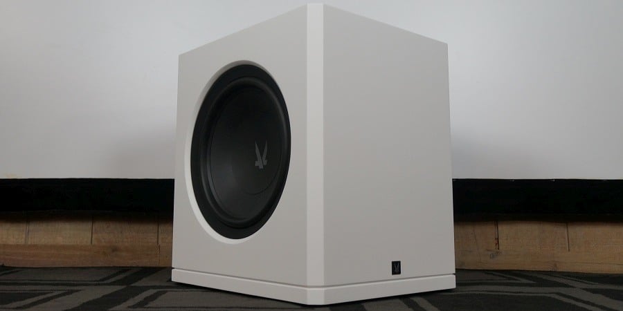

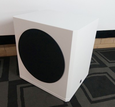

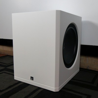

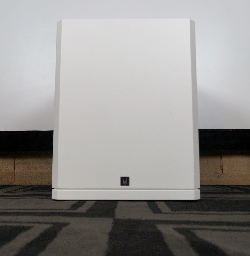

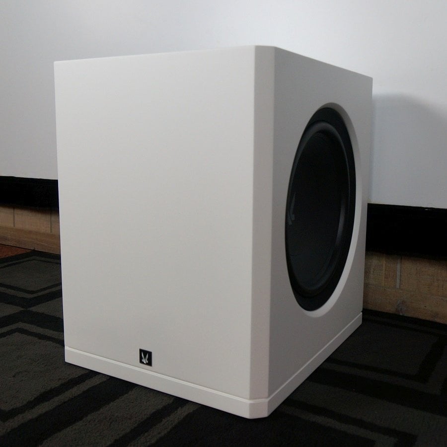

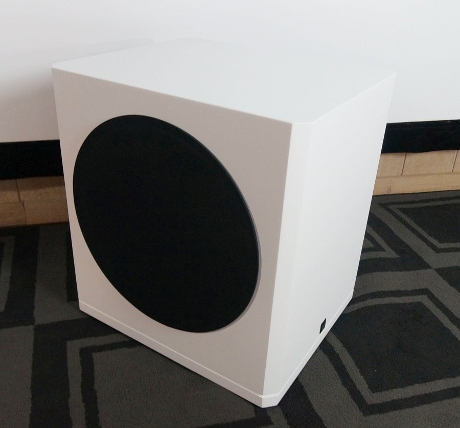

Once unpacked, the 1723 Subwoofer 2S reveals itself as an attractive, minimalist piece. It’s not a huge subwoofer but it can’t be accused of being small either. By my (admittedly skewed) standards, I would call it a medium-sized sub. The design accentuates the vertical dimensions by beveling the vertical edges, and this gives the sub a ‘monolithic’ look (idea for an installation artist: make a scale model recreation of Stonehenge by using these subs). Also adding to the monolithic look is the drivers being mounted on the sides rather than the front. The bottom of the sub has a ringed groove around the lower panel which gives it a more stately appearance. The finish that I received was an impeccable satin white, but the sub can also be had in black satin or black gloss as well as white gloss. The finish quality here is excellent, but buyers have a right to expect that at this pricing.

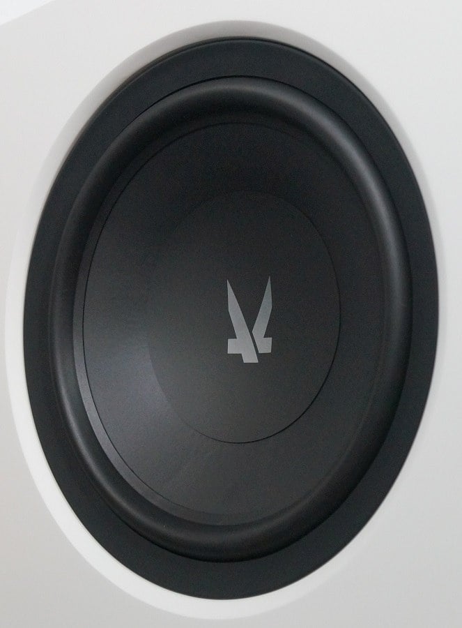

The cones are sunken in the enclosure with a chamfered edge that leads to a rubber trim ring. The cones themselves have a smooth concave dustcap with an Arendal logo printed in the middle. They can be hidden by grilles that magnetically adhere around the trim ring. The grilles use black fabric draped over a frame and so stand out on the white subwoofer that I received, but I would imagine they would have a better aesthetic fit on the black finished subs. If the cone is not in danger from rambunctious children or pets, I would advise users to leave the grilles off because the sub looks a lot cooler that way.

2S coneThe 1723 Subwoofer 2S shares a lot in common with previous Arendal subs that we have already reviewed, so I will be borrowing design descriptions from those reviews where applicable. It is essentially the 1723 Subwoofer 2V but in a sealed enclosure. In other words, it takes Arendal’s 1723 subwoofer driver and uses it in a dual-opposed configuration in a smaller sealed cabinet and drives it with the same 1,200-watt amp found in the 2V. For more detail, we will simply crib from the 2V review where applicable since they use the same components except for the enclosure.
The cones are made from a combination of long fiber pulp and fiberglass and are attached to the baskets with a nitrile-butyl rubber surround and a Connex spider. The voice coil has a 2” diameter and uses aluminum wiring around a polyamide former. The basket is a thick stamped steel frame that connects to a beefy motor comprised of a 1 ½” stack of two magnets that are 6” in diameter. There is a heavily bumped-out backplate for longer excursions with a reduced risk of hard bottoming, and venting is done under the spider. There are multiple aluminum shorting rings used for reducing inductance. Arendal claims it has a 50% higher excursion than the previous generation of 1723 subwoofers. The two 13.8” cones add up to a lot of surface area, about the same surface area as a single 18” cone, and that combined with the high excursion means the 2S should be capable of moving a lot of air.

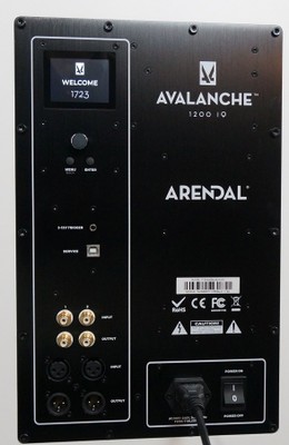

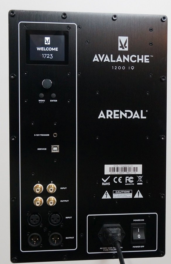

2S amp plate2The drivers are powered by a 1,200-watt RMS class-D amplifier that Arendal calls the “Avalanche” amplifier. The user controls the 1723 2S sub not through traditional knobs but rather through a 2.6” color LCD screen. This enables a lot more control over the sub than an array of knobs. You can adjust how each input is controlled individually, and aspects of control include different crossover slopes as well as high-pass slopes, wake-up times and wake-up sensitivities, operating mode selection, and even a 7-band parametric equalizer. The 1723 2S has a pair of RCA inputs and outputs as well as balanced XLR inputs and outputs. The outputs can be handy for daisy-chaining subs in a multi-sub setup as well as running the signal to some active speakers. Balanced inputs and outputs also make the 2S a great choice for pro-audio setups or recording studio systems.
A subwoofer needs highly sophisticated processing to deal with all of that, and the Avalanche amp has that with a 32-bit microcontroller. The microcontroller is also constantly monitoring performance parameters so that the sub is always operating in safe conditions. Some of the parameters monitored include output voltages, power supply rail voltages, and amplifier temperatures. If it senses anything amiss, it immediately shuts down the unit to prevent damage.

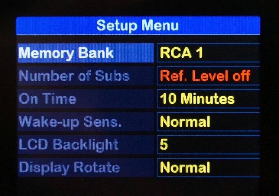

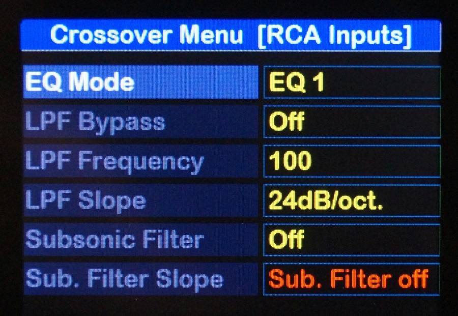

The 1723 2S can be controlled by an app for iOS and Android for those who don’t want to have to get up off their sofa to change the settings of the subwoofer. All the same settings from the LCD screen can be controlled by the app. The app also has a test tone for when you want to make sure it can produce a signal. One nice thing about the app is the graphic display of the parametric equalizer for those who want to see the effect that their changes have on the response. The app also has a time delay setting that can be changed by 0.25ms increments out to 50ms which can come in handy for situations in a multi-sub system where the subs have different distances. The ability to change time delay can synchronize all the subs so that their arrival of sound can hit the listening position simultaneously.
2S screen crossover menu   2S screen setup menu
With a 7-band parametric equalizer, each Arendal 1723 subwoofer has a great deal of flexibility in taming the response from the inevitable damage inflicted by typical room acoustics. What is more, a multiple 1723 subwoofer system can be globally controlled as subwoofer groups in the Arendal sub app, so that equalization can very easily be extended to multiple units, which is the best way to equalize low frequencies in a multi-sub system instead of having a different equalization for each sub. That feature, plus the ability to set delays in such fine increments on each sub, essentially does away with the need for external equalization in a multi-sub system altogether. All the user has to do is measure the system response and make the required changes in the app. With this ability, it's worth experimenting with higher crossover frequencies in a multi-sub system as well since room modes don't stop at the standard 80Hz crossover frequency. With a multi-sub system, localization from higher crossover frequencies will be less of a concern since the bass will likely be emanating from several different directions, thereby balancing out any particular localizable source.

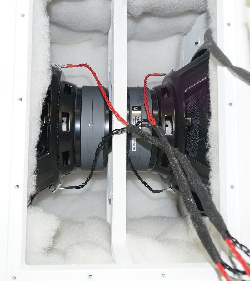

2S internal2
The drivers and amplifier are mounted in a stout high-density fiberboard enclosure that constitutes the bulk of the weight of the unit. The driver mountings are 2” thick, and the side panels are 1” thick. There is a ¾” thick windowpane brace running along the length of the cabinet to reinforce the lengthwise mid-section, along with plenty of stuffing to help damp rear pressure waves. An elegant touch is the mounting of the drivers on opposite sides of the cabinet. The mechanical transfer of energy from the moving mass of the drivers to the enclosure is canceled out completely by the opposite driver per Newton’s laws of motion. This means that the drivers impart no rocking motion on the cabinet. Contrary to popular belief though, there is still a need for a braced cabinet since dual opposed driver mountings do nothing to alleviate resonances from internal pressure forces.

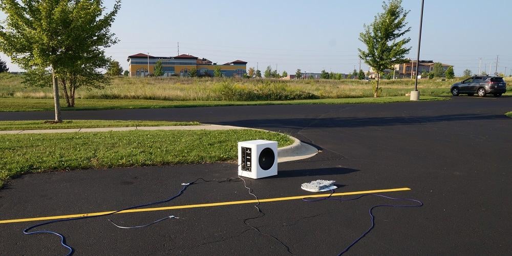

2S outdoor testing

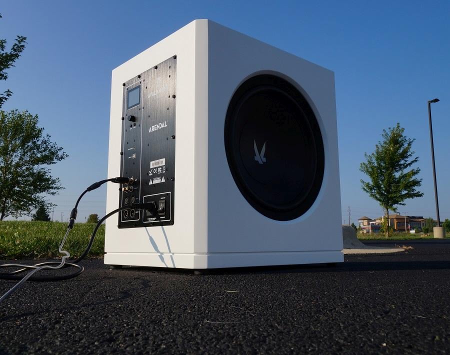

Testing on the Arendal 1723 Subwoofer 2S was conducted with the microphone facing the woofer at a 1-meter distance with measurements scaled back to a 2-meter distance by subtracting 6dB. The temperature was recorded at 75F degrees with 76% humidity. The subwoofer’s gain was set to maximum, phase was set to zero, and the low pass filters were set to bypass.

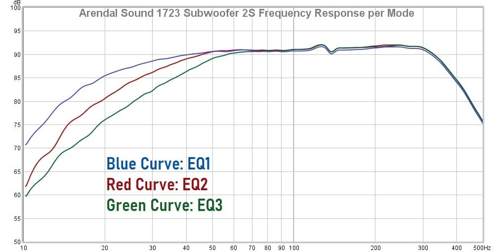

2S Frequency Response
The above graph shows the measured frequency responses for the 1723 Subwoofer 2S. Depending on the selected mode, users can have a beautifully flat response from 30Hz to 300Hz. Of course, the room will wreak havoc on this pristine response, so any subwoofer having such exquisite neutrality doesn’t really matter, but it is still nice to see. EQ2 and EQ3 will roll off the response and reduce the deep bass output, and that may come in handy for rooms that get a lot of low-end gain so that the bass does not become too bloated. EQ3 has the most natural ‘sealed’ type of response, but DSP equalization was doubtlessly used to create that response, so I would guess that isn’t the natural response of the drivers within this enclosure. One aspect that I like about this performance is the upper-end extension all the way to 300Hz. That enables the user to experiment with higher-than-normal crossover frequencies which can bring a host of benefits, especially in multi-sub setups.

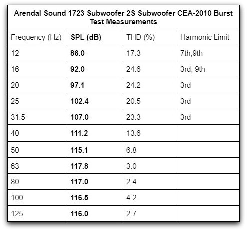

2S CEA 2010 table2
the 1723 Subwoofer 2S is a real corker among sealed subs.
The above CEA-2010 measurements are short-term bursts that show the subwoofer’s clean peak SPL before heavy distortion sets in. Our measurements have been referenced to 2-meter RMS, which is 9dB down from the standard requirement for the measurements to be shown at 1-meter peak. However most publicly available CEA-2010 measurements are shown at 2-meter RMS, so we followed that convention.
Bassaholics LargeThe 2S puts up some pretty serious numbers here, especially given the size. 115dB+ at 50Hz and above is some pretty beastly mid-bass output, and the deep bass is great for the class as well. These numbers do significantly depart from Arendal’s posted burst test numbers at some frequencies, and that is not surprising given the design of this sub. Existing measurement techniques are not standardized well enough to fully capture the output of subwoofers with opposite radiating surfaces. Unless I measured the sub in the exact same manner that Arendal tested the sub, I would not expect to duplicate their results. Another factor that might have led to my somewhat lower measurements versus Arendals is that I tested the sub on relatively fresh asphalt on a sunny day. Even though the day was not especially warm at around 75 to 80 degrees, the reflective heat off of the asphalt may have led to thermal effects that degraded the total recorded output than it might have had otherwise. This being the case, I would definitely not consider my own recorded numbers more valid than Arendal’s. In either case, the 1723 Subwoofer 2S is a real corker among sealed subs. These numbers corroborate my listening experience that this sub has a tremendous punch.
This measurement set earns the 2S our Bassaholics ‘Large’ Room Rating, meaning it should be sufficient for a 3,000 to 5,000 cubic foot area. For more information on how our room ratings are determined, read our article: ‘Bassaholic Room Size Rating Protocol.’

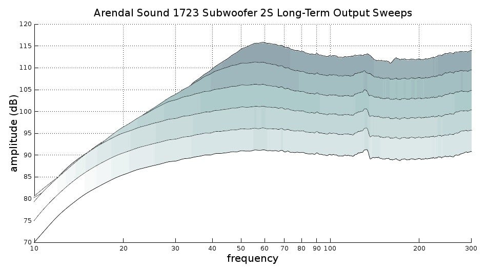

2S long term comp sweeps
Testing for long-term output compression was done by first conducting a 20-second sweep tone where 50Hz hit 90 dB with the subwoofer 1 meter from the microphone (graph has been scaled to 2 meters for easy comparison with our other review measurements). We then conduct further 20-second sweeps by raising the gain by 5dB until no more output could be wrung out of the subwoofer. These tests show us the long-term continuous headroom that the 1723 Subwoofer 2S is capable of.
The 2S shows great capability in terms of continuous output and can belt out more than 110dB above 40Hz for sustained periods. At high levels, we do see compression over-riding its equalized response in EQ1 mode so we do get a peak at what its natural response is more like. I could probably have pushed it even harder for more output above 70Hz, but the response was already compressing heavily, so I decided to end testing at the 115dB sweep since it was already closing in on all the useful output that could be had.

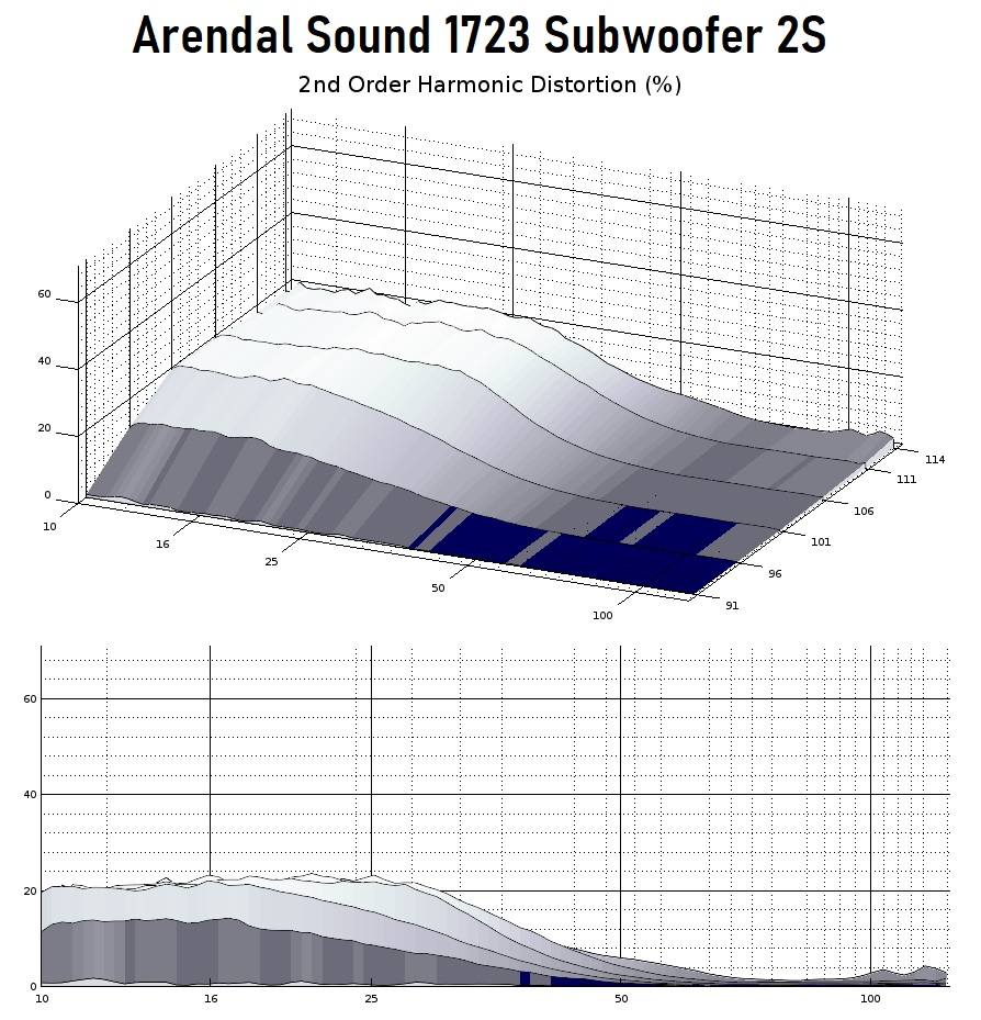

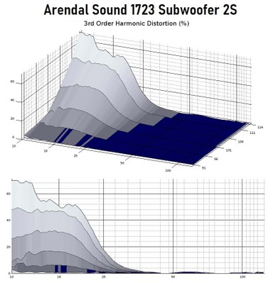

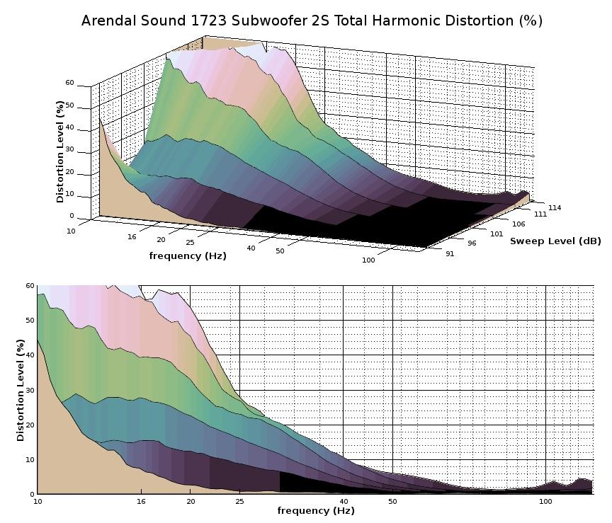

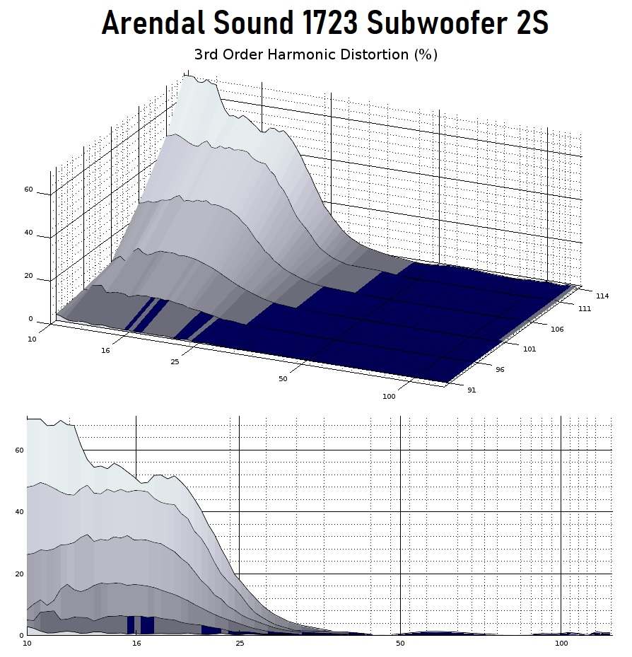

2S THD
The above graphs show the corresponding total harmonic distortion to the long-term output graphs. Essentially, they depict how linear the subwoofer remains for the corresponding drive level seen in the long-term sweeps. The quantity being measured is how much of the subwoofer’s output is distortion and is shown here as a percentage.
We do see distortion ramp up quickly in the low-end as drive levels rise, much like they would in most sealed subwoofers. Distortion rises quickly below 25Hz in the last 15dB or so as the equalized response shape reaches the end of excursion very quickly in deep bass. Deep bass is very tough for sealed subs, since excursion demands quadruple for every lower octave in order to retain the same amplitude level. However, we do see very clean output in mid-bass, even at the highest drive level. At 40Hz and above, the sub can’t really be pushed past 10% THD. At nominal levels, the 1723 Subwoofer 2S produces very clean and well-controlled bass. At 90dB, we see a lot more environmental noise in the measurements than actual distortion, and even then, above 40Hz, it cannot exceed 1% THD. Sealed subwoofers are generally not ideal for seeking high levels of deep bass, and the 1723 Subwoofer 2S is not an exception here. That being said, it acquits itself very well given its size. A ported sub of the same size would only have a performance advantage over a very narrow range of frequencies.
2S 2nd order harmonics   2S 3rd Order harmonics
The above graphs depict measurements of the constituent harmonics from the long-term output sweeps and are what the total harmonic distortion measurements are composed of for the 2nd and 3rd harmonics. These individual harmonics can give us a clue as to what might be the cause of some quirk or non-linearity. We are only showing the 2nd and 3rd here because they more or less reflect the higher even-order and odd-order behaviors, although higher-order harmonics tend to be much further down as a percentage of distortion compared to the second and third.
The most immediate aspect of these graphs that leaps out at us is the 3rd harmonic constitutes much more of the total harmonic distortion than the 2nd. This is not unusual, and it means that the driver is reaching the limits of linear excursion more at both ends of the cone’s throw rather than only in one direction. We do see that there is some asymmetry in excursion at high drive levels since the 2nd harmonic can be as high as 20% below 30Hz. I would guess this is not from induction effects since we see vanishingly little distortion in upper frequencies. Again, these high levels of distortion are only of concern when you blast the sub in deep bass; not a sealed subwoofer’s forte.

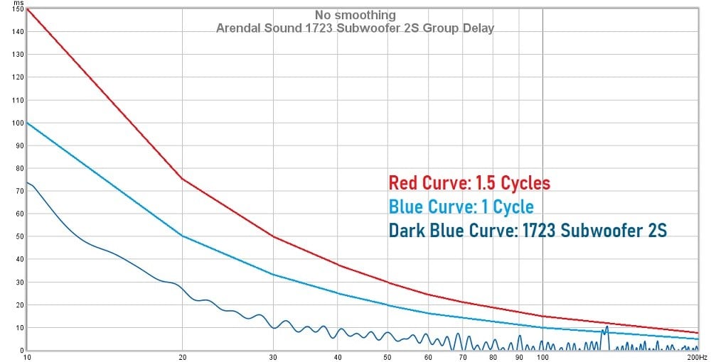

2S Group Delay
The time-domain performance of the Arendal Subwoofer 2S shown is superlative; very musical...
Group delay is the measurement of how much time it takes for individual frequency bands of an input signal to be produced by the speaker. It can indicate that some frequency components are developing slower than others or are taking longer to decay. It is generally thought that 1.5 sound cycles are needed for group delay to be audible at bass frequencies, although there is an argument that group delay should remain under 20ms to be completely unnoticeable, but that is likely meant for mid and upper bass frequencies.
Arendal subwoofers have always done well in time domain performance, and the 1723 Subwoofer 2S is no exception. Group delay is largely kept under 10ms down to 40Hz, and this is the range where it matters most. Below 40Hz, human ability to resolve sound degrades rapidly, so larger values of group delay do not matter as much, but even here the 2S maintains excellent performance, and does not cross our most strict threshold of 20ms until 25Hz. The rise that we do see in deep bass is due to response shaping from DSP equalization, but it is very well controlled and does not crop up into anything remotely audible. The other EQ modes have much the same group delay with only slight differences, so I have not bothered to include them in this graph in order to keep it uncluttered. The time-domain performance shown here is superlative, and anyone who wants a sub that isn’t laggy at all has a great choice in the 2S.
