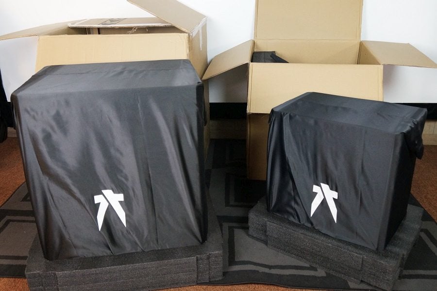

1723 V1 S1 boxes  1723 V1 S1 unpacking2

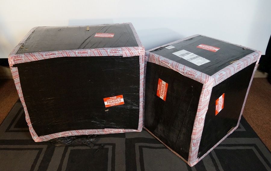

As usual, Arendal’s packing was exceptionally good. They arrived at my home in heavy-duty boxes that were wrapped in a shipping plastic sheet with the edges covered in security tape. Inside the box, the subs were sandwiched by some thick polyethylene foam pieces and covered in a drawstring sack made from a rayon-type fabric, protecting them from scuffs and moisture. The packing included cotton inspection gloves so that the subs can be removed without getting fingerprints on the finish.
1723 V1 S1 grilles2   1723 V1 S1 pair6

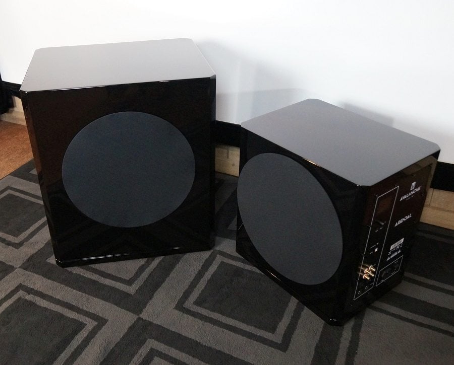

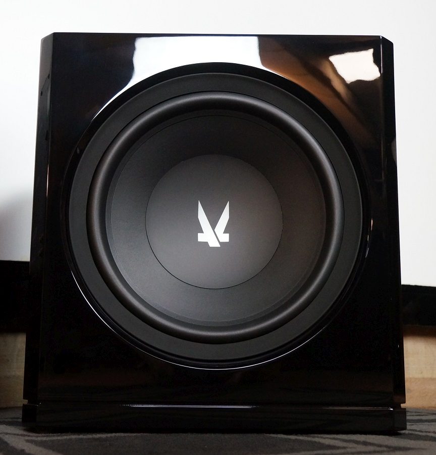

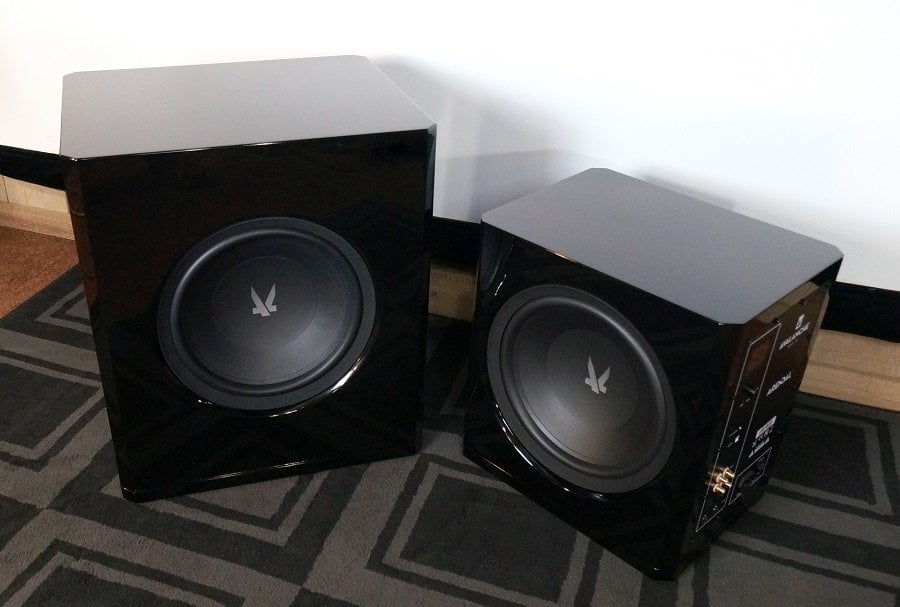

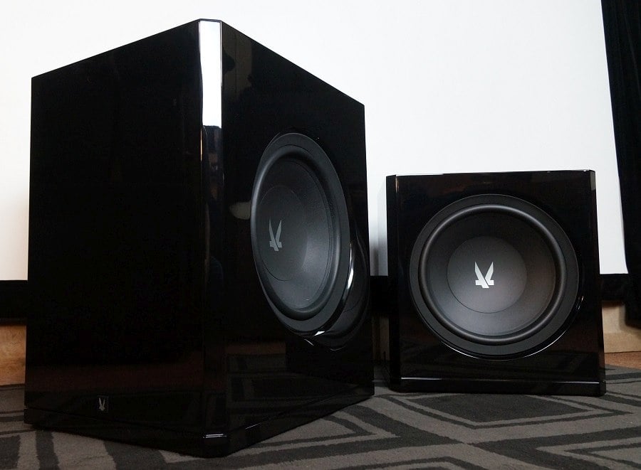

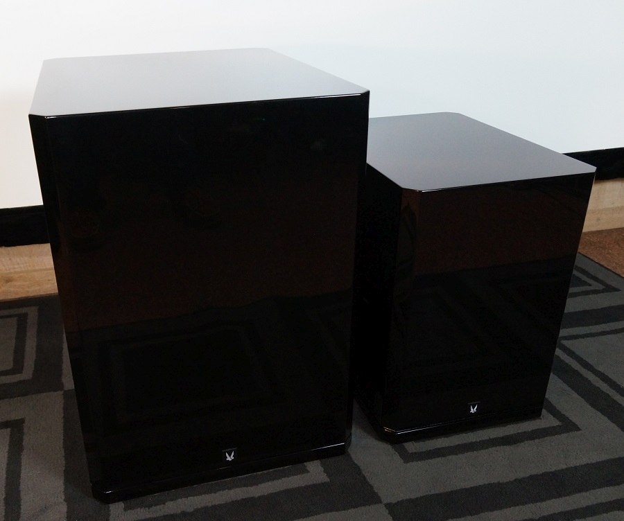

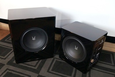

1723 V1 S1 pair10Once unpacked, the 1723 1S and 1V revealed themselves to be a pair of gleaming monoliths with a stylish austerity but not completely minimalist. The units that I was sent had a gloss black finish, and it was a high-quality gloss with no orange-peel texturing that I could see. The vertical edges were beveled which emphasized the height of the subs almost as an architectural styling cue. The lowest inch has a narrow groove that makes it seem like the subs are resting on a base. The cones are sunk into the cabinet with some beveling along with a trim ring to hide the driver frame. The cones themselves have a matte black texture with an Arendal logo printed on a concave dustcap. They can be hidden with a magnetically attached circular grille for those people who just abhor the sight of a loudspeaker cone, but I think these subs look better without the grille. The grille still may be useful in protecting the cones from curious kids who could damage them.
The 1V is substantially larger than the 1S, and most people would consider it a fairly large sub. Although the 1S is not a micro sub by any measure, it is pretty modestly sized, and people who can not handle a big sub would probably find it to be acceptable. The 1S would be a lot easier to hide than the 1V for those who need the sub to be out-of-sight, or at least not very noticeable. The subs can be had in gloss white, gloss black, matte white, and matte black finishes. Arendal’s matte finishes are so nice they really ought to be called satin finishes. Obviously, the gloss finishes are going to be a lot more noticeable than the matte finishes, so if you want the sub to be inconspicuous, go for the matte finish.

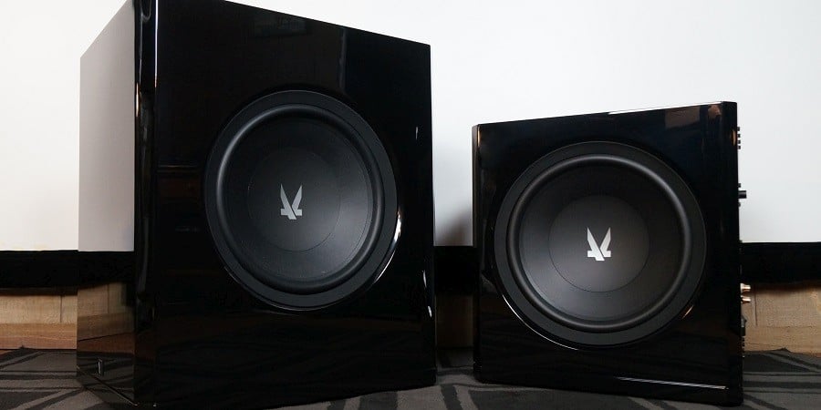

The 1723 1S and 1V share most of the same components and are separated by only one real design feature, but it is a major one: the 1S is a sealed subwoofer and the 1V is a ported subwoofer. However, let’s first go over the shared aspects of these subs before getting into further details of how they differ.
The driver is the same one used in the 1723 V2 that we reviewed, so we will just borrow our description from that article:

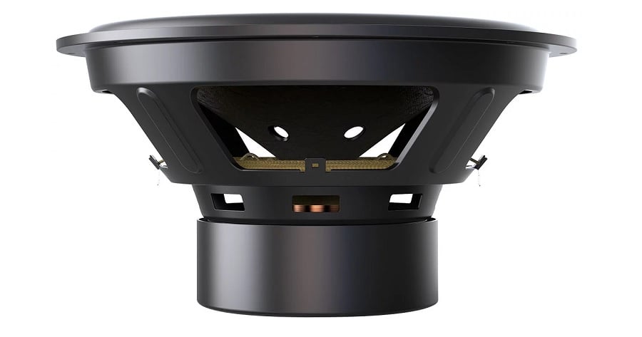

1723 driverThe cones are made from a combination of long fiber pulp and fiberglass and are attached to the baskets with a nitrile-butyl rubber surround and a Connex spider. The voice coil has a 2” diameter and uses aluminum wiring around a polyamide former. The basket is a thick stamped steel frame that connects to a beefy motor comprised of a 1 ½” stack of two magnets that are 6” in diameter. There is a heavily bumped-out backplate for longer excursions with reduced risk of hard bottoming, and venting is done under the spider. There are multiple aluminum shorting rings used for reducing inductance. Arendal claims it has a 50% higher excursion than the previous generation of 1723 subwoofers.

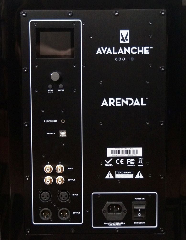

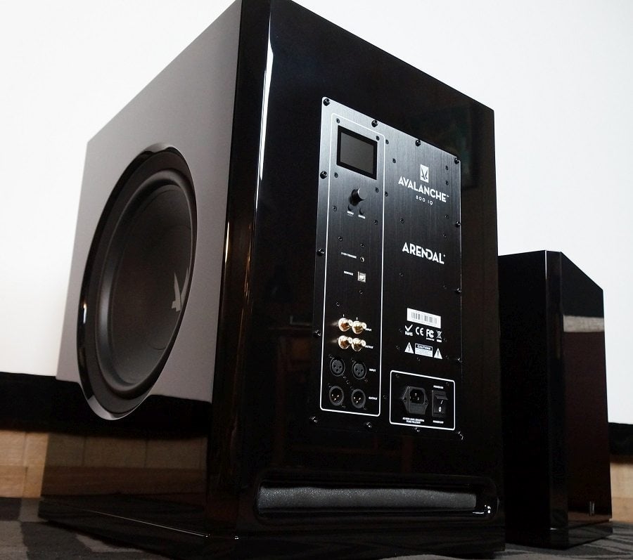

The drivers are powered by Arendal’s Avalanche amplifier, a class-D design that is controlled by a 2.6” color LCD screen with a selector knob, a menu button, and an enter button. This enables a lot more control over the sub than the usual array of knobs that most subs use. You can adjust how each input is controlled individually. Aspects of control include different crossover slopes, as well as high-pass slopes, wake-up times and wake-up sensitivities, operating mode selection, and even a 7-band parametric equalizer. Connectivity consists of a pair of RCA inputs and outputs and balanced XLR inputs and outputs. The outputs can be handy for daisy-chaining subs in a multi-sub setup, as well as running the signal to active speakers. A subwoofer needs highly sophisticated processing to deal with all of that, and the Avalanche amp has that with a 32-bit microcontroller. The microcontroller also constantly monitors performance parameters so that the sub is always operating in safe conditions. Some of the parameters monitored include output voltages, power supply rail voltages, and amplifier temperatures. If it senses anything amiss, it immediately shuts down the unit to prevent damage.
1723 V1 S1 amp panel2
All the same settings from the LCD screen on the 1723 1S and 1V subs can be controlled by an app  (on iOS and Android devices), for those who don’t want to have to get up off their sofa to change the settings of the subwoofer. One nice thing about the app is the graphic display of the parametric equalizer, for those who want to see the effect that their changes have on the response. The app also features a test tone for when you want to make sure it can produce a signal and a time delay setting that can be changed by 0.25ms increments out to 50ms, which can come in handy for situations in a multi-sub system where the subs have different distances. The ability to change time delay can synchronize all the subs so that their arrival of sound hits the listening position simultaneously.

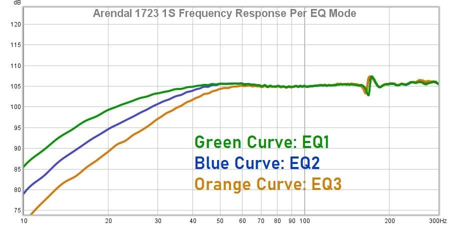

With a 7-band parametric equalizer, each Arendal 1723 subwoofer has a great deal of flexibility in taming the response from the inevitable damage inflicted by typical room acoustics. What is more, a multiple 1723 subwoofer system can be globally controlled as subwoofer groups in the Arendal sub app, so that equalization can very easily be extended to multiple units. This is the best way to equalize low frequencies in a multi-sub system, instead of having a different equalization for each sub. That feature, plus the ability to set delays in such fine increments on each sub, essentially does away with the need for external equalization in a multi-sub system altogether. All the user has to do is measure the system response and make the required changes in the app. With this ability, it's worth experimenting with higher-crossover frequencies in a multi-sub system as well, since room modes don't stop at the standard 80Hz crossover frequency. With a multi-sub system, localization from higher crossover frequencies will be less of a concern, since the bass will likely be emanating from several different directions, thereby balancing out any particular localizable source.

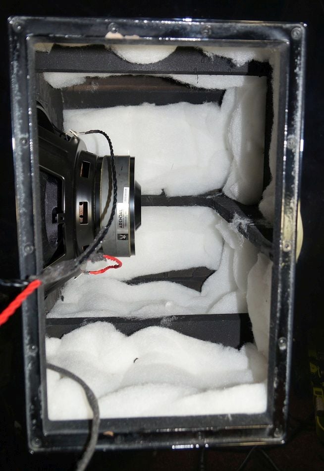

1723 V1 internalAs with Arendal’s other products, the enclosures for the 1723 1S and 1V are made from HDF (high-density fiberboard). HDF is stronger than MDF, and as a result, it weighs more, so these subs are not lightweights. In order to compensate for the beveled edge, Arendal has lined the inner edges with sizable inner-edge bracing, so the beveled edges have reinforced structure along that area. The 1V has braces at the midway point in the cabinet in the depth direction and height direction. The slot port adds a lot of additional bracing since it bends at the corner and then goes all the way to the top of the front of the enclosure; it runs parallel with two entire panels. The port is flared at both ends. A port of such an extended length will inevitably have a very deep tuning frequency. The ported design and larger cabinet require a lot more additional bracing for the 1V over the 1S, and all of that extra cabinetry is what accounts for the near-doubling of the weight, 106 lbs vs 54 lbs. There is a good amount of acoustic stuffing lining the walls of the cabinet of both subs to help damp internal pressure waves. The feet are stiff rubber cylindrical pieces with the Arendal logo molded on the bottom, and they should do well at absorbing any cabinet vibrations that the subs might have.
Overall, the design of the 1723 1S and 1V meets the expectations set by the other Arendal subs that we have seen. That bodes well for how the subs will handle real-world use, and since there is no substitute for experience, let’s see how they do in practice…
