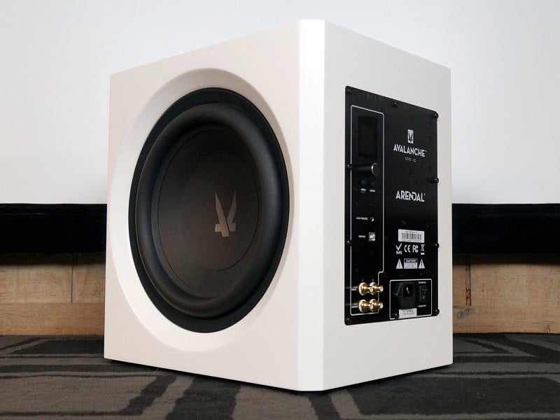

The Arendal 1961 subwoofer boxes arrived at my house wrapped in the plastic sheet covering that was bound by security tape. The boxes were very heavy-duty, as they must be to survive international transit, and the subs were packed in thick polyethylene foam blocks to give it a buffer for shocks and jolts. The subs were wrapped in a cotton sack so as not to get scuffed in the unpacking process. Since anyone who buys these subs will receive them via parcel shipping, it is important that they be well protected from commonly abusive shipping practices, and on this count, the 1961 subs have some very sensible packing.

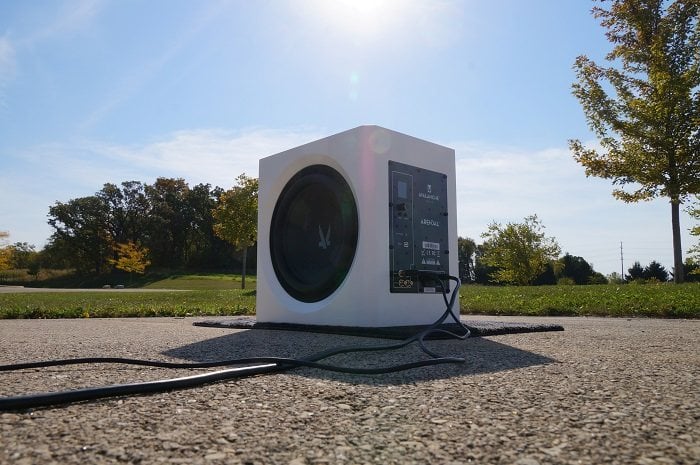

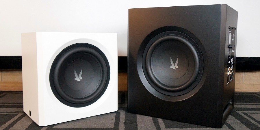

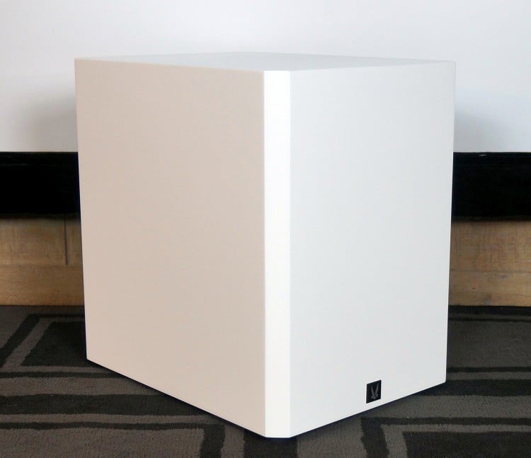

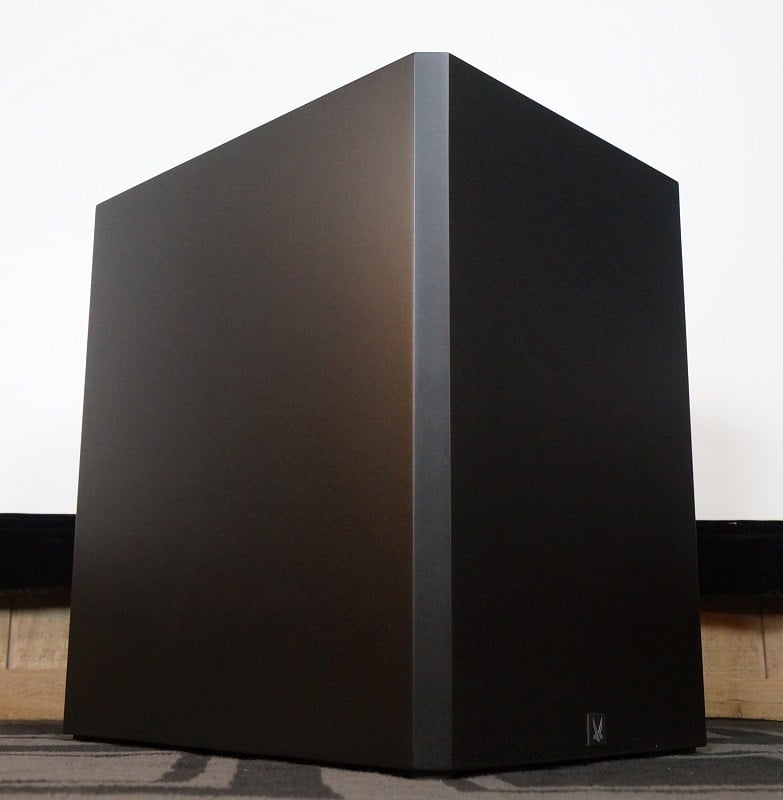

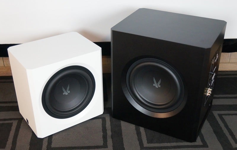

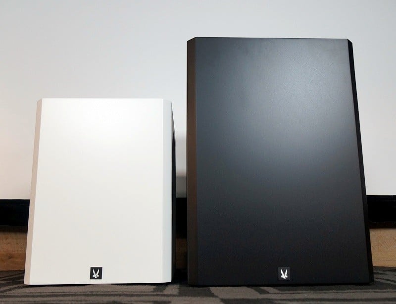

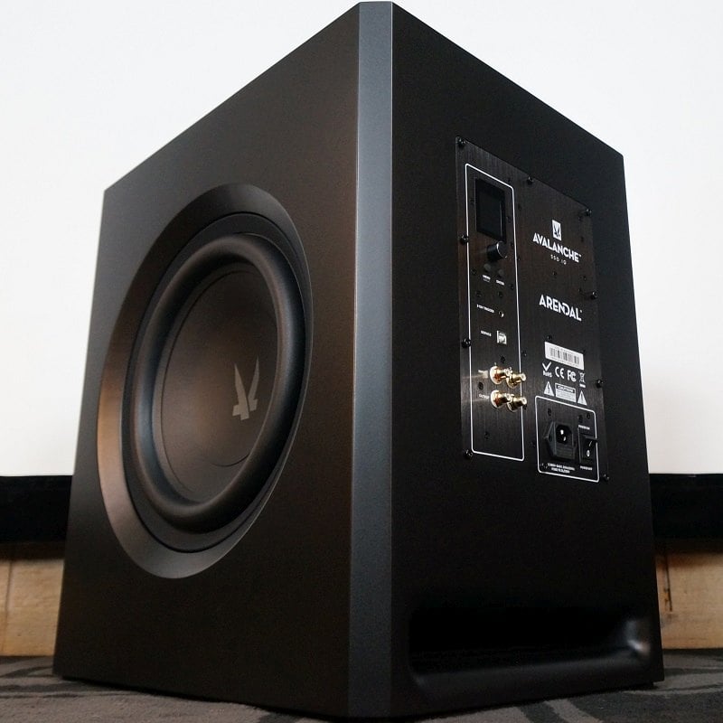

Arendal’s subwoofers all have a similar industrial design, so the 1961 subs look much like their larger 1723 siblings except a bit smaller. And smaller size is almost always a welcome attribute for people who are trying to get their audio equipment not to clash with their interior decor. I would characterize the 1961 1S as a small sub and the 1V as a medium-sized sub. However, I frequently receive such large subs that my idea of subwoofer sizes might have become a bit skewed. Their size advantage notwithstanding, the 1961 subs benefit from the tasteful and restrained trickle-down aesthetics of their larger siblings. The cabinets are fairly simple oblong boxes with the vertical edges having a significant beveling. All of the edges have a very slight rounding so there are no sharp edges anywhere.

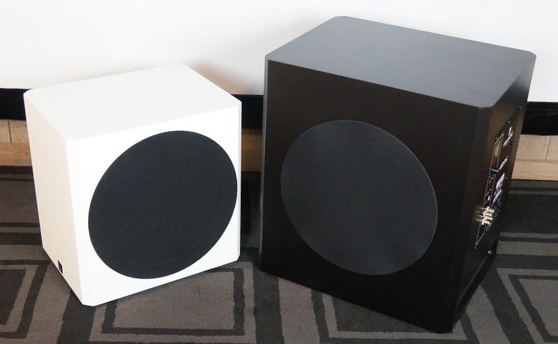

The 1961 subs only come in matte white and matte black finishes. As matte finishes go, the 1961s are pretty nice, and I have found the quality in “matte” finishes to range widely between manufacturers. The 1961 finishes aren’t as fine as the finishes from the 1723 series, but the 1723’s “matte” finish was really a true satin finish that was downplayed by Arendal for some reason. The 1961’s “matte” finish is a true matte finish, and a bit rougher and more textured than the satin finishes of the 1723s. The advantage of the slight texturing is that the matte finish is more durable and is not a fingerprint or scuff magnet like a satin finish.

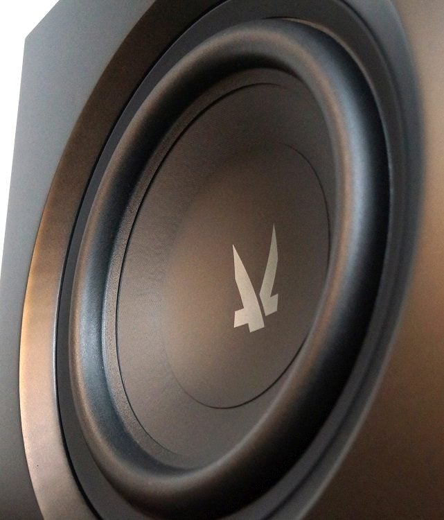

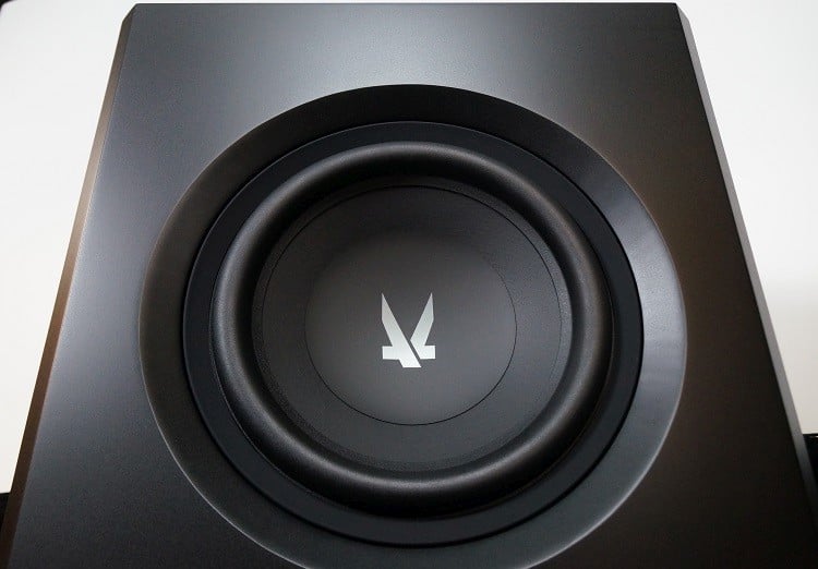

The 1961s are rather monolithic in appearance with the exception of the cone. The cone is a smooth matte black surface surrounded by a trim ring so there aren’t any exposed screws. One point of detail within the cone is the Arendal insignia printed in white in the concave dustcap. The cone can be hidden by a magnetic grille, but the whole sub is already so minimalistic that the grille doesn’t improve the appearance. Its only use is to protect the cone. The only other aesthetic detail in the sub is an Arendal logo in the lower front of the sub. The 1961 subs are simple and unobtrusive, so they aren’t likely to stick out in most people’s rooms if placed in a corner or out of the way.

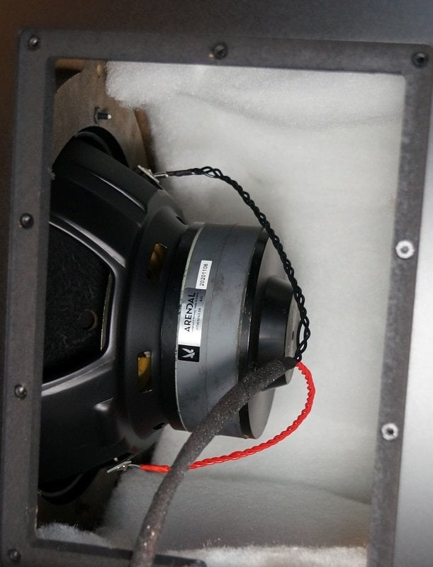

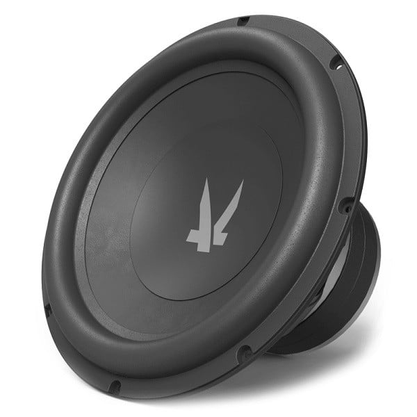

The cone is attached to a stamped steel basket via a Nomex/poly-cotton spider and isoprene rubber surround. These suspension components are engineered with very sophisticated modeling techniques and then fine-tuned using a Klippel laser scanner. The suspension is engineered to not exert a lot of tension on the moving assembly until very high excursions, thus allowing for lots of linear throw, and it also should not add a significant amount of weight, which would lower sensitivity.
The motor uses two 6” diameter magnets with a ⅞” thickness which ought to give it a lot of force for the energized coil to react against. There are aluminum shorting rings in the motor which should lower inductance thereby increasing the bandwidth of the drivers and lowering even-order harmonic distortion. The voice coil uses aluminum which has most of the conductivity of copper yet without nearly as much of a weight penalty; that ought to give it greater efficiency than copper. Venting is done in the basket under the spider. The backplate has been heavily bumped out to allow for high excursions without the former hard-bottoming against the backplate which can wreck the former in an instant. As with the suspension, the motor has been heavily optimized via computer modeling and Klippel scanning.

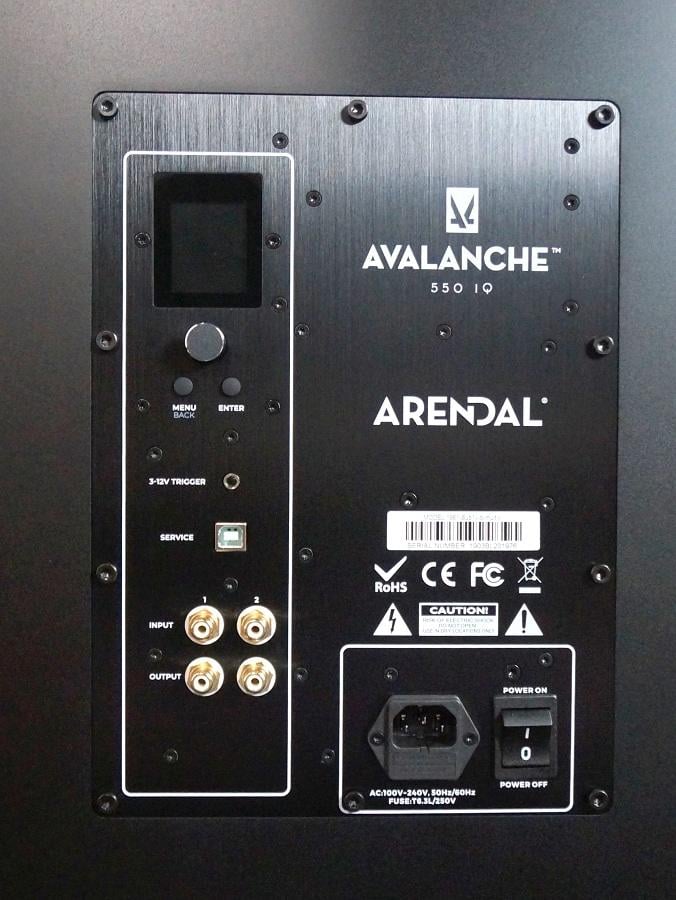

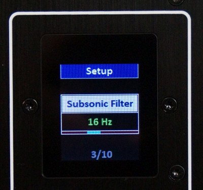

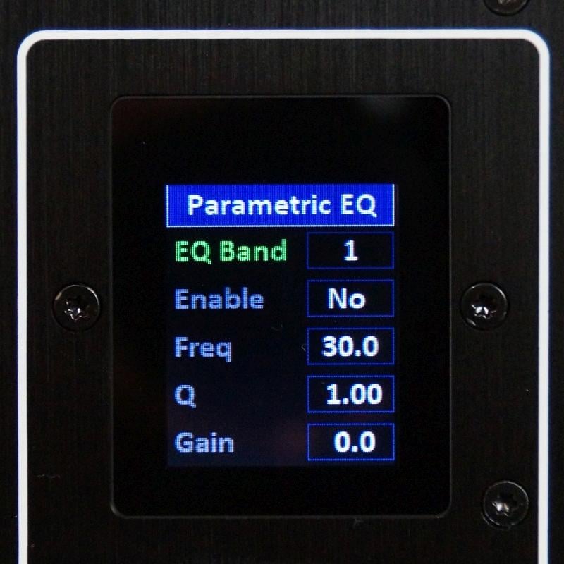

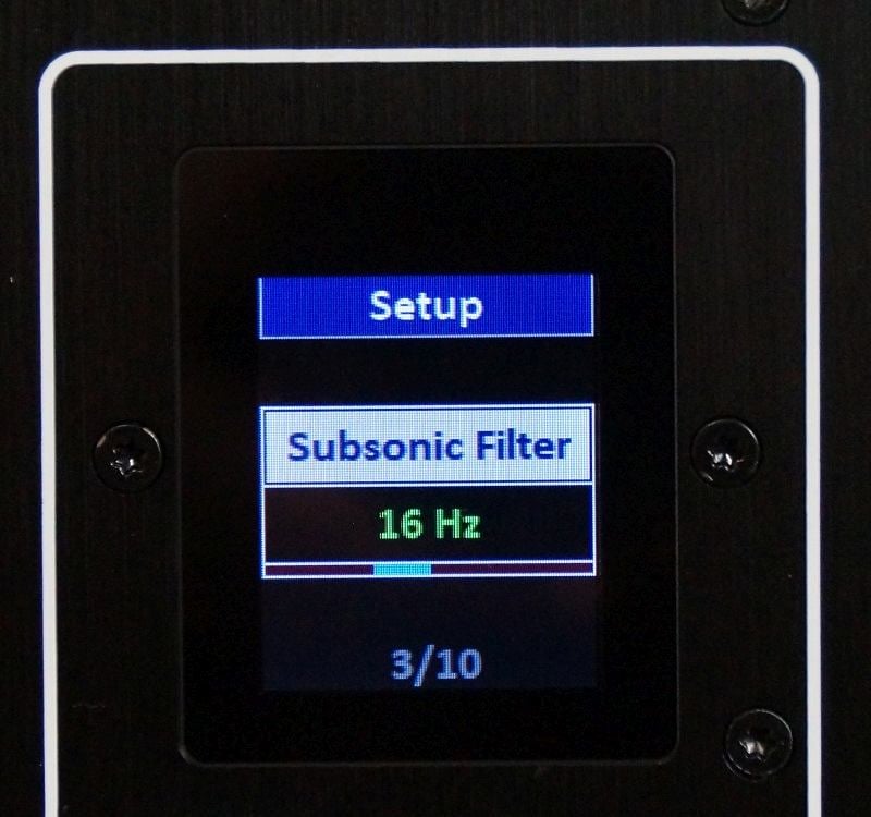

The 1961 subs use Arendal’s Avalanche 550 IQ amplifiers, a very sophisticated class-D design controlled by a powerful DSP engine. As the name suggests, it can output 550-watts RMS which should be plenty for the 12.2” drivers. Instead of the traditional knobs to control the basics like volume, phase, and low-pass frequencies, the 550 IQ uses a single knob and two buttons to control a 1.8” color LCD screen. This design enables a much wider and deeper control over all aspects of the sub’s operation. Phase can be controlled out to a single degree, volume can be fine-tuned to a single-decibel, and the low-pass filter can be set to exact frequency. The 550 IQ also features a 3-band parametric equalizer, so the 1961 subs do not need an external equalizer to manually alter the response. Response problems created by the room can be addressed on the sub itself. Operation modes and subsonic filters can also be engaged by the amp. The amp has two RCA inputs and outputs, and the inputs can be individually controlled so that the sub can accommodate connectivity with two different systems simultaneously.
Backpanel View of Arendal Sound 1961 Subwoofer Amp
In addition to the extensive level of control permitted by the 550 IQ amp, it also constantly monitors aspects of system operation to ensure that the sub is never running in potentially damaging situations. Power supply voltage, output voltage, and system temperature are a few of the properties always being monitored in real-time. If the amp senses anything amiss among a multitude of operational properties, it will immediately shut itself down rather than risk any damage to the sub itself. As with any other computerized system, upon activation, the amplifier runs through a series of self-tests to make sure everything is in order before becoming fully functional. Toward this end, the inclusion of an onboard tone generator makes it easy to deduce a problem within the larger system to see where a problem might lay if the sub isn’t producing sound.
A Useful 3 band Parametric EQ to help tame problematic bass modes
The enclosures are made from high-density fiberboard which is denser and tougher than the standard medium-density fiberboard that most sub enclosures are made of. The side-panels have a ¾” thickness and the driver baffle has a 1 ½” thickness. The 1V’s slot port paneling spans the width of the enclosure and snakes all the way up to the top of the sub on the interior of the cabinet; this adds a considerable amount of bracing as well as mass to the cabinet. There is also a fair amount of stuffing inside the cabinet to damp resonances. A nice side effect of enclosure stuffing is that it can help to lower the system resonant frequency. The feet are some stiff rubber cylindrical pieces with the Arendal logo molded into the bottom. The 1961 enclosures are built like boulders which is what I have come to expect from Arendal. These subwoofers feel very solid, and their size belies their weight. Just trying to lift the 80 lbs. 1V sub brings home the reality of their mass very quickly.
Interior View of the Internals of the Arendal Sound 1961 Subwoofer
The overall design and construction of the 1961 subwoofers fall in line with the other products from Arendal that I have encountered. The quality of materials and workmanship are well above average, even here in their entry-level subwoofers. The construction doesn’t go as far over-the-top as the 1723 series, but that is to be expected. But now we are faced with the question of what does all of this engineering add up to? Let’s give them a listen to find out…

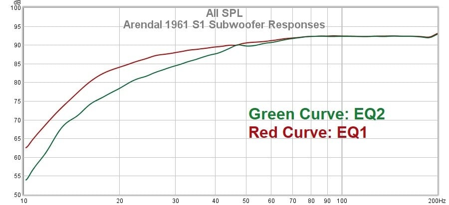

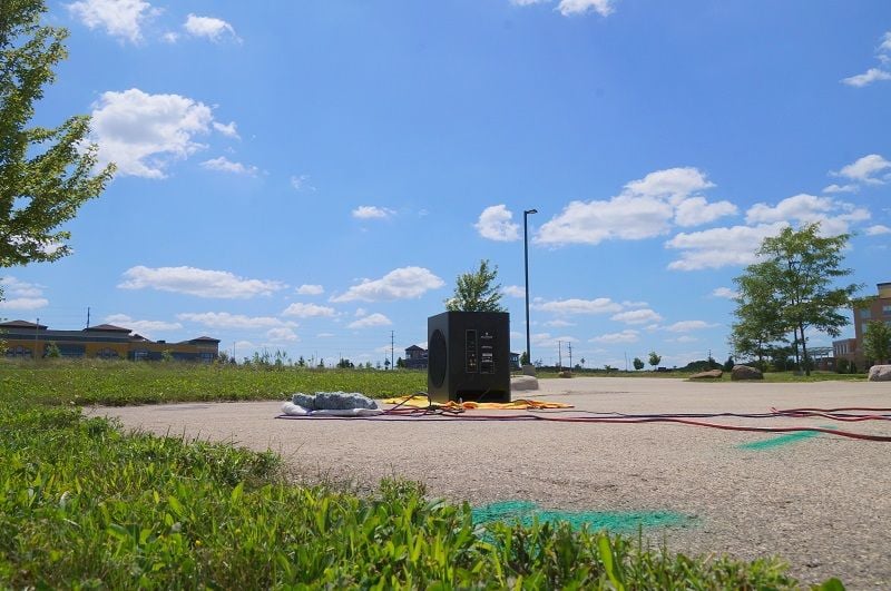

Testing on the Arendal 1961 subs was conducted with the microphone facing the woofer at a 1-meter distance and then scaled back to 2-meters in our graphs by subtracting 6dB in output. The temperature was recorded at 62F degrees with 84% humidity. The subwoofer’s gain was set to maximum, phase was set to 0, and the low pass filters were left off (except in a noted instance).

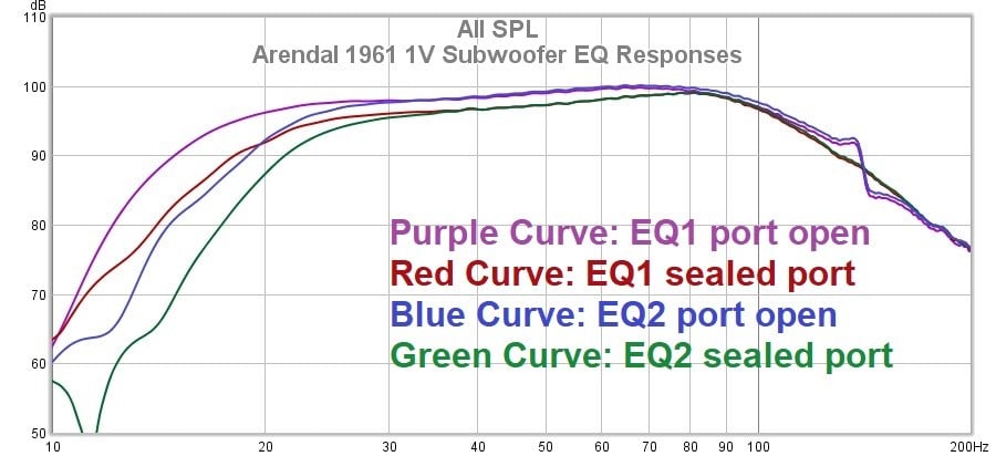

The above graphs show the measured frequency responses for the Arendal 1961 subwoofers. For this set of measurements, I did accidentally leave the low-pass filter set to 80Hz on the 1V and didn’t realize it until well after concluding testing (oopsy-daisy). Later near-field mic testing showed that the 1V had a flat response that extended well-past 300Hz much like the 1S. Both subs have a very neutral response and largely reproduce the signal in the same way the signal was sent.
These measurements show that the EQ2 setting high-passes both subs to cut off some of their low-frequency extension. The only case that I can think of where that would be useful is in instances where room gain is massively boosting the low-end of the sub. Even so, there is an adjustable subsonic filter in the DSP settings where frequency and filter slope can be attenuated, and that would be a better solution to taming excess room gain. Users are better served by the 1EQ setting, and I am not even sure why the 2EQ setting even exists in the 1V. The EQ2 setting in the 1S does resemble the natural slope of a sealed subwoofer more than the EQ1 response, and the EQ1 response looks to be more heavily shaped by DSP filters. One minor benefit to that is that the response will not be altered by compression quite as early at higher playback levels.
As with many other higher-end ported subs, the 1V includes a port plug, so I tested its effects on the response as a matter of academic curiosity. It performs as expected by kneecapping the low-end response. There is no real value of the port plug, and the subsonic filter can do almost everything it does without greatly reducing headroom. The only advantage of the port plug is that it can cancel the latent output of the port, but in a subwoofer with such a deep port tuning frequency, that has no audible benefit. As always, this poses the question of why buy such a large and heavy subwoofer if the ports are not going to be used?

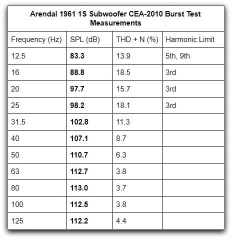

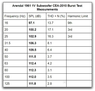

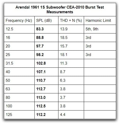

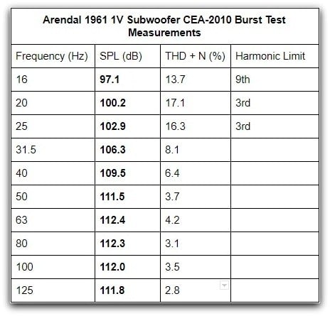

The above CEA-2010
measurements are short-term bursts that show the subwoofer’s clean peak SPL
before heavy distortion sets in. Our measurements have been referenced to
2-meter RMS, which is 9dB down from the standard requirement for the
measurements to be shown at a 1-meter peak. However most publicly available
CEA-2010 measurements are shown at 2-meter RMS, so we followed that convention.
The numbers for the 1961 subwoofers are good, especially in mid-bass. Our
numbers track the posted measurements by Arendal pretty closely although we
managed to capture just a bit more mid-bass output. Since the 1V has acoustic
emitters on different sides, it is difficult to measure it in a way that fairly
captures its output with respect to most other subs, so it might have a bit
more output in-room with respect to other subs than what we have measured. The
deep bass output from the 1V is decent, but there are similarly priced
subwoofers that do offer more but at the cost of a substantially larger
enclosure. Its deep bass output is good for the size, but if Arendal allowed a
bigger cabinet, they could have netted additional deep bass headroom.
Nonetheless, 97dB at 16Hz is nothing to sneeze at. Using our Bassaholics Room Rating protocol, the 1V is certified for a “large” room, and the 1S
achieves certification for a “medium”
room. That means the 1S should be sufficient for a 1,500-3,000 cubic foot room
and the 1V should be sufficient for a 3,000-5,000 cubic foot room for most
listening uses.

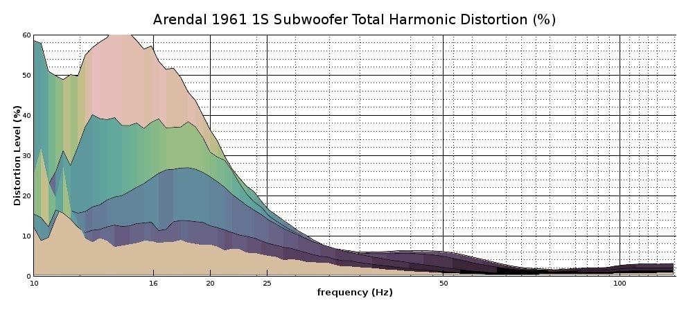

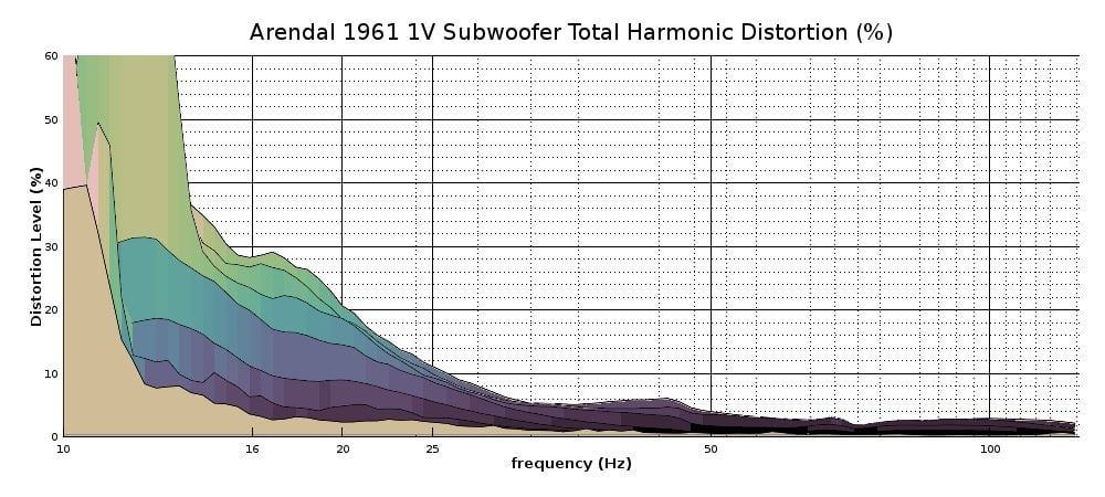

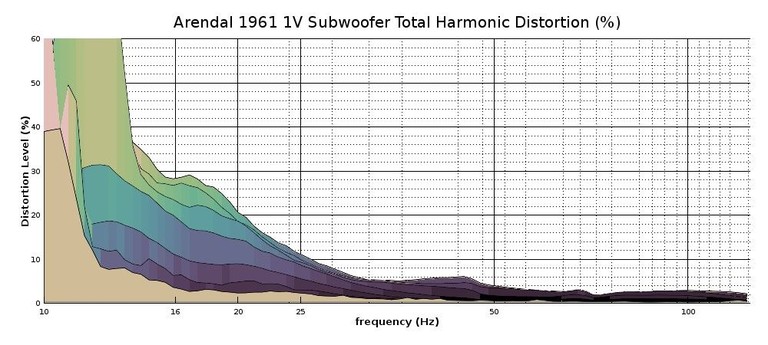

The harmonic distortion quantities are relatively low as well. At 31Hz and above, the 1V can not be pushed past 10%THD no matter what. It looks to me from comparing the 1S and 1V burst output numbers that the 1V has a very low port tuning frequency, possibly around 16 or 17Hz. I also think that it could have had more output had it not been so strictly limited at port-generated output, but I am guessing that the limiters were set up such that the port is not allowed to get into any serious port chuffing. Indeed, much like the 1723 2V, the 1961 subs refuse to make an unwelcome sound. Most ported subwoofers can be driven to produce more port chuffing than I was able to induce in the 1961 1V.

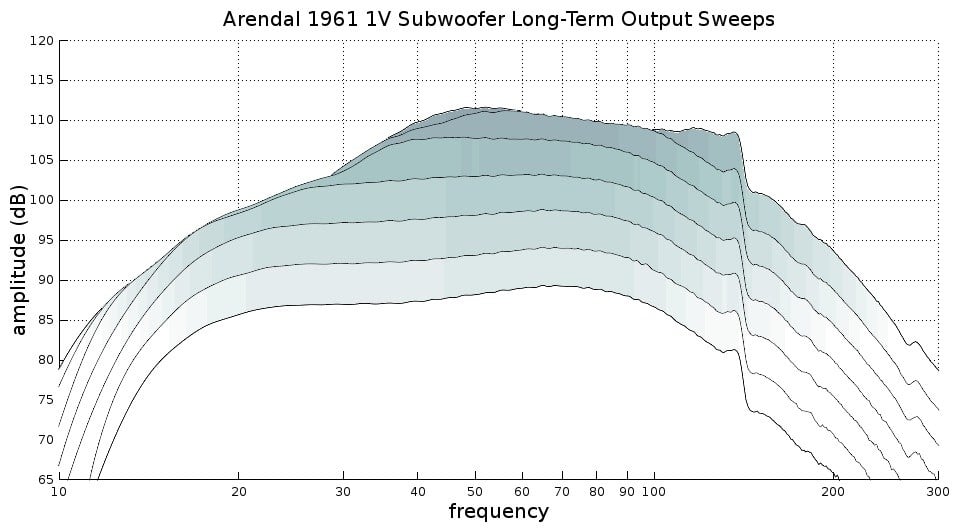

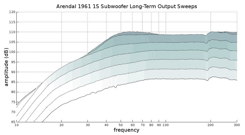

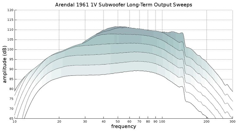

Testing for long-term output compression was done by first conducting a 20-second sweep tone where 50Hz hit 90 dB with the subwoofer 2 meters from the microphone. We then conduct further 20-second sweeps by raising the gain by 5dB until no more output could be wrung out of the subwoofer. These tests show us the long-term continuous headroom that the subwoofer is capable of. Here we can see how the DSP filters shape the 1961s’ response until the signal reaches the subs’ limits. Both subs can hit a continuous 110dB of mid-bass and that ought to give plenty of punch for most people’s tastes. We do see the low end get quashed a bit, especially in the 1V, as levels go up. With a larger enclosure and ports, it surely could have been less subject to deep bass compression. However, it is probably already reaching a size limit maximum for a lot of people, and pretty much anyone who buys it is going to be happy with the headroom that is seen here.

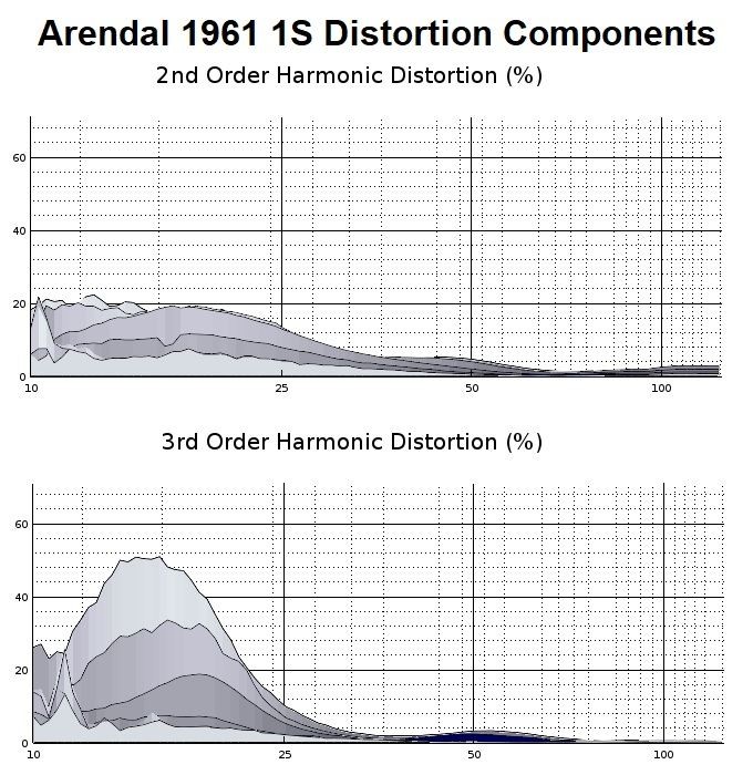

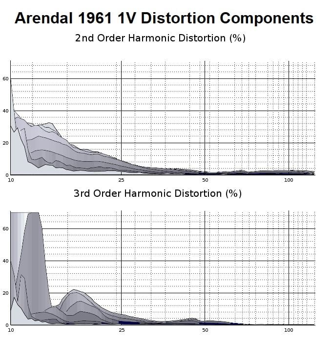

The above graphs show the corresponding total harmonic distortion to the long-term output graphs. Essentially, they depict how linear the subwoofer remains for the corresponding drive level seen in the long-term sweeps. The quantity being measured is how much of the subwoofer’s output is distortion and is shown here as a percentage. The 1961 subwoofers turn in an excellent showing here. At nominal levels, harmonic distortion is extremely low, and can’t really be made to exceed 10% until near 10Hz. Crank things up, and distortion rises, but only in deep bass frequencies. However, the distortion profile remains very good, and the subs just can’t be pushed into a lot of distortion above 30Hz even at maximum drive levels. One interesting thing to see is how the 1V keeps a lid on being completely overdriven until well below its port tuning frequency where there is very little output at all. In most subs distortion skyrockets at around port tuning, at which point output is going down but is not completely gone. This indicates that the 1961 1V is a bit better behaved than most ported subs. The 1S shows a very typical sealed subwoofer THD graph, although distortion doesn’t really take off until frequencies lower than normal for a sealed design, again indicating this sub is on a tighter leash than most in its class.
The above graphs depict measurements of the constituent harmonics from the long-term output sweeps and are what the total harmonic distortion measurements are composed of for the 2nd and 3rd harmonics. These individual harmonics can give us a clue as to what might be the cause of some quirk or non-linearity. We are only showing the 2nd and 3rd here because they more or less reflect the higher even-order and odd-order behaviors, although higher-order harmonics tend to be much further down as a percentage of distortion compared to the second and third.
Here we see that the THD comes from a mixture of odd and even order distortions. Some subs mainly have just odd-order distortions as the main ingredient of their THD. The advantage of this distortion profile is that even order is less audible than odd order, so the overall distortion produced by the 1961 subwoofers should be a bit less audible than some others, but it doesn’t matter very much since the subs don’t even produce much distortion until the highest drive levels, and even then it isn’t completely out of control. If I had to guess I would say that the even-order distortion is resulting from the suspension having slightly more tension in one direction rather than inductance since it doesn’t seem to rise at the same rate at all drive levels. Furthermore, these subs have an exceptionally low odd-order distortion level so the nonlinear restrictions on their excursions must be occurring in a partly asymmetric fashion.

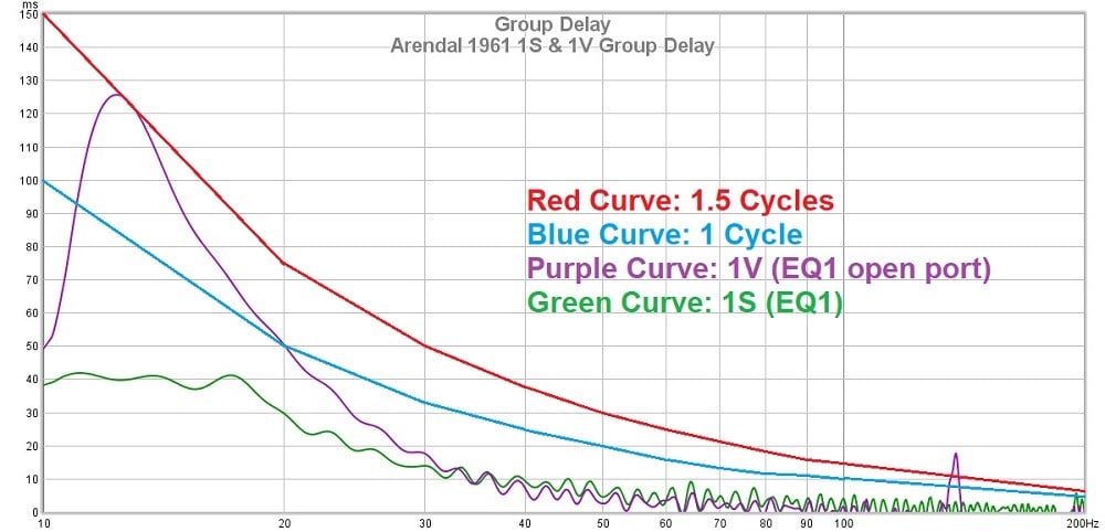

Group delay is the measurement of how much time it takes for individual frequency bands of an input signal to be produced by the speaker. It can indicate that some frequency components are developing slower than others or are taking longer to decay. It is generally thought that 1.5 sound cycles are needed for group delay to be audible at bass frequencies, although there is an argument that group delay should remain under 20ms to be completely unnoticeable, but that is likely meant for mid and upper bass frequencies.
Both 1961 subs have outstanding group delay performance, as can be seen. They don’t cross our worst-case threshold of 20ms until below 30Hz, where hearing acuity is very poor and delayed energy is unlikely to be audible. The 1V doesn’t cross one cycle of delay until 20Hz which is far too low for such levels of group delay to have any significant audible effect. It’s interesting to note that, until around 30Hz, the group delay levels are effectively the same between the 1S and 1V, and this should be seen as ever more evidence that the time-domain performance between sealed subs and ported subs can be the same for any practical purpose. The only difference is a narrow spike of group delay at about 140Hz that is a result of a pipe resonance from the port, but that will likely be filtered out for any typical crossover frequency and so will never be heard. Both subs have excellent time-domain performance, and the “quickness” or “speed” or “tightness” or whatever vague adjective that audiophiles want to assign time-domain behavior will be indistinguishable from each other as well as any other competently designed sub whether ported or sealed.
