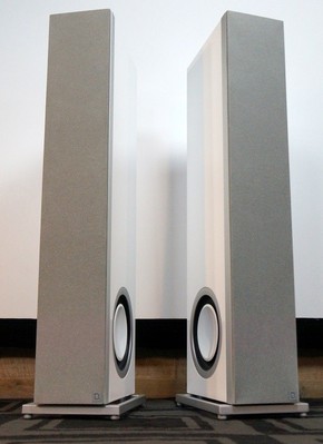

Appearance

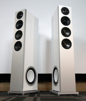

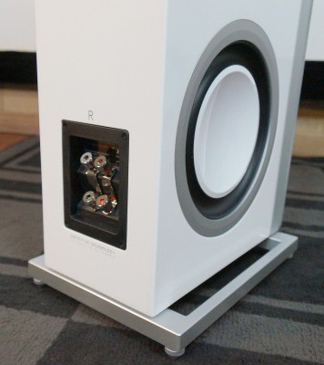

Upon arrival, the D15 speakers do need a slight amount of assembly by screwing in a metal plinth to the bottom and screwing feet into the plinth, but that is easy and takes less than 5 minutes. Following directions on the box, this should be done before unpacking the speakers. Unboxing the D15’s reveals them to be a strikingly modern design. The boxiness of the cabinet is not at all softened by corner rounding, and, in fact, the design embraces it with hard right angles at all corners. This is an effort to contrast the many circles of the drivers that are emphasized with black cones against the light aluminum front baffle. The all-aluminum front baffle provides a very attractive and high-end element to the appearance, and, to be honest, I am surprised to find something like that in a speaker at a price this low. While the industrial design here is striking, I don’t think it is ‘loud’ in that it will become the center of attention in most rooms. For those who want a tamer appearance, the grille hides the front baffle with a light-silver fabric and gives the speaker a much more minimalist look. The grille uses magnetic adhesion, so it has no grille guides to interrupt the smooth appearance of the front baffle. With the gloss white finish (a gloss black finish can also be had), the grille’d D15 is so minimal that it looks almost like a piece of abstract art. Normally, I think grilles make the speakers just look dull, but that is not the case here. Strangely, there are few images of the D15’s with the grille on posted to Definitive Technology’s product page.
There are 8” passive radiators on both sides of the speaker that have a gloss white cone and are easily the nicest-looking passive radiators I have ever seen. The tweeter is an aluminum dome that is partly obscured by a phase lens and has a mirror-image offset in a large black faceplate. It almost resembles an eye that is looking off to the side. The midrange driver has a large phase plug that Definitive Technology has used in past designs. I have never cared for the way it looks in the past, but somehow it isn’t as visually obtrusive here. The bass drivers have a sleek-looking carbon fiber cone. Altogether, I think it's an interesting looking speaker with or without the grille. I am guessing that even people who normally object to the appearance of speakers will get along with these when the grille is in place. In the Gloss White finish, they would fit right in any brightly colored decor. All-in-all, the Demand D15 speakers look quite nice.

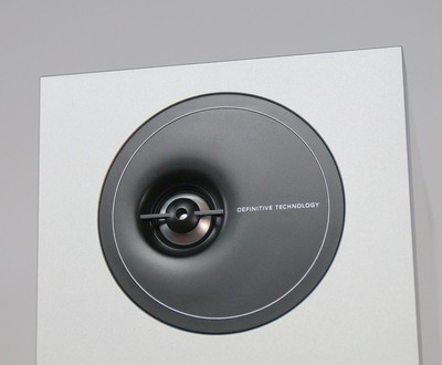

Let’s begin our discussion starting from the top and going down, so let’s talk about the tweeters. The D15 tweeters use a 1” aluminum dome mounted in a shallow waveguide. The aluminum of the tweeter dome is annealed, which means it has been softened by bringing the aluminum close to its melting point and then allowing it to cool slowly. This process dissolves the crystalline structure of the metal, and, in its recrystallization, it becomes softer. In its softer state, it has increased the damping which can tame break-up modes in higher frequencies. It should make for a smoother sound, especially with those people who are sensitive to higher treble frequencies. There is a plastic piece with partly covers the front of the tweeter that is a phase lens that Definitive technology calls the ‘20/20 Wave Alignment Lens.’ Its purpose is to block sound from the tip of the tweeter dome from interfering with sound emanating from the sides. It could also serve as protection for the fragile diaphragm of the tweeter dome.

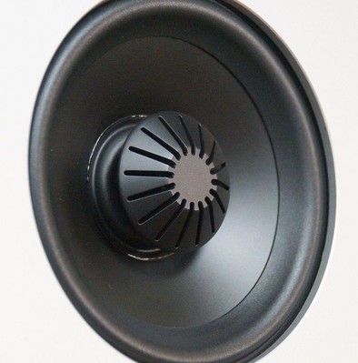

The midrange driver is a 5.25” polypropylene design that is quite unique to Definitive Technology that they call the ‘BDSS Woofer,’ which stands for ‘Balanced Double Surround System.’ It gets that name because the cone uses two surrounds: one surround on the outer edge of the cone and one in the inner edge that attaches it to the phase plug. Definitive Technology claims that this double surround system allows greater linear excursion. In theory, it should be possible that two surrounds could provide a more controlled excursion from the suspension components, although I can’t imagine that would provide a huge increase in excursion. This particular midrange phase plug is also something only seen in Definitive Technology loudspeakers, and they call it the ‘Linear Response Waveguide.’ It’s the largest phase plug I have seen, and that is probably why Definitive Technology calls it a waveguide, although it certainly does not function as a traditional waveguide. It looks to me like it just does what normal phase plugs do which is blocking wavefronts from the different areas of the cone from colliding and interfering with each other. It just does it a lot more than normal phase plugs.

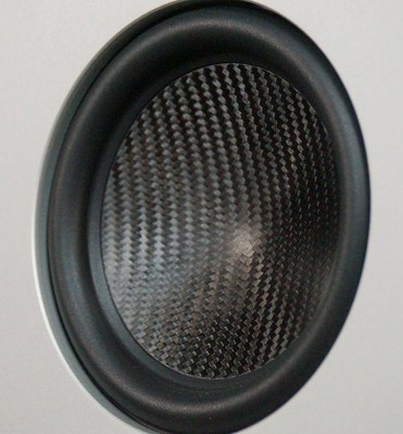

For the bass drivers, the D15 uses two 5.25” carbon-fiber cones.
They look nice and have a beefy surround and so they should be quite capable in
bass frequencies. They are also used to power the two 8” passive radiators on
the sid
e of the speaker. Definitive Technology claims a lower -3dB limit of 48
Hz for the D15, so these radiators should be very competent down to 50 Hz at
least. I wasn’t able to get a close look at the bare
drivers since a trim ring covers the frame screws, and removing the trim ring can
be a bit risky since it is glued on.

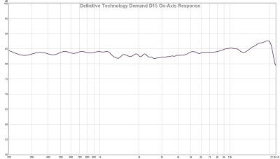

Definitive Technology Demand D15 Measurements and Analysis

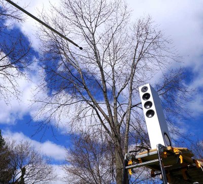

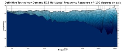

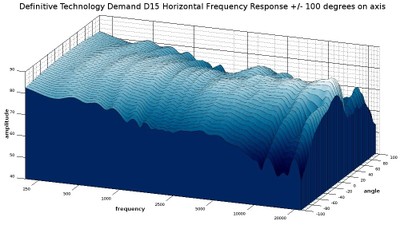

The Definitive Technology D15 speakers were measured in free-air at a height of 4 feet at a 2-meter distance from the microphone, with the microphone raised to a 7.5’ elevation that was level with and aimed at the tweeter center. The measurements were gated at 9-milliseconds. In this time window, some resolution is lost below 400 Hz and accuracy is completely lost below 200 Hz. Measurements have been smoothed at a 1/12 octave resolution.
The above graphs depict the Definitive Technology Demand D15’s on-axis and horizontal dispersion out to a 95-degree angle in five-degree increments. Information on how to interpret these graphs can be read in Understanding Loudspeaker Review Measurements Part II. The first feature that leaps out from these graphs is just how flat the on-axis response is. This is a very nicely linear behavior on-axis. There is a rise beginning at 15 kHz which peaks at 20 kHz, but I would wager that most buyers of the D15s could hardly hear that high, not that there is much content up there anyway. The only difference that kind of peak in the response would make is perhaps the addition of a slightly more ambient sound in some recordings. We do see that the off-axis does see a small rise above 3 kHz at angles outside of 30 degrees, and this is due to a slight directivity mismatch between the tweeter and midrange driver at further off-axis angles. However, out to 30 degrees, the linearity corresponding to the on-axis response holds. The ‘listening window’ of this speaker, i.e., the +/- 30-degree angle from on-axis, is beautifully linear.
One interesting thing to see is that the linearity holds slightly better on the inside angle of the D15s as opposed to the outside angle. As was discussed in the ‘design analysis’ section, the D15 pair have specific left and right speakers, and the differentiating feature is the mirror-imaged offset tweeter; the tweeter is mounted further out from center with respect to the left or right unit. What this means is that the dispersion between the speakers is going to be slightly better than outside the speakers. It’s not hugely better, but if you want to optimally set up your Demand speakers, pay attention to the left/right designations.

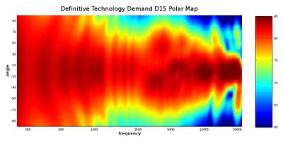

The above polar map shows the same information in the preceding graphs but depicts it in a way that can offer new insight regarding these speakers’ behavior. Instead of using individual raised lines to illustrate amplitude, polar maps use color to portray amplitude, and this allows the use of a purely angle/frequency axis perspective. The advantage of these graphs is they can let us see broader trends of the speaker’s dispersion behavior more easily. More information about interpreting this graph can be read in our article Understanding Loudspeaker Review Measurements Part II.
In this polar map, we can see that the D15s have a relatively wide dispersion speaker with good coverage out to 60-degrees off-axis and within that angle directivity is fairly well controlled, although not perfectly. We more clearly see the asymmetry caused by the offset tweeter in the polar map above its crossover frequency of 2.5 kHz (in this map, the right side of the speaker is positive degree angles so left side is negative degree angles).

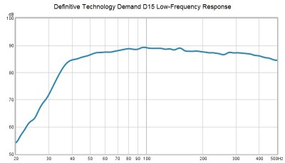

The above graph shows the D15’s low-frequency response captured using groundplane measurements (where the speaker and microphone are on the ground at a 2-meter distance in a wide-open area). We can see that the D15’s have a fairly flat bass response down to just below 40 Hz. Definitive Technology specs the response of these speakers as 39 Hz to 24 kHz, but they don’t give a window for that response. The low-end of their specs are not exaggerated, and these really do have a strong bass response down to 39 Hz. With a response this flat down to such a low frequency, boundary loading might give a substantial boost to the low frequencies, so users might get a tighter bass sound by pulling them away from walls or corners. These speakers aren’t designed to utilize boundary reinforcement like many other tower speakers that have a more gradually rolled-off low end response.

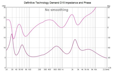

The above graphs show the electrical behavior of the D15 Towers. Definitive Technology specifies the impedance load of the D15s to be 8 ohms nominal, but I would call that a stretch. They have a 5.4 impedance minima at around 130 Hz. That is too low in a heavily used region for these to fairly claim an 8-ohm load. The phase angle in that region isn’t totally benign as well. If Definitive Technology claimed 6 ohms nominal, I wouldn’t argue, but 8 is a stretch. Nonetheless, this isn’t an extremely harsh electrical load. I wouldn’t want to run these speakers on a budget AVR amplifier, but I think midrange AVR’s should be able to handle these speakers without much trouble. I measured sensitivity at 84.7 dB for 2.83v at 1 meter which is pretty close to Definitive Technology’s spec of 85.5 dB for 1 watt at 1 meter. These aren’t very sensitive tower speakers, and they could benefit from some beefy amplification. On the other hand, I don’t think anyone buying a $3,400 tower speaker pair is going to drive them with a $200 AVR, so it’s not likely to be an issue. However, those who want super-loud headbanging speakers may want to look at higher sensitivity designs, as these will only have so much headroom, even with a monster amp.

good news about the bad news here is that there is very little bad news with
respect to these speakers, and I think anyone who has read this far would have
guessed that much. My only real nit-pick with the D15s doesn’t really concern
the speakers themselves but Definitive Technology’s overly optimistic impedance
spec for them. Too much of the electrical impedance of the speaker falls below
8 ohms for this to be considered an 8-ohm nominal load. However, as I said,
that isn’t to say the electrical load of the D15s is bad, but rather it is just
not as light of a load as Definitive Technology implies. However, this nit-pick
is not a big deal, and I only even mention it just to have something to gripe about.
One other thing I would say here that is not a complaint about the speaker but
rather as a notice to would-be buyers is that while these speakers can get very
loud, they can’t get insanely loud, and those looking to achieve THX Reference
level loudness in a large room will have to look elsewhere. However, for 99.5%
of home audio enthusiasts, these have more than enough headroom.
With those very minor
criticisms out of the way, let’s go over the highlights of the D15s. First and
foremost is the sound: these speakers sound terrific. They are tonally
balanced, accurate, detailed, and deliver a marvelous soundstage. They have
good bass extension down to 40 Hz and a good deal of dynamic range. The
dispersion uniformity is good, if not quite perfect, and these aren’t speakers
that need you to dress y
our room up in acoustic treatments for an optimal
sound. They sounded great with every piece of music that I threw at them. The
only time they complained was when I blasted them with very high levels of
extremely deep bass in a movie, but that is not something I can fairly hold
against a speaker of their design type, because it is not reasonable to expect
them to play near-infrasonic bass at loud levels;. No speaker like this could.
That is what subwoofers are for.
I can also appreciate how good looking these speakers are. As I said before, I think these could pass some high standards for aesthetic approval from other household members that many other floor standing speakers would not be able to clear. They look very nice, and while they are not cheap speakers, they look more expensive than they are. But the looks are not skin deep with the D15s, because the build quality is also very good. They feel as solid as they look. Again, not a cheap speaker, but it’s easy to identify where the money went.
