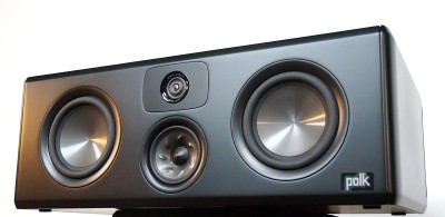

Polk Audio wol200 pair.jpgwed the audio world with their massive Legend L800 tower speakers, but those towering speakers have overshadowed the fact that Polk released other speakers in the Legend series also, although those other speakers did not boast Polk’s SDA technology. While the L800’s SDA technology was indeed impressive, we found the L800s to be a good loudspeaker in a multitude of other ways as well, so it stood to reason that the other speakers in the Legend series should have the same high level of engineering. We decided to put that theory to test, so in for review today we have the Polk Audio Legend L200 bookshelf speakers and L400 center channel speaker.

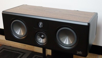

Far from being mere accessories to the L800, the L200 and L400 are quite formidable in their own right, as they should given their pricing. The design, style, and construction of these speakers suggest something that is capable of high fidelity sound. Let’s dive in to explore these speakers and then listen to them and measure them to see if they keep the promises they make as a part of Polk’s flagship series…

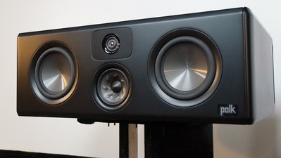

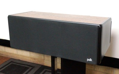

The Polk L200 and L400 speakers came well-packed, and upon unboxing, revealed some very nice and conservatively-styled speakers. The Legend speakers play it pretty safe as far as aesthetics go. They have a satin black front baffle with some softly-chamfered edges. The rest of the enclosure can be had in either a Black Ash or Brown Walnut finish, but the Black Ash finish comes with a gloss black front baffle instead of satin black.These are readily discernible as real wood finishes and do lend an element of higher-end panache to these speakers. The grilles are normal black-fabric wrapped frames with a continuous chamfer angle to go with the front baffle. There is a Polk badge in the lower part of the front of the speaker with or without the grille. The grille uses magnetic adhesion so there are no grille guides on the front baffle. The drivers themselves are the only element that lends anything unusual about the appearance of these speakers. The woofer cone has some angled dimples that Polk calls a ‘Turbine Cone’ that resembles a kind of vortex. It does look slightly abnormal but kind of cool nonetheless. The ring radiator tweeter has a sharp point in the center that looks a bit more distinct than the typical dome tweeter, but again, it looks a bit more interesting for that matter.
Overall, this is a very nice execution of a traditional loudspeaker aesthetic. It should fit in very well with a wide range of interior decors. Both the L200 and L400 are very tastefully designed, and they are not likely to draw attention to themselves. The only caveat is that the L400 is a bit larger than most center speakers. That larger size is necessary for the kind of performance it offers, however. It would be difficult to execute a three-way center in a smaller enclosure, and that three-way design is needed for the caliber of performance that it is targeting. But if you can make it fit, it isn’t likely to stand out as much thanks to its restrained styling.

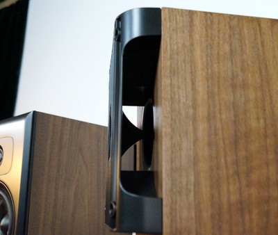

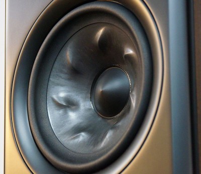

As was mentioned before, the midrange driver is a unique design in the Legend series. The cone is made out of foamed polymer and is peculiarly shaped such that Polk calls it the ‘Turbine Cone.’ The cone has seven fin-type protrusions that form a vortex pattern hence the name ‘turbine.’ The shape and number of these fins are claimed to make the cone stiffer which can drive break up modes higher in frequency where they will be easier to filter out by the crossover circuit. Lower bass is produced by the port which uses Polk’s ‘Power Port’ design that has been seen on previous higher-end speaker lines from Polk. The idea behind the Power Port is that it preserves the laminar flow of air within the port by controlling its contact with the environment from a flared cone piece that is mounted over the port opening. This should protect against port turbulence at higher drive levels better than traditional port designs. I would guess that the plate which covers the port also helps to load the lower frequency output a bit more.

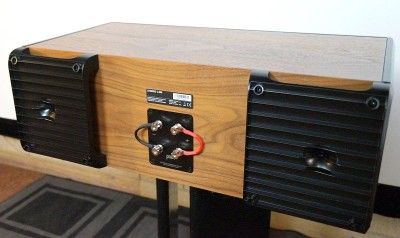

    The cabinets of the L200 al200 rear2.jpgnd L400 are stout affairs and comprise the bulk of their respective weight. I wasn’t able to get a close look at the bare drivers since a trim ring covers the frame screws, and I didn’t want to risk breaking these expensive speakers to get a peek at the internals. The cabinets feel solid, and a knock test doesn’t reveal any hollowness or any feeling of flimsiness. It’s constructed out of 3/4” MDF panels and braces with a 4/5” MDF front baffle. The braces are optimally placed according to FEA analysis and laser vibrational analysis. The midrange driver in the L400 is in an enclosed compartment so that back waves from the bass drivers do not affect its position. A healthy amount of foam and polyfill are placed in the cabinet for internal damping. There are dual 5-way binding posts lined with a wire jumper for those who want to bi-wire or bi-amp these speakers. I think the ability to bi-wire or bi-amp is a bit absurd for the L200 particularly, but I get that it is a market-demanded feature for a speaker of this price point. The speakers come with magnetically adhesive grilles that Polk claims do not cause much diffraction, and given the low-profile of the grille frames, they don’t look like they would be a significant source of diffraction.
    All in all, the L200 and L400 speakers look to be solidly-designed bookshelf and center speakers with some innovations befitting the flagship line from a major speaker manufacturer like Polk Audio. One appealing aspect particular to the L400 is the three-way design and layout of the drivers where the tweeter and midrange driver are vertically-aligned. This alignment of the tweeter and midrange plus the low crossover frequency of the midrange driver to bass drivers should ensure that there are virtually no horizontal off-axis lobing nulls that occur with so many other two-way center speakers with dual active woofers in a horizontal arrangement. That means that the sound projected by the center speaker should have good consistency over a very wide area. This is not the case with many center speakers, especially those that simply plant a tweeter between two woofers on a horizontal plane, but the L400 is a real effort to avoid that pitfall (the problems with that design approach can be read about in our article detailing the difference between horizontal vs vertical speaker designs and in our article about center channel design considerations). And now that we have talked about how the L200 and L400 speakers work, let’s see what they sound like…

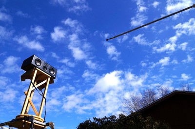

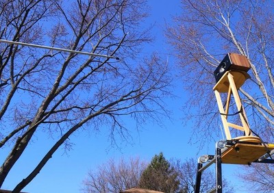

    The Polk L200 and L400 speakers were measured in free-air at a height of 7.5 feet at a 1-meter distance from the microphone, and the measurements were gated at an 11-millisecond delay. In this time window, some resolution is lost below 250 Hz and accuracy is completely lost below 110 Hz. Measurements have been smoothed at a 1/12 octave resolution.

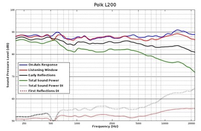

    Polk L200 SpinoRama
    The above graph shows the direct-axis frequency response and other curves that describe the L200’s amplitude response in a number of ways. For more information about the meaning of these curves, please refer to our article Understanding Loudspeaker Measurements Part 1. We were only able to do the set of measurements needed for this graph for the L200, which involve a frequency response test for every 10-degree increment over a complete circle around the speaker on both the vertical and horizontal axis (which add up to 72 response sweeps). The L200s put up a good showing here. The midrange region is admirably flat. There is a slight lift above 10 kHz, but that is not likely to be heard aside from adding a touch of ‘air’ on the recordings that actually have content that high. We can see from the directivity indexes that the ring radiator tweeter starts to beam a bit below 10 kHz, and those who want the full upper treble experience are advised to listen as close to on-axis as is practical with respect to the speaker, perhaps by toeing it in towards the listening area. The listening window curves and early reflections curve suggest a speaker that has good correspondence from on-axis to off-axis angles.

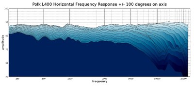

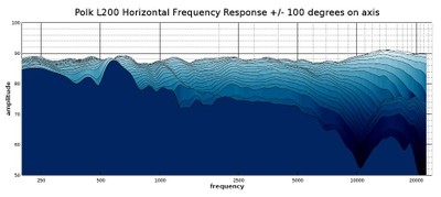

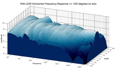

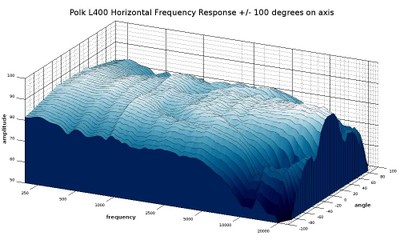

    The above graphs depict the speaker’s lateral responses out to 100 degrees in five-degree increments. More information about how to interpret these graphs can be read in this article: Understanding Loudspeaker Review Measurements Part 2. In these graphs, we see how well the off-axis angles match the on-axis response, and, for the most part, they do pretty well, excepting the beaming tweeter above 10 kHz.
    One interesting feature we can see in comparing these responses is how the L400 maintains a broader dispersion at higher frequencies versus the L200. The reason for this is the smaller diameter of the midrange driver in the L400; generally speaking, the smaller the radiating diaphragm, the wider dispersion it will have at higher frequencies. The high-frequency beaming of the tweeters isn’t as big of a deal as the reader might imagine; there rarely is any substantial amount of spectral energy in most recordings above 10 kHz, so in the case that a listener has to sit at an off-axis angle where the upper treble is diminished, chances are they won’t be missing much anyway.
    Something else to note is the lack of lobing nulls in the L400. Every single center speaker I have ever tested had some kind of interference between the horizontally-aligned drivers at some off-axis angle. The better center speakers managed to push those nulls off to far off-axis angles, but the L400 just does not exhibit any horizontal interference whatsoever. The reason for that is that the horizontally-aligned bass drivers are low-pass filtered at a frequency low enough that, in their operational range, they act acoustically as a single source since the highest-frequency wavelengths that they are allowed to play is still greater than the distance that they are separated; their crossover frequency, 270 Hz, has a 52” long wavelength, and the actual center-to-center spacing between the bass drivers is about 26”. The reader will never understand how much joy it brings this reviewer to finally see this long-sought ideal finally achieved.

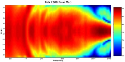

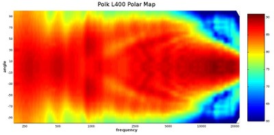

    The above polar map graphs show the same information that the preceding graphs do but depict it in a way that can offer new insight regarding these speakers’ behavior. Instead of using individual raised lines to illustrate amplitude, these polar maps use color to portray amplitude, and this allows the use of a purely angle/frequency axis perspective. The advantage of these graphs is they can let us see broader trends of the speaker’s behavior more easily. For more information about the meaning of these graphs, we again refer the reader to Understanding Loudspeaker Review Measurements Part II.
    In these graphs, we see that tweeter does start to beam a bit in upper treble; most dome tweeters have this characteristic, and we see that the ring radiator does too. The listener will want to be listening within a 30-degree angle to catch upper treble frequencies, but that is within a normal area for most listening positions. Those who are sensitive to upper frequencies or just want to take down the treble a bit can angle the speakers outward (or straight ahead with no toe-in, which puts a central listener about 20-30˚ off tweeter axis) a bit so that they are not facing the listening position directly. In a manner of speaking, just changing the direction of these speakers acts as a tone control; the further you listen off-axis, the less bright they will sound. One interesting aspect of the L400s is how even the dispersion is out to 8 kHz. The directivity matching between the tweeter, midrange driver, and bass drivers is superb in this speaker. Not only has Polk avoided the lobing problems in typical center speakers, they have excellent integration between all of the drivers for the off-axis response. Polk, now you are just showing off!

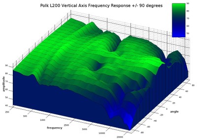

    The above graph shows the L200’s speaker’s response behavior along its vertical axis where zero degrees is directly in front of the tweeter, negative degree values are below the tweeter, and positive degree values are above the tweeter. There is nothing unusual about the measured performance here, and most two-way speakers have this kind of response. The vertical response doesn’t matter as much as the horizontal response, so long as the listener’s ear level is roughly level with the tweeter. One interesting aspect that is not easy to see from this particular graph is that the -10 degree angle is actually a bit flatter than the tweeter height response. So if you want the ultimate in linearity from the Polk L200’s, listen at an angle slightly below that of the tweeter.

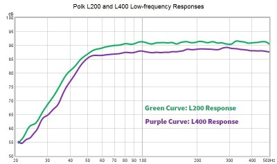

    The above graphs show the L200 and L400’s low-frequency responses that I captured using groundplane measurements (where the speaker and microphone are on the ground in a wide-open area). In these graphs we see a nicely flat response down to 50 Hz. Room gain may be able to net a usable bass response down to nearly 40 Hz. This extension is better than the average bookshelf speaker and center speakers, and it is no wonder that they didn’t benefit much from subwoofers on acoustic recordings. One aspect of these responses that I like to see is the omission of any kind of mid-bass bump that some manufacturers give to their bookshelf speakers to affect a deeper bass response than what is actually there. The Polk’s play it straight, and the low-frequency response is very linear. No exaggerated bass here.

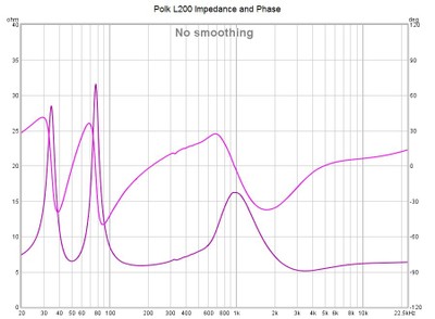

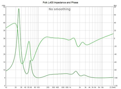

    The above graphs show the electrical behavior of the L200 and L400 speakers. Polk specs these speakers as 4 ohm, and that is mostly correct in that this is too stiff of a load to qualify for a nominal 8 ohms or even 6 ohms. While the minima doesn’t really dig below 5 ohms, they do occur along with steep phase angles, and that may be a tough load for cheap amplifiers, especially the L400. I doubt that anyone who buys these speakers will end up pairing them with a budget AVR, so I don’t see this electrical load ever being a serious issue. One feature to note is the balanced impedance peaks in the low frequencies on the L200, and that means that the port length and diameter is a good fit for the enclosure size. The L400, on the other hand, looks to have relatively large ports for the enclosure size as can be seen from the much larger lower frequency peak. Port tuning can be seen to be right at 50 Hz for the L200s and around 45 Hz for the L400. Sensitivity measurements put the L200s at 86.3 dB for 2.83v at 1 meter and the L400 at 87.6 dB for 2.83v at 1 meter. These measurements are close to Polk’s own specifications for these speakers and are very normal sensitivities for bookshelf speakers and center speakers in this class.

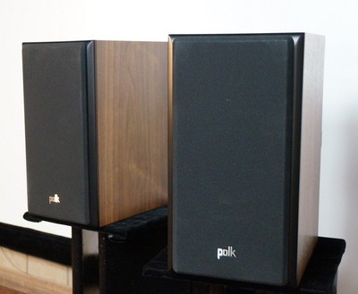

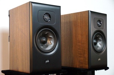

    Expectations are high when a major loudspeaker manufacturl200 hero pair.jpger such as Polk launches a new flagship series. This is as it should be since no one doubts that a company like Polk has the resources to produce very well-engineered loudspeakers. The question for the Legend series is has Polk done something innovative with this opportunity or have they phoned in an unexceptional effort? In my opinion, Polk has released some exceptional loudspeakers that merit their higher cost.

    The Polk L400 center speaker has to rank among the best I have ever tested.
