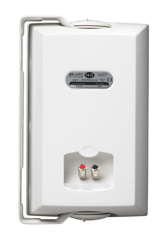

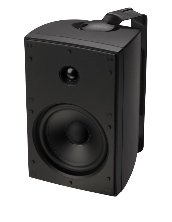

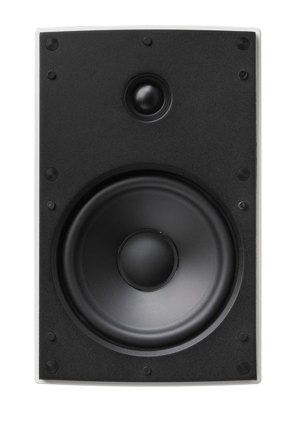

The 6.5” mid-bass polypropylene driver and 1” polyester fabric dome with urethane coating are moisture resistant.  Both drivers utilize conventional ferrite magnets.  The 6.5” driver has a stamped frame with an extended pole piece for higher excursion capabilities.  Unlike some competitive outdoor speaker models that simply slap a resister and capacitor on the tweeter and call that a crossover, NHT actually employed a real network with a 2nd order electrical (4th order acoustical) response.  All parts are 5% tolerance including the laminated core inductors, non-polarized electrolytic caps, and cement resistors.
The NHT 02-ARC outdoor speakers are available in both Black and White finish options.  The paint NHT chose has had 1000s of hours of environmental testing and is said to be UV resistant.  Our review samples came in the black finish.

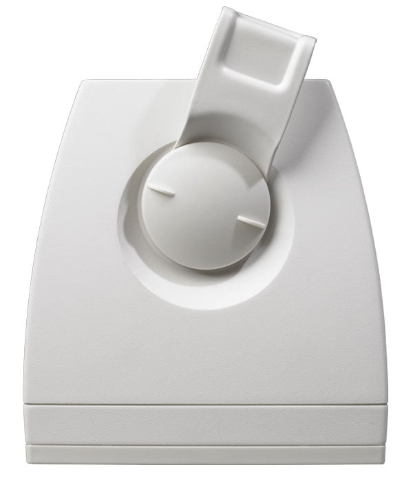

We used tapcons to mount the “C-Clamp” brackets onto the stucco block wall.  We did this by first pre-drilling the holes using a concrete bit and then using hexagon head tapcons.  It’s important to line up the screws with the narrow hole area of the bracket. This will ensure the head doesn’t fall through the bracket once tightened down to prevent massive head trauma to any unfortunate soul in the gravity’s path of the speaker that was installed improperly.
Getting the speaker to tighten down on the bracket is a bit tricky mostly because it’s challenging to line up the screw holes.  I found it easiest to line up the bottom of the speaker first and slightly tighten down the mounting screw before doing the top one.
Before fully tightening down the mounting screws, you will want to properly position the speaker.  The bracket allows pretty good horizontal adjustments but absolutely NO vertical adjustment flexibility at all.  This was a bit disappointing as we’ve seen more sophisticated mounting brackets on other systems.  My advice is to place the speaker as low as possible but high enough so there is absolutely NO chance that Kareem Abdul-Jabbar can bump his head if he ever plans on paying you a visit. A workaround to getting a slight tilt downward would be to wedge an angled wooden mounting plate underneath the top of the bracket while screwing it into the wall with a longer tapcon.

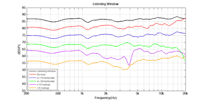

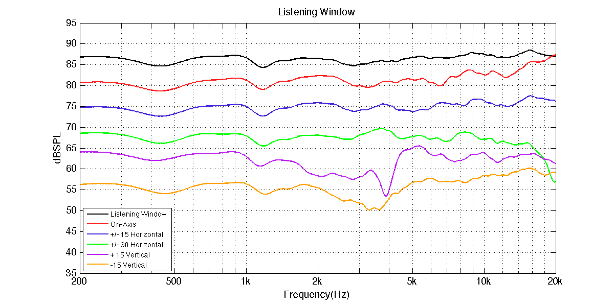

NHT 02-ARC Listening Window
The listening window response is the average of 5 measurements ranging from 30 degrees left to 30 degrees right plus measurements 15 degrees above the speaker and 15 degrees below the speaker.  When the loudspeaker has symmetry about the vertical axis, the right and left are equal and the total number of measurements is reduced to five. The measurement provides a picture of how the loudspeaker performs from seating locations that are not directly on axis with the speaker.  The top curve is the average of the seven positions and provides an idea of how the speaker performs throughout a listening area.  The listening window response for the NHT 02-ARC is excellent.  Notably, at 15 degrees off-axis the loudspeaker frequency response is very flat.

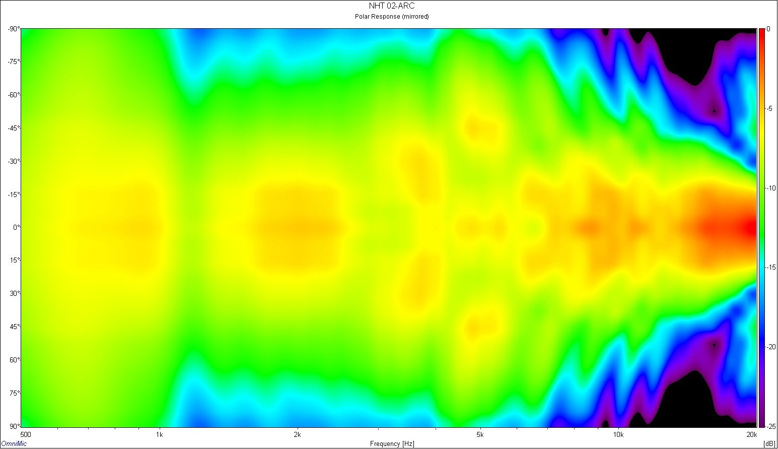

NHT 02-ARC Polar Response with Grill

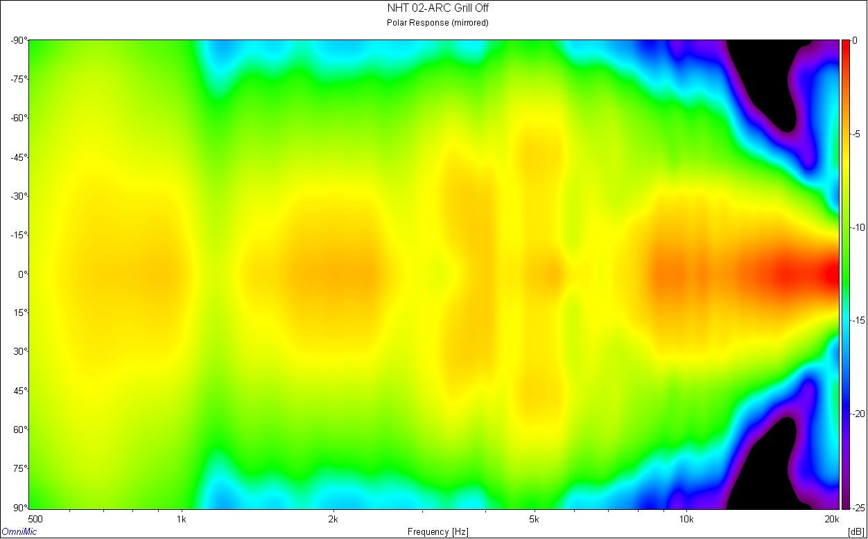

The polar response graph shows how a loudspeaker performs at various seating positions in a room.  The polar response graph above was generated by measuring a loudspeaker at 7.5-degree intervals around a circle half way between the woofer and tweeter height at a distance of 1 meter.  The NHT 02-ARC has uniform polar response with slight aberrations in the upper treble range.  The grille of the loudspeaker has a squared off plastic edge that extends from the speaker baffle approximately ½”.  An additional polar response measurement was conducted without the grille yielding the response shown below.
NHT 02-ARC Polar Response Without Grille
Clearly, the loudspeaker grille has a substantial effect on the off-axis upper treble frequency response.  The performance of this loudspeaker is quantitatively superior with the grille removed.

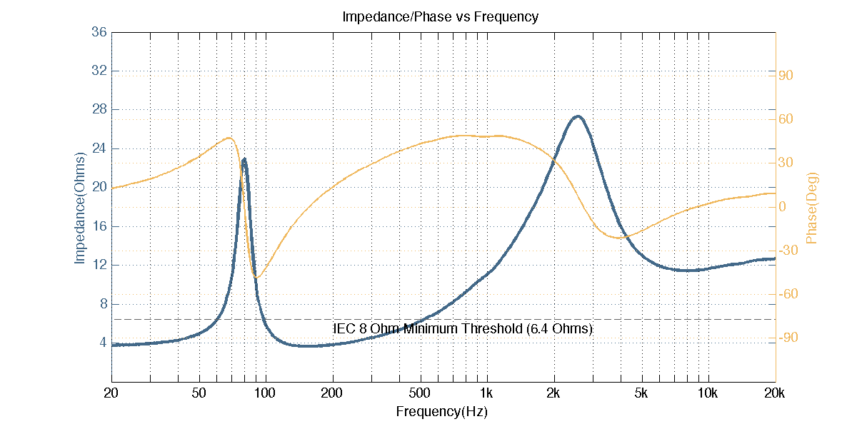

NHT 02-ARC Impedance
The impedance of the NHT 02-ARC loudspeaker dips far below the IEC 6.4 ohm minimum for a manufacturer rated 8-ohm speaker.  So much so that I checked all of the settings and connections several times to make sure the measurements were accurate.  When all else failed, I measured a speaker with known impedance to validate the test rig.  From 500Hz up, this speaker could be considered an 8-ohm speaker.  For frequencies below 500Hz, this speaker is clearly a 4-ohm speaker.  It is highly advisable to drive this loudspeaker with an amplifier that is 4-ohm stable.  If these were my speakers, I would get a label maker out and cover the 8-Ohm label with a 4-Ohm label.

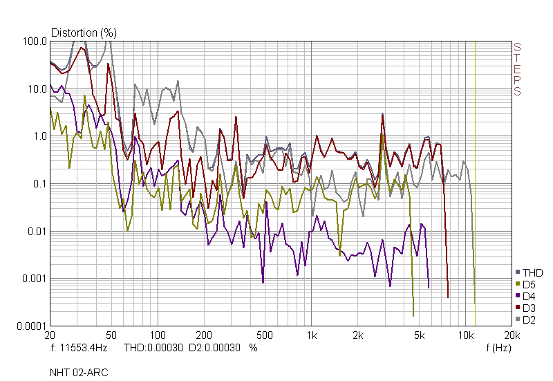

NHT 02-ARC Harmonic Distortion
The harmonic distortion graph was generated using a 90dB stepped sinusoid sweep measured at 2 meters.  This is the last test we perform on a loudspeaker since it really tortures loudspeakers.  This test was run full range putting the sealed 6.5” polypropylene woofer through the ringer.  Considering the size of this loudspeaker, the distortion remains very low averaging well below 1% for the 2nd and 3rd order harmonics above 60 Hz.  The offensive higher order harmonics are very well behaved. There is nothing to complain about here.  This is superlative performance and no doubt a major contributor to the speaker’s taut, controlled sound.

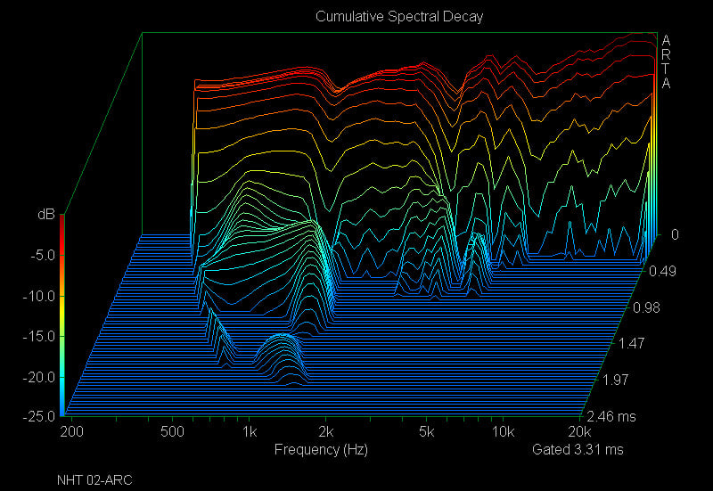

NHT 02-ARC Cumulative Spectral Decay
Cumulative spectral decay (CSD) is derived from the impulse response measurement taken with a 90dB excitation signal at 1 meter.  The cumulative spectral decay shows how sound at various frequencies dies out as a function of time.  It is important to note that the leftmost ridge is not valid and is a product of the measurement technique.  The CSD for the NHT 02-ARC does not show any offensive artifacts except the ridge that reappears at 1500Hz at around 2ms.  One explanation, albeit not conclusive, is that the speaker is stand mounted.  Resonance and reflections from anything close to the speaker will affect the measurement and there isn’t much any manufacturer can do to fix this issue.  Since this is greater than 20dB below the reference level, it is nothing to worry about.

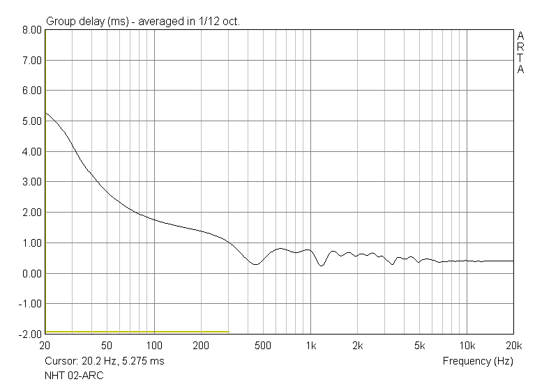

NHT 02-ARC Group Delay
The group delay graph shows the rate of change of the slope of a loudspeaker’s phase.  As a rule of thumb, values below 1.6ms in the mid to high frequencies will likely not effect perception of sound quality.  Increasing group delay in the low frequencies is not as objectionable as it is in the mid to high frequency ranges.  The NHT 02-ARC group delay values are below 1ms at 300Hz.
