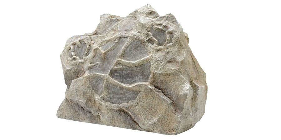

The RK6T2 is part of the Boston Acoustics Voyager series of outdoor speakers. They are fully weatherproofed designed and are constructed of highly durable plastics, rubber and other materials tested for outdoor environments. They are available in three finishes: New England Granite, Sandstone (my review samples), and River Rock.
The RK6T2 features a dual voice coil 6 ½” mica filled copolymer woofer with butyl rubber surround, and two 1” silk dome tweeters. According to Boston Acoustics, the woofers have stepped baskets that sets the cone forward to prevent “tunnel effect” and preserve smooth natural midrange sound. All of the drivers are angled upwards 20 degrees to optimize sound for the listening area when the speakers are placed at ground level.

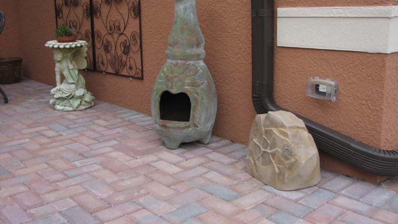

I prewired my home for four speakers in the front yard; two by the front of the house in the landscaped area to provide coverage to people walking on the sidewalk, and two by the front porch to cover the sitting area and front entrance. I installed the RK6T2’s at the porch zone, diagonally placed from the sitting area with one by the front door, and one by the entrance of the walkway.
Boston Acoustics discusses the differences of outdoor versus indoor speaker placement and that the former is setup more for wide coverage area while the later is positioned for a more focused sweet spot in a fixed listening area. They suggest placing the speakers where there is a solid surface directly behind them which will help reinforce the bass output.
I was a bit disappointed that the RK6T2’s didn’t provision for mounting straps like the Paradigm rock speakers I currently have under review. Not only is this a good idea for anti-theft, but it also ensures it keeps them well placed during storms which are plentiful in Florida. These speakers do however have considerable mass so this shouldn’t be much of a problem for all but extreme weather conditions. In those circumstances, I recommend bringing them indoors.

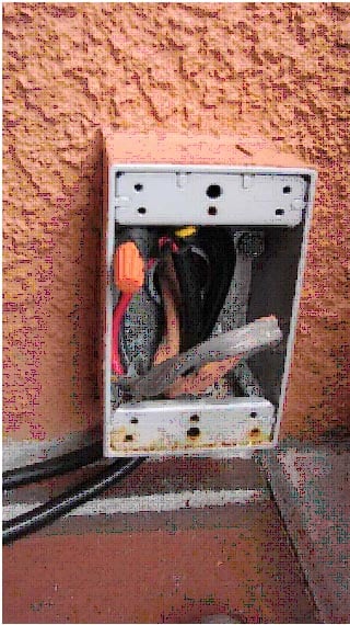

Editorial Note on Wiring:
I unfortunately took the pre-wiring of my home to the extreme by running all 10AWG speaker wires to every location. This made it quite a challenge to connect in wall volume controls as well as self containing the wires in junction boxes. A note to installers and audiophiles alike, you’re better off running 14/4 for redundancy and better flexibility. You can parallel them to yield an effective resistance of 11AWG.
Boston Acoustics provided standard wire nuts you get
when buying ceiling fans or electronic fixtures. Though they added white sticky conductive
grease which created quite a mess for me when I had to disconnect the wires
after I realized I didn’t route the cables through my junction boxes. This is good foresight on their part, but
just remember to know exactly where you want your wires before tying them down. The manual warns about this, but of course, I
didn’t actually read the manual until I started writing this review. As an added precaution, I also used
electrical tape in conjunction with the wire-ties to ensure total isolation and
reduce the chances of oxidation from being outdoors.

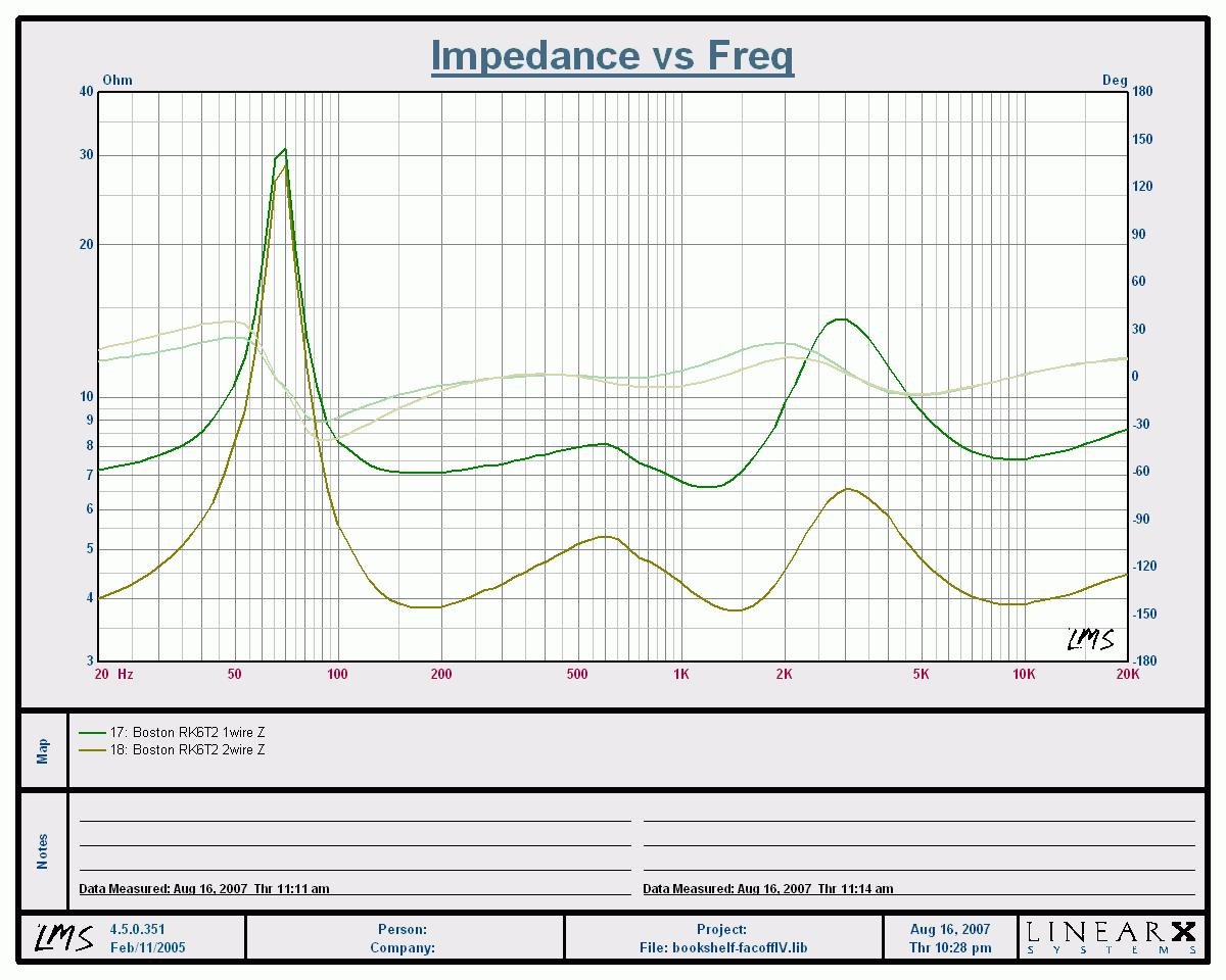

The single wired impedance of the RK6T2’s is roughly 8 ohms while the two wired impedance is (as expected) ½ of that – 4 ohms. The impedance of these speakers is rather benign maintaining +-30 degree phase within the entire audio spectrum and never dipping much below 4 ohms (two wire connection) at any frequency. This demonstrates deliberate and careful crossover design to ensure these speakers will work well with a wide variety of amplifiers.

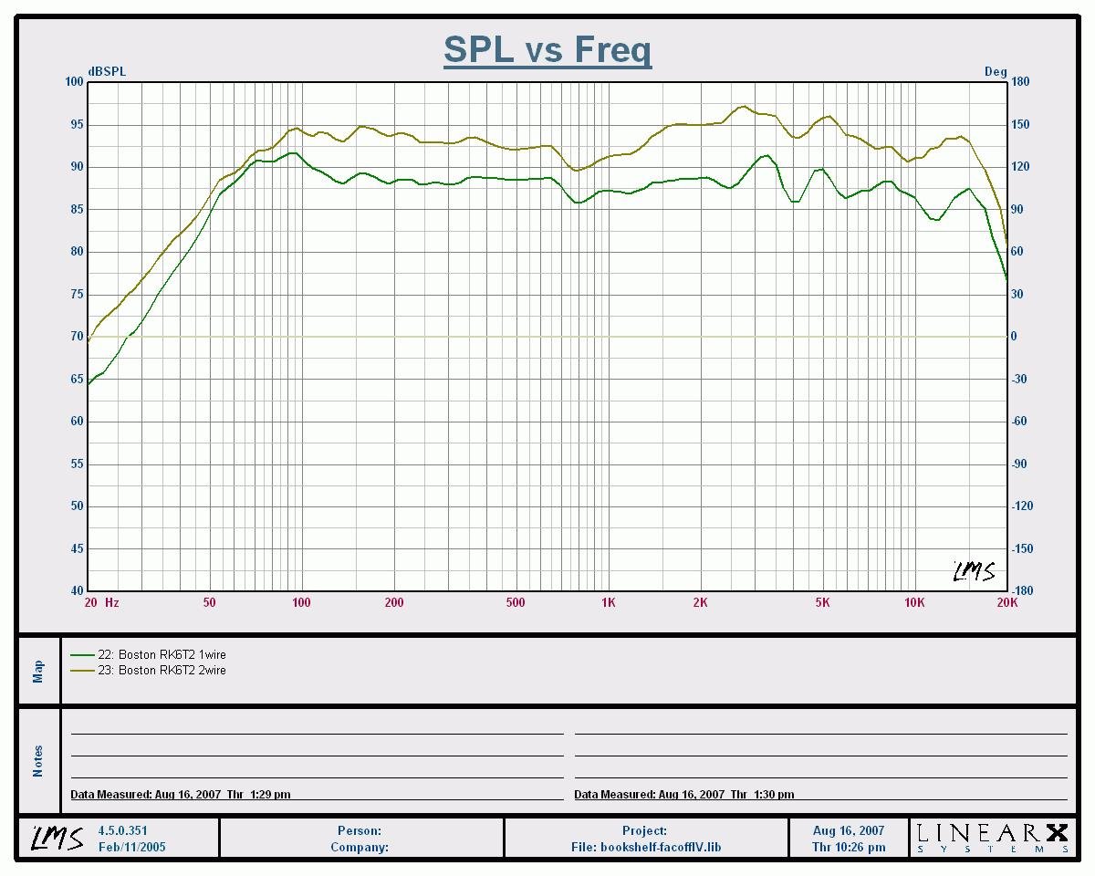

I measured these speakers in the Audioholics showcase theater room placed on the floor with the mic 1 ft away and up slightly above the acoustical center of the speaker. The results were quite outstanding, maintaining a +-3dB frequency response from 60Hz to 16kHz. The one wire measurement was slightly more linear, while the two wire measurement showed an increase in loudness by about 6dB (as expected since the impedance was halved) and slightly more top end which is likely a function of mic positioning more than anything. The usable bass extension of these speakers appears to be in the mid 40Hz region. By placing them against a surface as Boston Acoustics suggests, you could achieve up to 12dB of gain in the lower frequencies by doing this.
