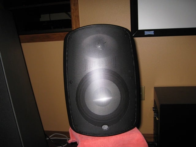

RBH MC-6AW Configuration and Setup
Based on the numerous glowing reviews of RBH Sound products on this website, it is easy for a casual reader to draw the wrong conclusion that fellow Audioholics are overly enthusiastic about this company’s products. Had it not been for the fact that I’ve heard and marveled over their products first hand, I’d probably turn a sympathetic ear to that concern. The reason I’m saying this is because although I’ve listened to various RBH speakers at different places, I’ve never reviewed a pair nor have I had a pair set up in my reference system. I won’t make you wait for a surprise conclusion at the end of this review. I was extremely impressed with the RBH MC-6AW speakers especially because they are only a small indoor/outdoor two-way system. At first I was mainly thinking of these as patio speakers but read further to see the outcome of the “indoor” possibilities.
Description and Inspection
Well I didn’t take the MC-6AW’s apart and inspect
them as I normally do because they are made with molded plastic and sealed for
outdoor use. Physically, they appear to be a fairly standard design for an
outdoor speaker but upon closer inspection, they are not. They have an aluminum woofer, an aluminum
tweeter and a mineral loaded polypropylene box.
I typically do not prefer aluminum tweeters but this speaker is changing

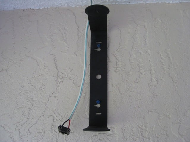

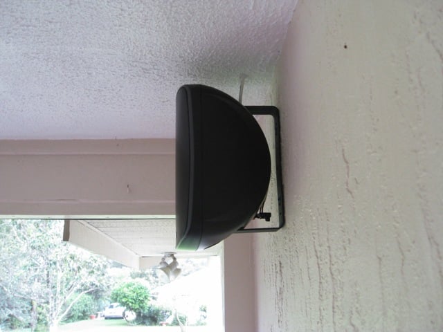

my mind. The speakers came with one bracket that can only swivel one direction,
left and right unless you mount them on their side which I typically wouldn’t recommend. We found out from RBH that if they are placed high up on the wall with the
tweeters on the outside it could allow for good dispersion characteristics
between the speakers and this would allow them to be angled downwards towards
the listening position. There is also a threaded insert in the center on the
back of the speaker to attach a different bracket so both directions of
movement could be achieved. These speakers must be bracket mounted as they are
not meant to stand on their own (although I did it temporarily for reviewing
purposes). The manual is very basic and straight forward, showing the user how
to install the bracket and set the speakers up for optimal sound. I think it is always good to read the manual
even if installation and set up is intuitive because there maybe something the
manufacturer wants you to know to optimize the product.

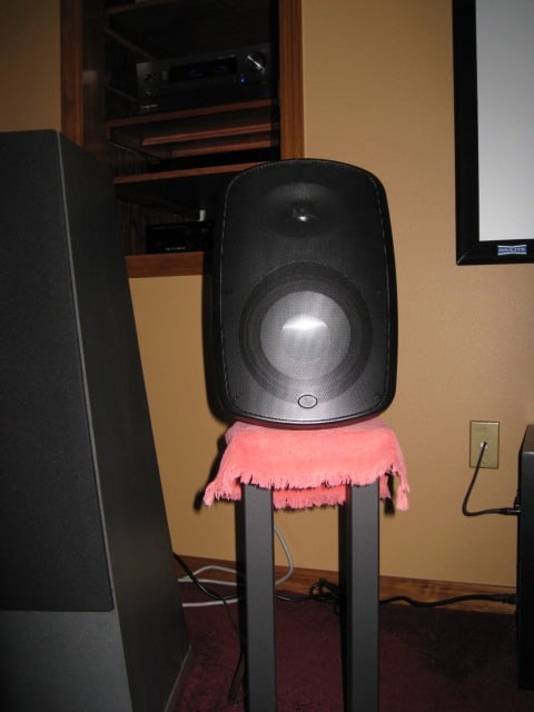

I set these speakers up two different ways and
conducted a unique listening session for each. The first thing I did was
temporarily put them on stands in my reference system just on the inside and a
bit forward of my reference speakers. Ideally they should have been mounted on
the wall like they were designed for which adds the proper low end gain to the
overall response. I didn’t want to go to the trouble of mounting them in my
reference system for obvious reasons. But I did want to give the MC-6AW’s the
opportunity to perform with my best equipment in a nearly ideal acoustical
environment. Let me reiterate, these speakers are not meant for stands. They
will easily tip over. I set my processor
to “small” with an 80Hz crossover and except for a brief listen in “Direct”
mode I had the subwoofers on during my listening sessions. If these speakers are to be used indoors they
would surely need to have a subwoofer to go with them.

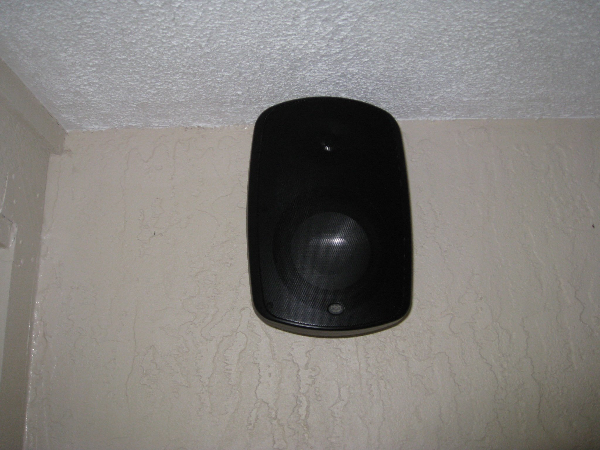

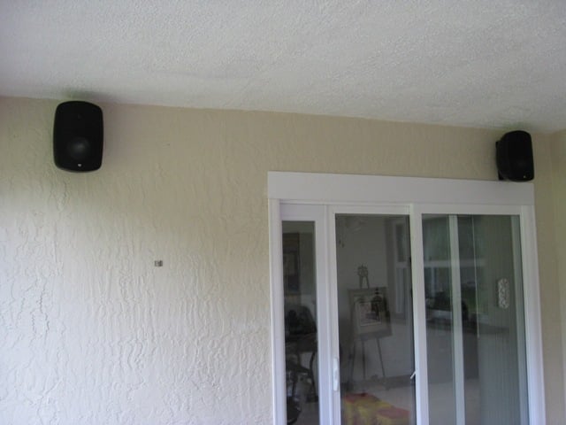

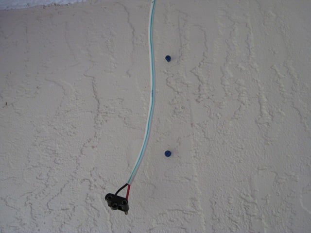

The other setup I did when testing these speakers was to mount them on my patio for outdoor listening. I mounted them near the ceiling and here is where I wished the speakers had a bracket that swiveled up and down so I could point them down slightly. I used my family room equipment which consists of an old Yamaha receiver and Panasonic DVD player. This was quite a step down in component quality compared to my reference system but not bad especially for outdoor purposes. There is no subwoofer on the patio. The installation was quite easy. I have block walls so I just used a couple of Tapcons, put the brackets on and mounted the speakers. The installation was as easy as it sounded. Of course I left out the wiring which is always the hardest part when you want to hide them.

After installing the speakers on the patio I listened again to some of the previous material except for the SACD stuff. The environment outside is obviously completely different. There were not 4 walls, there were only two block walls and tile floor. There are also outside noises to overcome such as cars and jets (I live in the flight path to the airport). There was no acoustical treatment set up, just the speakers and the outdoors. I had a preconception that they sounded good in my pristine listening environment but probably won’t on the patio. I was wrong. They also sounded great on the patio. Of course I couldn’t hear all the nuances that are heard on my reference system but I would surely be proud to show these off to any guests. Although I thought these speakers needed a bracket that could have been angled downward, I found that it was unnecessary. The dispersion was excellent. The first thing I noticed was that the sound stage was very high, ha ha (they are mounted near the ceiling). I definitely heard the better bass response from the boundary gain caused by mounting them on the walls. The Yes tracks carried the same involvement that I am used to hearing. I still heard the highs and detail very well like in Funhouse from Flim and the BB’s. There is a part in it that has a chime that I could hear with great detail. Even in the outside environment “Into The West” carried the dynamics well and Annie Lennox’s voice was still captivating enough. On “Malcolm Makes Hajj” the instruments sounded real and had good detail. It doesn’t make a lot of sense to talk about the sound stage in this environment though. On “Tom’s Diner” I could hear a lot more reverb due to the block walls and tile floor but it still sounded good. Hearing all this detail with the speakers mounted so high told me that the dispersion was excellent and that can be seen in the measurements to follow.

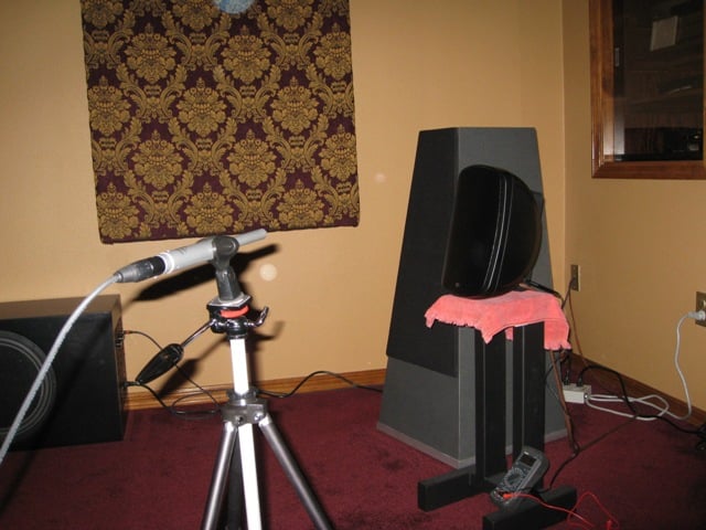

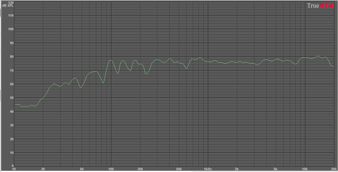

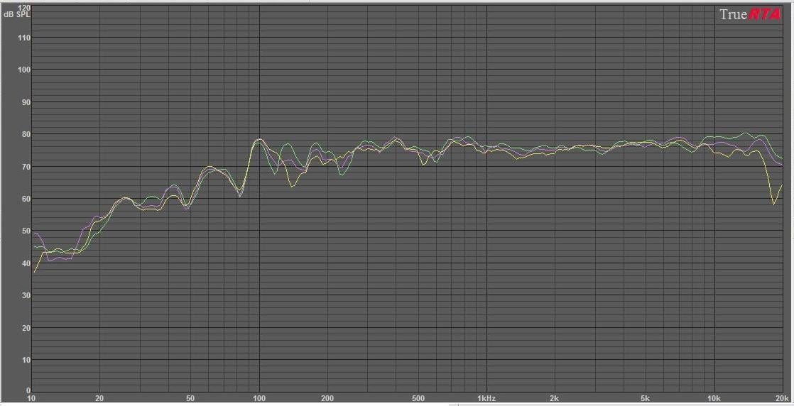

The measurements that were taken were very basic.
First a frequency response was taken at 1 Watt at 1 meter and then the off axis
response was taken I didn’t perform a room response because I didn’t see any
added value by providing it. Using TrueRTA’s quick sweep function reveals quite
amazing linearity in the response curves.
The on-axis frequency response of the MC-6AW is nearly ruler flat above a few 100Hz.. On the low end remember that there will be some gain when mounted on a wall which will provide better spectral balance.
Near field Frequency Response
The off axis response is mainly used to determine how well the speaker’s reflections will sound. If the shape of the off axis responses are the same as the on axis response wall reflections from these speakers should sound okay if they are vastly different then some absorption material should be used. In the case of the MC-6AW’s the response barely fell off showing excellent dispersion. This design is excellent; RBH knew that these would be mounted under ceilings or eaves and accounted for that in the response.
Off Axis Response - 0º, 30º, 60º
