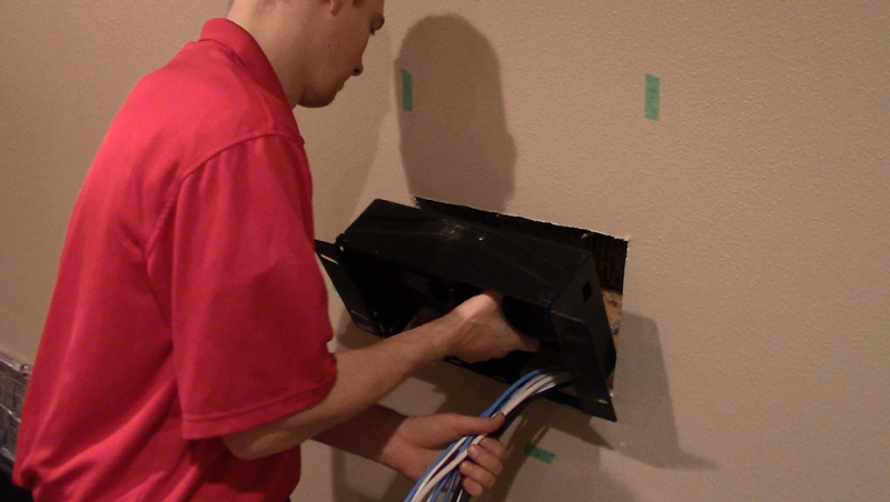

The included cut-out template make is easy to level, mark and cut out the spot for the recessed box. Don’t worry if the cut-out isn’t perfect, as the TV can be leveled later on and a plastic cover will hide the edges of the box.

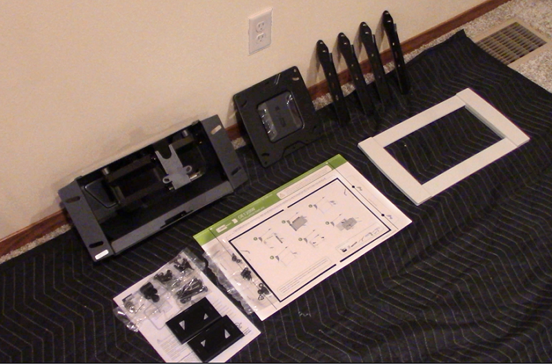

recessed mount parts
OE120IW Parts
There’s nothing notable about the process of bolting the recessed box to the wall, attaching the brackets to the back of the TV, or lifting the TV onto the mount - and nothing notable is a good thing.
Once the TV was up and the safety screws in place, I adjusted the mount until the TV was level, the tilt tension until it could be tilted by fingertip, and arm tension so it pushed in and pulled out easily. At this point, all that was left was to install the outlet, hook up and dress the cables, and install the décor covers. Using a standard old-work electrical box, installing the outlet went without issue.
TV mounting plate          installing recessed box
Installing the OE120IW
Properly routing and dressing the cables took a bit more effort. The cable channels in the arm are best suited for small diameter, flexible cable. In my situation, I had to run HDMI, Ethernet, power for the TV, and three separate speaker wires through the channels. I was able to make everything fit, but just barely and not without some struggle. I suspect that most users will only run HDMI and power, in such a case the channels should work perfectly as long as the HDMI cable isn’t too thick. If it is, an HDMI coupler to a thin cable could be used.

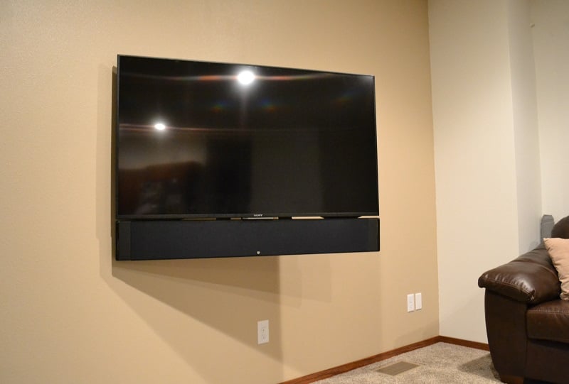

Once the OE120IW was in place, I used it for a few months before writing this review. I wanted to see how it would perform for the long term. In short, it’s a solid product. Pulling the TV out and pushing it back in was easy once I loosened the tension nearly all the way. And, thanks to the double-arm design, you can pull it out all the way without fear of the joints locking, at which point you would need to go behind the TV and push the arm back a bit to unlock the joint. However, as with any full-motion mount there is a certain amount of stress put on the TV when you move it in or out. I’ve never had a TV break from this, but it always makes me a little uneasy.
I leveled the TV post-installation, and it remained level as I continued to use the mount over the following months.
outlet with surge protection
Panamax surge suppression outlet installed in OE120IW
My 55” Sony X850c looks great when pushed flat against the wall. The low-profile of the OE120IW makes a noticeable difference when compared to traditional full-motion mounts. The 10.75” arm is pretty short compared to the 15” – 28” arms on many of the other mounts I’ve used, but for my purposes it’s all that’s needed. The arm allows you to swivel a TV just enough to make sitting anywhere in a room – other than maybe at drastic angles – a good viewing experience.
