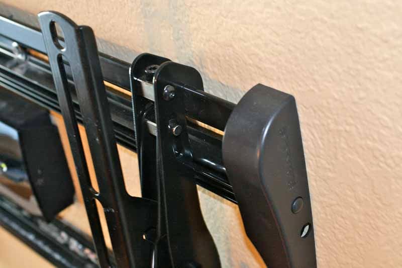

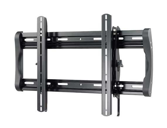

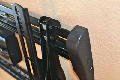

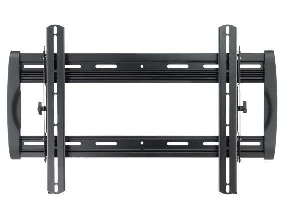

The Sanus LT25 Flat Panel Wall Mount is an open-back design, which I prefer over those mounts which provide a solid plate across the back. Open-back mounts give you some interior room to use for centering wireless HDMI receivers, recessed power plates or other modules or devices such as Sanus' ClickFit surge protector. They also tend to be easier to maneuver and weigh less. The mount is made from heavy gauge extruded aluminum, which makes it strong and light. The end caps, which bear an embosses Sanus Systems logo, are made of plastic to further reduce weight and give the mount a nice finished look. This is a beautifully machined piece of equipment.

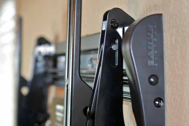

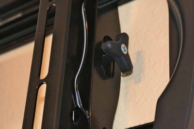

The mount works by installing the back plate to the wall and then hanging the two Virtual Axis tilting arms which are designed to be pre-fastened to your television or display. Tilt adjustment tension can be set using the knobs located on the side of the tilt arms, and adjustments are easy, either by hand or via an allen wrench. The two arms slide along the mount rails, both top and bottom, so you can actually center the TV in your space, even if the mount needs to move to the right or left during the installation process.

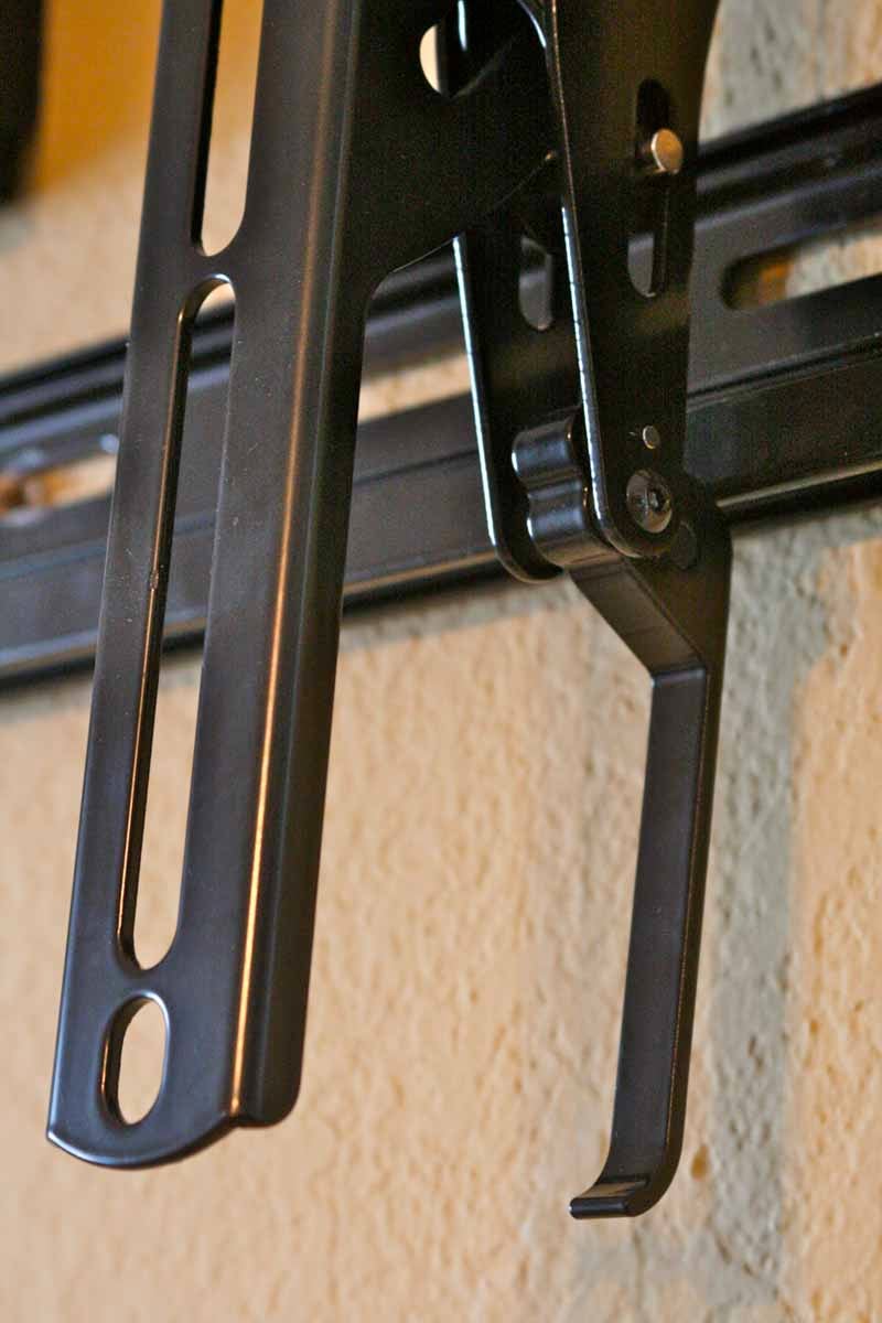

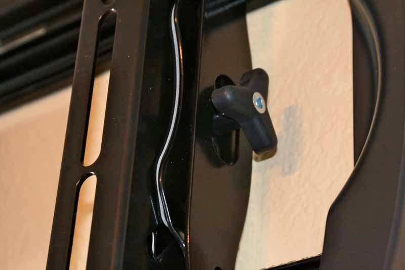

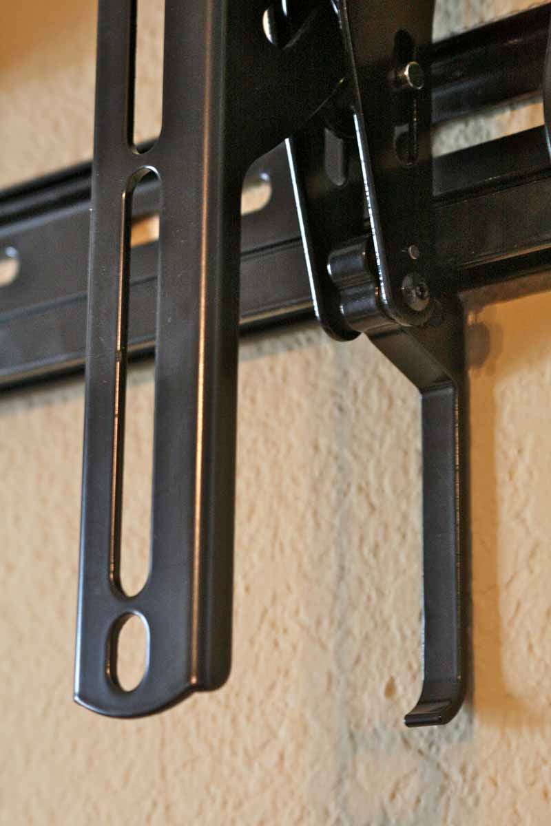

A ClickStand mechanism means that you can release the bottom of the mounting brackets and swing out the TV for easy installation of power, AV and network cables. This is one of the most convenient features we've seen, save for the next one I am about to mention. A ProSet post-installation height adjustment screw is located on each tilt bracket. This means that you can basically slap the mount up on the wall any which way (more or less) and you will have 2 degrees of roll in either direction in order to assure your television is level. I cannot stress enough how important this is. A natural and accepted part of mounting flat panel TVs involves a torpedo or 2-foot level, which you place on the mount as you mark it out on the wall. This assures a level positioning of the mount bracket. The trouble is, screws drift and, particularly in older homes, floors and ceilings aren't always straight. When you finally mount your TV on the wall, it is not uncommon to note that it is slightly out of sorts and not at all level. The built-in adjustment provided by Sanus removes all worry and you can finally just install the mount as needed and handle the fine-tuning afterwards (we still recommend you use a level, but if you're even remotely close you are good to go).
The ClickStand disengaged the bracket from the lower rail and then swings around to stand off the TV from the wall, allowing you to make cable connections easily and quickly.

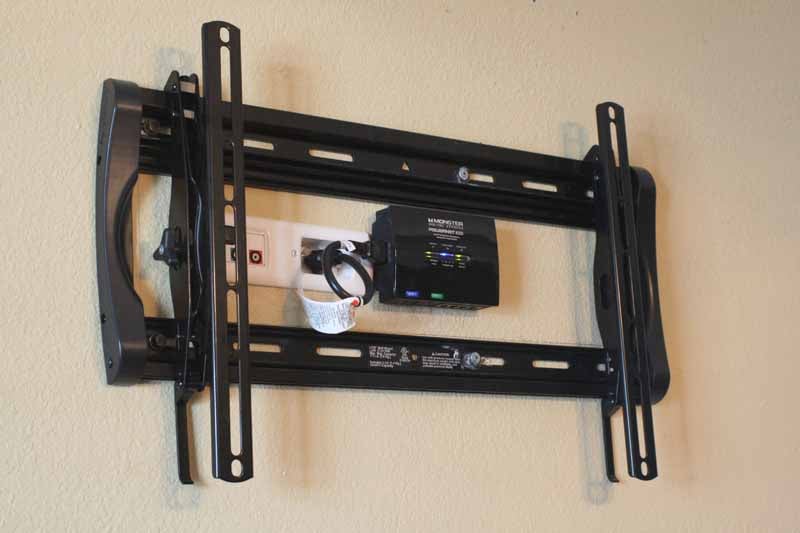

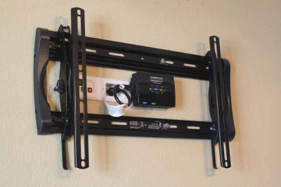

Installation was a breeze. This mount was one of the easiest products I've ever installed. In fact, with the ProSet system, we slapped up a torpedo level, marked our holes and went to town. After locating the studs and pre-drilling the holes for our lag bolts, we put the mount up on the wall and secured everything in place. Because the mount is so wide, it's very easy to catch studs at all four primary mounting points. The entire aluminum mounting plate has openings at top and bottom across the entire length in order to facilitate an easy installation, regardless of your location. Sanus also included mounting hardware for both wood and masonry, complete with washers, bolts and stand-offs.
About the only thing to even watch out for during installation is the location of the mounting holes on your television. If they are less than ~16" then the tilt mechanisms should be located on the outside of the mounting brackets. If greater than ~16" they should be on the inside. All this means is that you may have to reverse the tilt adjustment knobs by removing them completely and inserting them on the other side, so you can switch the tilt arm brackets around. The tension knobs should always, for obvious reasons, be located on the outside so that you can get to them for easy adjustment.
Once everything was in place, we made good use of the ProSet height-adjustment screws and dialed in the mount to be perfectly level. This was done while holding our torpedo level on the top of the display and adjusting the ProSet screw with the included allen wrench. In less than 2 minutes our television was perfectly level and installation was completed. Now all that was left was installing the myriad of devices and wall plates we had in store to wrap up our installation. One note - while positioning any peripherals, be sure to check your clearance and ensure that your tilt brackets aren't going to interfere with cables or anything you plan to place behind the screen.
The ProSet screw is on top of the tilting bracket and adjusts easily for 2 degrees of positive or negative roll.
