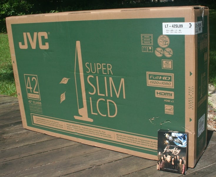

The super slim JVC LT-42SL89 arrived in the smallest box I've ever seen
on a display. It was barely bigger than the display itself. What was nice about
it was that it was easily manageable by the delivery driver. It also seemed to
be well enough braced and protected for travel. My only concern was that the
small thickness of the box would not stand up well to inertial forces around
tight corners. Of course, any driver that would just lean your new display
against the wall of their truck without securing it is just going to find a way
to break it no matter what box it is in.

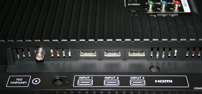

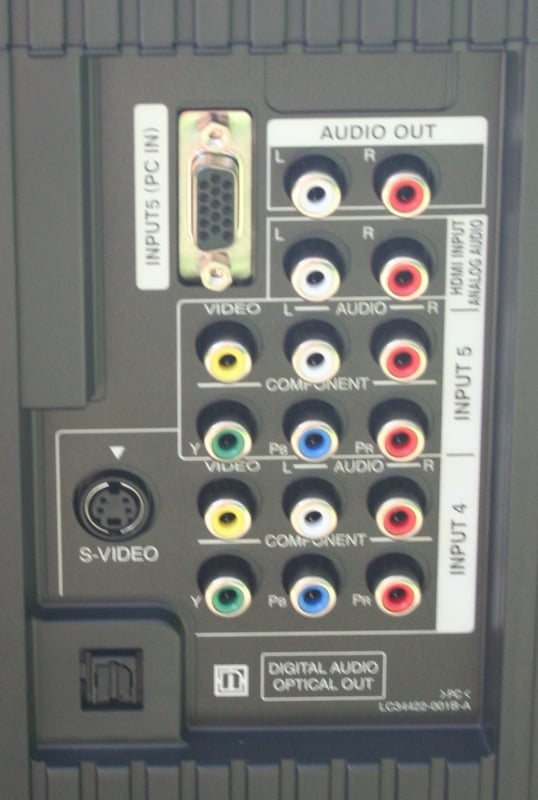

cable in and connecting your inputs. The LT-42SL89
sports three HDMI inputs, a PC input, and two analogue inputs that have component,
composite, and analogue audio inputs. One of the analogue inputs also has an S-video
input, plus there is one analogue audio input for all three HDMI inputs (one
for all three, not one each). There are single analogue and TOSLink audio
outputs along with a coaxial F/cable input for your cable or OTA signal. To the
side (still on the back) is a headphone output and a USB input for high
resolution picture viewing.

I personally like the number of inputs on this display and find them more than adequate. Three HDMI and two component should be enough for anyone. For those of use that use a receiver or processor for video switching this is probably 2 HDMI and 1 component more than we need (provided there are no connectivity issues). For the rest of the world, it should be more than enough. One thing that I found a bit deficient was that the component inputs wouldn't accept a 1080p signal. When I connected my Xbox 360 via component, I found I had no picture. A little research uncovered that the components could only accept up to 1080i. The HDMI inputs, on the other hand, could accept 480i inputs which is a bonus. If you have a display that does a good job of deinterlacing, this is a must.

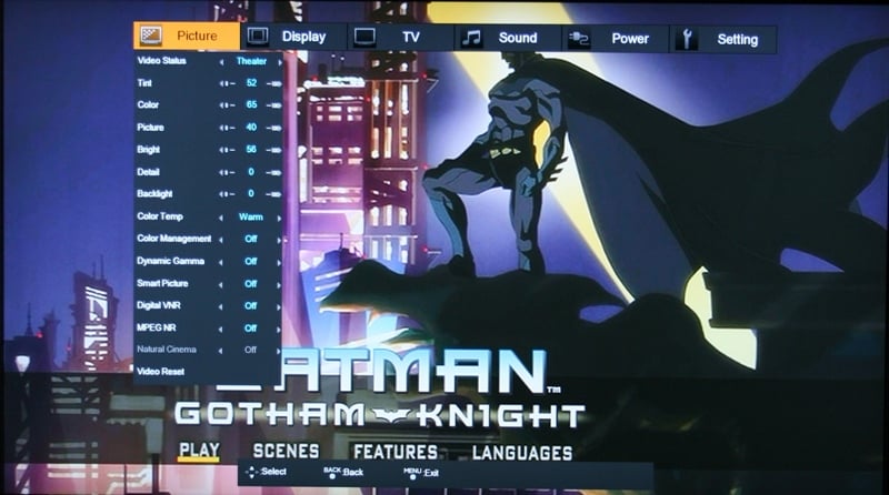

that really needs an overview is the Picture menu. Of course you will find
Tint, Color, Picture, Bright, Detail, and Backlight. Notably absent was
Contrast which I suppose is covered under "Bright." Color and Tint is
something you should probably never touch with Picture and Bright being used
for your initial calibration. Detail should be used with care (if at all) as it
will add artifacts if turned up too high. As for the rest of the settings:
Video Status - Standard, Dynamic, Game, and Theater. Theater is the only one that really looks natural. You can think of Standard, Game, and Dynamic as Blue, Bluer, and Blue Man Group.
Color Temp - Cool, Natural, and Warm. Warm is really the best with Cool just adding to the blue and Natural looking a little washed out.
Color Management - Supposedly corrects for dull colors. I played with this option a bit and it did add to the lushness of the picture sometime to the point that it looked a little "glowing." I didn't like the effect myself.
Dynamic Gamma - Even though JVC says that this should be enabled for "optimal picture quality," I found it probably the most annoying feature ever. Basically, it is supposed to adjust the detail in the dark areas so to increase black definition. What it does is make every change of scene a little lighter and then adjusts it down. EVERY CHANGE. It isn't a subtle effect either - it is very visible. And annoying. If this is what it takes to have "optimal picture quality," I'm just going to have to lower my standards.
Smart Picture - Adjusts the overall brightness based on what you are watching. If this option did anything, I couldn't discern it.
Digital VNR - Digital Video Noise Reduction is used to reduce video artifacts. There are High, Low, and Off settings.
MPEG NR - This noise reduction reduces block and mosquito artifacts. This only has an On and Off setting. I found that this setting softened the detail of the picture too much even though it did reduce noise considerably. I'd suggest keeping this option set to Off.
Natural Cinema - Essentially provides 3:2 pulldown. This option only works for 480i and 1080i sources.
The only real problem I had was that Natural Cinema (necessary for 3:2 pulldown) would turn itself off every time the unit lost power (and on other occasions though I couldn't determine the cause). If you live in a place where you get power outages very rarely, maybe this isn’t such a big deal. Unfortunately, I live in Florida where power outages come 2-3 times a week on average. There is really no reason that this setting (or any for that matter) should reset and not get stored to some kind of non-volatile memory. If you own this set, you're going to have to get used to periodically checking this setting.

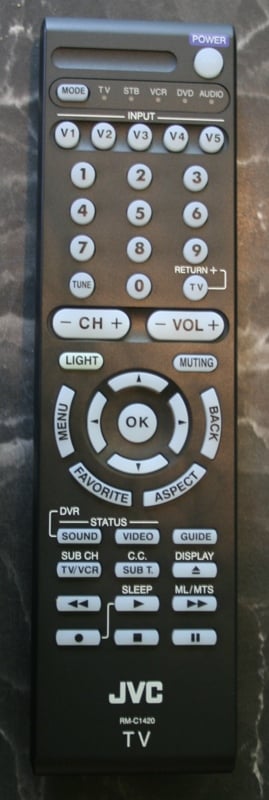

Remote Control
The funniest thing about the JVC remote is that it came with
Panasonic batteries. Not sure exactly what that means. Like many remotes these
days it is universal with a few pages in the manual dedicated to remote codes.
The remote is a flat black and it a bit thicker at the bottom than the top. It
is fully backlit (yeah!) but the "light" button is hidden near the
center of the remote (boo). There are individual buttons for every input
(yeah!) but only a single button that switched between the different devices
(boo - but I don't use it as a universal so I don't really care all the much).
The "Menu" and "Back" buttons are on opposite sides of the
arrow keys with the "Favorites" and "Aspect" buttons far to
close. It is remarkably easy to it the wrong button which will knock you out of
the menu completely. As remotes go, it isn't terrible but it isn't great
either. I'd call it "functional."

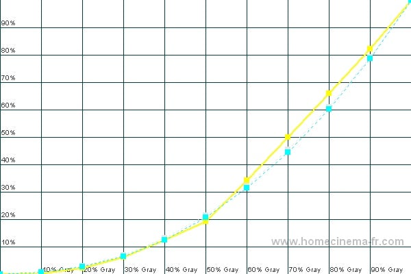

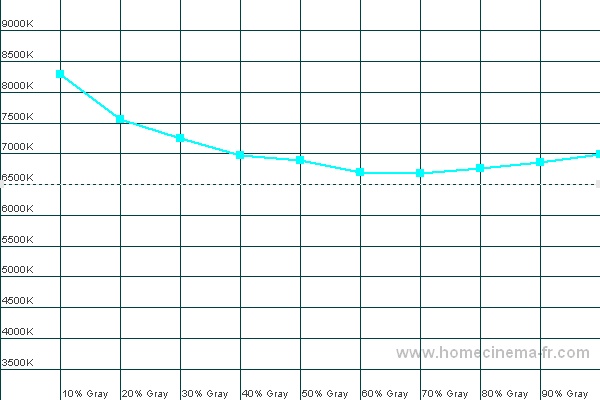

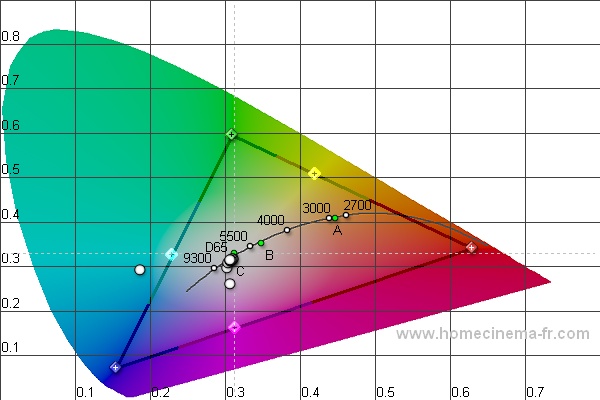

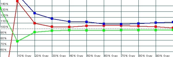

For calibration I'm using both the Sencore ColorPro5000 and Colormetre HCFR software. Basically, Sencore is great for calibrating your set but doesn't give you the pretty graphs that we like to show in our reviews. That's where Colormetre comes in. From the default settings, I measured:
Dynamic - 11000k (524:1 ANSI contrast ratio)
Standard - 9500k (596:1 ANSI contrast ratio)
Game - 11000k (390:1 ANSI contrast ratio)
Theater - 7000k (338:1 ANSI contrast ratio)
There really aren't any adjustments you can make to the default settings. Sure, you can set brightness levels and such but there aren't any gain or cut scores that can be used to adjust the color temperature. From the standpoint of a subjective evaluation, Dynamic/Standard/Game are all pretty useless because they are so blue. I'm sure I could have eked out a higher contrast ratio based by adjusting the backlight but these were the measurements I got from the default setting. After switching the Video Status to Theater, I adjusted the brightness and detail using the Avia disc and got the following measurements:
Color Temp (left); CIE (right)
Luminance (left); RGB (right)
Perfect Score is 130
JVC LT-42SL89 Benchmark total score: 76/130 and 77/105. All tests were run through the HDMI input.

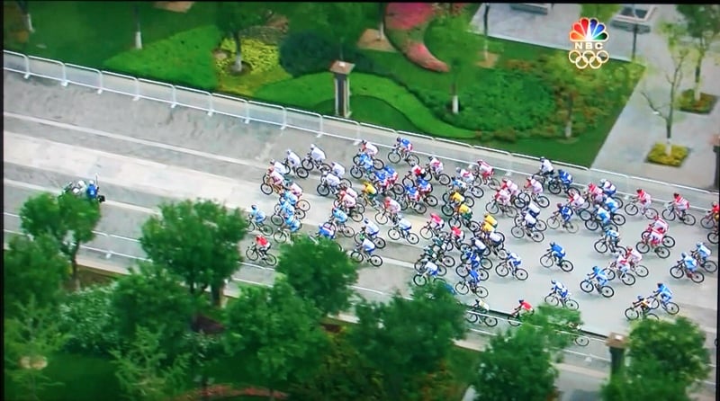

HDTV - 2008 Beijing Summer Olympic Games
I love the Olympics, always have. Now that I have HD, I really, REALLY love it. With a good HD signal, watching the games is like sitting in the stands. It looks so real. Of course, most of these sports are fast moving which is an excellent time to gauge how the display handles fast motion. The LT-42SL89 did remarkably well with fast motion and I was very pleased to note very little motion blur. Even on the fastest scenes, the motion blur was very subdued and only by paying close attention could I even see it. None of the others that viewed the set noted it (some, even after I asked them to look for it). The images were crisp and clean and the colors well saturated. Any major (or minor for that matter) problems I noted were attributable to bad signal quality and not any problem with the display.

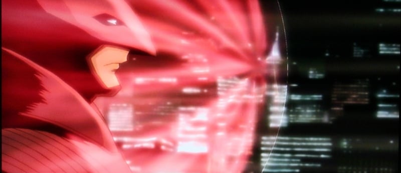

This animation DVD sports six short stories about the Dark Knight that supposedly takes place between the Batman Begins and The Dark Knight. I was very interested in this DVD as I am allergic to movie theaters (has to do with the bad sound, noisy people, and ridiculous price of popcorn) and wanted my Batman fix. You can only see so many previews for The Dark Knight before you go a little stir crazy. The animation varied between lame and just OK with most of the stories hovering somewhere between boring and "wait, did I just nod off?" I was particularly concerned about the black levels and how well the LT-42SL89 would handle them. For the most part I was pleased as I didn't note any macroblocking or visual artifacts. The blacks were just OK, however, as I noted that even after calibration they were more a dark gray than black. If I lowered the brightness enough so that the blacks were truly black, the entire picture looked a little dim. Overall, it wasn't too bad though.

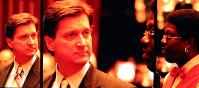

HD DVD - Ocean's 13
Imagine my surprise when I found a movie on my Netflix cue that was available in HD DVD (yes, it had been there a while). Like everyone else, I had really enjoyed Ocean's 11. Ocean's 12 was sort of a bomb for me but I had heard that this one was better. It was, but it still lacked the magic of the first as far as I am concerned. The picture overall was crisp and clean and the colors really popped. There was one scene where everything was tinted red and if you had the display in anything but Theater you'd see a TON of artifacting. Even when calibrated, this scene was mighty grainy. Overall, though, the picture looked really good.
