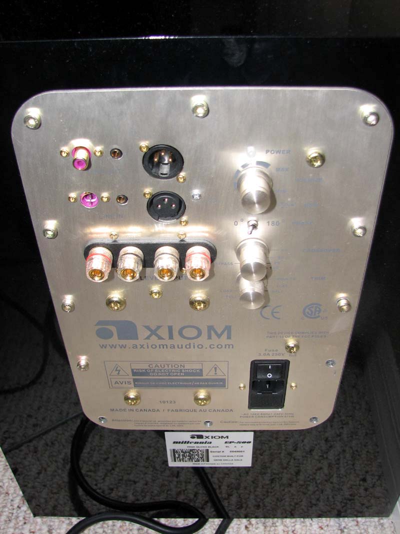

I recently had a few issues with my unit including:
- Both RCA level connectors came loose and eventually broke off
- An intermittent thumping sound developed that would only go away if I power cycled the unit; only to come back a few days later.

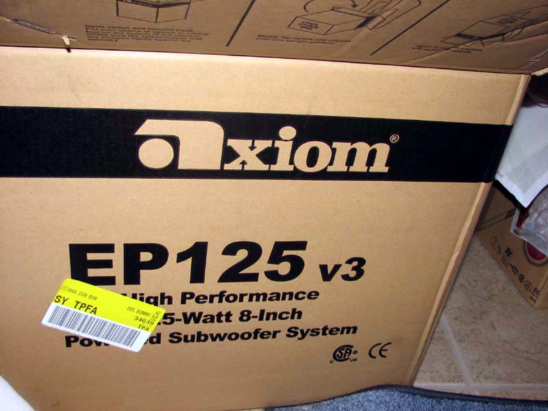

What did
take me for a spin was the fact that I received a heavy box with EP125v3
markings on it. I scratched my head
thinking “did I ask them to send me a sub?”
Maybe they assumed I wanted a little sub for my workout room. Incidentally I noticed the v3 marking and checked their website which currently
shows only v2. Perhaps they have sent me
a prototype of a revamp to their sub?
Before opening the box, I was getting a bit excited of that notion, I phoned them to verify. I didn’t want to jump the gun because the possibility of a shipping mistake and have Axiom B-stock a perfectly brand new Ep125 subwoofer product I mistakenly opened that wasn’t meant for me. It turned out this is how Axiom ships replacement amps for their EP500 subwoofers. It still didn’t explain the weight but I figured I’d verify this for myself nonetheless. I think Amie may have sensed the disappointment in my voice that I in fact didn’t mistakenly receive a new subwoofer but my curiosity was getting the best of me and I wanted to solve this mysterious weight issue.

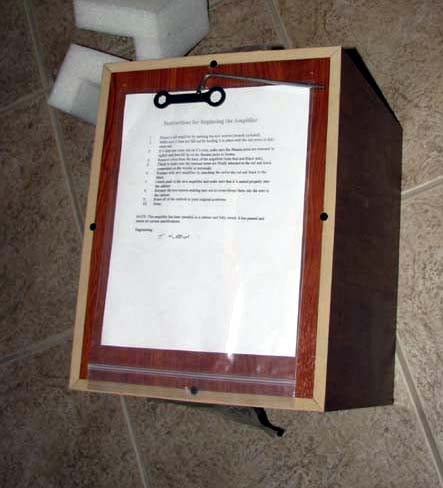

When I opened the Ep125v3 box, I noticed a hardwood box with an instruction sheet and some tools. I glanced at the instructions which were very specific on how to replace the EP500 amp. Of course I put them to the side, never to look at them again (as I typically do with user manuals and instructional sheets) and got to work. For those that like to follow directions, I included them as an attached PDF in this article in the related links area.

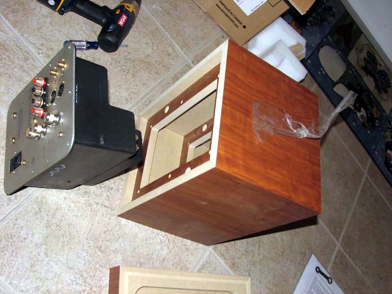

Unscrewing the EP500 amp from the Ep125 box required a power drill as the screws were quite large. When I pulled the amp out, I noted how the internal bracing of this box seemed more structurally rigid than the actual real subwoofer product itself. It was clear to me that Axiom took every precaution to ensure this amp arrived undamaged to me.
Using their supplied tools, I removed the old amp (after unplugging it of course). The large torroid power supply of this amp makes it rather hefty. I suggest removing the bottom screws first and placing one hand towards the bottom while removing the remaining screws.

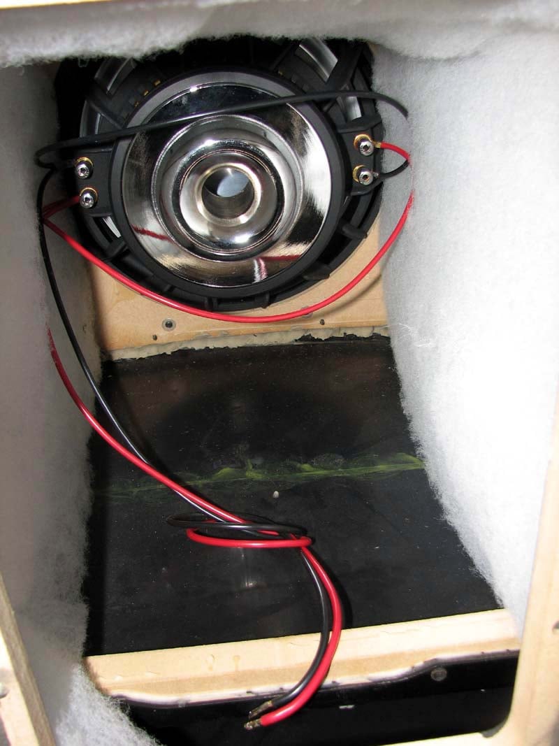

It was nice to see the inside of my EP500. The massive motor structure and cast basket, and dual terminal lugs of this driver still impresses.
