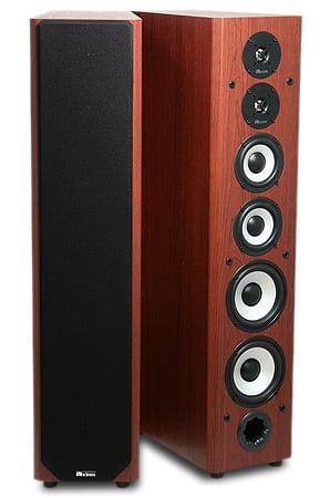

M80ti tower speakers
Enclosure: Triple Vortex / Reflex
Max Amp Power: 400W
Min Amp Power: 10W
Freq Response +/-3db: 34 - 22kHz
Freq Response +3dB- 9dB: 25 - 22kHz
Impedance: 4-ohms
SPL (in-room 1w/1m): 95 dB
SPL (anechoic 1w/1m): 91 dB
Crossover: 160Hz & 2.3kHz
Tweeter: Dual 1"
Mid-bass: Dual 5.25"
Woofer: Dual 6.5"
Dimensions: 39.5" x 9.25" x 17" (1003mm x 235mm x 432mm)
Weight: 55 lbs (25 kg)

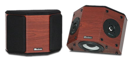

QS-8 Surround Speakers
Enclosure: Acoustic Suspension
Max Amp Power: 400W
Min Amp Power: 10W
Freq Response +/-3db: 95 - 22kHz
Freq Response +3dB- 9dB: 65 - 22kHz
Impedance: 6-ohms
Crossover: 2.5kHz
Tweeter: Dual 1"
Dimensions: 8.25" x 11" x 6" (210mm x 279mm x 152mm)
Weight: 13 lbs (4 kg)

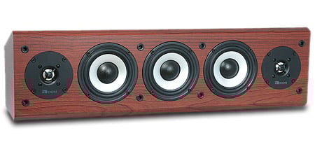

VP-150 Center Speaker
Max Amp Power: 400W
Min Amp Power: 10W
Freq Response +/-3db: 85 - 22kHz
Freq Response +3dB- 9dB: 50 - 22kHz
Impedance: 6-ohms
Crossover: 2.7kHz
Tweeter: Dual 1"
Mid-bass: Triple 5.25"
Dimensions: 7.5" x 27.5" x 7.5" (191mm x 699mm x 191mm)
Weight: 20 lbs (9 kg)

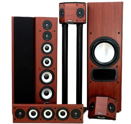

- Two M80ti tower speakers-front left and right
- Two M80ti tower speakers-alternate surrounds (7.1 system)
- One VP-150 center speaker for the 5.1 system (Two) to be used in the 7.1 system
- Two QS-8 used for surrounds 5.1 system and EX channels in the 7.1 system
- Two EP-600 subwoofers placed 1/3 in from sidewall
Over 24 Custom Matte and Highgloss Finishes and 6 grill cloths are also available at an extra charge of $95-$350 USD per model; to a maximum of $275-$1000 USD per system in the same finish.
Axiom Epic 80-600 VP150 and M80ti
The VP-150 center channel speaker is a very interesting design. The speaker configuration with the tweeters placed at the ends of the enclosure is one that I have not seen produced in the many years I have been installing speaker systems. The reasoning behind this design is said to improve dispersion and off axis response on the left and right side. It is also said to provide a broader soundstage and wider array for more seated listening positions. It is a sealed design for easy placement and integration into custom A/V cabinetry.

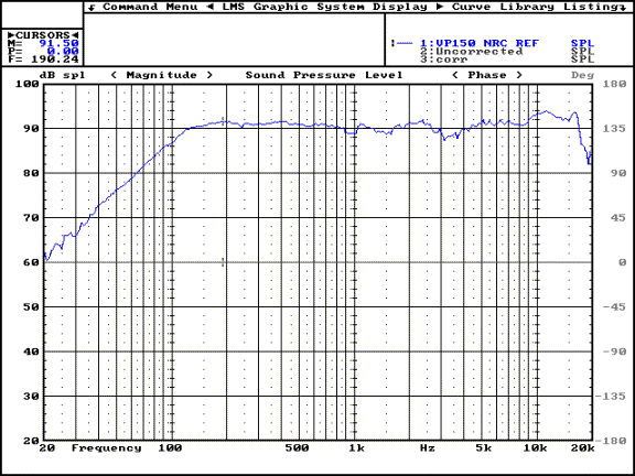

The VP-150 has a pretty flat frequency response. There is a slight hump between 12kHz -17kHz. Also note the effective low frequency cutoff of about 80Hz.

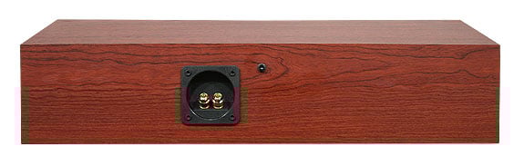

Around
the back of the VP-150 you will find very high quality five-way gold plated binding posts and the mount

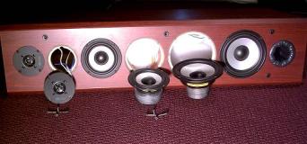

hole for the optional wall bracket as shown below. A look inside the VP-150 revealed very good speaker
components and build quality. The enclosure is constructed from 3/4" MDF and is lined with polyfill. 18
AWG high strand count copper wire is used from the crossover to the speaker spade connections. The
speaker's woofer component is of high quality aluminum and the midrange speakers have steel baskets,
large motor structures, and shielded bucking magnets.
The tweeters used in the VP-150 are composed of a high power handling
titanium dome.
As shown below all drivers are recessed in the front baffle to improve imaging and
reduce diffraction. This is a nice touch for a speaker in this price class. Many speakers costing much
more take the easy and more cost effective route and flush mount driver components.
The VP-150 has excellent fit and finish at this price point. The vinyl Boston Cherry looks like real wood and no visible seams were detected. The grill that covers the front baffle looks OK but I think this is one area that could be improved upon. Although the grill did its job just fine, its construction was a bit on the flimsy side.
M80ti Floorstanding Speakers
The M80ti floorstanding speaker has another
interesting design. As far as I know, the design is not replicated in any current loudspeaker currently
on the market. The Axiom M80ti has dual tweeters mounted in tandem on the top of the front baffle,
below that there are dual midrange drivers and dual woofers.
The drivers used in the M80ti are the same type used in the VP-150 with the exception of displacement. This insures very similar sonic signatures for seamless transitions between the center speaker and front main speakers.
All drivers used in the Axiom M80ti are active and they are all recessed into the front baffle. Many loudspeaker manufacturers use multiple drivers in their designs in an active/passive-radiator configuration. All of the drivers in the M80ti 舗 s are active. The first of three ports is mounted on the very bottom of the front baffle.

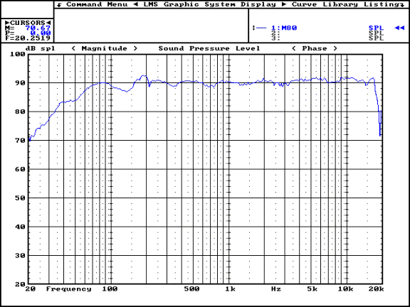

As you can see from the above 1 meter frequency response, the M80ti measured
very well and has a relatively flat anechoic response. The M80ti has an effective low frequency
response of about 40-45Hz which is somewhat masked in the measurement since anechoic chambers bass
response below 85Hz begin to taper off.

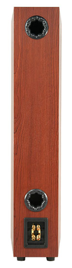

A peek around the back of the Axiom M80ti revealed that these speakers can be bi-amped, due to the incorporation of dual 5-way binding posts. These speakers are also bi-wireable, however, in my opinion this method of termination will yield no appreciable gain in performance. Unless you have a very long run of speaker wire and you want to double up the gauge of wire to compensate for the long distance, there is no audible benefit. The remaining two ports are located on the top and bottom of the enclosure as shown in the photo.
On the bottom of the enclosure you will find threaded inserts for the installation of either spiked or rubber feet. High quality parts are supplied with the speaker along with a wrench to install them.
A look inside the Axiom M80ti revealed that this speaker is built to a very high standard not usually found in speakers at this price. The photo below shows the Axiom M80ti lying on its side with the woofer, midrange, and tweeter removed. The enclosure is constructed using 3/4" MDF.
The first thing I noted inside the M80ti's enclosure was the very robust shelf bracing, one located just below the mid subwoofer and one located just below the bottom tweeter. These are used to control cabinet resonance. The speaker enclosures were also packed with polyfill.
The Axiom M80ti speakers are built with separate chambers to house the dual midranges. This construction technique is most often found on very expensive loudspeakers.
The Vortex vent ports used on the Axiom M80ti are designed to reduce port noise. Look closely at the photo and you can see the attached vent sock, this helps reduce noise even more and prevents the polyfill from blocking the port.
The fit and finish on the M80ti was superb. The speaker is elegant and takes up very little space due to its relatively small footprint of 9.25 x 17 inches (and 40" tall). The grills attach to the front baffle solidly, but again I would have liked to have seen a sturdier grill. That gripe aside, I must say that I was blown away by the attention to detail and the excellent build quality and overall engineering of the Axiom M80ti. The construction techniques used in this speaker are usually found in speakers at much higher price points.
Axiom Epic 80-600 QS8 and EP600
The Axiom QS8
surround speaker is yet another unique design. It incorporates dual tweeters mounted on a trapezoid
front baffle. The tweeters are wired in phase. The QS8 also has dual midranges, one mounted on top and
one on the bottom that are wired in phase. This unique driver configuration produces two effects: it
makes the speaker have a very wide dispersion area and it creates a very diffuse
soundstage.

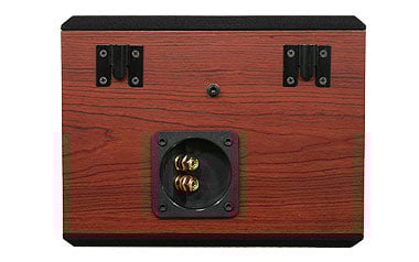

Looking around the back of the QS8 you will find 5-way gold plated binding posts, quick connect slide brackets, and a threaded insert for the optional swivel mount.

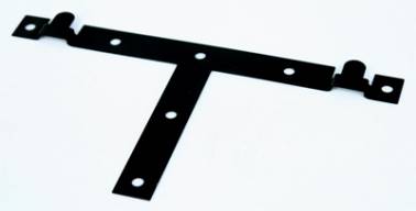

The QS8 allows for several different mounting configurations. Wall mounting can be accomplished using the supplied T bracket.
If you cannot flush mount the QS8 with the T bracket you can use the optional swivel mount.
The QS8 is very installation flexible. If you don't have a wall to mount them,
installation can be accomplished using the optional floor stands. The floor stands are black powder
coated, measure 38 x 10.5 x11 inches, and have an integrated cable management system.
Removing the top midrange revealed the inner workings of the QS8. The enclosure is a sealed-design cabinet constructed with 3/4 inch MDF. The photo shows the bottom midrange, dual tweeters, and in the upper left hand corner you can see part of the crossover. The enclosure was filled to capacity with polyfill.
Driver components used in the QS8 are the same type as used in the VP-150 and M80ti to ensure similar sonic characteristics.

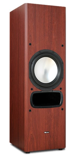

Monster Sub: EP600 Subsonic Subwoofer
And then there is this
to say: the Axiom EP-600 differentiates itself from the norm. This is an understatement. This subwoofer
walks among the giants, weighing in at 100 lbs and standing 46 inches tall. It truly is intimidating.
The 12-inch aluminum woofer is mounted in the center of the front baffle: below that you will find the
vortex port and the small rectangular Axiom badge.

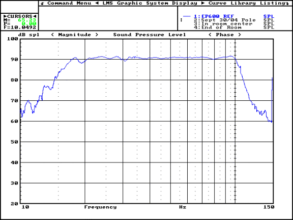

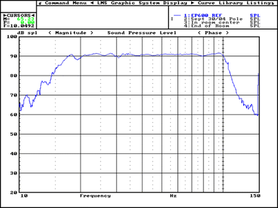

What more do we need to say - one look at the frequency response of the EP-600 and you can see that this is a very capable subwoofer. Look at how flat the response is between 20Hz and 100Hz. Also note the low-end extension to about 15Hz.

Axiom really has done their homework with the EP-600 subwoofer. It is very musical and is able to reproduce low frequencies at very high SPL levels. One of the EP-600 subwoofers would have easily been enough to fill my room when calibrated to reference level. Two was just icing on the cake.
The gain knob on the plate amplifier was barely off the zero mark. Two of the EP-600s in my room was like having the power of Mother Nature right at my fingertips. My advice if you do use two of the EP-600 subwoofers: bolt your house down to its foundation because, Mister, you are going for a ride!
Axiom Epic 80-600 Conclusion
The Axiom speaker systems I reviewed were absolutely unbelievable. The speaker's good build quality, high performance, and excellent customer support and service offered by Axiom make these an easy recommendation. These speakers are without a doubt among the finest speakers built in Canada at this price. They set a new benchmark for performance at this price and about the only thing left to say is "WOW!"
Axiom Audio M80ti Speakers
The Axiom M80ti speakers were the stars of the show. Their effortless dynamic capability, almost liquid midrange, tight and deep bass, and their uncanny ability to disappear, had me shaking my head in disbelief. Was I really listening to a speaker of such small stature and price?
EP-600 Subwoofer
The Axiom EP-600 subwoofer is a monster. It is very musical, can play lower than we can hear, and when called upon can wreck the house with gut-wrenching high SPL. Let's not forget the gorgeous plate amplifier; it is a true audiophile subwoofer with impressive slam. The Axiom EP-600 does require some experimentation for placement.
It is a very large subwoofer, I would have liked to have seen the use of more internal bracing, and a nicer grill would have been appreciated; however, the value of this subwoofer is in its performance. In that category, it is truly an awesome subwoofer.
VP-150 Center Channel
The VP-150 center channel sounded very natural: male and female voices were unrestrained and blended perfectly with the rest of the speakers in the system. The minor gripe I have is the ability of the VP-150 center speaker to keep up with the M80ti tower speakers. Off axis performance was a bit recessed sounding in the vocals, so you will want to avoid placing seats too far to the left/right of the center position. In addition, their effective crossover point of 80Hz made it a little difficult to select the best crossover setting for the system. The grill cover was a little on the flimsy side, but considering the price of the VP-150, I can certainly cut it some slack. I recommend that two of the VP-150's be used with the M80tis in large rooms that intend to use front projection systems or very large displays.
I was shocked at the level of performance that I was able to obtain with the QS-8 speakers. These little speakers sound a lot bigger than they are. Using them as the surrounds placed on the sidewalls, they were impressive. Their sound was big and open. They are equally impressive when used as an EX speaker and they blend perfectly with the rest of the system. The QS-8 can be mounted in just about every conceivable configuration. Because of their small size, they are very unobtrusive when installed.
