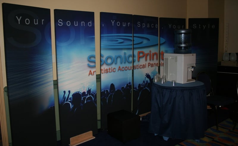

Auralex Acoustics showed off their SonicPrint panels at the Audioholics State of the CE Union event. They treated the Pioneer/Dolby and EMP/Yamaha rooms with upwards of 20 panels each, giving those rooms an advantage over the untreated ones. We've seen the SonicPrint panels at the most recent CEDIA tradeshow, but here we had an opportunity to really examine them up close and personal.

The Auralex SonicPrint panels take a lot of the air out of the "I don't want ugly panels on my wall" argument. Essentially, you can print whatever picture you like on your panel! I've seen these panels before but it has always been on the floor of a tradeshow under harsh florescent lights. At the SOTU event, I was able to see what they would look like in a real room. In a word - amazing. On the show floor with your nose up to them you can see the texture of the panel fabric. Sure, it sort of gives the impression of a brush stroke, but not really. Once we got them in a room, even with the lights on, they looked like prints. They had sharp lines and crisp images with stunning resolution. Most of the time I was sitting half way across the room from panels that were eight feet high by two feet wide. This is how they would be placed in a real room though most likely not as large. The panels were about 2" thick and provided a significant reduction in reflections. Consequently, the EMP and Pioneer rooms sounded much better than some of the other demo rooms.
