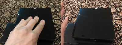

RSL CG3 models have a fingerprint-resistant finish that works
The RSL CG3 and CG23 have a fingerprint-resistant finish. I tested it and it works as advertised.

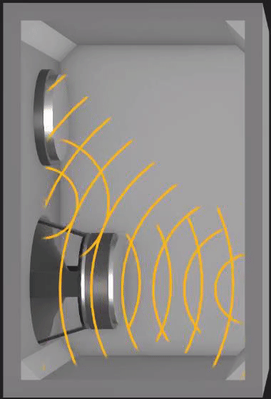

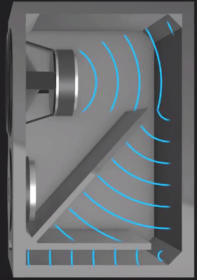

Standard Speaker without Compression Guide RSL's patented compression guide technology
RSL's Compression Guide technology is patented.
A standard speaker is pictured left and RSL's compression port, which divides the speaker's cabinet into areas of lower and higher pressure is pictured right.
The core technology at the heart of the CG3s and all RSL speakers is their patented Compression Guide. This is visibly seen as a slim, rectangular port on face of the speaker.  The CG3 has a single port and CG23 has dual ports.  There is no rear port. Joe told me that front mounting the port always a priority so customers could wall mount the speakers and have greater placement flexibility in general.
In case you’re not familiar with RSL’s Compression Guide technology, Howard previously described that his patented Compression Guide design,
“works by essentially dividing the cabinet up into areas of lower and higher pressure (compression). As the sound wave travels though these different pressure zones, the effect of resonance is reduced.  This reduction results in tighter bass and eliminates the ‘boxiness’ that even high-end box speakers tend to suffer from. We also feel that eliminating the ‘boxiness' increases midrange clarity.”
In some ways, it sounds similar to Atlantic Technology’s H-PAS, where you have internal dividing partitions that compress and accelerate the woofer’s backwave which then exit out a front-mounted rectangular vent. While Atlantic Technology announced H-PAS around 2009, RSL’s Compression Guide was patented decades earlier in the 1980s.

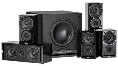

RSL CG3 5.1 channel speaker system
RSL's CG3, CG23, and Subwoofer 10S 5.1 home theater system.
Lightning has struck twice and in this case it’s a darn good thing. I thoroughly enjoyed my time with the RSL  CG3 system and feel it is worthy of high praise.
