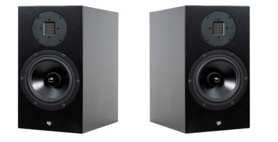

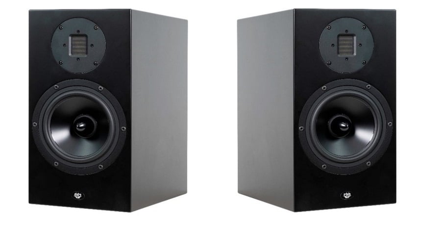

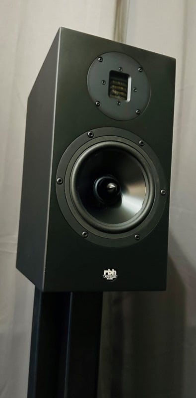

The 61/AX
speakers are of average size, they are finished in a somewhat industrial
looking matte black finish that screams “all business”. They will also be
offered in a matte white finish as well (more exotic finishes available soon.) The
speakers I received have black anodized woofers, although they are also available
in the traditional silver aluminum finish RBH is known for. After unboxing I
could not help but notice the build quality. The cabinets are built in-house in
Utah, out of HDF, and are as solid as any speakers I have ever encountered. I
would say after the traditional rapping knock on the top, they are brick like.
They use a 1.4” AMT tweeter along with RBH’s signature 6.5” aluminum woofer. Both drivers were designed in-house by RBH and these are used in their top-of-the-line UNRIVALED signature series speakers.
The AMT has more surface area than a traditional dome type tweeter and offers a wide horizontal dispersion with a controlled vertical dispersion. In recent years we have seen many speaker manufacturers move the AMT tweeters because they offer extended frequency range, fast response time, and improved micro dynamics. I have experienced that many well engineered AMTs have more output than traditional dome tweeters without strain. The AMT tweeter has improved greatly over the last decade, and I have personally come to love the sound that they produce.
The aluminum 6.5” woofer features a composite metal phase plug that reduces on axis beaming at higher frequencies and can help reduce heat-related problems like thermal compression in the voice coil. This is an excellent and proven driver.
The heart of this active system is a state-of-the-art Marani DSP that features FIR filtering optimization and a fully active crossover network. The system is bi-amplified with a very robust amplifier (built for the demands of commercial use) that uses the heralded Pascal class D amplification modules. These modules are known for both their high-power and audiophile sound quality in-fact, these modules are used in many modern ultra high-end amplifiers.
The power is rated at 150 watts for the tweeter and 250 watts for the woofer. This is a lot of power for a small speaker and Rich explained to me that he wanted to drive these speakers to their full capability by using a very robust and powerful amplifier to achieve the type of dynamics his design required.
The secret sauce here is the DSP, with 96/24 DAC’s that feature FIR filtering. FIR filtering allows for a little digital magic as it handles the crossover duty, time alignment and improves linear phase characteristics (as you will see in the measurements section of this review). This also includes an optimization filter that linearizes frequency response. The 61/AX has built in limiters for speaker protection, so don’t be afraid to let them sing with confidence.
There is a lot of technology packed into these monitors, and tech of this level is not usually found in speakers in this price range. Rich explained to me that each component of these speakers, from the ground up, were matched for maximum sound quality and dynamic performance.

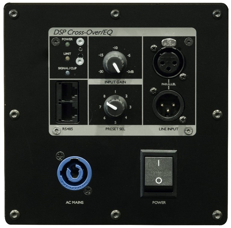

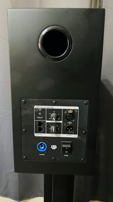

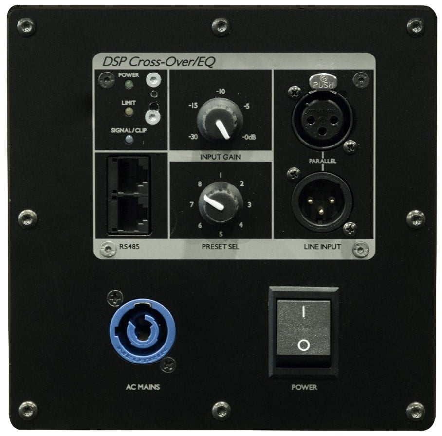

A simple plate on the back of the speaker has power, XLR input/output, volume control, and an 8-position switch to select different frequency response curves in the DSP (see measurements section).
The 8 factory DSP’s offer a wide range of frequency response profiles, two of the settings are optimized for “Nearfield” use when the speakers will be used as studio monitors. I found these DSPs to work as advertised in my office/studio where I sit about 30” from the speakers. The other six allow for optimization in a variety of larger room placements. RBH can even build custom DSPs (for an upcharge) for any application one may need. Again, these are very robust speakers built for day-in /day-out use in a studio application.

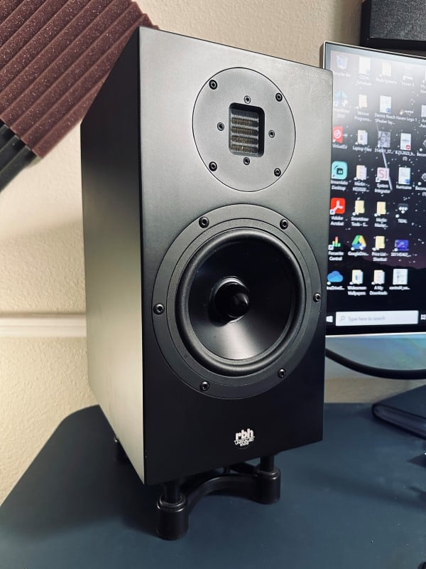

For the last several months, I have had the 61/AX setup in my office/studio. They live on Isoacoustics monitor stands on top of my desk that place the tweeters about an inch below ear height, and 30” from my listening position (I cannot recommend the IsoAcoustics products enough.) The speakers are slightly toed in about 5-degrees because they are so close to my listening position. They are connected by balanced ¼” to XLR cables running from my Focusrite 4i4 USB audio interface, my PC as the source.

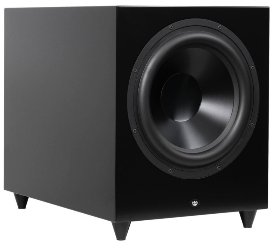

I have used these as monitors for some time by themselves. Recently, RBH Sound sent me one of their excellent new 12P-SF/R powered subwoofers to review with the 61/AXs. This subwoofer uses their signature reference 12” woofer with an 800-watt DSP driven amplifier. This subwoofer is a perfect match for the 61/AX speakers since it has dual XLR input/output for flexibility. The DSP in this subwoofer allowed me to “blend” the subwoofer perfectly with the monitors taking advantage of the subs DSP.

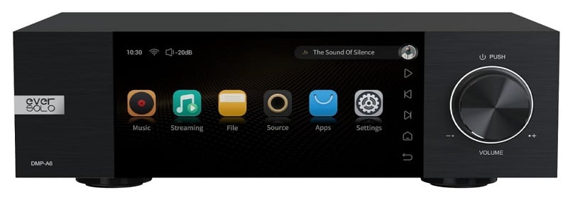

In this much larger room, I hooked the 61/AX to the excellent Eversolo DMP-A6 DAC that RBH had supplied to me for this review. RBH is planning on selling the 61/AX, Eversolo DMP-6 streamer and 12P-SF/R subwoofer as a complete package soon. The DAC was connected via XLR to the sub, then looped back into the monitors.

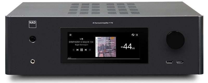

I wanted to try the system in a 3rd room, so I connected the monitors to a NAD t778 main L/R pre-out, since the NAD t778 does not have balanced outputs, I used the provided RCA-XLR adaptors and crossed them over at 80Hz. They were used as main L/R replacing the Focal Kanta No2 for this review.

I connected the RBH subwoofer and WOW! The music literally came alive. It was so incredibly clean and clear. Getting caught up in the moment, I kept turning the volume up and up, and the more I did, the more my 12’ x 13’ office sounded like a nightclub but without any shrillness. As I turned these up to levels peaking more than 110db (something I only do in very short bursts,) I observed the absolute lack of dynamic compression. As the volume increased the speaker did not change tonal character at all. Literally, it felt like I could keep going up to 11. The dynamics of these speakers are insane, especially when paired with the RBH 12P-SR/R subwoofer. Another thing I noticed, is that as loud as I was playing these, there was no harshness whatsoever…I had to catch myself and turn these down before I damaged my hearing. The nearest comparison to this is driving a supercar on a closed racetrack, something I have had the pleasure of doing. You can be driving well over 100mph in a Porsche 911 turbo on a straight away and not really notice the speed- that’s what these speakers are like!

Next, I moved the 61/AX into my master bedroom system. This is a medium sized room at 16’L x 13” W x10’ H. I replaced the main L/R Focal Kanta No2 with the RBH monitors on steel stands, hooked up from the L/R Pre-outs on my NAD T778 receiver. Since the NAD does not have balanced Pre-outs, I used the RCA-XLR adaptors that RBH conveniently supplies with the 61/AX. After connecting the monitors, I did some calibration, level matching the RBH with the Focal center channel. This room has a pair of excellent SVS SB-3000 subwoofers. These eventually turned out to be a good match with the RBHs.

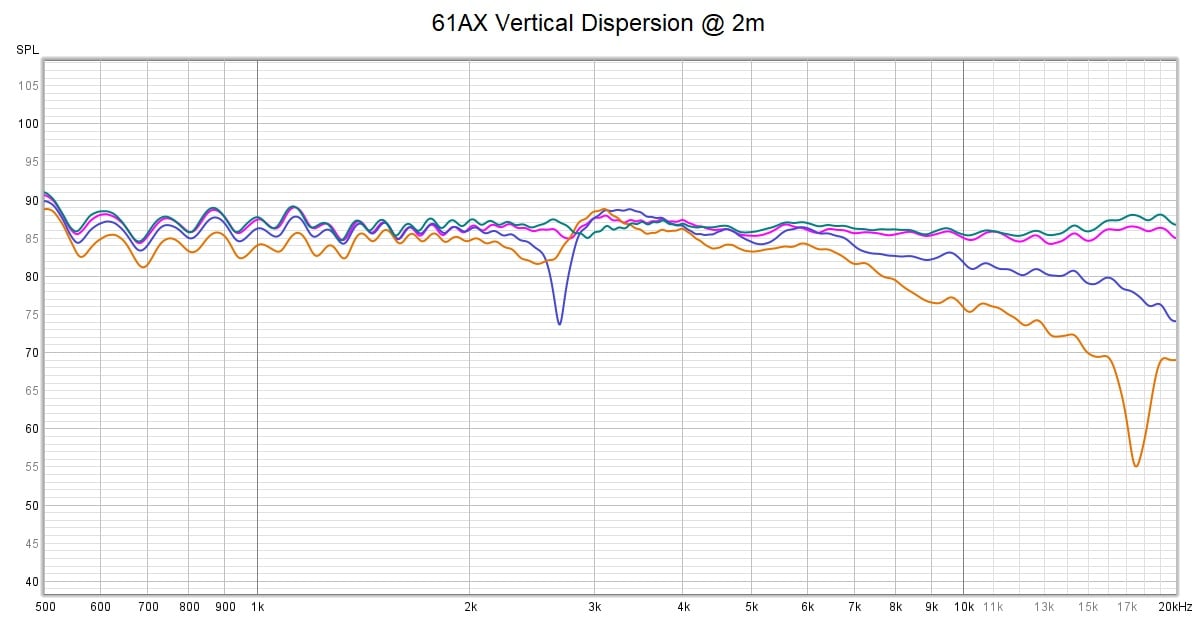

Measurements of the RBH 61/AX

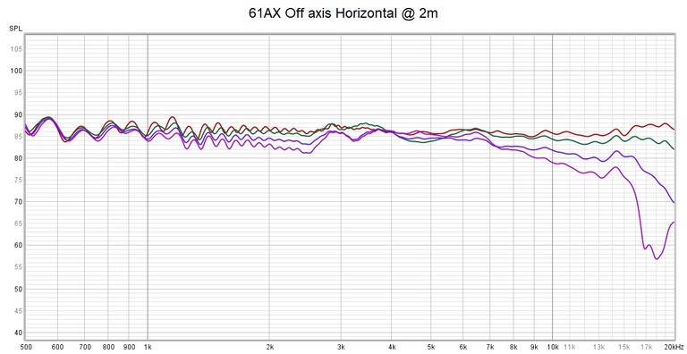

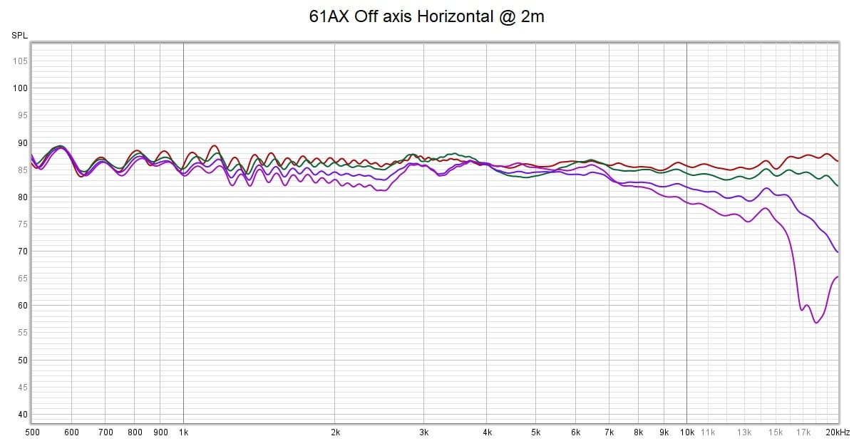

This graph shows the On Axis (Brown) and Horizontal Off Axis Frequency Response from 500 to 20kHz; 15 degrees (Green)), 30 degrees (Purple), 45 degrees (Magenta)

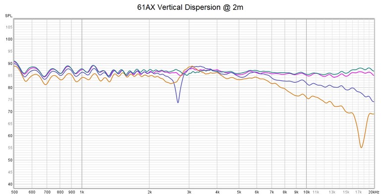

This graph shows the on axis (Green) and vertical off axis frequency response above the tweeter axis of the speaker: 15 degrees (Magenta), 30 degrees (Blue), 45 degrees (Orange).

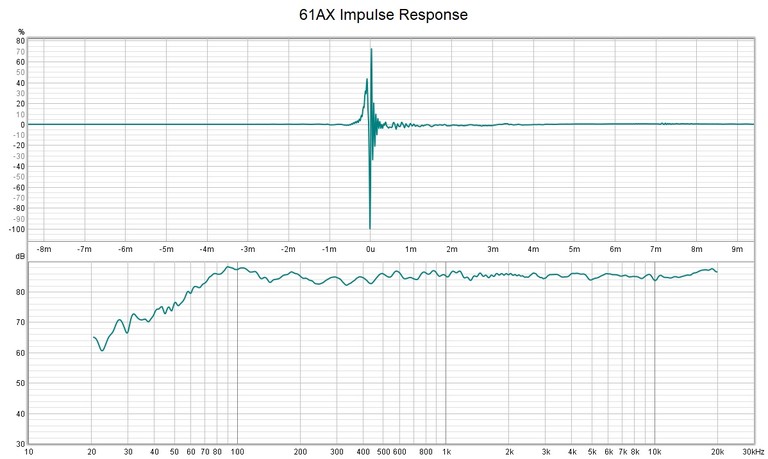

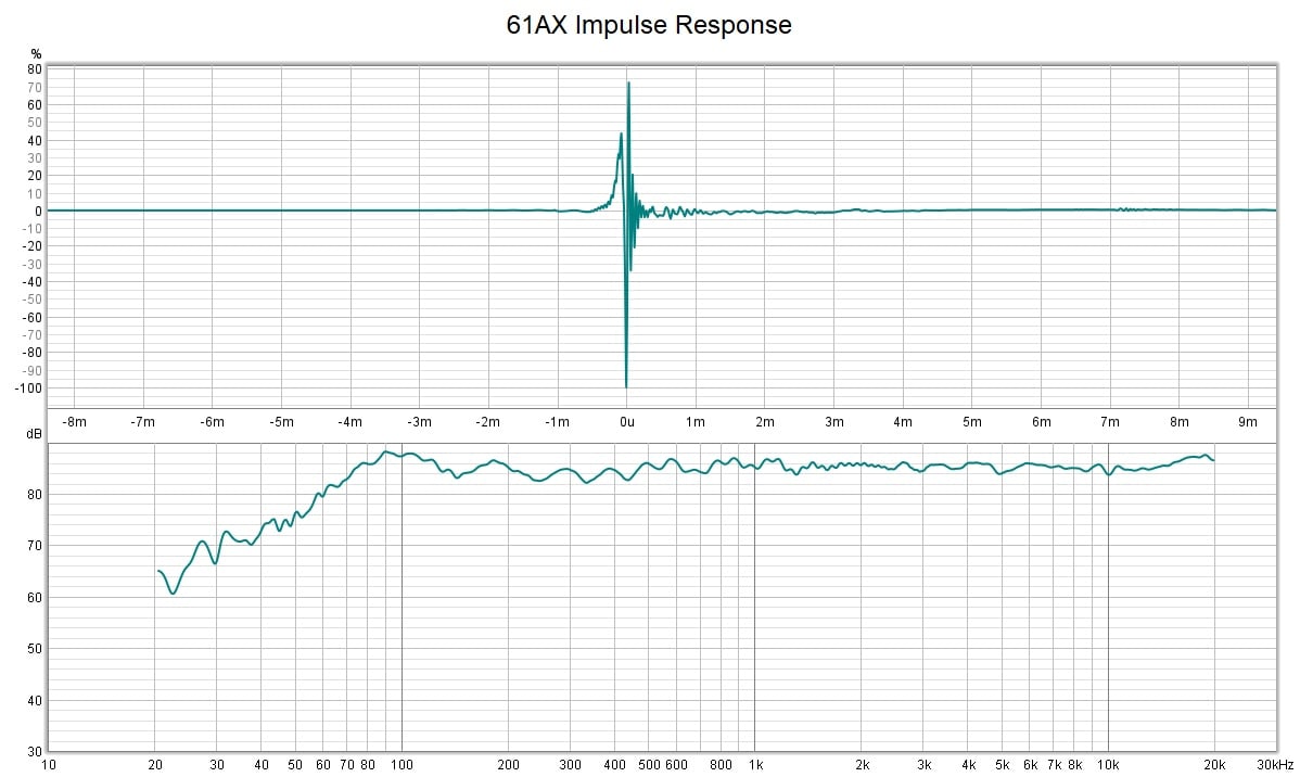

These measurements show the on Axis Frequency Response of the speaker (setting 1) from 20Hz to 20kHz as well as the speakers impulse response which is very clean.

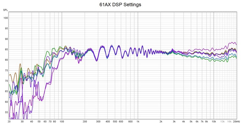

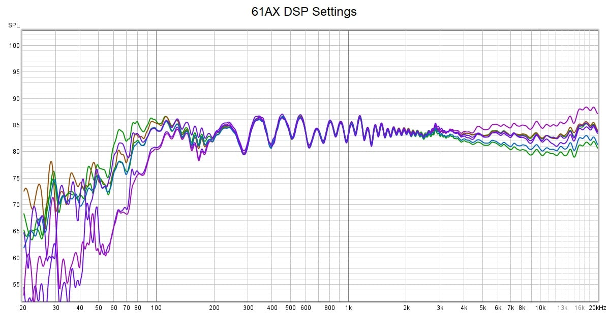

This group of measurements shows the on axis frequency response of the 61AX taken at 2m with each of the 7 available DSP settings. The following is a description of each of the selectable DSP settings:
Setting 1: Full Range (Provides Maximum Bass Extension)
Setting 2: Full Range (Tweeter +)
Setting 3: Flat Response (No EQ)
Setting 4: 80Hz HP filter (for integrating with subwoofer)
Setting 5: 80Hz HP filter (Tweeter +)
Setting 6: Near Field (Tweeter-, for Near-field/Desktop use)
Setting 7: Near Field (Tweeter- Bass+, for Near-field/Desktop use)

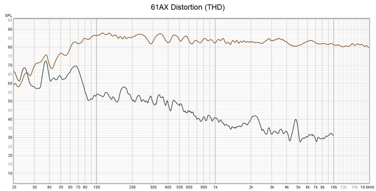

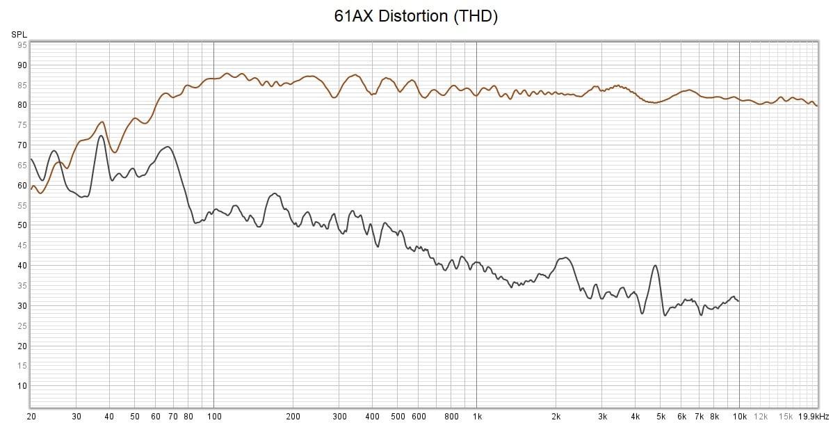

Measurement showing low Harmonic distortion levels (black) of 61-AX taken at 2m on axis

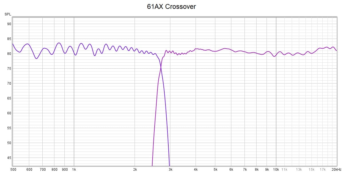

This measurement shows the separate frequency response of the woofer and tweeter as well as the extremely high order FIR Filters (108dB/Octave) of the crossover made possible using a powerful DSP.
This level of filtering cannot be achieved using passive networks and one of the biggest advantages offered by active speaker designs.
