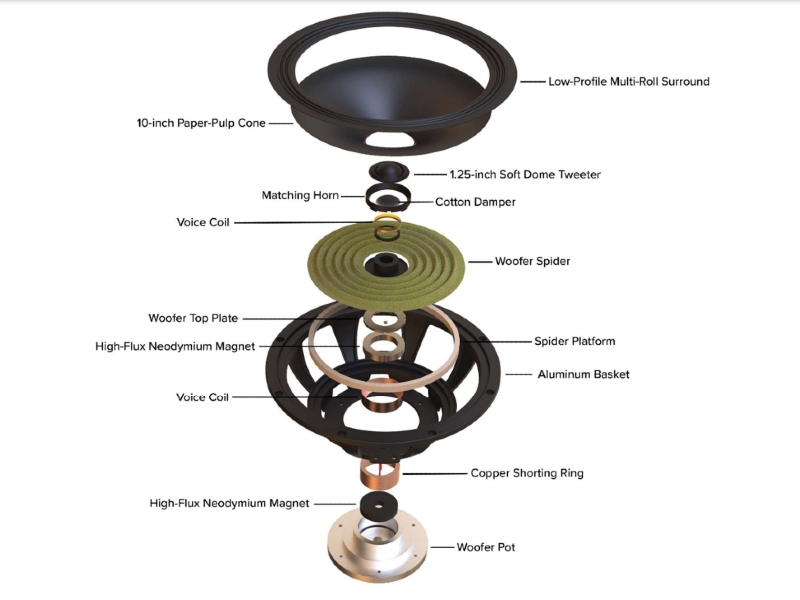

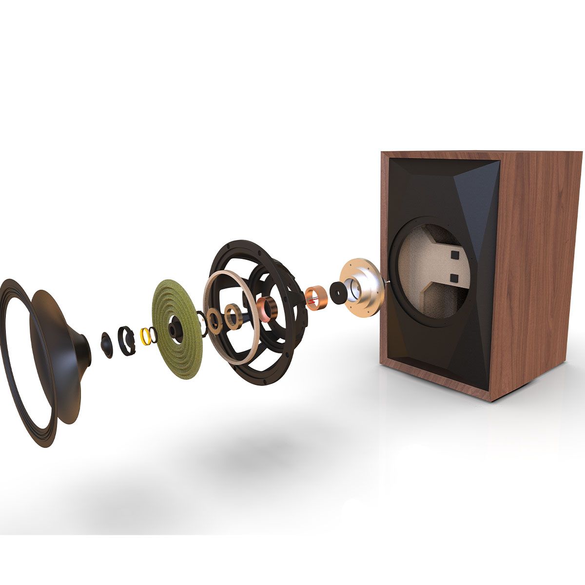

The 10-inch Concentric Driver
The all-new 10-inch concentric driver used in the SourcePoint 10 is said to be the result of an 18-month R&D effort, and MoFi promises both “stunning clarity and deep bass impact” from this custom design. The 10-inch paper-pulp cone reportedly produces large and dynamic sound with minimal excursion, thanks to a surface area that’s almost 2.5 times greater than that of a typical 6.5-inch bass driver. As Jones described above, this reduction in movement allows the woofer to serve as a more consistent waveguide around the tweeter, resulting in “the most coherent sound possible, with the least amount of distortion, and without sacrificing bass,” according to MoFi. The centrally-mounted tweeter uses a 1.25-inch soft dome with a wide-roll surround and large-diameter voice coil. The tweeter can play lower than most, crossing over at 1.6kHz, thanks to great power handling and minimal thermal compression. At the upper end, the tweeter delivers smooth response beyond 30kHz, according to MoFi. The heart of this concentric driver array is a new neodymium magnet system called Twin-Drive. As Jones explains, simply optimizing the frequency response of the woofer and tweeter won’t get you all the way to sonic nirvana. You must also minimize distortion in the motor structure of the drive unit, or else the motor distortion will generate new frequencies outside of the original signal. In an effort to reduce these distortions, the Twin-Drive system was created. This innovative design “creates a fully symmetrical magnetic field, eliminating flux modulation for extremely low intermodulation distortion (IMD),” according to MoFi. The company claims that this technical achievement is an important part of the SourcePoint 10’s pure and accurate sound.
Abiding by the requirement that the tweeter motor structure fit within the voice-coil diameter of the woofer, typical concentric driver designs feature tweeters with relatively low sensitivity. SourcePoint 10 uses a compound motor structure named Twin-Drive to solve this issue. The magnets of the woofer and tweeter motor deliberately couple together so that each aids the other in driving flux across both the woofer and tweeter gaps. The result: Greater flux density than either motor can achieve alone.

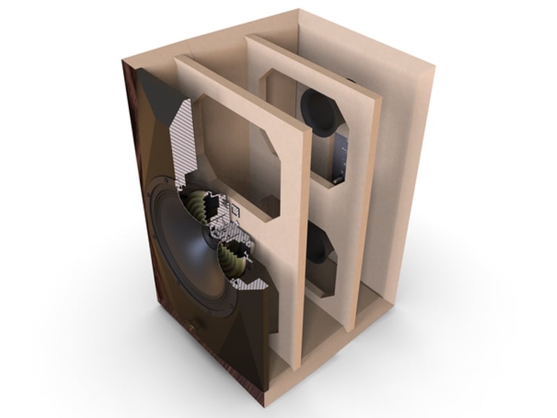

The Cabinet
One of Jones’s claims to fame is that he doesn’t just design drivers; he also designs the crossovers and the cabinets. A 10-inch woofer requires a fairly large cabinet, and it had better be a heavy-duty affair that won’t add resonance. The SourcePoint 10 features 1-inch thick MDF panels on the top, bottom, and sides, with extensive internal bracing. The front baffle is made from a 2-inch thick MDF panel. (The front panel is painted in a smooth satin black, while the other surfaces are treated to real wood veneer.) Measuring 22.5 inches tall by 14.5 inches wide by 16 inches deep, each speaker weighs a substantial 46 pounds. According to Jones, the cabinet was designed to optimize both bass extension and overall system efficiency.
A large woofer requires a large cabinet. SourcePoint 10 has an internal cabinet volume of 50 liters, or almost two cubic feet. Because of the relationship between box size, low-frequency extension, and efficiency, this volume can be traded to gain both bass extension and efficiency. SourcePoint 10 has a sensitivity of 91dB, low-frequency point of 42Hz, and true 8-ohm impedance with a minimum of 6.4 ohms at 150Hz. This makes SourcePoint 10 very easy to drive and well-suited to a wide range of amplification.

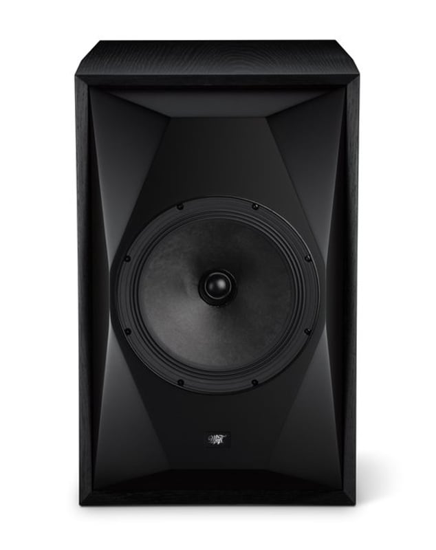

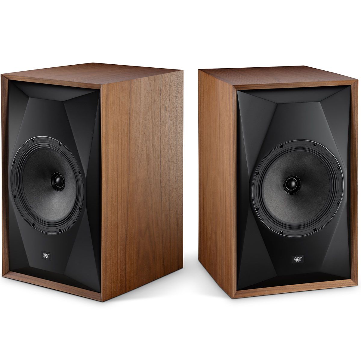

The most visually interesting element of the SoucePoint 10’s design is its multi-faceted front baffle. Some speakers, such as the aforementioned TADs and KEF LS50s, use curved front baffles to minimize diffraction. But curved lines don’t scream “mid-century modern,” so Jones instead designed a series of facets into the 2-inch thick front baffle.
The shape of the front baffle also matters. When mounting any driver in a cabinet, the cabinet edges will refract and reflect the sound that travels across the baffle to the cabinet edge. This radiation interferes with the direct radiation from the driver and causes high-frequency response irregularities that vary with listener location. This can be particularly troublesome with a concentric driver configuration. In SourcePoint 10, such diffraction is greatly reduced by sculpting the baffle to produce multiple facets. The varying distance from the driver to the edge smooths out the diffraction ripples; the sloping surfaces further minimize them. As the listener, you benefit by hearing only the smooth, even response of the driver — not the sound of the cabinet.”
— Andrew Jones

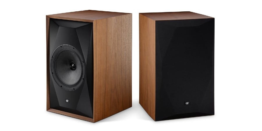

Rounding
out the mid-century vibe is your choice of Satin Walnut or Satin Black Ash real
wood veneer. These furniture-grade veneers are even book matched for
mirror-imaged grain patterns on each pair of speakers. With the grilles off,
the veneer peeks around the corner from the sides in the form of a picture
frame that goes around the edge of the front baffle. Because the picture frame
is set back from the drivers (thanks to that extra-thick baffle), it can add
some style without introducing problematic reflections. MoFi suggests listening
with the grilles off, but Jones says the grilles have been designed to have
minimal effect on the sound of the speakers. The magnetically-attached grilles
do retain the profile of the multi-faceted baffle, but the look is softened
somewhat by the fabric. Dedicated stands will be available as an optional extra
