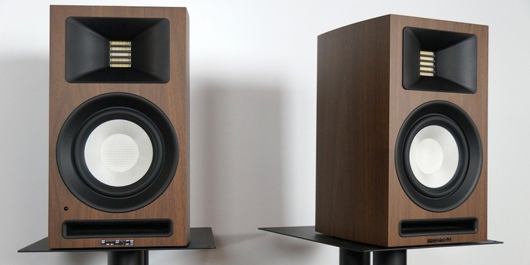

The Fluance Ri71 promises high-fidelity with the easy convenience of HDMI ARC plug-and-play, as well as Bluetooth. Unlike a soundbar, it has a driver layout much more optimized for higher quality sound instead of a bunch of tiny drivers being squeezed in a horizontal array. It can also produce a real stereo soundstage and imaging, which soundbars don’t really do. At the very affordable pricing of $400 shipped, it would seem to be a bargain, but does it deliver on the promise of high-fidelity? Let’s dig in to find out…

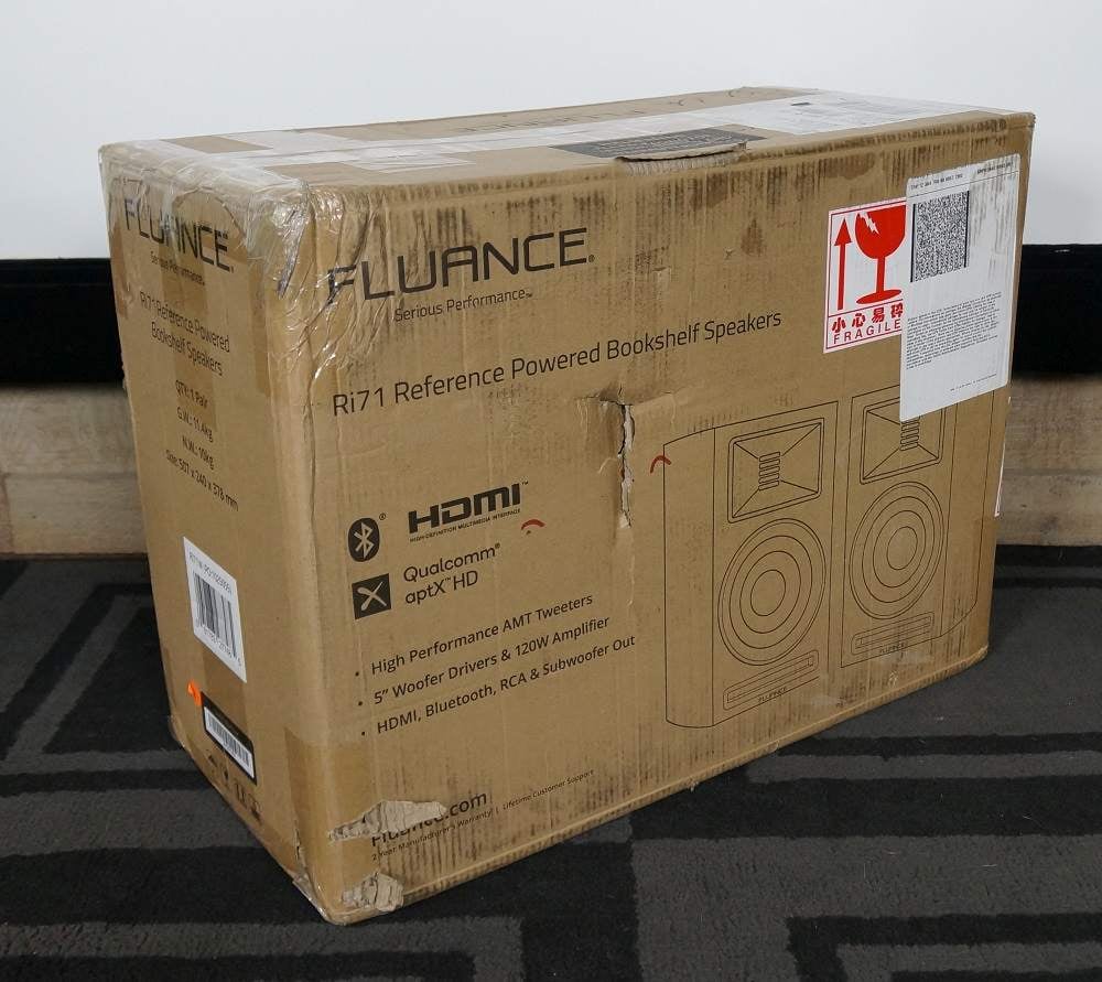

It is important that the packing be good on the Ri71s since they must be delivered, as Fluance is a manufacturer-direct company. The speakers arrived in a single box in heavy-duty cardboard. Inside, the packing material was styrofoam blocks sandwiching the top and bottom of the speaker pair with a foam divider. The speakers were wrapped in plastic bags to protect them against moisture. This isn’t the most durable packing I have seen, but at least the styrofoam was of a higher quality instead of the crumbly stuff that falls to pieces with slight impacts. Luckily, the speakers are not large or heavy, so this packing should suffice.

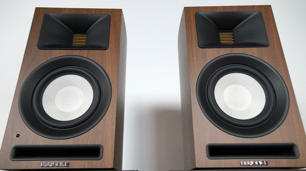

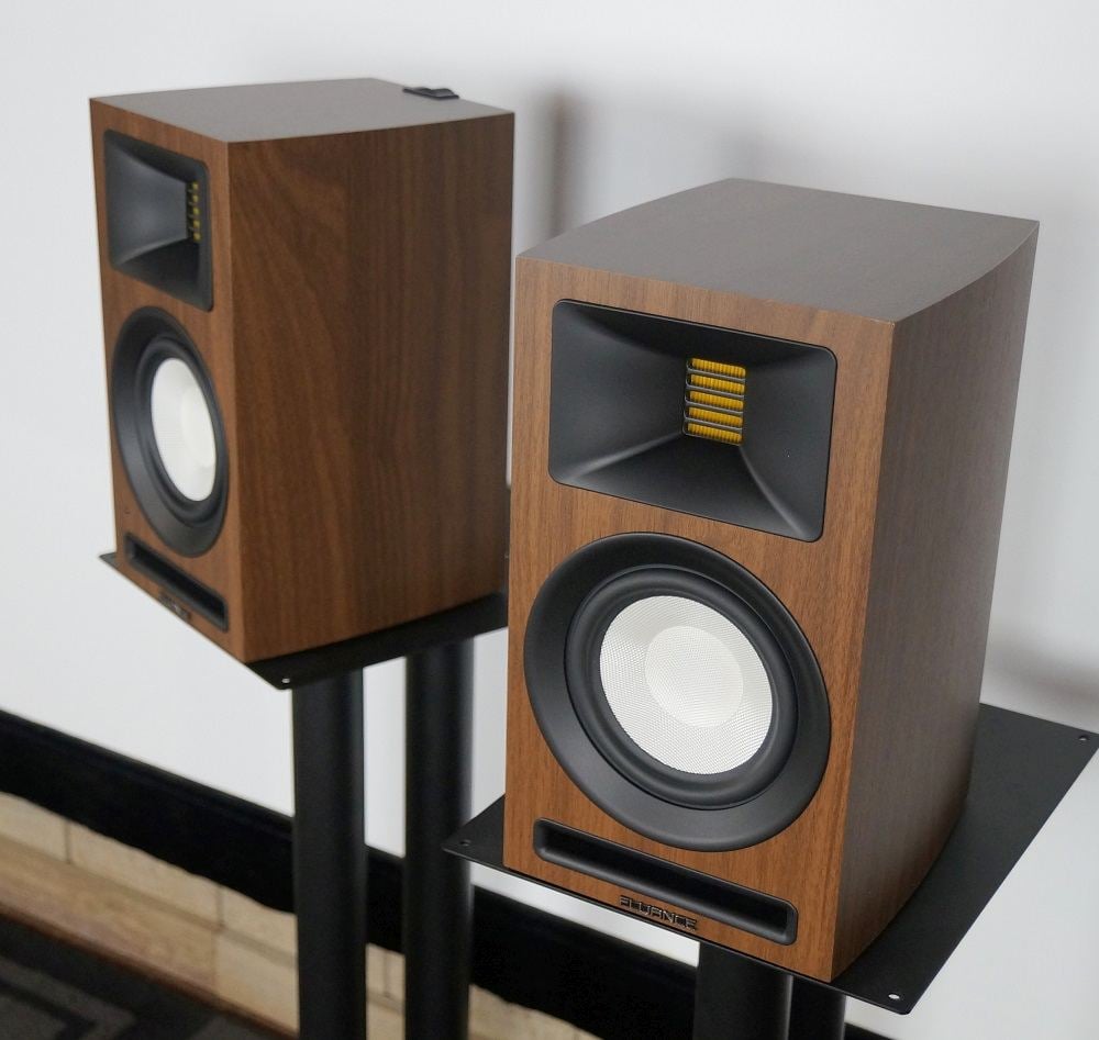

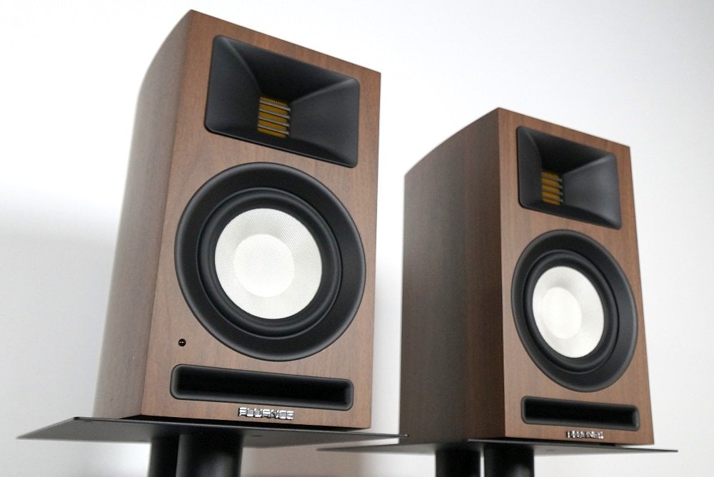

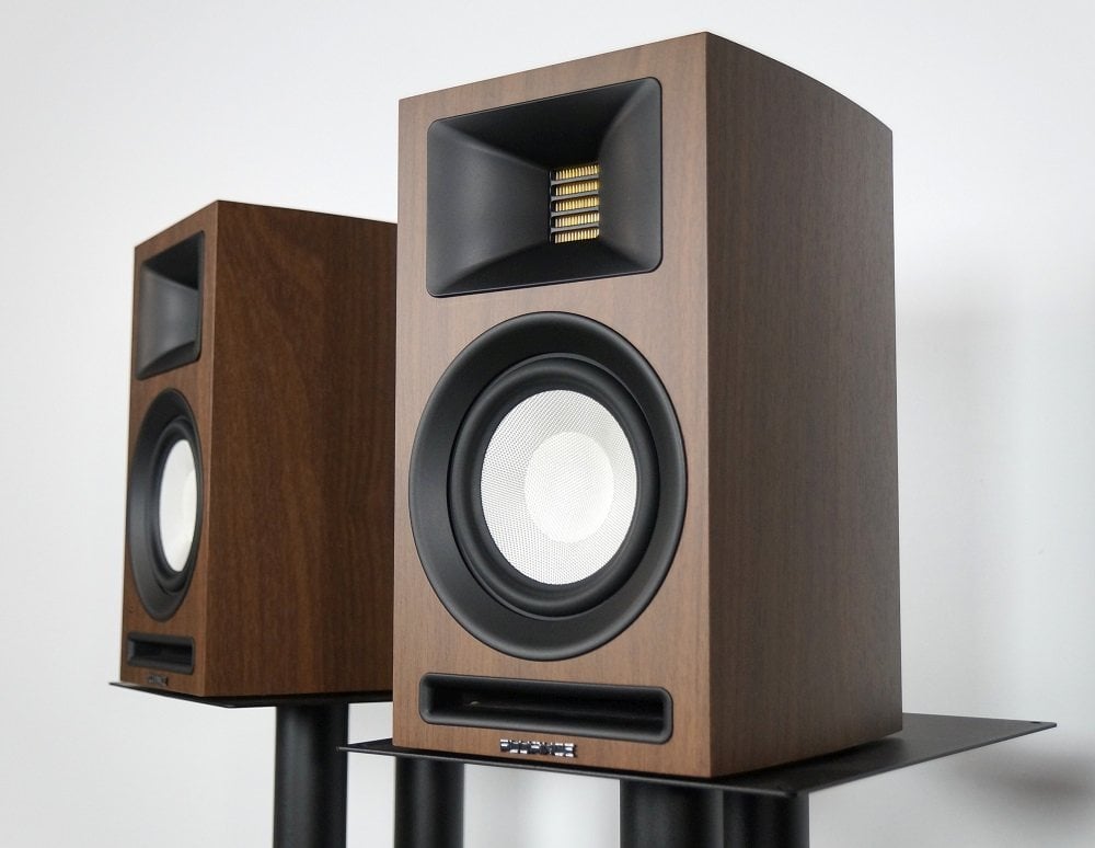

After unpacking the Ri71s, we see a pair of handsome and not-especially-large stand-mount speakers. They are not tiny desktop speakers, but they won’t eat up a large amount of shelf space. They can be had in a black ash, white ash, or walnut finish, and I received a pair in walnut. The finish is vinyl imitation, of course, but it is pretty well done and not blatantly fake. The drivers stand out a bit on these models, since the woofer cone is a fairly stark white and the tweeter is nested in a good-sized waveguide. Strangely, these speakers do not come with grilles to conceal or protect the drivers. The AMT tweeter looks like a gold trinket buried in a black waveguide. The woofer has a white fiber-glass weave centered in a black surround and frame. The Ri71s actually have curved side-panels, not something often seen in such low-cost speakers. One of the speakers has an LED status light mounted in the lower lip of the waveguide. Overall, I don’t think the Ri71s look bad, but I do think Fluance should have included grilles for those who want to de-emphasize their appearance. Some people want their speakers to be as visually subdued as possible, and the Ri71s don’t really do that.

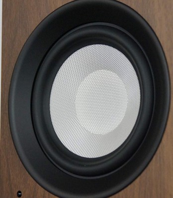

Ri71 tweeter   Ri71 woofer

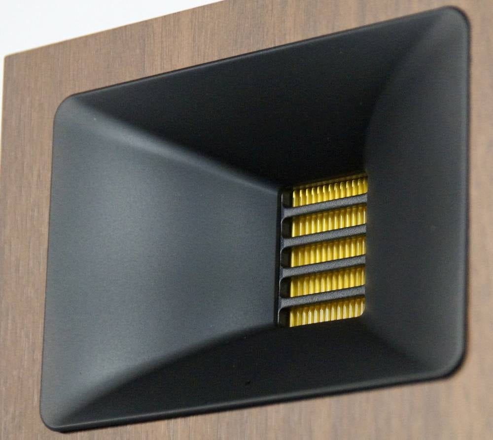

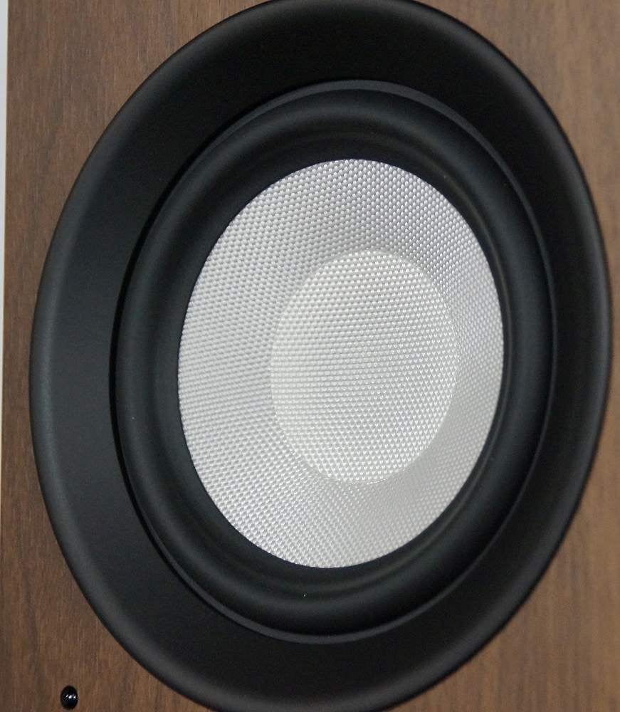

The tweeter is mounted in a waveguide. The waveguide should help control the dispersion of the sound to make it more uniform throughout its bandwidth. The waveguide should also help to give the tweeter better directivity matching with the mid-woofer. The mid-woofer uses a 5.25” glass-fiber composite cone. The spec sheet tells us that the Ri71s use a 2.7kHz crossover frequency with 2nd-order filters.

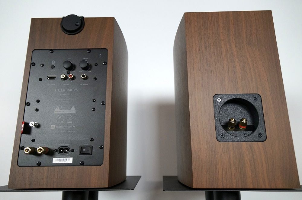

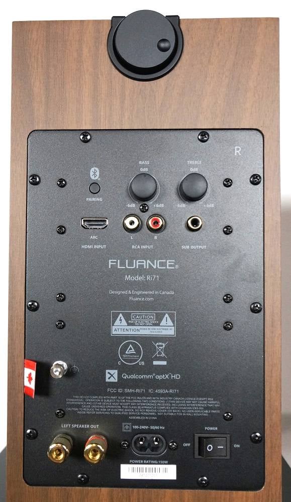

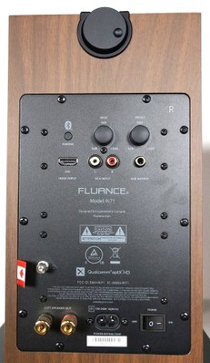

Ri71 amp panelEven though the Ri71s are powered speakers with DSP technology, they have still opted to use passive crossover circuits. I am guessing the reason is that they thought it would be simpler to do that than to pack in four amps, one for each driver. By using a passive crossover circuit, Fluance only needs two amps for the speaker pair. Taking a peek at the crossover circuit, it looks to have six elements, a couple more than what is needed for basic 2nd-order filters, possibly added to pad down the tweeter. That makes it easier for the DSP to smooth out the response on top of the speaker’s native electro-acoustic response. The DSP technology should make it easy for Fluance to attain any kind of target curve that they want in terms of frequency response.
The Ri71 uses two 60-watt RMS class-D amps to power the speakers. That should be plenty of power for loudspeakers of their specs. The spec sheet says THD is less than 0.3%, but it doesn’t say at what drive level. Connectivity for the Ri71s is good, with Bluetooth aptX HD and AAC codecs, left and right analog RCA inputs, and HDMI ARC. HDMI ARC makes the Ri71s a very easy plug-and-play alternative for soundbars. I do wish the Ri71s had optical S/PDIF and USB Audio inputs. That would have given them more flexibility as sound systems for desktop PC setups. The Ri71 has a subwoofer output that, if connected, automatically engages an 80Hz high-pass filter on the speakers. That is a nice touch of bass management for those who want to use subwoofers — a good idea since these modest-sized bookshelf speakers aren’t likely to be deep bass monsters on their own. For those who want bigger bass without needing to add a subwoofer, Fluance has a sister tower speaker called the Ri91 ($800/pair), with two 6.5” woofers.

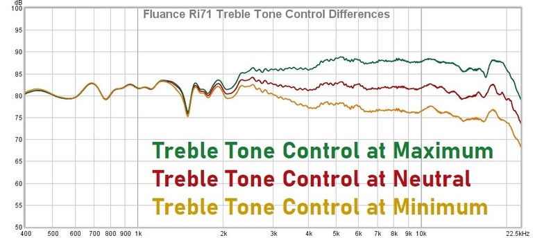

There are tone controls that raise or lower the treble or bass by 6dB. That’s a very nice feature that allows the Ri71s to be tuned to the taste of the user. The rear-mounted volume knob is an interesting design. It rises above the top of the speaker so it can easily be adjusted without needing to reach behind. Pushing it in also changes the input being used. It makes it easy to interact with the speaker while keeping a clean front baffle. Other speakers in this class have that control on the front of the speaker. The Ri71 comes with a remote-control unit that has some functions not available on the speaker itself. One remote-control-only function is the ability to swap channels so that the left and right channel signals can be reversed. The remote can also interact with Bluetooth playback by playing, pausing, reversing, and forwarding tracks. It can also adjust the LED status light brightness to full brightness, 25% brightness, or off.
The enclosure looks to be made from ½” MDF paneling. There are some small rubber pads affixed at the bottom to serve as feet. Many products in this category give you the feet separately and give the user the choice of attaching them. Curiously, the tweeter is set in its own sealed compartment within the enclosure. I wouldn’t have thought an AMT would need that since it’s already self-enclosed within its own unit. Possibly, it is just taking up space to provide a more optimal volumetric area for the mid-woofer, or maybe it is designed to stop any kind of interaction between the mid-woofer’s backwaves and the waveguide, since the waveguide isn’t the most overbuilt one around. At the least, it is giving the enclosure more bracing. There is also a cross brace behind the woofer to strengthen the side walls. A front-mounted slot port at the bottom of the cabinet helps with additional bracing, too. There is also some polyfill-type stuffing to help damp internal pressure waves.
Ri71 rear

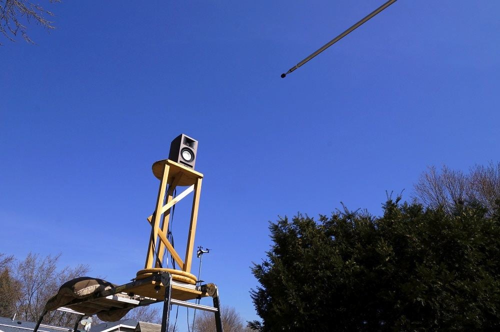

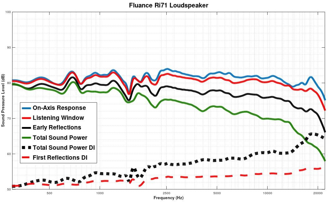

The Fluance Ri71 speakers were measured in free air at a height of 7.5 feet at a 1-meter distance from the microphone, and the measurements were gated at an 11-millisecond delay. In this time window, some resolution is lost below 250 Hz and accuracy is completely lost below 110 Hz. Measurements have been smoothed at a 1/24 octave resolution.
Ri71 Spin o Rama
The above graph shows the direct-axis frequency response and other curves that describe the speaker’s amplitude response in a number of ways. For more information about the meaning of these curves, please refer to our article Understanding Loudspeaker Measurements Part 1. Overall, the Ri71 has a fairly linear response, especially in the tweeter’s bandwidth. There are some imperfections, though; there is some raggedness from about 1.5kHz to 2.5kHz. Since that region is right under the spec’d crossover frequency, I would guess the raggedness stems from some trouble trying to get the tweeter to blend in perfectly with the woofer. The culprit might be the waveguide; it can’t be easy getting a perfect blend with a waveguide like that on an AMT tweeter. AMT tweeters can produce very complex sound fields; putting one into a relatively deep waveguide, and then using a relatively high crossover frequency, was going to be a challenge. The good news is that the raggedness is formed from narrow dips, so it will look a lot worse on a graph than it sounds. I didn’t notice any serious problems in that area in my listening, and I doubt anyone else would unless they were specifically listening for it with certain content. The only other notable attribute that I see is that the tweeter has an ever-so-slight downward tilt in upper frequencies. It’s probably not even enough to call this a “warm” speaker. Overall, it is more neutral than warm.

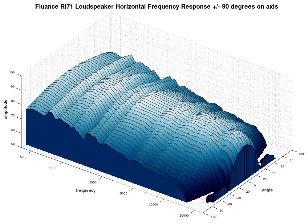

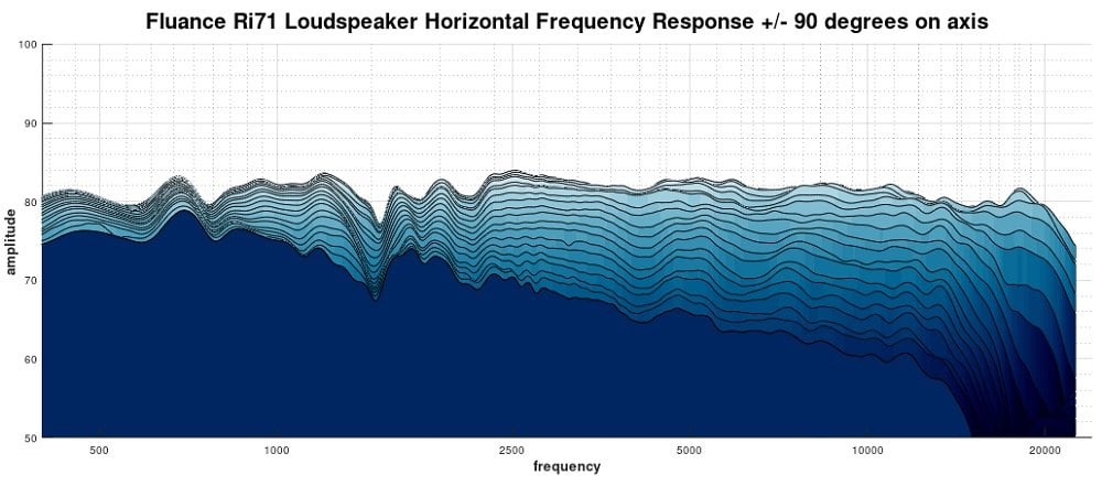

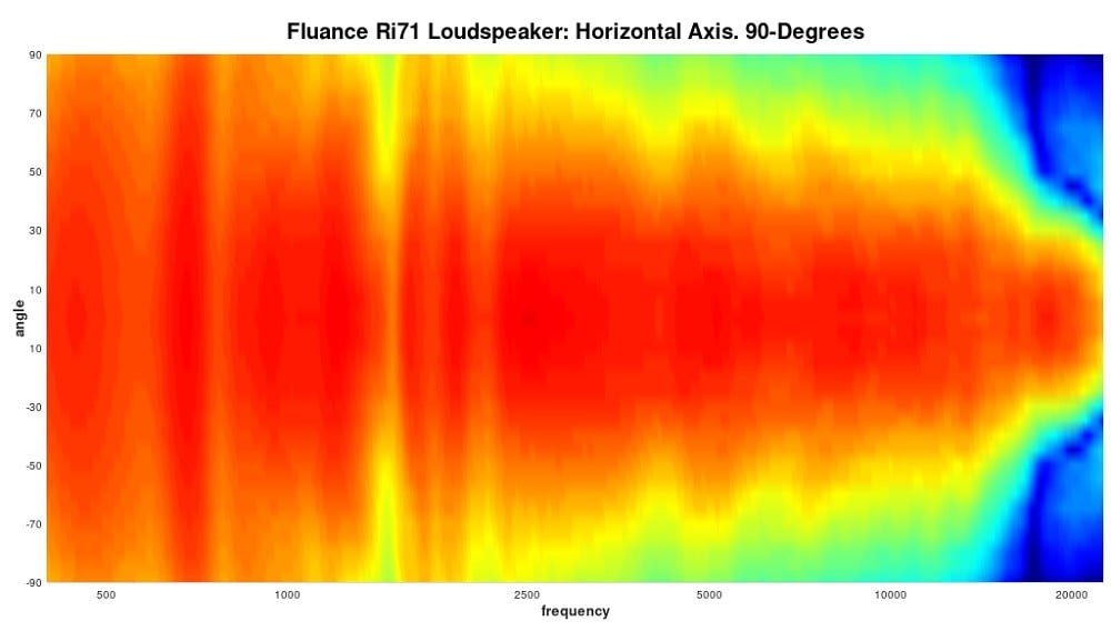

The above graphs depict the Ri71’s direct-axis and horizontal dispersion out to a 90-degree angle in five-degree increments. Information on how to interpret these graphs can be read in this article: Understanding Loudspeaker Review Measurements Part II.
In the above graphs, we again see how nicely linear the Ri71 speakers are, aside from the minor crags around 1.5kHz. One thing to note is how well the off-axis responses correspond to the on-axis response. That means this speaker will retain the same sound signature over a wide angle. It also makes the Ri71s a lot easier to handle for equalization, especially auto-EQ systems like Audyssey or Dirac. Having such a broad angle behave so similarly means that the acoustic reflections should greatly resemble the direct sound. That is good news for those trying to integrate speakers into a room that doesn’t have the best or most even acoustics. There is just a lot of good news in the above graphs and not much bad.
Ri71 polar map
The above polar map shows the same information as the preceding graphs but depicts it in a way that can offer new insight regarding these speakers’ behavior. Instead of using individual raised lines to illustrate amplitude, polar maps use color to portray amplitude, and this allows the use of a purely angle/frequency axis perspective. The advantage of these graphs is that they can let us see broader trends of the speaker’s dispersion behavior more easily. More information about interpreting this graph can be read in this article: Understanding Loudspeaker Measurements Part II.
In the above graph, we can see that the waveguide does a pretty good job of keeping directivity controlled to a very high frequency. There is some very slight beaming up to about 15kHz, and I think that a large part of that is simply a lowering of amplitude overall from the slight downward tilt of the tweeter’s response. Above 15kHz, the dispersion does narrow a lot, but that happens at too high a frequency to matter for most listeners. And even so, the Ri71 speakers still have a nearly 30-degree width of even energy at 20kHz which is much wider dispersion than most speakers have at such a high frequency. The bottom line for the above graph is that most listeners will want to be within a 60-degree angle within the front-facing direction of the speaker; that is a very wide angle, and I doubt that many people will be trying to listen to a sound system outside of 60 degrees. The Ri71 speakers throw out a wide angle of an even, balanced sound.

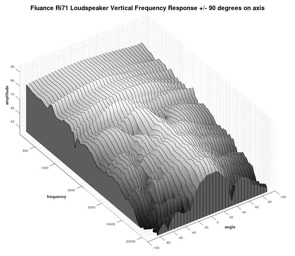

Ri71 3D Vertical Waterfall Response
The above graph shows the Ri71’s response behavior along its vertical axis, where zero degrees is directly in front of the tweeter, negative degree values are below the tweeter, and positive degree values are above the tweeter. One thing to note is that the waveguide squeezes the tweeter’s dispersion more tightly on the vertical axis than the horizontal axis. This is by design, of course, and we can see that the design is working as intended. Like all multi-way speakers where the drivers are separated by distance, we can see some off-axis nulls around the crossover frequency band. They aren’t tremendously restricting on the Ri71, but listeners will want to be within a 10-degree angle above or below the tweeter’s height in order to stay away from the nulls, which would take a bite out of the sound. As with most speakers, I would advise listeners to position the speaker where the listener’s ears are roughly level with the tweeter’s vector.

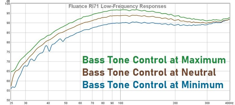

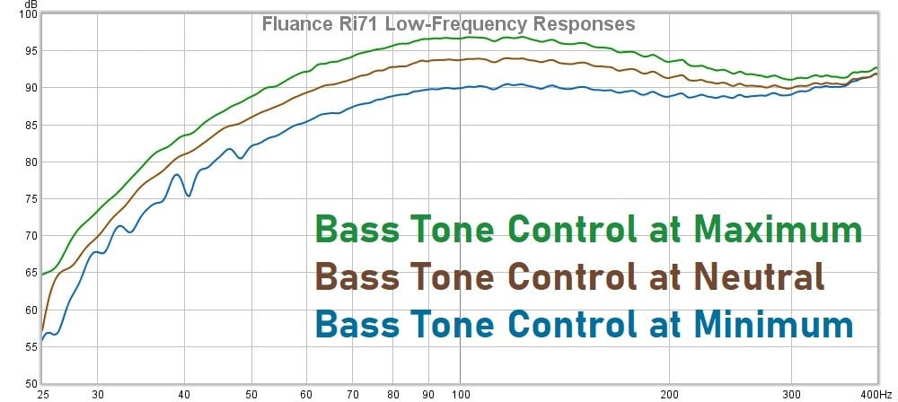

Ri71 Low Frequency Responses
The above graph shows the Ri71’s low-frequency response captured using ground plane measurements (where the speaker and microphone are on the ground at a 2-meter distance in a wide-open area). The Ri71 has a bass tone control knob, and I have shown responses where the tone control is set to maximum, neutral, and minimum. The bass control knob only moves the bass level about 3dB from its neutral position, and while that will certainly change the sound character, it won’t completely transform the speaker. Nonetheless, it’s not a bad thing to have the choice. With this kind of response exhibited above, I think most people will have a decent bass response down to mid-40Hz in-room. Of course, a 5.25” driver is only capable of moving so much air, so if you crank the volume, the low end will get squeezed first. As we saw in our listening tests, those who want loud, deep bass are going to need to add a subwoofer. One thing I like about this response is that the port output has not been exaggerated in order to give the impression of more bass, as some small bookshelf speakers tend to do. That creates a lot of output over a very short frequency band. In my experience, that can create a droney bass sound. All-in-all, the performance shown above is quite good.

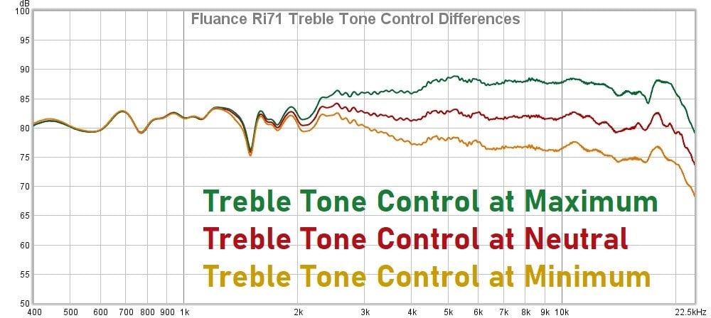

Ri71 Treble Tone Control Differences
The above graph shows how the treble is affected by the Ri71’s treble tone control. As with the bass tone controls, I have shown responses where the tone control is set to maximum, neutral, and minimum. The treble tone controls offer a bit greater difference in amplitude attenuation than the bass tone controls, and here we see about 5dB swings in output. This can make the Ri71 very hot in treble, very laid back, or just neutral. There are also degrees of attenuation between these ranges since I am only showing the extremes. This is a nice feature to suit personal preferences, and it makes these great speakers for those who like spicy speakers, and for those who like a warmer sound. Personally, I would leave the dial at the neutral position, as that achieves a nicely balanced sound to my ears.

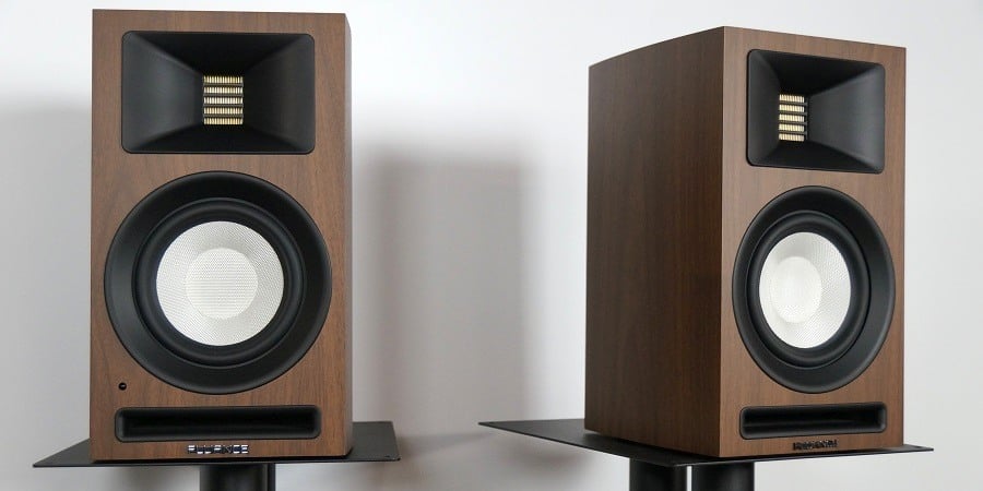

Ri71 pair4Without any real criticisms of the Ri71, let’s talk about its strengths. As a loudspeaker, its primary mission is to produce a good sound, and that is what the Ri71 does. While its frequency response is not perfect, it is a relatively neutral speaker, and it doesn’t degrade the sound with any serious spikes or dips. That controlled behavior carries out over a wide angle, so this isn’t a speaker that only sounds good in a small listening area. It can maintain a clean sound at loud enough listening levels for anyone with reasonable expectations, so it has a fairly good dynamic range. Its bass extension is good for a smaller speaker, and users should expect to easily get bass below 50Hz in a medium-sized or smaller room. They can sound bigger than they look, especially when a subwoofer is added.
I would definitely take the Fluance Ri71 speakers over almost any soundbar.
Outside of its sound quality, the Ri71’s HDMI connectivity and modest size make it a great alternative to a soundbar. Bluetooth and RCA inputs also greatly increase its flexibility to be incorporated into different systems. The subwoofer output jack, along with automatic high-pass filtering, is a big help in achieving a fuller sound and increased dynamic range. It sounds fine without a subwoofer, but it sounds great with one.
Aesthetically, they look fine, and I don’t think many people would object to their appearance in a typical living room. With three different finishes, I think they could be made to fit in almost any interior decor. Their reasonable size will help with other household members accepting them as well. They aren’t tiny speakers, but they aren’t large ones either.
