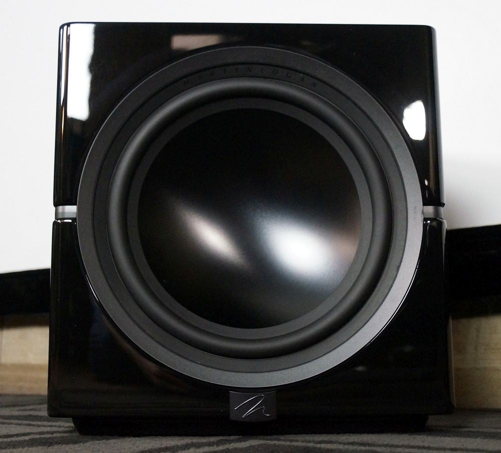

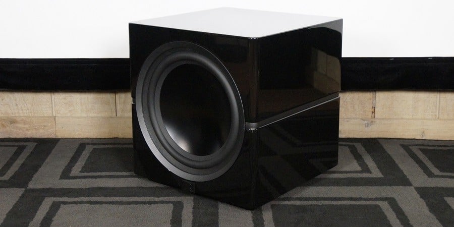

MartinLogan Dynamo 12 Subwoofer Appearance
Dynamo 12 grille3  Dynamo 12 f
the new generation of Dynamo subs looks to be more like a product revolution than evolution.

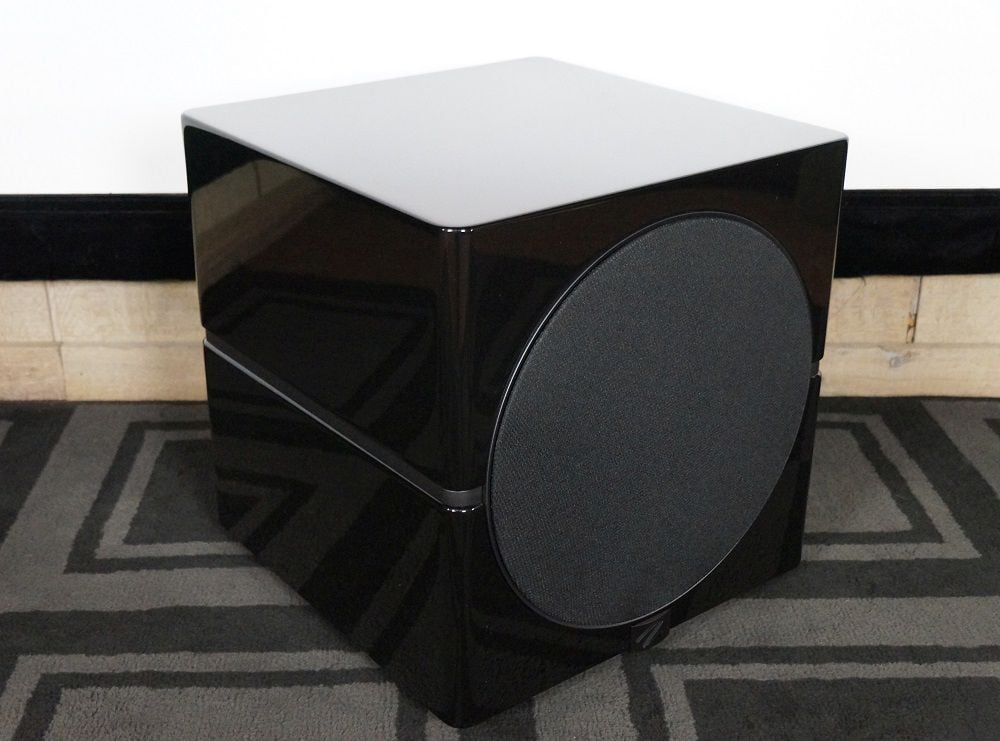

The Dynamo 12 is a very nice-looking sub, but not a stylistically daring unit. It is not a large sub, but not a tiny one either, so it needs to look classy to fit in upscale interiors. It uses a gloss black finish for a luxury demeanor, as well as rounded edges and a horizontal trim piece that divides the upper and lower halves. The driver uses a smooth, concave cone that is surrounded by a gunmetal trim ring for a neat and clean appearance. A grille that covers the cone is included, but I don’t think it improves the appearance of the sub, so I wouldn’t use it unless the driver needs protection from children or pets. A MartinLogan badge rests at the lower lip of the front baffle. Overall, the Dynamo 12 is about as tasteful as a subwoofer enclosure can be made to look, and the only person who would object to its appearance is someone who wouldn’t tolerate any subwoofer whatsoever.

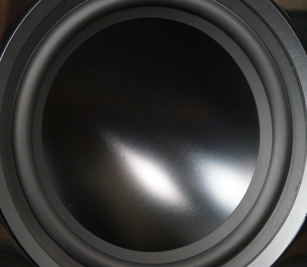

Dynamo 12 cone2In the broadest terms, the Dynamo 12 is a sealed subwoofer with a 12” driver and an 800-watt RMS amplifier, but that doesn’t tell us enough to know how it performs; for that, we need to know the specifics. So, let’s begin our discussion of the design details with the driver. MartinLogan’s 12” driver uses an aluminum one-piece cone that is affixed directly to the former. This is interesting because many subs in this category use aluminum as a layer like a dust cap, and then use something like treated paper, polymer, or a stiff fabric like Kevlar as the body of the cone. MartinLogan tells me that it’s more difficult to manufacture a unibody aluminum cone like this, but it offers performance benefits by acting as a heatsink, thereby reducing thermal compression. It also allows the cone to be anodized black to match the exterior styling better. This is a change from the previous generation of Dynamo subs, which used polypropylene cones.
The cone attaches to a stamped-steel basket via a half-roll surround. Previous generation Dynamo subs used an inverted, ribbed surround, but MartinLogan tells me that buyers preferred the look of traditional convex surrounds because it made the driver look brawnier, so they went back to a more traditional surround. The motor section has been beefed up with larger magnets, although they still use 2” voice coils. Klippel analysis was used to optimize output and lower distortion in the design. As a sealed system with a +/-3dB window down to 22Hz, the driver needs to be fairly high-excursion to withstand such low frequencies, even if DSP is used to attain that kind of response. (Or rather, especially if DSP is used to attain that response!)

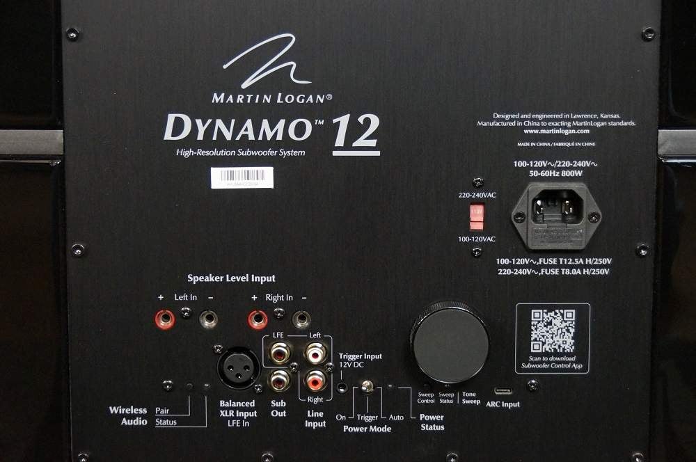

Dynamo 12 back panel2
MartinLogan calls their amplifier the Magnitude MT-1.6kW amplifier. The 1.6kW stands for 1.6 kilowatts of peak power, although it is spec’d at 800 watts RMS. It is controlled by an advanced 500MHz DSP engine with 64-bit processing. Most of the amp’s functions can be controlled by MartinLogan’s subwoofer control app, which connects via Bluetooth. The app controls are extensive, including levels, low-pass frequency, low-pass filter order, continuous phase, listening modes, ARC Genesis, and a tone sweep. The physical controls on the subwoofer itself are pretty sparse: volume, tone sweep, power mode, and wireless audio pairing. This is a problem when trying to integrate the Dynamo 12 into systems without bass management, where users don’t have access to the app. Apps can glitch out or have compatibility issues, especially as software environments continue to change. Without external bass management, users would need access to low-pass and phase settings, but there is no way to control those on the Dynamo 12 without the app. I think MartinLogan easily could have added a button or switch on the backplate that would enable the knob to control multiple different settings. Physical access to these functions wouldn’t have been that difficult to include if the company chose to do so.
The rear panel volume knob is pretty swank in the way it illuminates the level. It can also be used to control a sine wave tone generator. That is a nice onboard feature, not only to check for signal and amplification problems, but also to look for room resonances. Instead of loading up an exterior tone generator to look for bass-induced buzzes and rattles around the room, that can be done from the sub itself. It’s a handy feature, and I am surprised more sub manufacturers haven’t followed MartinLogan in adopting this feature.
Connectivity is generous and consists of a line-level RCA LFE input as well as left/right RCA inputs, an RCA sub out, a balanced XLR input, left/right speaker-level inputs, and even a built-in wireless receiver. The sub comes with a wireless transmitter, too. This allows the Dynamo 12 to easily accommodate a wide variety of systems and situations.

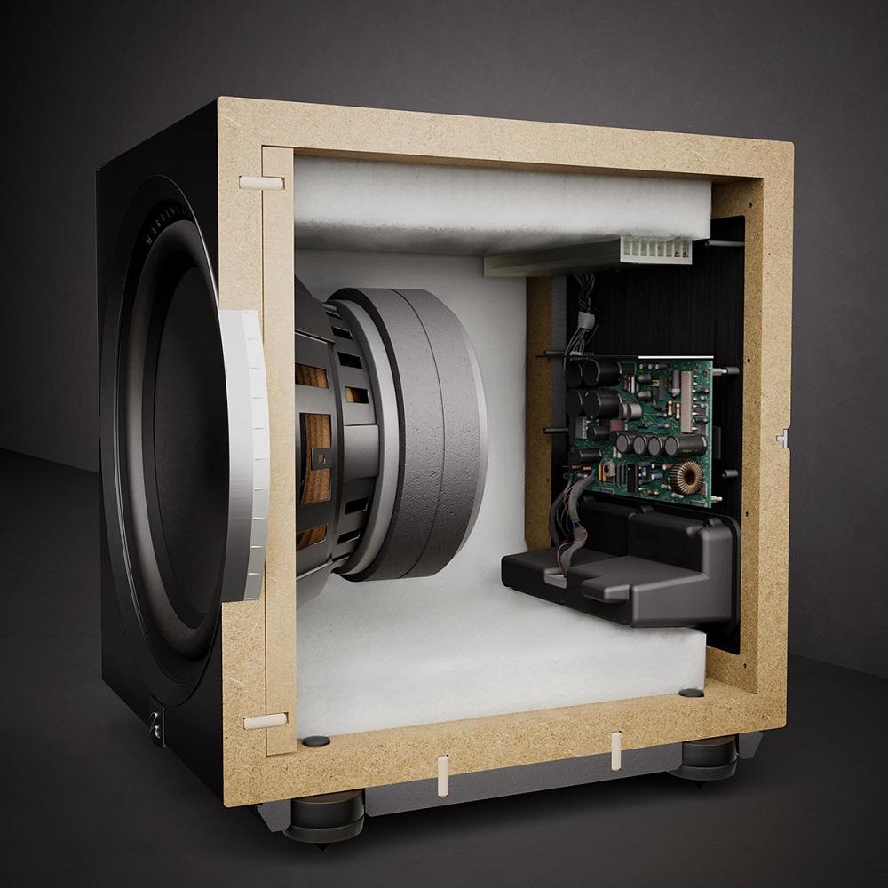

dynamo 12 cutawayThe Dynamo 12 is compatible with Anthem’s room correction software “ARC,” although users will need to buy the ARC calibration mic and supply a PC or Mac that can run the software. This is a great addition for systems that either do not have automated room correction equalization systems, or only have older EQ systems. Many simpler two-channel systems would not have this capability, nor would many pro-audio or pro-sumer systems, so the Dynamo 12 makes it easy to use advanced auto-equalization in those system types.
The enclosure is a beefy one and uses 1” MDF side panels with corner braces shoring up the interior edges. A polyfill-type stuffing lines the interior panels. The feet are some circles made out of a soft rubber compound that is supposed to damp mechanical vibrations from transmitting to the floor. MartinLogan also provides a spike option for users who want stickier footing on carpeted surfaces.

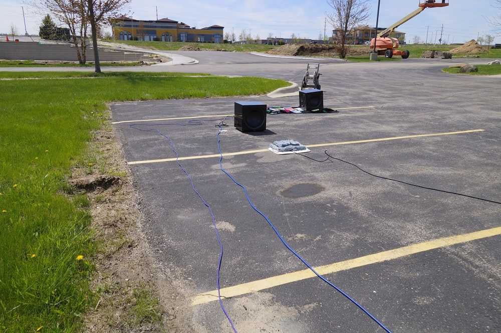

Testing on the MartinLogan Dynamo 12 was conducted with the microphone facing the woofer at a 1-meter distance with measurements scaled back to a 2-meter distance by subtracting 6dB. The temperature was recorded at 60°F with 80% humidity. The subwoofer’s gain was set to maximum; the phase was set to zero, and the low-pass filters were set to bypass.

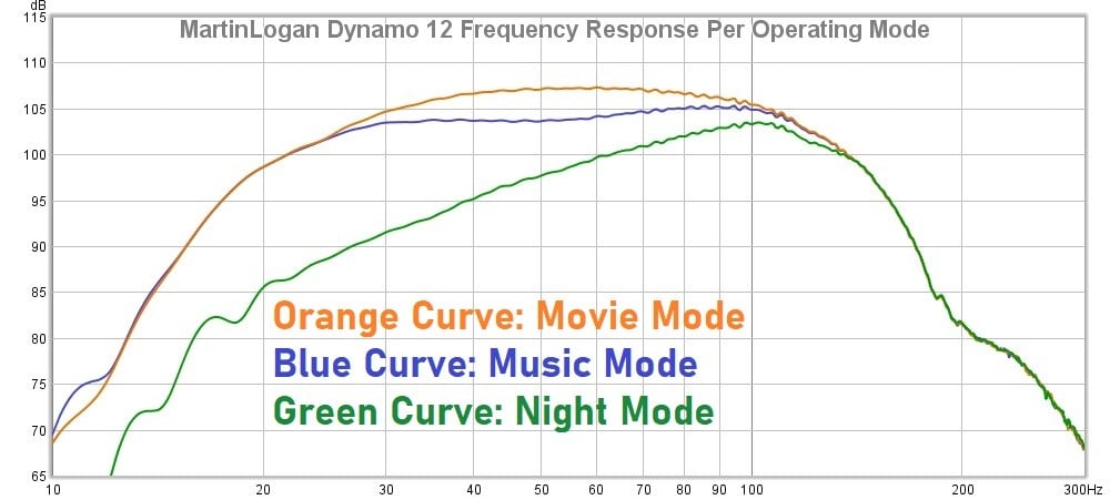

The above graph shows the measured frequency responses for the Dynamo 12 subwoofer for each of its operating modes. ‘Music Mode’ provides the most neutral response; ‘Movie Mode’ gives a bit more mid-bass oomph; and ‘Night Mode’ simply lessens output as the frequency lowers. ‘Music Mode’ will give the most weight to deep bass in this set of responses, so I am not sure why anyone wouldn’t just use that mode for movie watching as well as music listening. ‘Movie Mode’ and ‘Music Mode’ should yield a solid in-room response down to below 20Hz. However, a single sealed 12” sub isn’t going to have gobs of headroom at very deep frequencies, as we shall see, so multiple Dynamo 12s would be recommended for those interested in lots of deep bass output. ‘Night Mode’ shaves off deep bass output, and that might help lessen the transmission of sound through walls in typical household construction, but it wouldn’t eliminate the sound transmission altogether.

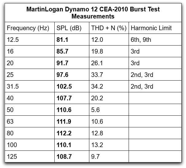

Dynamo 12 CEA 2010 table
Bassaholics Medium Room RatingThe above CEA-2010 measurements are short-term bursts that show the subwoofer’s clean peak SPL before heavy distortion sets in. Our measurements have been referenced to 2-meter RMS, which is 9dB down from the standard requirement for the measurements to be shown at 1-meter peak. However, most publicly available CEA-2010 measurements are shown at 2-meter RMS, so we followed that convention.
The Dynamo 12 is able to produce a healthy level of deep bass along with a nice mid-bass punch. While output at 16Hz and below is not tremendous, 91.7dB at 20Hz and 97.6dB at 25Hz is an appreciable amount of deep bass, and not bad at all coming from a sealed 12” subwoofer. Above 50Hz, output averages above 110dB, so the Dynamo 12 is able to throw a truly meaty jab in music-range bass. These measurements net the Dynamo 12 our Bassaholics ‘Medium’ Room Rating, meaning it should be able to handle rooms of up to 3,000 cubic feet. It is a bit restricted at lower frequencies to earn a larger room rating, but it could probably handle a larger room size for those who just wanted it for acoustic music bass rather than movie bass. To learn more about Audioholics’ Bassaholics Room ratings, please look at this article: Bassaholic Subwoofer Room Size rating Protocol.

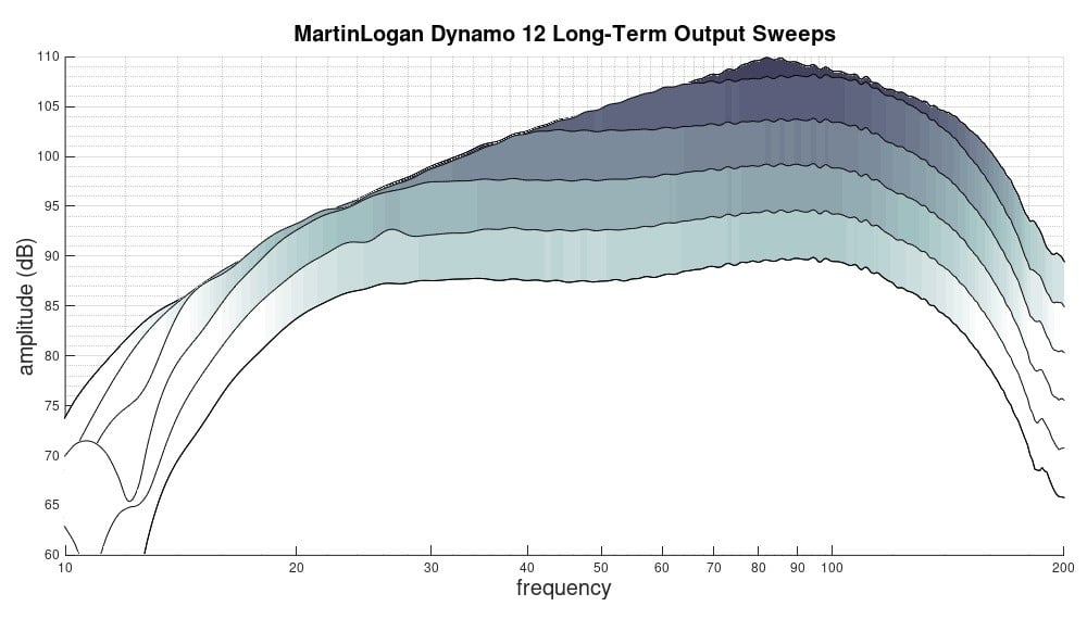

Dynamo 12  compression sweeps
Testing for long-term output compression was done by first conducting a 20-second sweep tone where 50Hz hit 90 dB with the subwoofer 1 meter from the microphone (graph has been scaled to 2 meters for easy comparison with our other review measurements). We then conduct further 20-second sweeps by raising the gain by 5dB until no more output can be wrung out of the subwoofer. These tests show us the long-term continuous headroom that the subwoofer is capable of.
This test was conducted with the Dynamo 12 in ‘Music Mode.’ We can see how compression changes the response at higher drive levels. As the sub is pushed harder, it overrides its equalized ‘mode’ response and begins to conform to the native response of the driver in the enclosure. By the highest drive level, we see a typical sealed subwoofer response with a 2nd-order roll-off. This would occur in ‘Movie Mode’ as well. We can see that for ‘Night Mode,’ MartinLogan simply allowed the native response of the sub. In the end, we can see that the Dynamo 12 is capable of quite a bit more mid-bass than deep bass, but that is true for most sealed subwoofer designs.

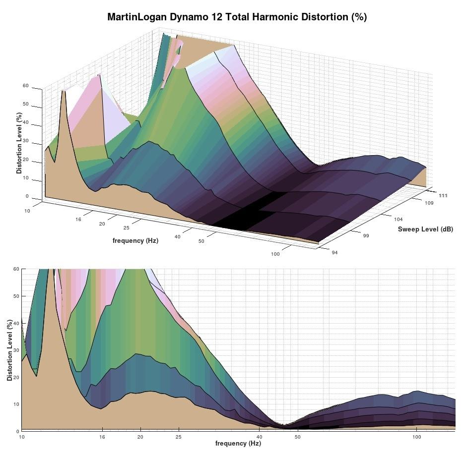

Dynamo 12 THD
The above graph shows the corresponding total harmonic distortion to the long-term output graph. Essentially, it depicts how linear the subwoofer remains for the corresponding drive level seen in the long-term sweeps. The quantity being measured is how much of the subwoofer’s output is distortion, shown here as a percentage.
As with many other sealed subwoofers, distortion ramps up as frequency goes down. Sealed system drivers are put under a lot of strain to produce deep bass; for every octave lower the driver is tasked to play, the excursion demands quadruple to maintain the same SPL. It gets no assistance from a port or passive radiators. A sealed system runs out of headroom quickly in deep bass, and when the driver reaches the limits of its excursion, it begins to produce distortion. For the Dynamo 12, at nominal levels at the 90dB sweep or lower, distortion is kept in check pretty well, especially above 40Hz, where it barely rises above 1%. Even at full throttle, distortion in mid-bass just barely goes over 10%.
Dynamo 12 2nd harmonic
Dynamo 12 3rd Harmonic

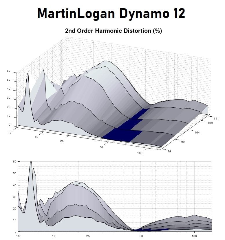

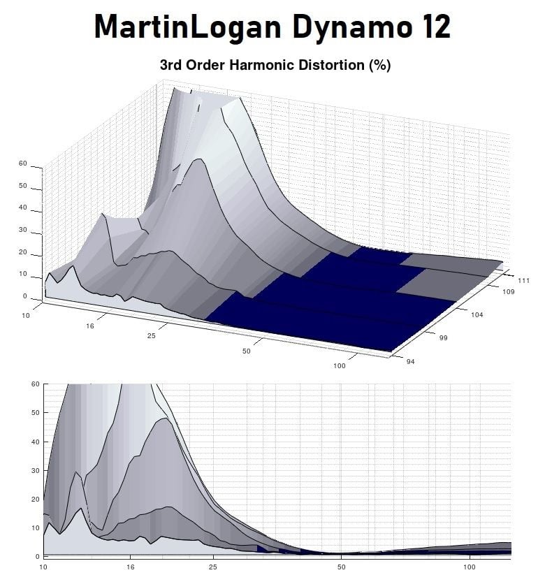

The above graphs depict measurements of the constituent harmonics from the long-term output sweeps and are what the total harmonic distortion measurements are composed of for the 2nd and 3rd harmonics. These individual harmonics can give us a clue as to what might be the cause of some quirk or non-linearity. We are only showing the 2nd and 3rd here because they more-or-less reflect the higher even-order and odd-order behaviors, although higher-order harmonics tend to be much farther down as a percentage of distortion compared to the second and third.
One point of interest about the above graphs is how we can see that even-order distortion is more prominent at lower levels than odd-order distortion, but as the drive level increases, odd-order takes over, at least in lower frequencies. The good news about that is that even-order products are more difficult to perceive than odd-order, so the Dynamo 12’s distortion should be fairly subtle until you push the sub hard in deep bass. I would guess from the shape of the even-order distortion response that its root cause is induction. I don’t know if MartinLogan employs shorting rings or a pole piece cap that could reduce induction. A 12” driver that could handle the 800 watts of the amp needs quite a bit of coil to handle all of that power, and that is bound to generate some significant induction.

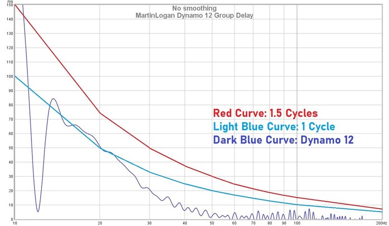

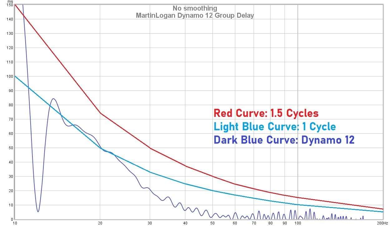

Dynamo 12 Group Delay
The Dynamo 12 is razor-sharp with excellent transient response.
Group delay is the measurement of how much time it takes for individual frequency bands of an input signal to be produced by the speaker. It can indicate that some frequency components are developing slower than others or are taking longer to decay. It is generally thought that 1.5 sound cycles are needed for group delay to be audible at bass frequencies, although there is an argument that group delay should remain under 20ms to be completely unnoticeable, but that is likely meant for mid and upper bass frequencies.
The performance shown by the Dynamo 12 above is very good. Above 40Hz, it doesn’t even get close to 10ms of delay. By the time it exceeds our worst-case scenario of 20ms, it is under 30Hz where human hearing acuity is greatly diminished. Furthermore, there is very little musical content under 30Hz. The rise in group delay is caused by the response shaping from the DSP. Without this equalization, the Dynamo 12 would likely have extremely low group delay across all frequencies. As it is, in the range where it matters, it has terrific time domain performance. Anyone worried about the Dynamo 12 sounding slow or lingering does not need to be. It’s razor-sharp with excellent transient response.

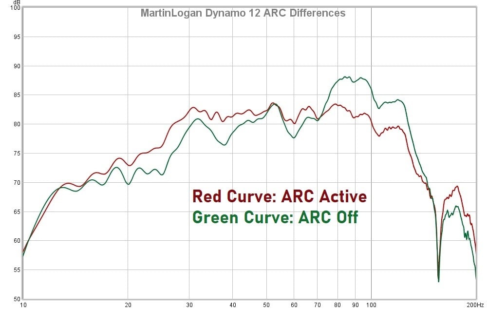

Dynamo 12 ARC DIfferences
The above graph is the in-room frequency response I measured with and without ARC active. Each curve is an average of five positions. As can be seen, ARC makes a big improvement. This isn’t just seen on a graph but heard in person. From 30Hz to 100Hz, ARC irons out the response to within a 3dB window. Without ARC, the response takes wild swings and has about an 11dB window within that same frequency range. Peaks are trimmed and dips are lifted. Users will need to buy the ARC calibration microphone to use the software onboard the sub, but I would say it is well worth the expense, given these results.
