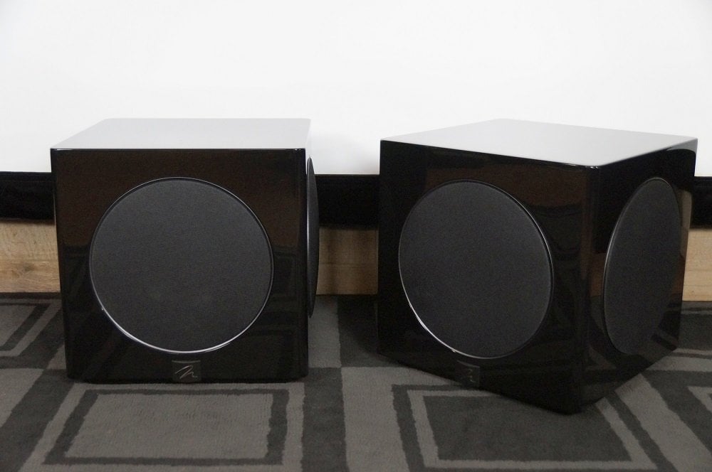

MartinLogan Abyss 10 Subwoofer Appearance

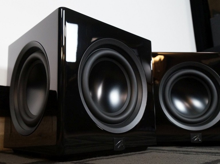

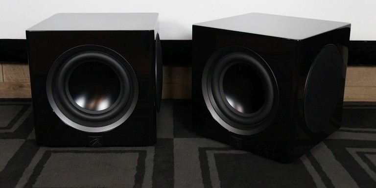

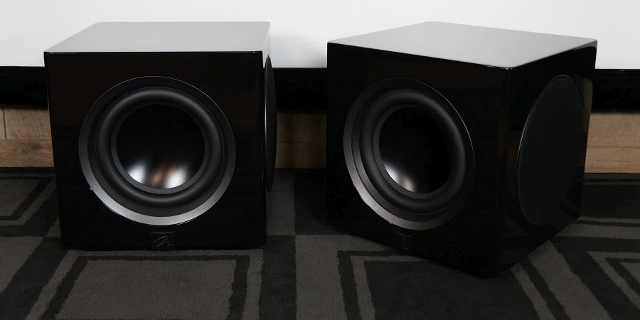

The Abyss 10 doesn’t take any risks in trying to look like a nice sub, so it goes the tried-and-true route of a gloss black finish with rounded edges. It’s a reliable way to get a box to look nice, which the Abyss 10 does. The lateral and horizontal edges have a slight rounding, but the vertical edges have a much heavier rounding. One aspect that helps its appearance is the symmetry of being an almost perfect cube shape. This heightens the “spousal approval factor,” as does the diminutive size of the Abyss 10. One visual aspect that distinguishes the Abyss 10 is the side-firing passive radiators. These add to the symmetry since the radiators look identical to the active driver, so all side panels have the same appearance except the rear panel. The driver cones all have a very clean look since they use smooth concave aluminum cones and are surrounded by trim rings, so no screws are exposed. MartinLogan has included grilles that have a plastic mesh frame wrapped in black fabric that covers only the cones. I don’t think they improve the appearance of the Abyss 10, so I would only use them to protect the drivers if needed. Overall, the Abyss 10 looks like a nice sub with restrained styling that will allow it to fit in any type of interior decor. Its small size may allow it to be tucked away somewhere unnoticeable, but if that is not possible, its appearance is not likely to offend, even in more luxurious interiors.

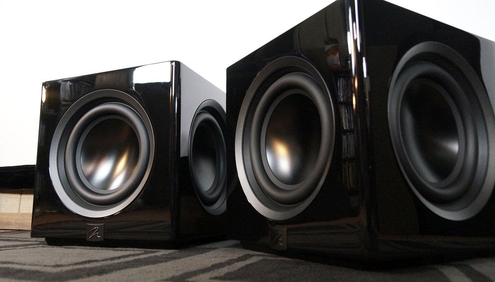

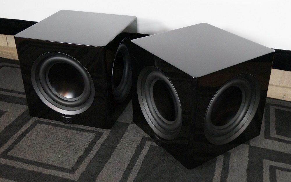

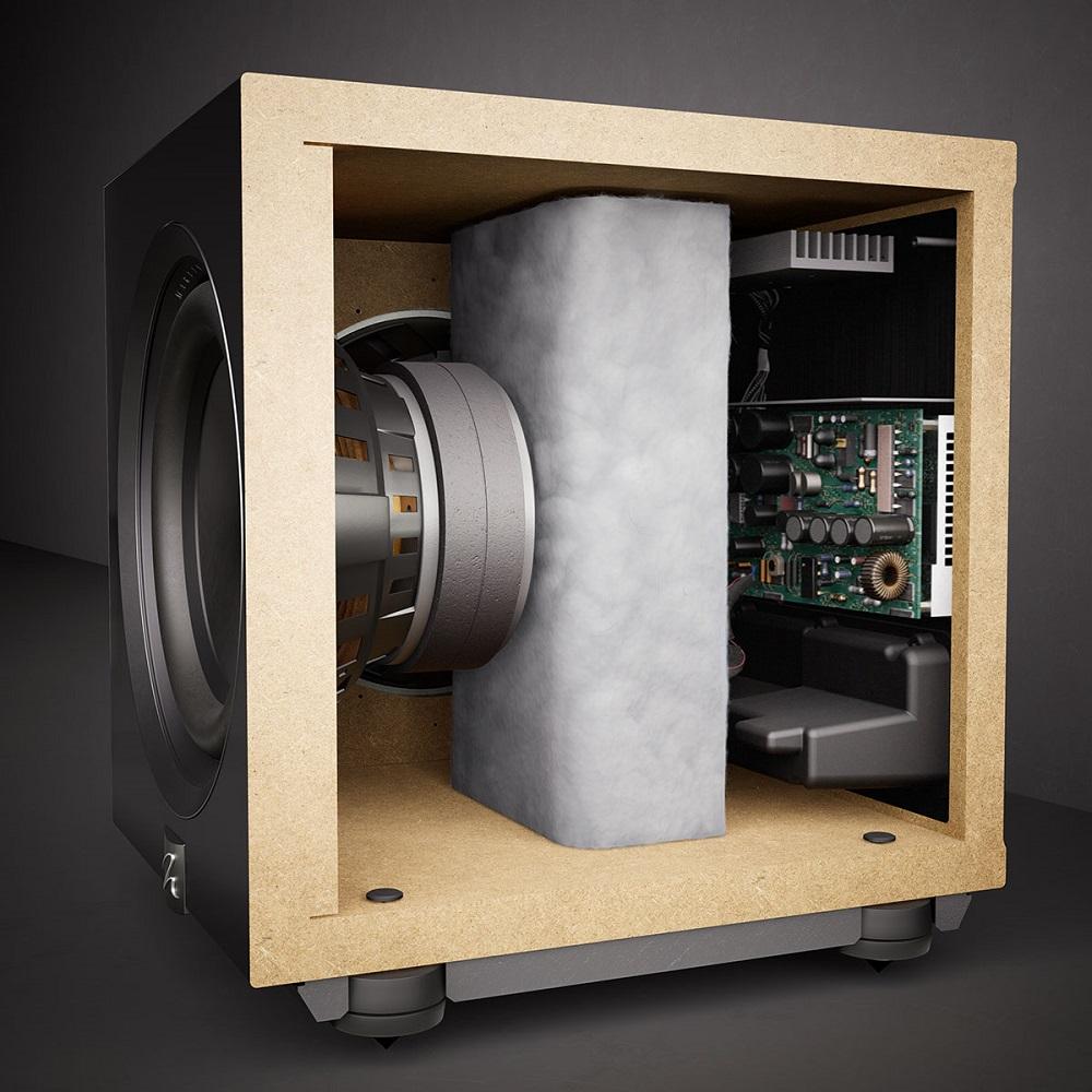

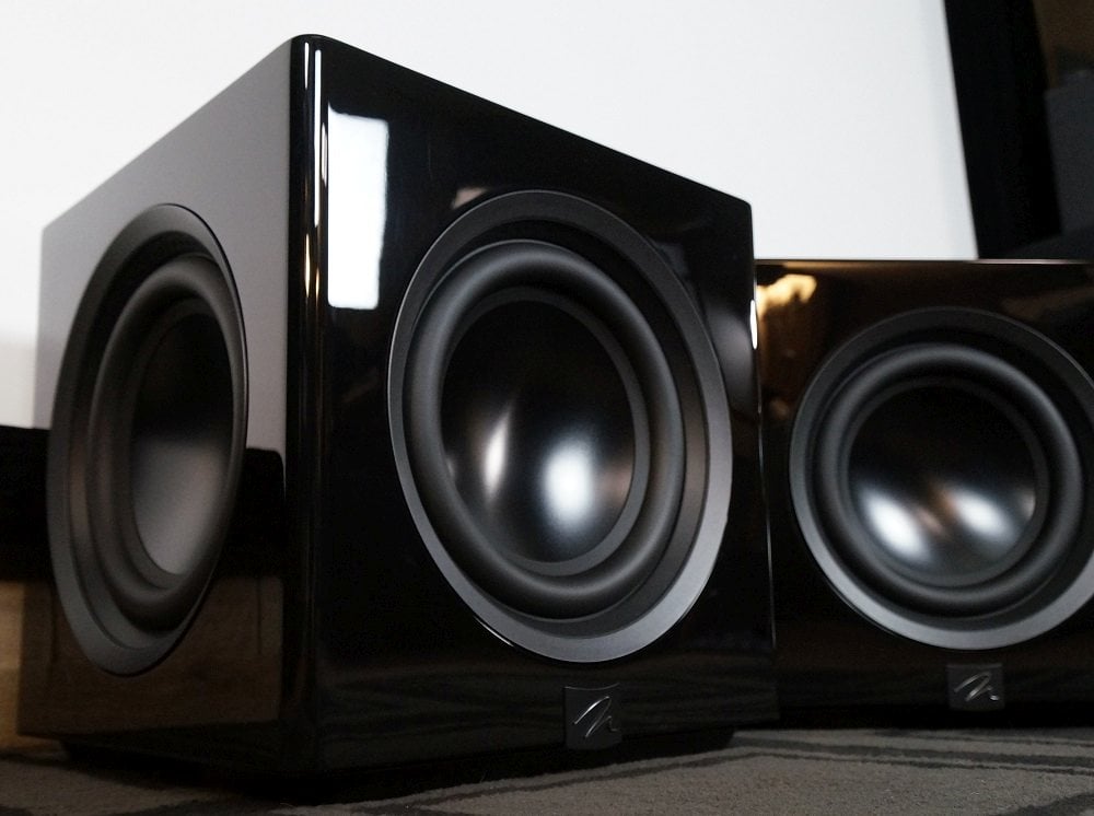

To state the design in a nutshell, the Abyss 10 uses a 10” driver to load two passive radiators and is powered by an 800-watt RMS amplifier. But that is just a surface description that doesn’t tell us a lot about how the subwoofer will perform, so let’s dig in a bit deeper and begin our discussion with the driver. The Abyss 10 driver uses a 10” aluminum cone. This is a single-piece aluminum cone and not just a dust cap for some other material, as is so often done. This is more difficult to manufacture but is advantageous since the cone can act as a heatsink in order to reduce thermal compression. This is especially advantageous when a mere 10” woofer is being driven by 800 watts of RMS power. MartinLogan is trying to squeeze a lot of performance out of a small cabinet, and that can be done by giving it a lot of amplification, but now thermals become a larger consideration, since so much of the power being dumped into a small, near-airtight enclosure will end up as heat. I think that a heatmap of the Abyss 10 in operation would be interesting to see, not just for the active driver cone but for the passive radiator cones, which are also aluminum pieces.
The cone attaches to a stamped steel basket via a half-roll surround. The motor uses a 3” voice coil in a double stack of magnets. It’s vented from both under the spider and through the pole piece in the backplate. The larger coil diameter and extra venting are needed to handle so much power.
Benefits of Passive Radiators

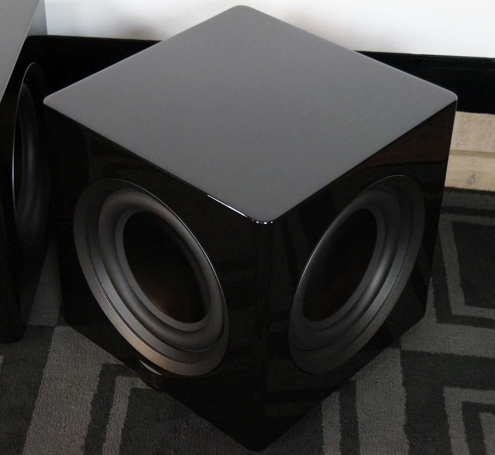

The deepest frequencies of the Abyss 10 are produced by its passive radiators. For those who don’t know, the radiators are driven by the backwave pressure created by the driver, much like the air in a port. But passive radiators have several advantages over a port. Firstly, they allow the enclosure to be smaller since port volume doesn’t occupy internal cabinet space. Second, passive radiators do not have all of the aural byproducts that a port can produce, such as “chuffing” and port pipe resonances. To be sure, passive radiators can produce some mechanical noise when overdriven, but it is usually less intrusive than the turbulence generated by a port. One disadvantage of passive radiators is that they might not have as fast a reaction time as the air in a port, since the moving assembly of a passive radiator has a lot more mass than a slug of air. There may be a bit more group delay in a passive radiator’s bandwidth, although a well-engineered system of either type can keep delay down to inaudible levels.
MartinLogan has wisely used two passive radiators in opposing sides of the enclosure. As a rule of thumb in loudspeaker design, you generally want passive radiators to have twice as much displacement as the driver. So you can either have two radiators with as much linear throw as a driver, or have one passive radiator with double the linear throw as the driver. Long-throw passive radiators tend to be very heavy as well as sometimes unreliable, so MartinLogan opted to use two medium-throw radiators that match the driver. It was probably easier for them to do this since they already had the suspension and cone design down from the active driver. Their design is mostly just the active driver minus the motor section, and maybe a bit of added weight on the moving assembly to hit a certain resonant frequency.
It was also a smart move to have the passive radiators firing in opposing directions; the moving mass of the radiators will cancel each other out. Earlier passive radiator designs were known to be so heavy that they could shift the entire subwoofer enclosure so that it would “walk” and move its position by itself. With MartinLogan’s design, the passive radiators won’t cause any rocking motions at all.

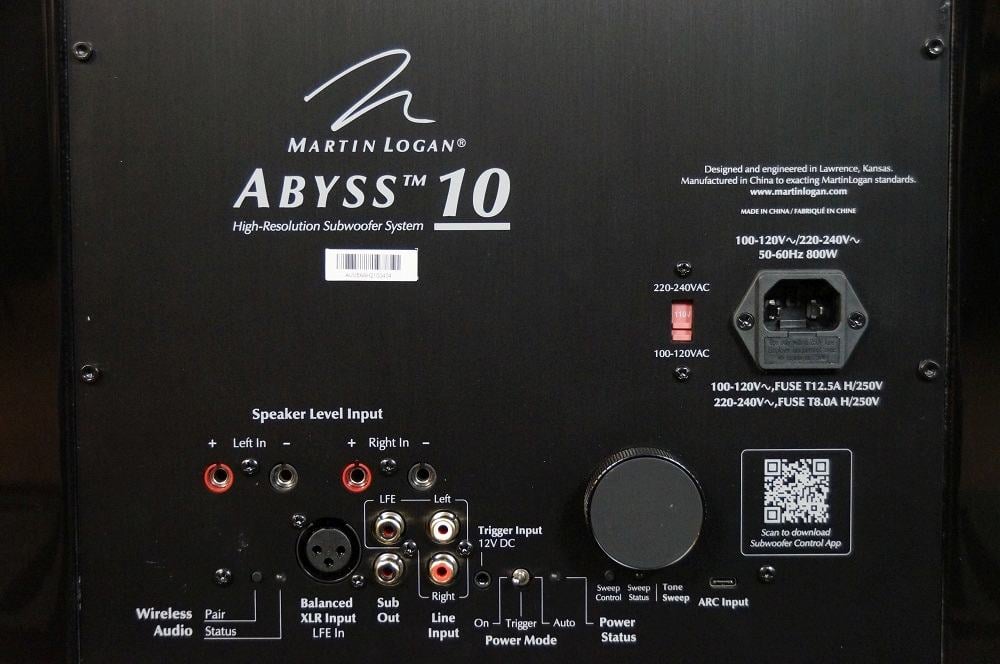

The active driver is powered by an amplifier that MartinLogan has coined the Magnitude MT-1.6kW amplifier, which puts out the aforementioned 800-watts RMS and 1,600-watts peak. It is controlled by an advanced 500MHz DSP engine with 64-bit processing. Most of the amp’s functions can be controlled by MartinLogan’s subwoofer control app, which connects via Bluetooth. The app controls are extensive, including levels, low-pass frequency, low-pass filter order, continuous phase, listening modes, ARC Genesis, and a tone sweep. The physical controls on the subwoofer itself are pretty sparse: volume, tone sweep, power mode, and wireless audio pairing. I also have a Dynamo 12 subwoofer in for review with the Abyss 10, and they share the same problem; there is very little configurability without the app. That will be a real problem for systems that don’t have exterior bass management on those occasions when the app doesn’t work. Bluetooth apps usually work, but not always. I have not always had success getting my phones to communicate with the subs, although the MartinLogan app seemed to work with my Samsung Android phone. I think MartinLogan should have added physical controls to adjust phase and low-pass frequency settings on the amp panel.
One of the few controls on the amp panel is a knob that has an LED light strip that indicates level. It can be used to control either volume or a tone generator frequency. The tone generator is a nice onboard feature, not only to check for signal and amplification problems but to look for room resonances as well. The Abyss 10’s connectivity options are excellent: line-level RCA LFE input as well as left/right RCA inputs, an RCA sub out, a balanced XLR input, left/right speaker-level inputs, and even a built-in wireless receiver. It comes with a wireless transmitter too.

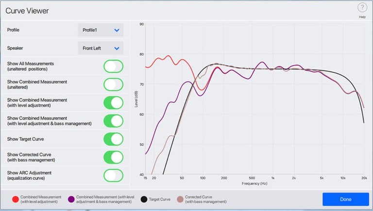

The Abyss 10 is compatible with Anthem Room Correction (ARC), although users will need to buy the ARC calibration mic and supply a PC or Mac that can run the software. This is a great addition for systems that do not have automated room correction equalization systems, or only have older EQ systems. Many simpler two-channel systems would not have this capability. The same is true for many pro-audio or pro-sumer systems. So, the Abyss 10’s compatibility with ARC makes it easy to use advanced auto-equalization in those system types.
The Abyss 10 enclosure is a stout affair, with 1” thick MDF side panels and a central pillar reinforcing the top and bottom panels. Acoustic stuffing has been added for internal damping. MartinLogan touts their “anti-vibration” feet, which look to me like standard soft rubber feet, and not exactly as high-technology as the company describes. But they should do the job of damping enclosure vibrations from transmitting mechanical energy to the floor. I think that, unless the flooring is flimsy, this is a problem that is usually overstated. MartinLogan also provides spiked feet for users who want sticker footing on carpeted surfaces.

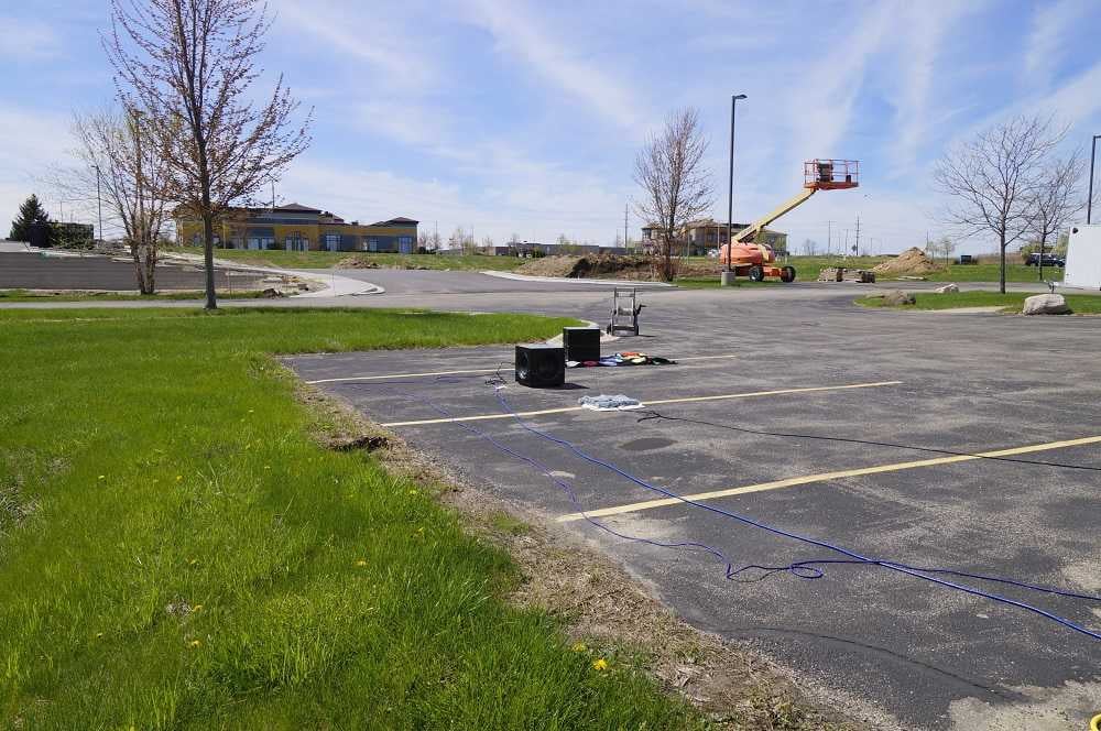

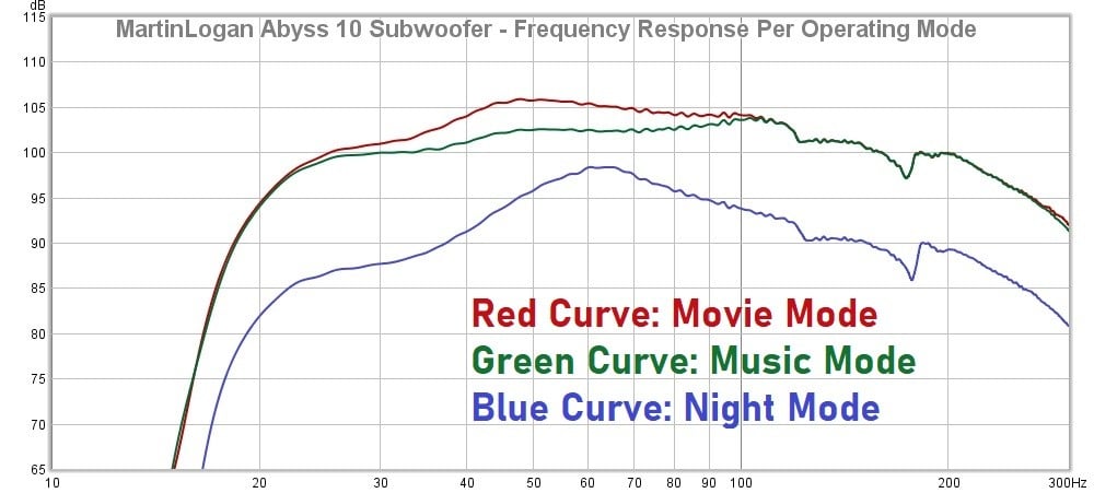

Testing on the MartinLogan Abyss 10 was conducted with the microphone facing the woofer at a 1-meter distance with measurements scaled back to a 2-meter distance by subtracting 6dB. The temperature was recorded at 60°F with 80% humidity. The subwoofer’s gain was set to maximum; the phase was set to zero, and the low-pass filters were set to bypass.
The above graph shows the measured frequency responses for the Abyss 10 subwoofer for each of its operating modes. Its most neutral response occurs in Music Mode, but typical domestic room acoustics will screw up any flat low-frequency response, so don’t expect to get anything like that in-room. Nonetheless, Music Mode is what I would run the sub in. Movie Mode gives a small boost to lower mid-bass, mostly in the range from 40Hz to 70Hz. I am not sure why MartinLogan thought that movies would somehow benefit from an elevated response in this range. My guess is that they did this simply because the sub has a lot more headroom within that band. Either mode should yield a solid in-room response down to 20Hz. What is also nice is the upper bass extension that goes up to 200Hz. This high-frequency extension allows the user to try much higher crossover frequencies than the standard 80Hz, and that can yield big dividends, especially in multi-sub systems.
Night Mode substantially reduces overall output, especially in deep bass. I have to question the usefulness of Night Mode, and I think its benefits would be very situational. If you are playing your system so loud that it is bothering other household occupants, reducing the sub level as well as the sub’s response shape probably isn’t going to solve the problem, although it might slightly alleviate it.

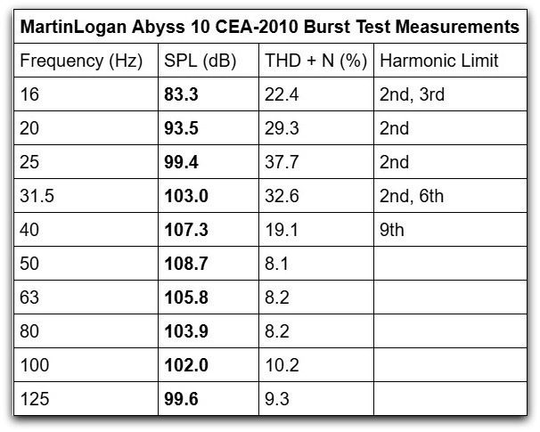

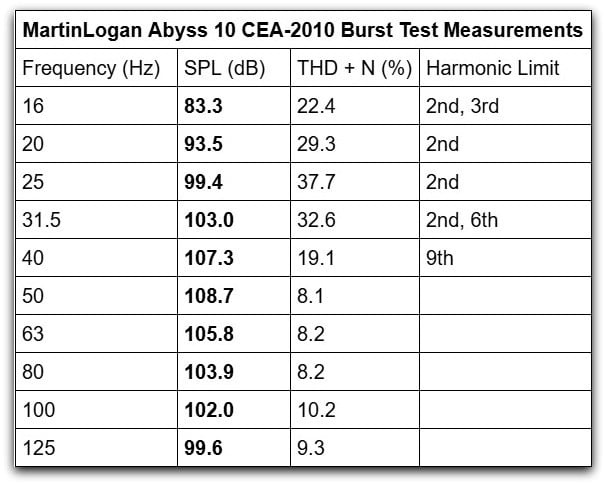

The above CEA-2010 measurements are
short-term bursts that show the subwoofer’s clean peak SPL before heavy
distortion sets in. Our measurements have been referenced to 2-meter RMS, which
is 9dB down from the standard requirement for the measurements to be shown at
1-meter peak. However, most publicly available CEA-2010 measurements are shown
at 2-meter RMS, so we followed that convention.
The above table shows the Abyss 10 to be a punchy little subwoofer with good bass extension down to 20Hz. It almost but not quite hits 100dB at 25Hz, which is good for a subwoofer of its size. Output peaks at 108.7dB at 50Hz, which should give some real thump to the fundamental of many bass drums. There are subs that can produce more output for a lower cost, but they do so in a much larger size, as well as with a lesser build quality and feature set. This CEA-2010 burst test measurement set nets the Abyss 10 our Bassaholics “Medium” Room Rating, meaning it should be able to handle rooms of up to 3,000 cubic feet. Not bad for such a modestly-sized subwoofer!

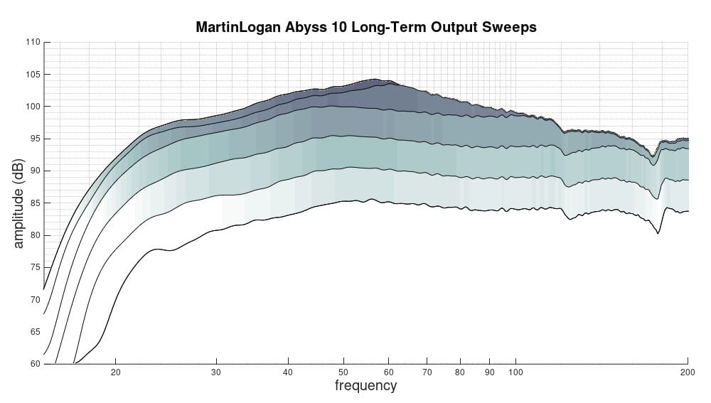

Testing for long-term output compression was done by first conducting a 20-second sweep tone where 50Hz hit 90 dB with the subwoofer 1 meter from the microphone (graph has been scaled to 2 meters for easy comparison with our other review measurements). We then conduct further 20-second sweeps by raising the gain by 5dB until no more output can be wrung out of the subwoofer. These tests show us the long-term continuous headroom that the subwoofer is capable of.
The continuous output exhibited by the Abyss 10 in the above graph is not bad. Surprisingly, the highest drive levels compress the higher frequency bands rather than the lower frequency bands. That means that the Abyss 10 does not give up much output at the deepest frequencies when pushed hard. The Abyss 10 driver likely has a fair amount of moving mass in order to push so much air for such a small cone, and the trade-off in that is reduced upper frequency sensitivity. Lots of voice coil means higher inductance and greater weight, and that skyrockets the amount of power needed to maintain the same SPL in those circumstances. The Abyss 10 manages to exceed 100dB continuously between 40Hz to 70hz, and it can belt out 95dB non-stop at 25Hz. Again, very impressive for such a small subwoofer.

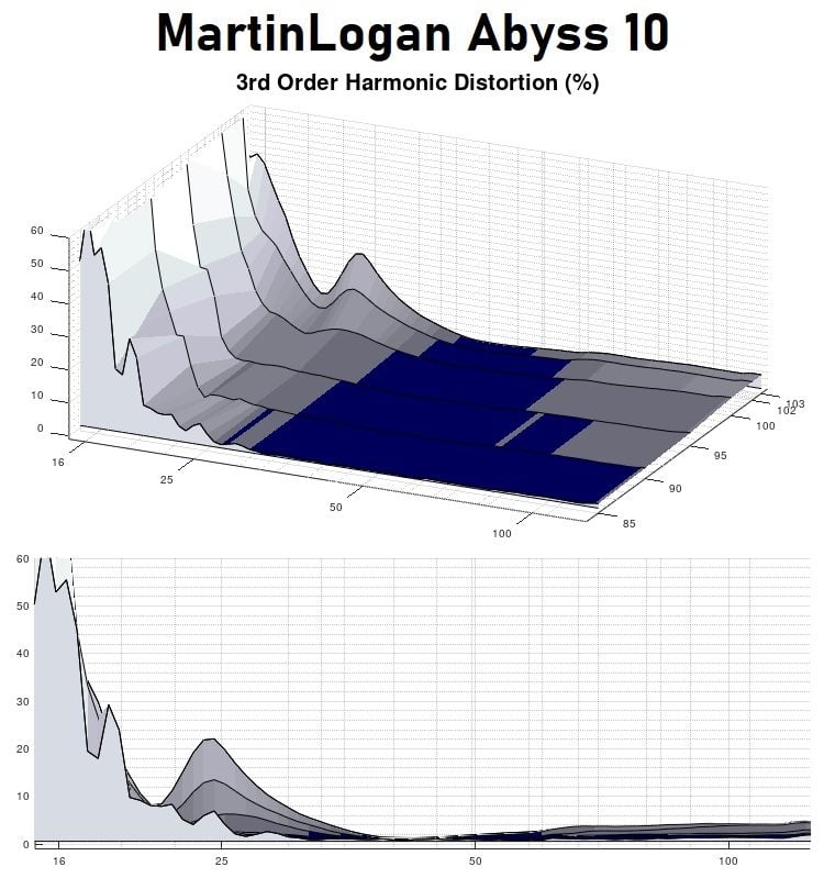

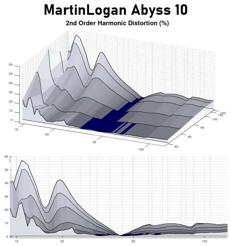

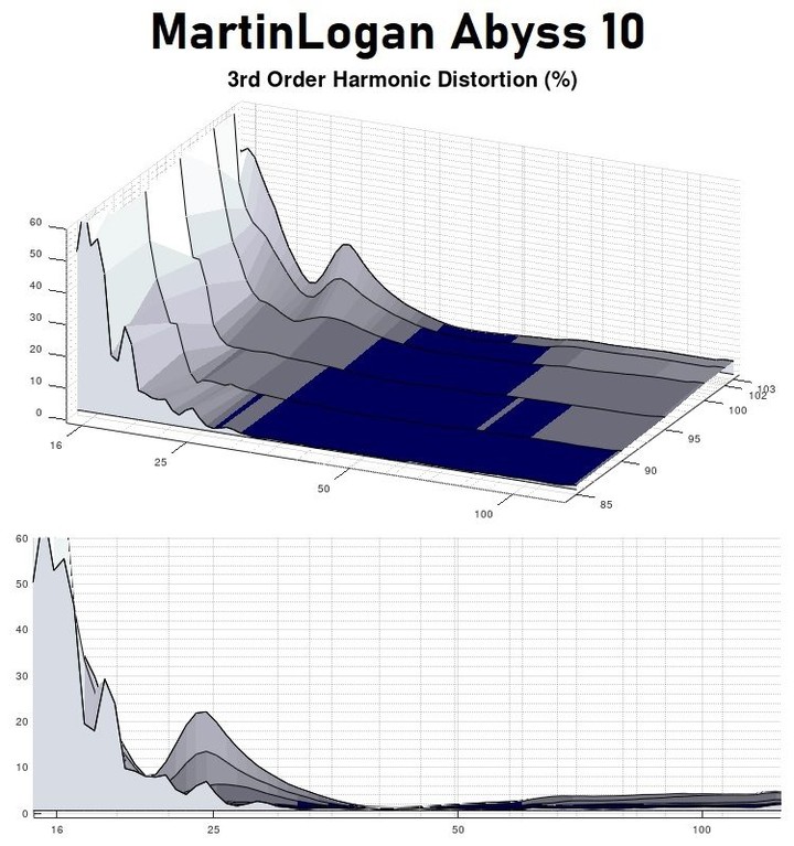

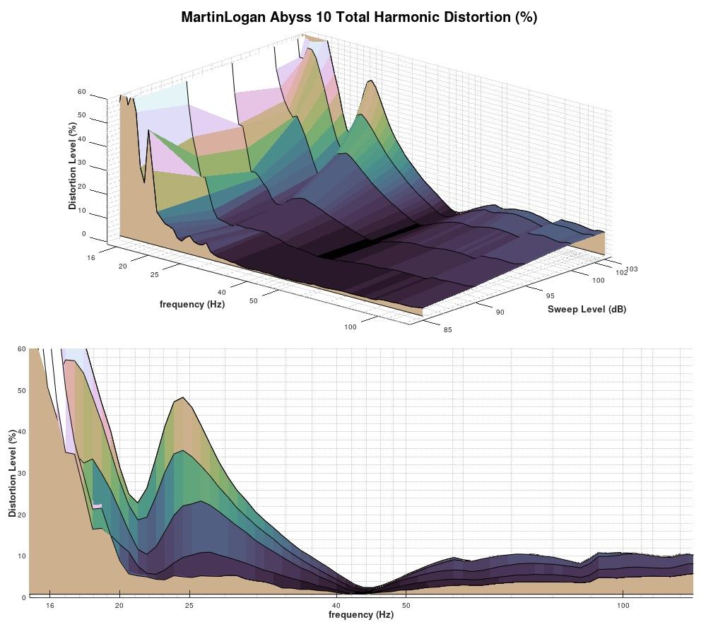

The above graph shows the corresponding total harmonic distortion to the long-term output graph. Essentially, it depicts how linear the subwoofer remains for the corresponding drive level seen in the long-term sweeps. The quantity being measured is how much of the subwoofer’s output is distortion, shown here as a percentage.
While the Abyss 10 can generate a fairly high level of distortion at 25Hz when pushed to its limits, it does a great job of maintaining its cool above 35Hz where it can’t be pushed over 10% THD. It’s a good sub for loud music since the vast majority of the bass in musical recordings occurs above 40Hz. At nominal levels, it stays very clean down to 20Hz, but when pushed hard, the frequency band around 25Hz does shoot up in distortion. I never noticed anything amiss in my own listening of normal content, but hitting the Abyss 10 with a sine wave test tone at 25Hz will produce some pretty clear overtones. My guess is that most users will never push it that hard. We see that distortion lowers just below 25Hz at high drive levels, and that is because the passive radiators are taking a load off the driver. Below that, distortion goes way up, but at that point output goes way down, so it doesn’t make a difference since there is very little output below 20Hz.
The above graphs depict measurements of the constituent harmonics from the long-term output sweeps and are what the total harmonic distortion measurements are composed of for the 2nd and 3rd harmonics. These individual harmonics can give us a clue as to what might be the cause of some quirk or non-linearity. We are only showing the 2nd and 3rd here because they more-or-less reflect the higher even-order and odd-order behaviors, although higher-order harmonics tend to be much farther down as a percentage of distortion compared to the second and third.
What is interesting in comparing the above graphs is that we can clearly see that the Abyss 10 errs more on the side of even-order harmonic distortion rather than odd-order. That means that whatever is causing the driver’s non-linear travel is mostly affecting one side of its excursion rather than both sides. Much of it is surely stemming from inductance, which is where a counter-current generated by the coil’s motion in the magnetic field can oppose the intended motion of the driver. I don’t know if the Abyss 10 driver uses shorting rings or a pole piece cap that could reduce inductance effects. The good news is that even-order harmonics are more subtle than odd-order harmonics, especially in music, since they can simply sound like one of the many overtones of the musical instrument itself.

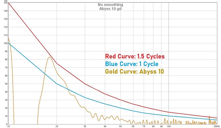

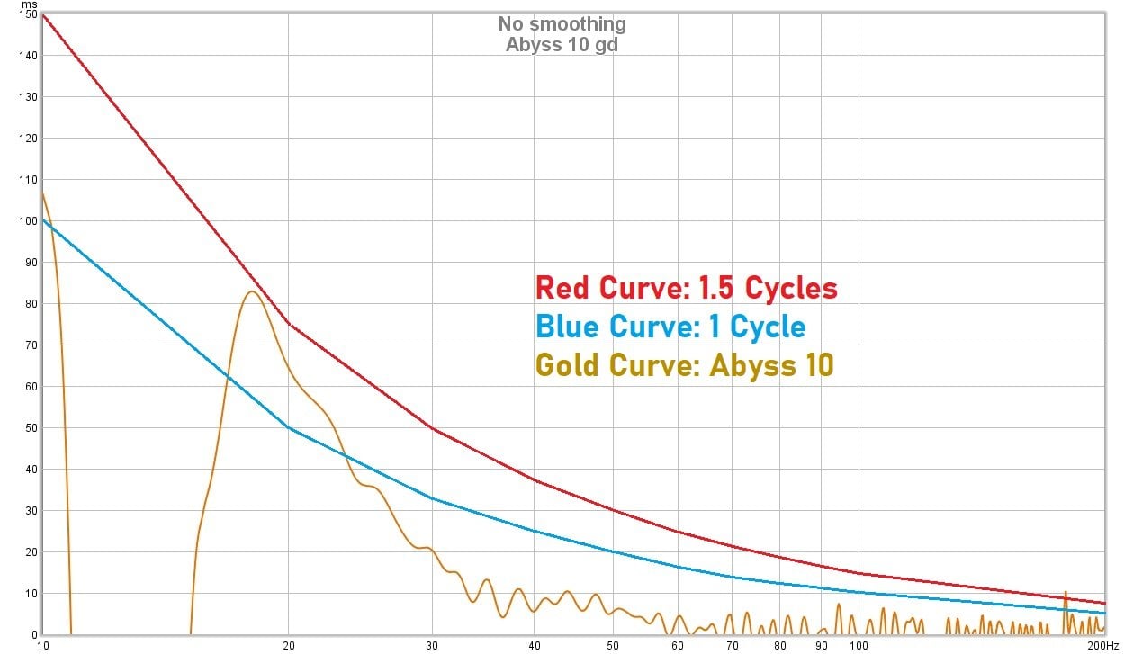

Group delay is the measurement of how much time it takes for individual frequency bands of an input signal to be produced by the speaker. It can indicate that some frequency components are developing slower than others or are taking longer to decay. It is generally thought that 1.5 sound cycles are needed for group delay to be audible at bass frequencies, although there is an argument that group delay should remain under 20ms to be completely unnoticeable, but that is likely meant for mid and upper bass frequencies.
The group delay for the Abyss 10 is exceptional, especially for a subwoofer that uses passive radiators. Above 40Hz, delay stays under 10ms, and between 30Hz to 40Hz, it does not rise above 20ms. Below that, human hearing sensitivity is fairly poor, and most of the reproduced sounds in that range are effects noises, so it doesn’t matter as much. In the frequency bandwidth of common music, the Abyss 10 is as sharp as a tack. This was reflected in my own listening to the subwoofer; I had no complaints about its acuity.

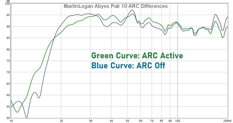

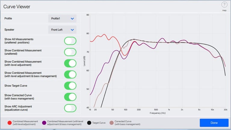

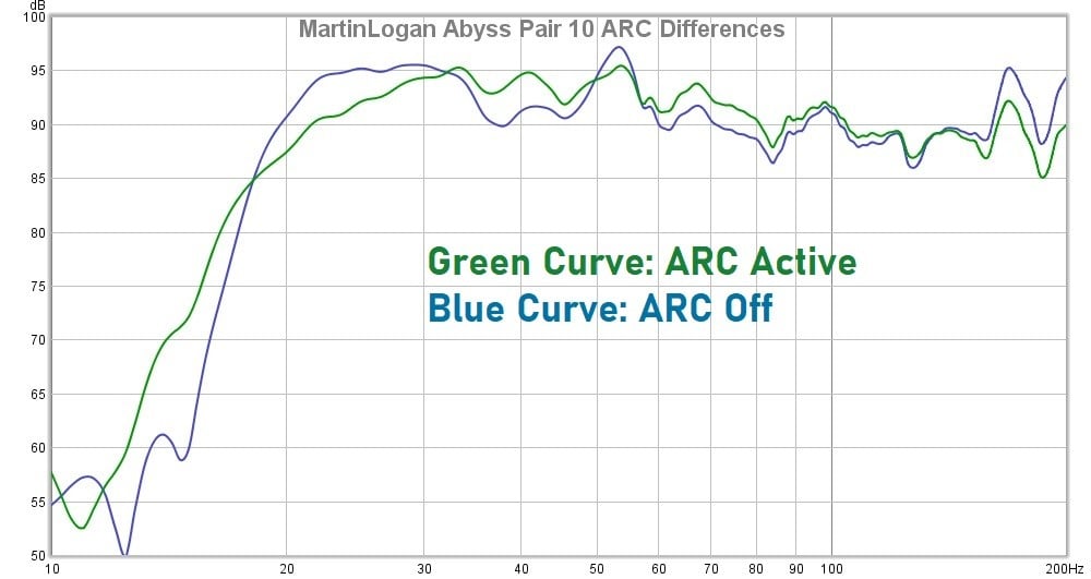

The above graph is the in-room frequency response I measured with and without ARC active. Each curve is an average of five positions. Activating ARC led to an audibly improved response, and this is borne out by the in-room measurements. ARC’s equalization led to a more even response and a more balanced sound across all listening positions. Peaks were tempered and dips were shored up. In fact, I would say the audible improvement that I experienced was better than one would guess from looking at this graph. It should be noted that this graph was taken using both Abyss 10 subwoofers. A single subwoofer would be tougher for any equalization system to handle. But this leads us to one of the advantages of the Abyss 10; it is relatively small, so it makes multi-subwoofer systems much more feasible- if your budget can handle that.
