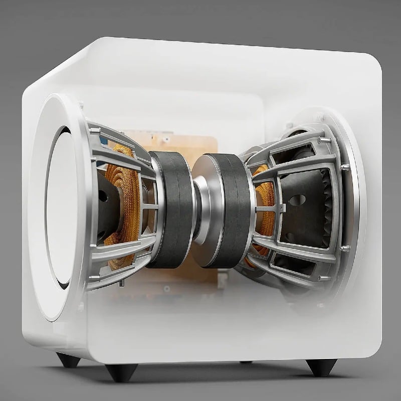

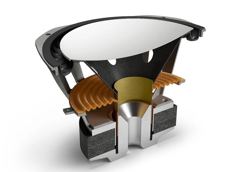

The KC92’s force-cancelling drivers incorporate KEF’s patent-pending P-Flex Surrounds, reportedly inspired by the Japanese art of origami. They use pleats in the surround material (similar to origami folds) to defy internal air pressure and allow the driver to move more precisely in response to the audio signal without sacrificing sensitivity, according to the company. The results are said to be deeper bass extension and more detailed bass reproduction with high linearity and vanishingly-low distortion, regardless of the volume level.

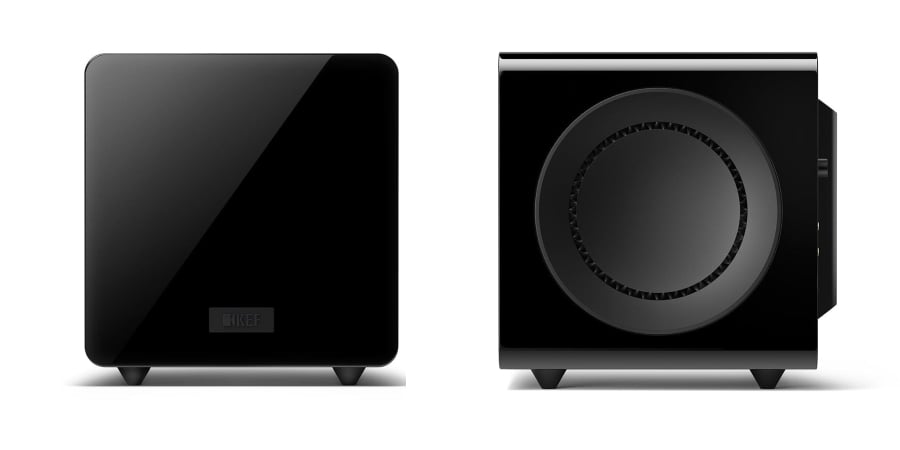

excursion characteristics.” The sub’s cabinet measures just 13.88 inches tall,
13 inches wide, and 14.19 inches deep. Inside, there are two 9-inch drivers
that use a concave aluminum skin to strengthen a paper cone. The vented voice
coils and enlarged motor systems are arranged back-to-back, reducing cabinet
vibration for maximal
