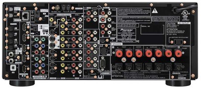

Audio Inputs: 7.1 multi-channel inputs, 6 assignable digital inputs (4 optical, 2 coaxial), 8 analog inputs
Audio Outputs: 2 optical digital outputs, multi-zone stereo pre-amp level audio outputs, 7.1 preamp outputs
Additional Connections: RS-232C port for third party control Systems, remote I/O ports, 2 assignable +12V triggers

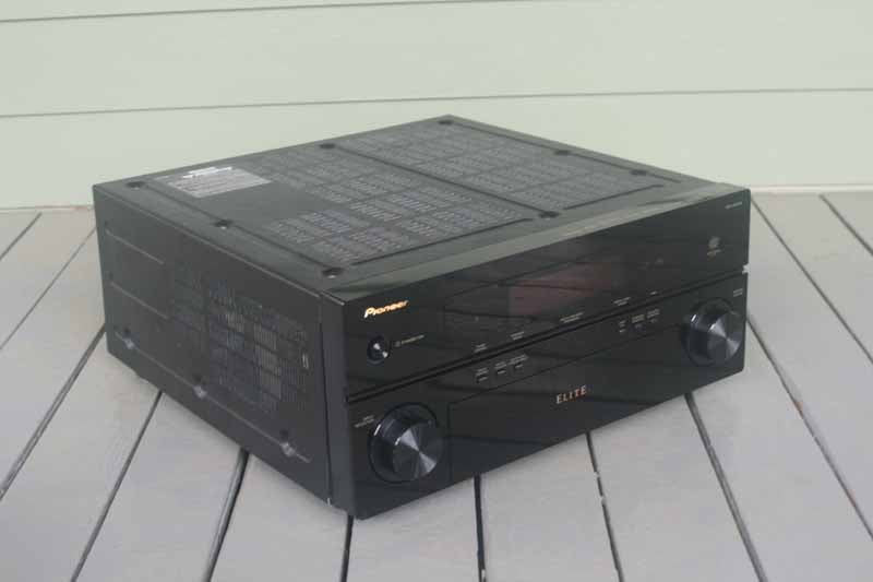

VSX-94TXH Introduction
The last Pioneer receiver review I personally did was in 2005 on an entry-level product (the VSX-815) which struck me as a good balance between available features and power. It will seem pretty obvious when I say that this flagship Elite AV receiver product trumps my last experience by quite a bit. It also, however brings a certain amount of expectation. Being a top of the line model, the VSX-94TXH has a lot of competition and is going to need to distance itself in some areas before being crowned the leader in any particular department.
