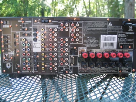

As you can see from the specifications above, there are a ton of inputs on this receiver. Three component, three HDMI, four optical, two coaxial, and a set of 7.1 analogue inputs... the list goes on. The unit is XM-ready and can be connected to your iPod with an included cable. At the time of this review I had what can only be described as an obscene number of products in-house to test with. I had no problem connecting everything I needed with plenty of room to grow. The three HDMI inputs are more than any but the most gear-happy users will ever need. One thing that I really liked is how much room there was between the speaker terminals. If you were going to attach your speakers via bare wire, I felt like you'd have a lot more room to get your hands in there to feed in the wire.

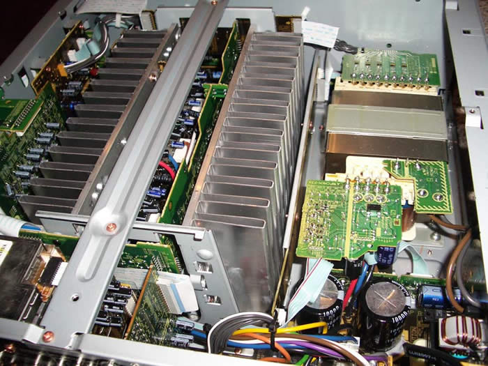

![pioneerinside.jpg](pioneerinside.jpg/image_mini)
The Pioneer VSX-82TXS houses a 690VA Transformer, two 10,000uF 71V caps which is a fairly robust power supply for a receiver in this price class. 60V caps would have been sufficient to yield 130wpc power figure this receiver boasts, but its nice to see they have some design margin which ensures the caps will never be in an over voltage situation even if the voltage fluctuates dramatically during a high line condition. Taking this receiver apart was a bit of a pain thanks to its 21 chassis screws. I was starting to think this receiver was HEMP hardened to withstand a nuclear pulse.

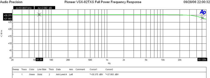

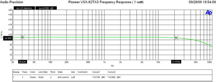

Power Bandwidth
The Pioneer VSX-82TXS possesses a wide bandwidth amplifier topology with a -3dB point in excess of 85kHz.
At full continuous unclipped power (166wpc x 1; 8 ohms, 138wpc x 2; 8 ohms - full bandwidth with less than 0.1% THD+N), the Pioneer VSX-82TXS still maintained good bandwidth linearity with a -3dB point of 51kHz despite we were driving the receiver way beyond its rated 130wpc power specification. Into 4 ohms, the VSX-82TXS was able to deliver continuous power levels at a whopping 235wpc x 1 and 190wpc x 2 with less than 0.1% THD + N. The amplifier section of this receiver is conservatively rated. Kudos to Pioneer.
Keep in mind most review publications don't do continuous power measurements and they usually publish power measurements into clipping at 1% THD + N. Our measurements are very conservative and it is clear that this receiver is a true workhorse for its asking price.

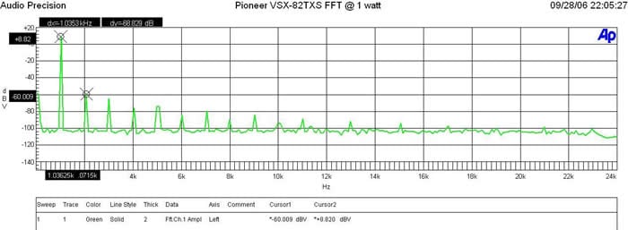

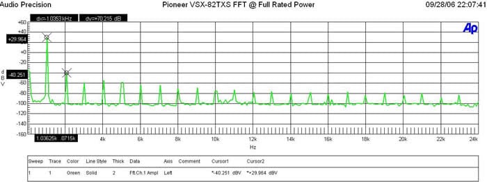

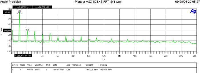

FFT Distortion Analysis
At 1 watt into 8 ohms, the PA350B exhibited impressively low distortion (8.82+ 60.009)dBv = 68.83dBV or 100*alog^-1(-68.83/20) = .04% THD + N which is clean as expected but not as stellar as similarly priced units we've tested in the past including the budget Yamaha RX-V659.
(29.964 + 40.251)dBv = 70.22dBv or 100*alog^-1(-70.22/20) = .03% THD + N which is still quite good and indicative that this receiver can deliver more juice beyond its power rating.

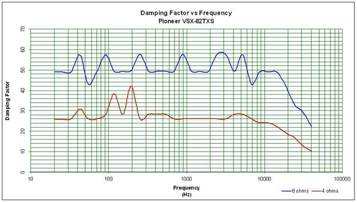

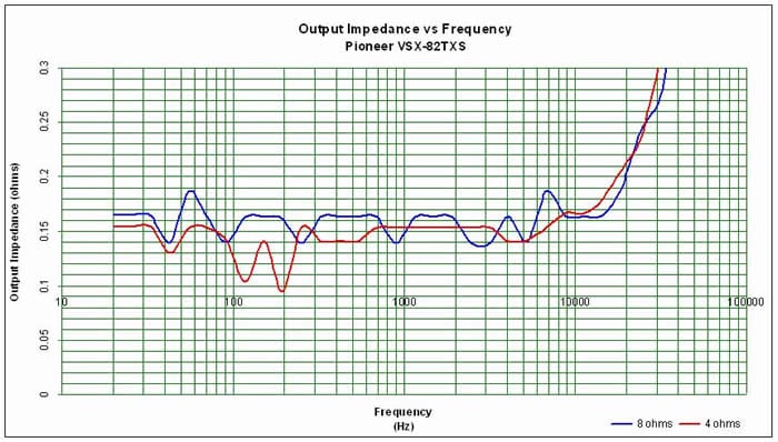

Amplifier Output Impedance & Damping Factor
The amplifier output impedance was around 150mohms (a bit higher than our desirable 100mohm or less mark) for the entire audible bandwidth up to 10kHz with sharp increase above at the upper 20kHz frequency range. This is good performance for an A/V receiver though not quite as stellar as we've seen in similarly priced units from the likes of Denon and Yamaha.
The amplifier damping factor is about what I expected based on the measured output impedance. It is uniformly good across the entire audio frequency range just barely meets our 50 mark for an 8 ohm load we like to see as a minimal requirement for receivers. All in all, it's a good measurement and this receiver will likely be able to consistently drive a wide range of loudspeakers with good results. We do suggest sticking with speakers that don't dip below 3 ohms for best results.
