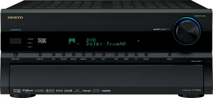

DSC02591.JPGThe Onkyo TX-SR805 receiver is a larger receiver, at a height of 7 5/8” and weighing in at over 50 pounds, it is a bit heftier than many run of the mill midrange components. Actually, at its asking price, the TX-SR805 outweighs other competitive receivers by about 10 lbs, an increase of 125% over the typical weight.

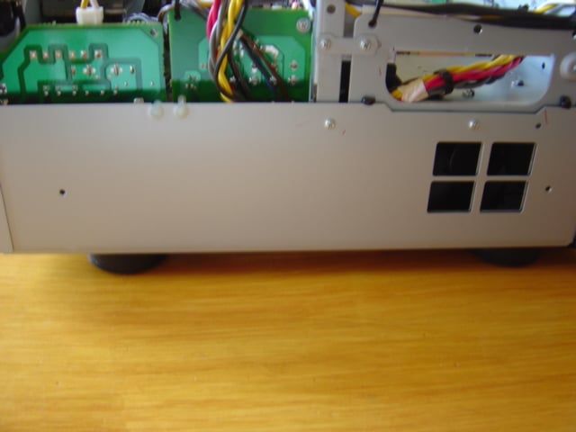

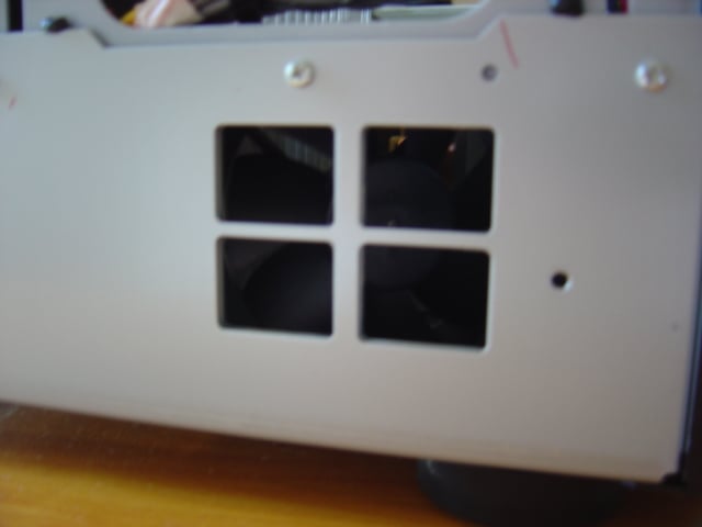

The chassis is constructed of typical light gage steel but with a relatively thick-brushed aluminum faceplate, again by receiver standards, and is available in a black or a silver finish. The sample sent for the review was the black model.

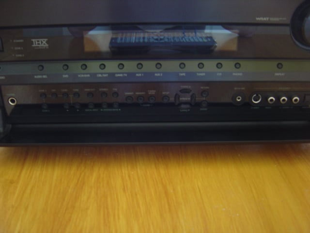

DSC02598.JPGThe front panel is clean, with most of the controls tucked away behind an aluminum foldout door secured with the typical push type latch. The general appearance has been updated some in the last few years since the 602 was current. The recessed volume knob is backlit with a very nice cobalt blue that is adjustable as part of the front panel dimmer/off function. Unfortunately, the front text display does not use the same color, instead going with a bluish green that is an odd match.

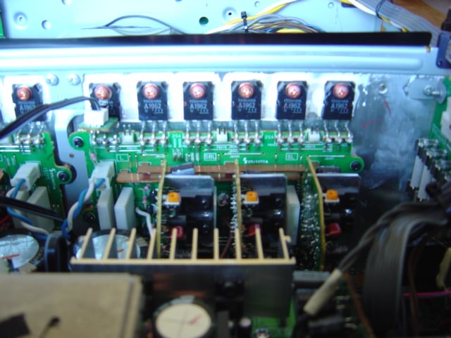

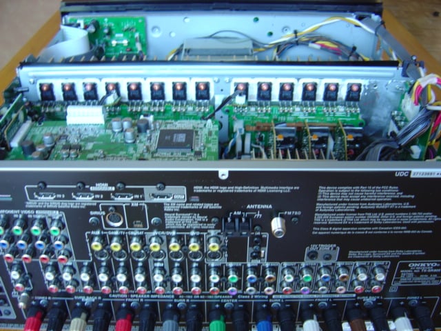

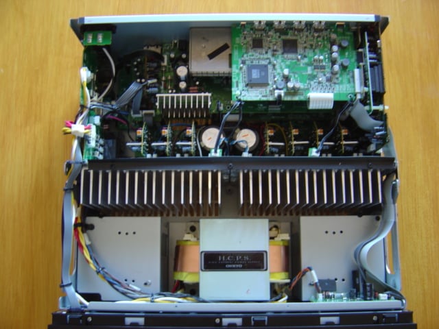

Upon removing the top cover, we see that cover steel gage is slightly thicker than DSC02592.JPGtypical and that the chassis is still sturdy even without it. The sides of the chassis interior have full length, half height side panels that provide frame continuity to the front and back panels. The heat sink and front panel are connected with an additional full height frame also connected to the side panel, which provides additional rigidity for the weight of the transformer.

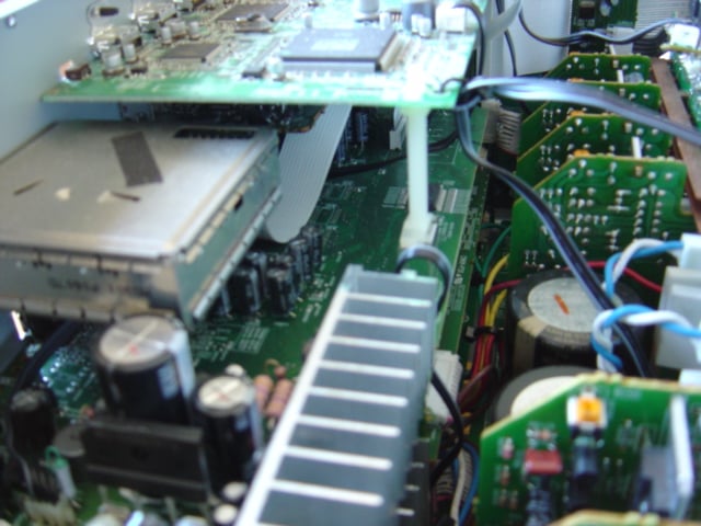

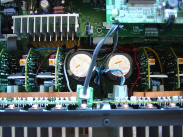

Inside, the Onkyo TX-SR805 is densely packed but very cleanly laid out, with a minimum of wire bundles strung across the inside of the chassis unlike some receivers that I have seen. The main power run is routed to the transformer along DSC02599.JPGthe left side panel, but other than a few other short wire runs and some short runs of computer styled ribbon cable there is very little in the way of cabling spaghetti. Short, clean internal cabling runs suggests a well thought out component arrangement where every circuit is near to where it is supposed to be in order to do its part along the chain. It suggests, to me, that perhaps this Onkyo receiver was a little more carefully designed than other competing products.

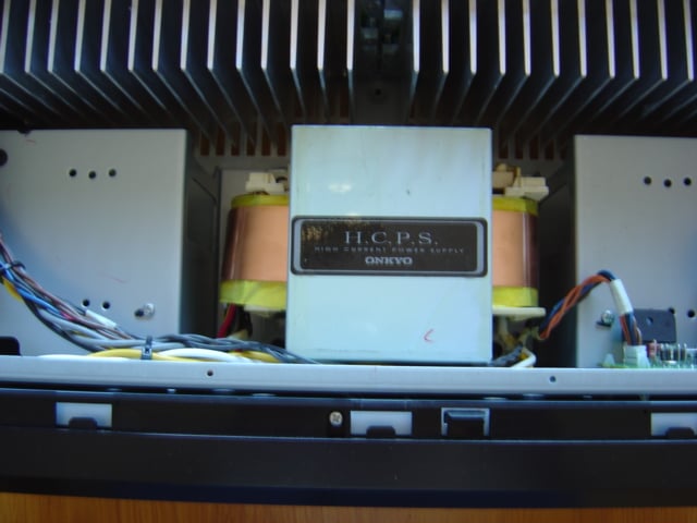

Centered at the front is a large EI core transformer that is separated from the rest DSC02593.JPGof the circuitry by a full width machined aluminum heat sink. The main transformer is flanked by two light gage housings that mount 80 mm exhaust fans with vents at the front of each side panel.

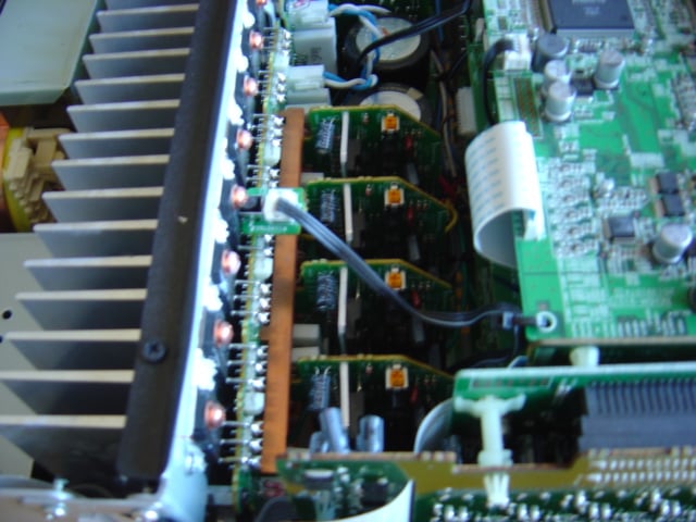

Coupled to the back of the heat sink are seven discrete amplifier boards for the power output stage. Nestled in between the amplifier boards is a pair of decent sized main power supply capacitors.
The back third of the housing is occupied by the input, output, and processing circuit boards. These boards consist of a discrete digital a/v board at the HDMI DSC02600.JPGinputs, a digital audio board at the coax/toslink inputs, a shielded board for the radio inputs, an analog a/v input board with a supplementary aluminum heat sink, and power supply input boards at the left.
The power amplifier design of the TX-SR805 is a discrete dual push-pull configuration for which Onkyo received THX Ultra2 certification. Amplifier distortion is controlled with a three stage inverted Darlington circuit and the TX-SR805 boasts a 110 dB S/N ratio at full power. Onkyo claims the amplifier section is rated to drive 4 ohm speaker loads and is said to be capable of 60 amps of instantaneous current.
As I have said previously, the power supply of the TX-SR805 is unusually beefy for this price range and there is no other receiver on the market near this price that features a THX Ultra2 certified amplifier section. The power feed is supplied at the rear left corner and is protected by a main power supply fuse that is rated 12A at 125V, allowing a maximum outlet draw of P = 12A x 125V = 1500W. The seven amplified channels of the TX-SR805 are rated to output 130W each providing a potential momentary output total of 910W. The aforementioned main power supply capacitors are of Onkyo manufacture with 2 x 15000F at 71V that allows plenty of headroom for the rail voltage.

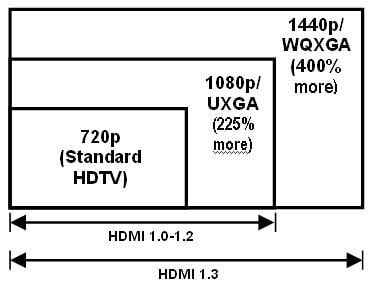

The TX-SR805 features full HDMI 1.3a audio and video functionality. Signal bandwidth supports 1080p60 video and 36 bit Deep Color. Audio support is provided for bit rates of all the next generation codecs, DD+, DTHD, DTS HD, DTS MA, and uncompressed multi-channel LPCM. The TX-SR805 has three HDMI inputs as well as an output with an HDMI repeater to allow greater cable run lengths.

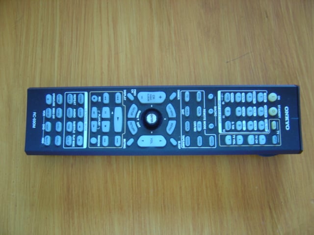

DSC02611.JPGThe remote control is a standard Onkyo design that has been in use at least since the TX-SRxx2 generation, it is identical to what I recall of my TX-SR602 remote. It has a fairly standard feature set typical of most A/V receiver remotes. In addition to the obvious, it has programmable universal remote capability via a host of remote codes for various manufacturers and supports three programmable macros.

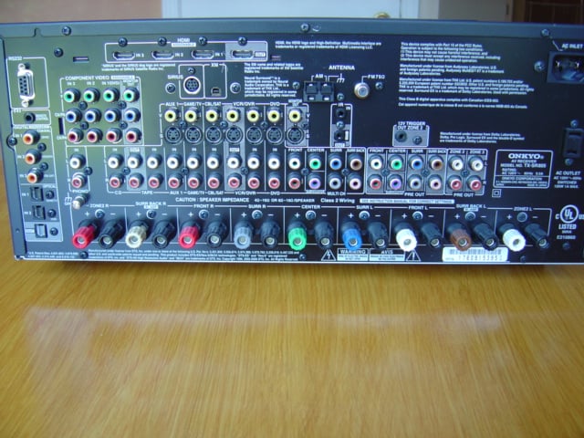

The rear panel is relatively well laid out with connections grouped together by purpose. Digital connections are located around the periphery with HDMI at the top and digital audio to the left side of the panel. Component video in/out grouped in a separate bank, standard analog audio/video connections arrayed down the middle from left to right, followed by analog multi-channel in, out, and zone 2/3 out. The digital and analog radio connections are centered above the A/V connections. The binding posts for speaker termination are aligned across the bottom. The detachable power cord and a single switched outlet are at the opposite side from the digital audio connections. Each grouping of connectors is labeled and enclosed in a white box and outputs are differentiated from inputs by white hatching inside the boxes for easier viewing when one has to crane ones head around to the back of the unit after initial installation to make any subsequent wiring revisions.
The only hitch that occurred during physical setup was that the TX-SR805, unlike my reference Rotel, only had a single RCA subwoofer out connection. A slight annoyance, the remedy was to use a monaural RCA splitter. Output for dual subwoofers really should be a minimum on all receivers, and certainly on a receiver mindful enough of room acoustics that it incorporates active room correction like Audyssey.

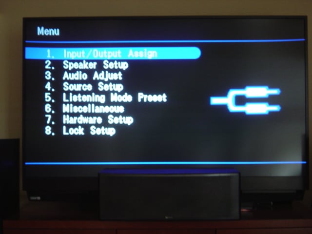

Once the physical setup is complete, setup for the electronics is the next step. The users manual includes a section titled ‘Up and Running in a Few Easy Steps’ which suggests the automatic speaker setup and the onscreen display (OSD) running as the place to start for quickest path to usable operation.

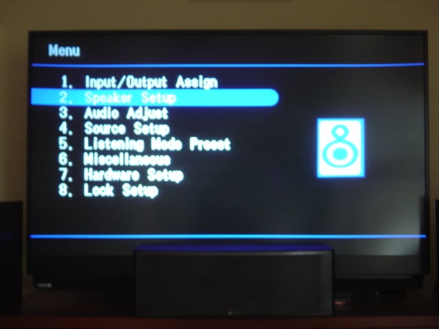

Input MenuTo get the OSD running, the first step is to consider the video connection used for the main monitor: HDMI, component, S-video, or composite video, and set the output mode using the switch labeled HDMI OUT under the front flap. Repeatedly pressing this button will cycle through these alternates while the TX-SR805’s front LED display shows the current setting if the default does not match the current monitor connection. While it is possible to run through the setup using only the front display, getting the OSD going is really the best place to begin.

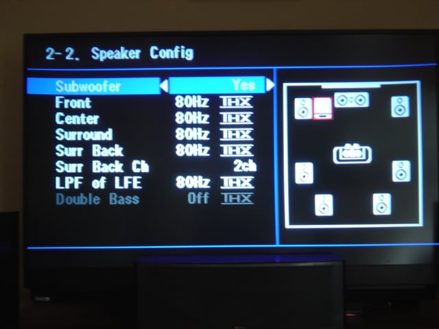

Next up is speaker setup, which runs as part of the Audyssey EQ calibration. This feature activates automatically when the included microphone is inserted into the jack under the front flap. Follow the instructions, locate the microphone at ear height in the primary seating location and the TX-SR805 will cycle through a series of chirps for each speaker in turn, clockwise around the connected array. The first pass serves as the setup point for all the levels, delays, and crossover points as well as the first point for the Audyssey room acoustics correction. When complete, the user will be prompted either to run another test or to proceed to the calculations. The Audyssey correction feature will accept up to eight test points in a room, at which point, the receiver will automatically begin calculations for the speaker setup and the correction filter.
Speaker MenuIf, for any larger home theaters, eight listening positions are not enough, a little planning of measurement points is the best advice to maximize benefits. Try to use no more than 5-6 points to define the perimeter and the remainder for interior points considering where best to place these points in the room relative to the particular seating arrangement.
Initially, I chose to setup the receiver manually using settings I was familiar with from my reference receiver. The intent was to avoid engaging the Audyssey EQ, which also runs the setup routine, so that I could become familiar with the sound of the receiver itself, before evaluating the quality of the onboard acoustics correction.
The setup menus, which are laid out logically and orderly in the user manual, are cross referenced with the various submenus and commands. I found it easy to go through the entire setup manually. The only setup hitch I found was with the crossover settings where I was unable to decrease the subwoofer low pass filter below the THX recommended 80Hz even though I could set all of the other high pass filters below this value.
Odd, so I checked the user’s manual to find that the LFE low pass filter only supports four settings: 80, 90, 100, and 120 Hz.
The high frequency channels support high pass settings of 40, 50, 60, 70, 80, 90, 100, 120, 150, and 200Hz. Why Onkyo would not provide the same low pass and high pass filter settings is beyond me but they did.
As a note on LFE setup, I will take issue with certain wording used in Onkyo’s manuals, as well as other manufacturers, to describe how to set main speakers appropriately for use with the LFE channel. The manual uses the term ‘full band’ for speakers with a ‘good sized’ woofer that can play bass ‘adequately’ without defining what ‘full band’ is by frequency response. ‘Full band’ is also the terminology in the crossover setting menu that implies the high pass filter is turned off. In the past, the manual for the TX-SR-602 that I owned used the terms ‘large’ or ‘small’ to control the high pass filter and suggested dependence on woofer size, 6 ½” as suggested transition, again without consideration of frequency response of bass driver.
This is confusing to newcomers: main speakers should only be put on settings such as ‘full band’ or ‘large’ if they can go at least as deep as the system subwoofer, and preferably only with true full band speakers able to go down to 20 Hz and are capable of sustaining the high SPL levels required of an LFE channel. Even then, overall system dynamic range will generally benefit from shifting the LFE burden from the main receiver/power amplifiers to the dedicated amplifiers in the subwoofer.
Speaker ConfigRegardless of the choice to use automatic setup or manual, owners of any system with an automatic setup routine are advised to go into the setup menus and manually verify the speaker settings. While automatic setup algorithms have been steadily improving, they are notoriously error prone. Go in, look at the settings, and make sure they make sense, because even good programs make some interesting selections. Case in point with the review receiver, the crossover frequencies were set differently between the surround and surround back channels even though the speakers are identical and there were some wide disparities between level and distance settings for individual speakers. The complexities of bass frequencies and room interaction often make this difficult for automatic setup routines to get correct and the Onkyo users manual points out that THX recommends setting subwoofer levels and distances manually for this very reason.
One other piece of advice while manually checking settings is to make sure that the receiver is set for 8 ohm speaker impedance. The provision of this setting on a receiver is to make Underwriter’s Laboratories happy under certain specific test conditions, but it is nothing more than a choke on output power, irrespective of the actual speaker impedance. As always, make sure the receiver is well ventilated, and if necessary, use active cooling such as a small fan to vent at the heat sinks. I did find that this particular receiver runs hot, so some sort of acoustically controlled active cooling is recommended, especially if the unit is to be installed in a confined space or enclosed cabinet.
Throughout my time with the TX-SR805, the only operational glitch I encountered was related to HDMI. When entering setup, on the fly, during playback from an HDMI source the receiver would sometimes be unable to reestablish signal lock and resume playing. Correcting this required turning the TX-SR805 off and then on again.

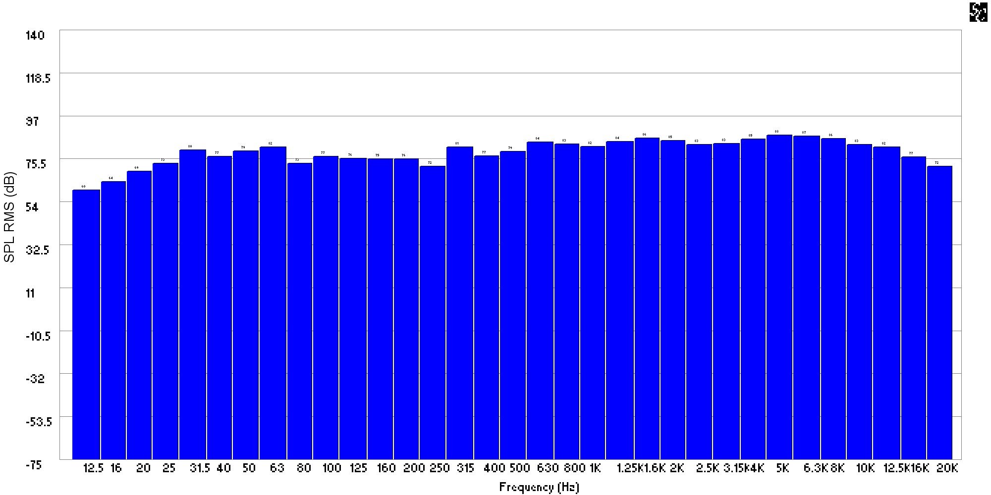

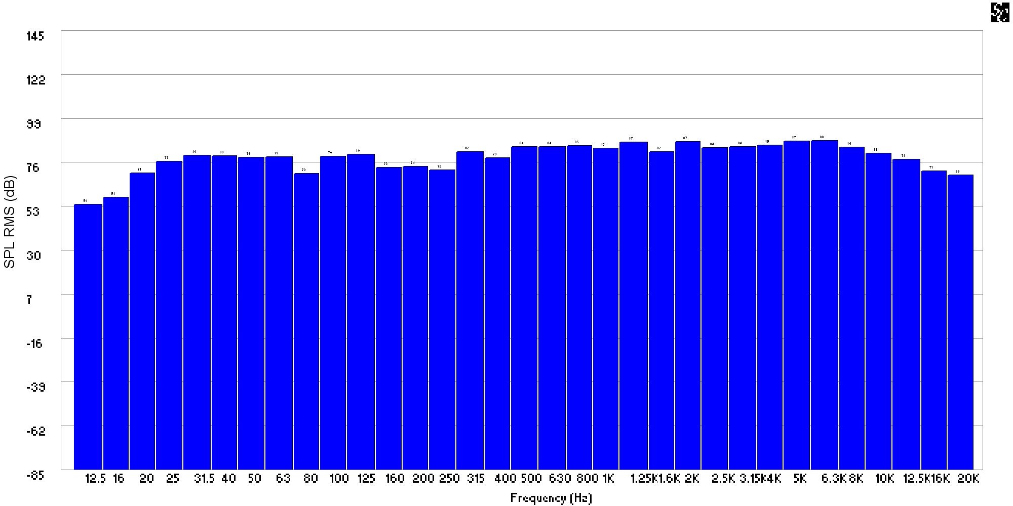

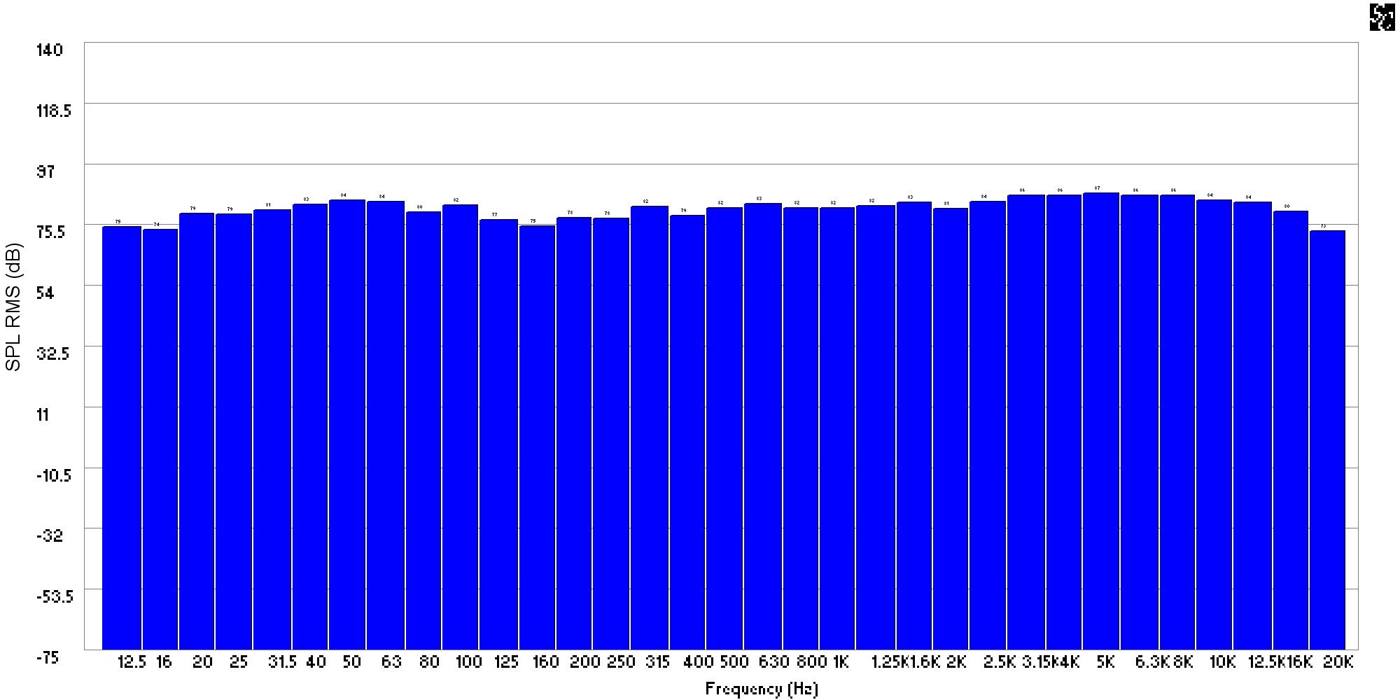

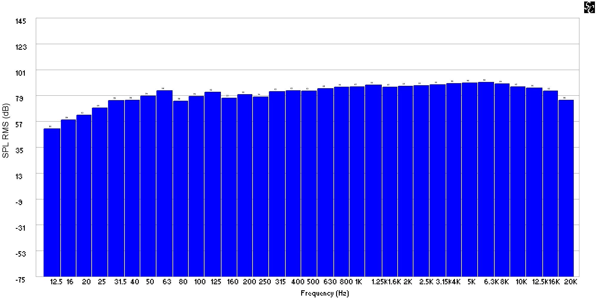

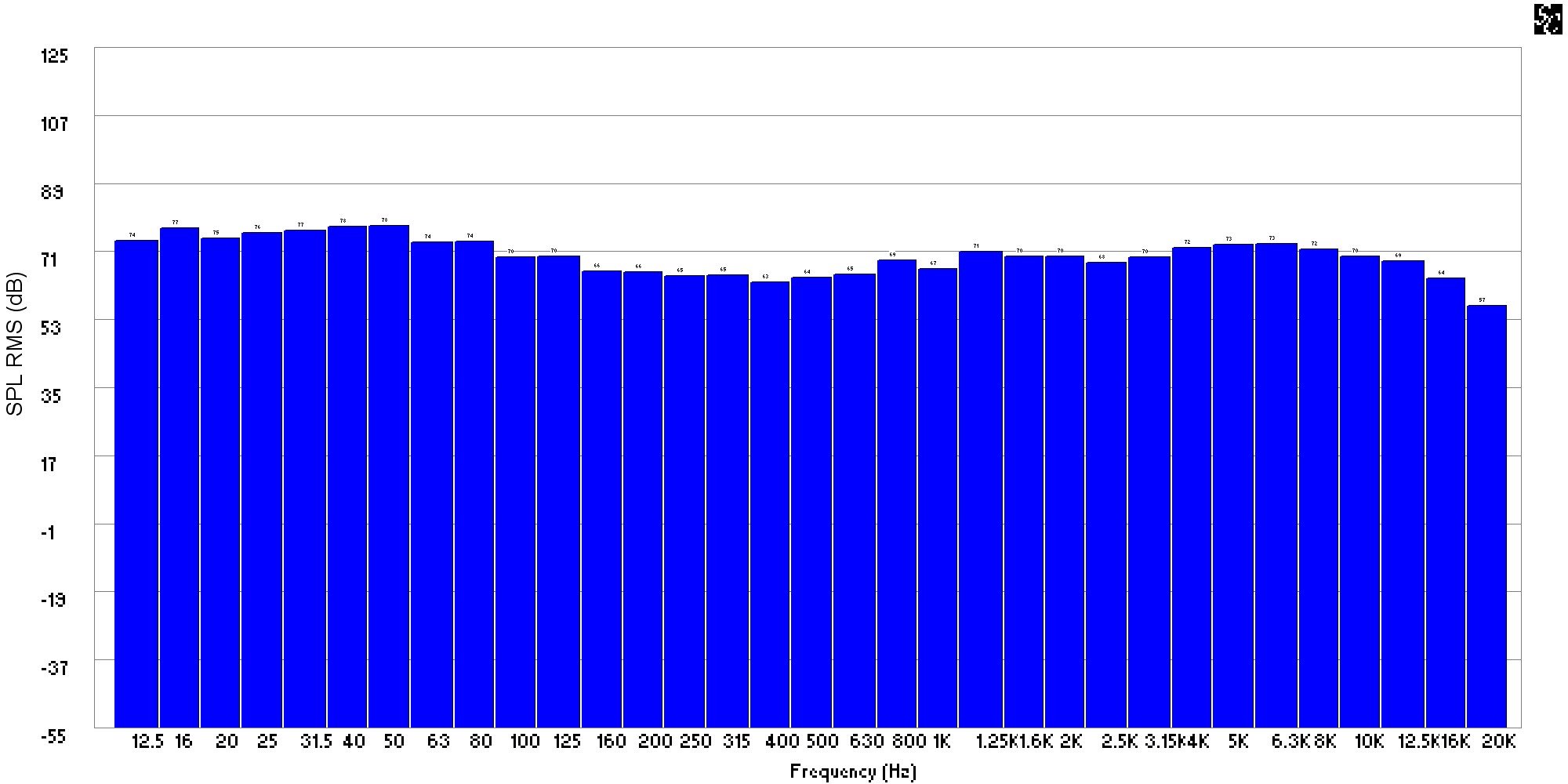

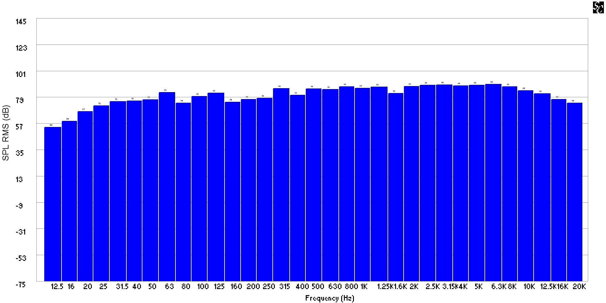

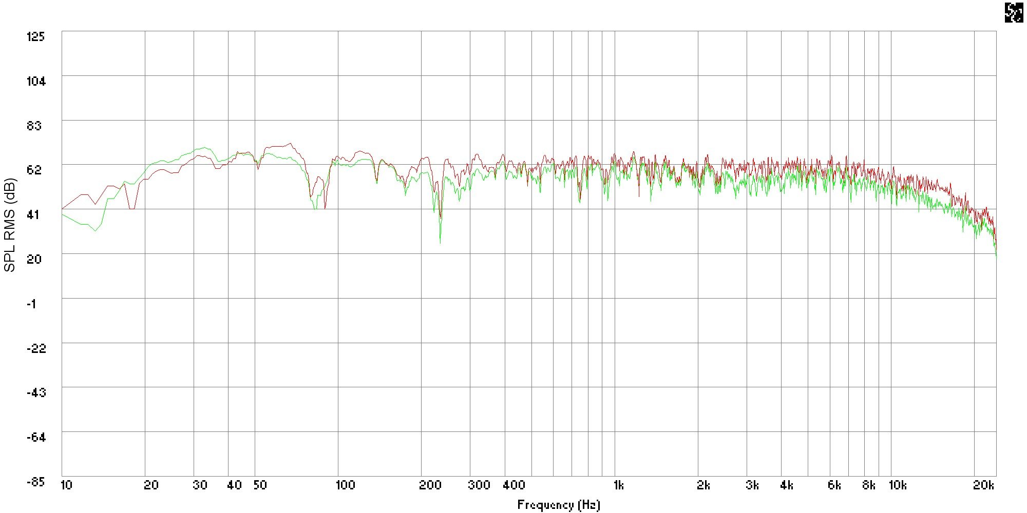

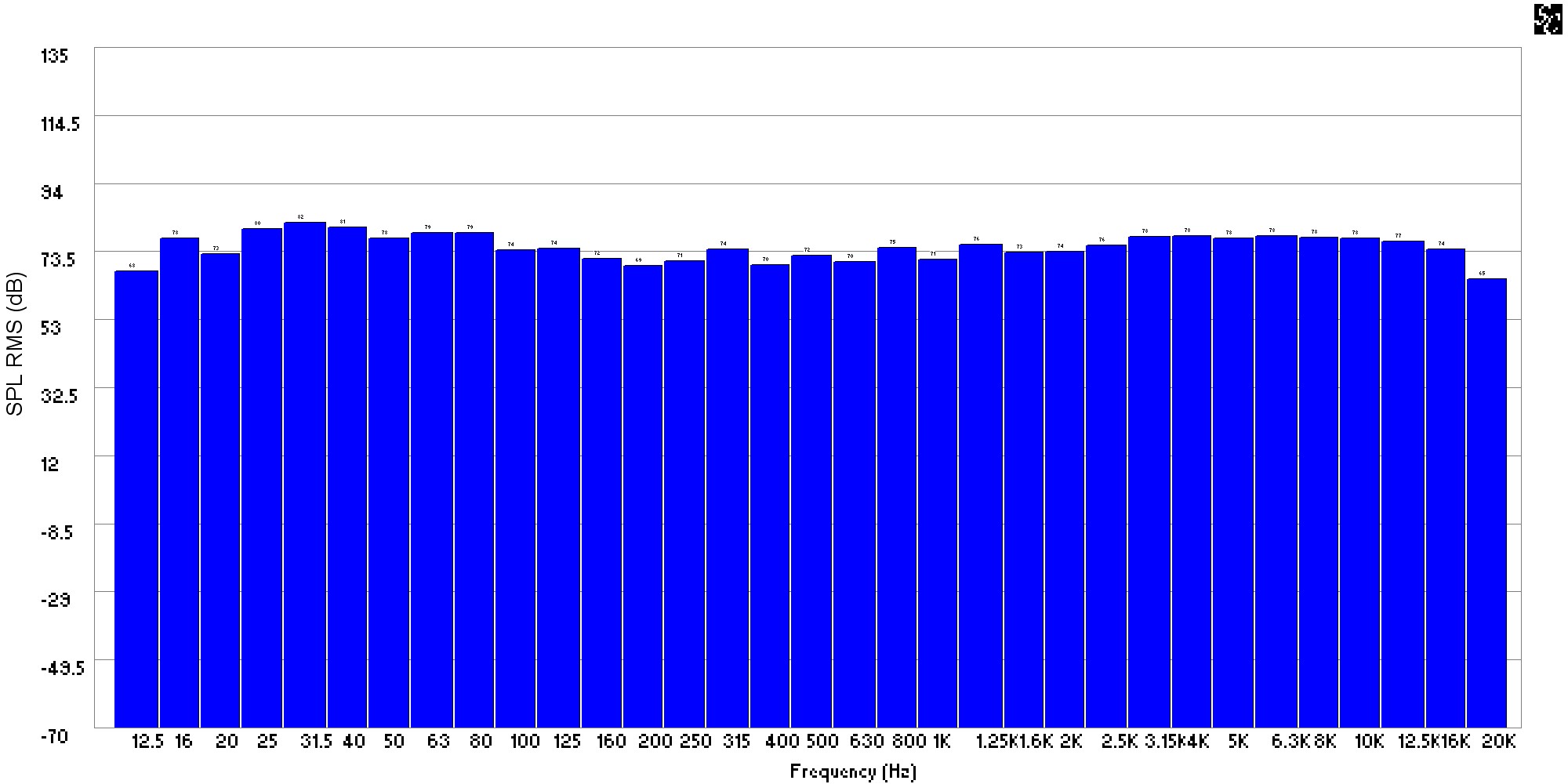

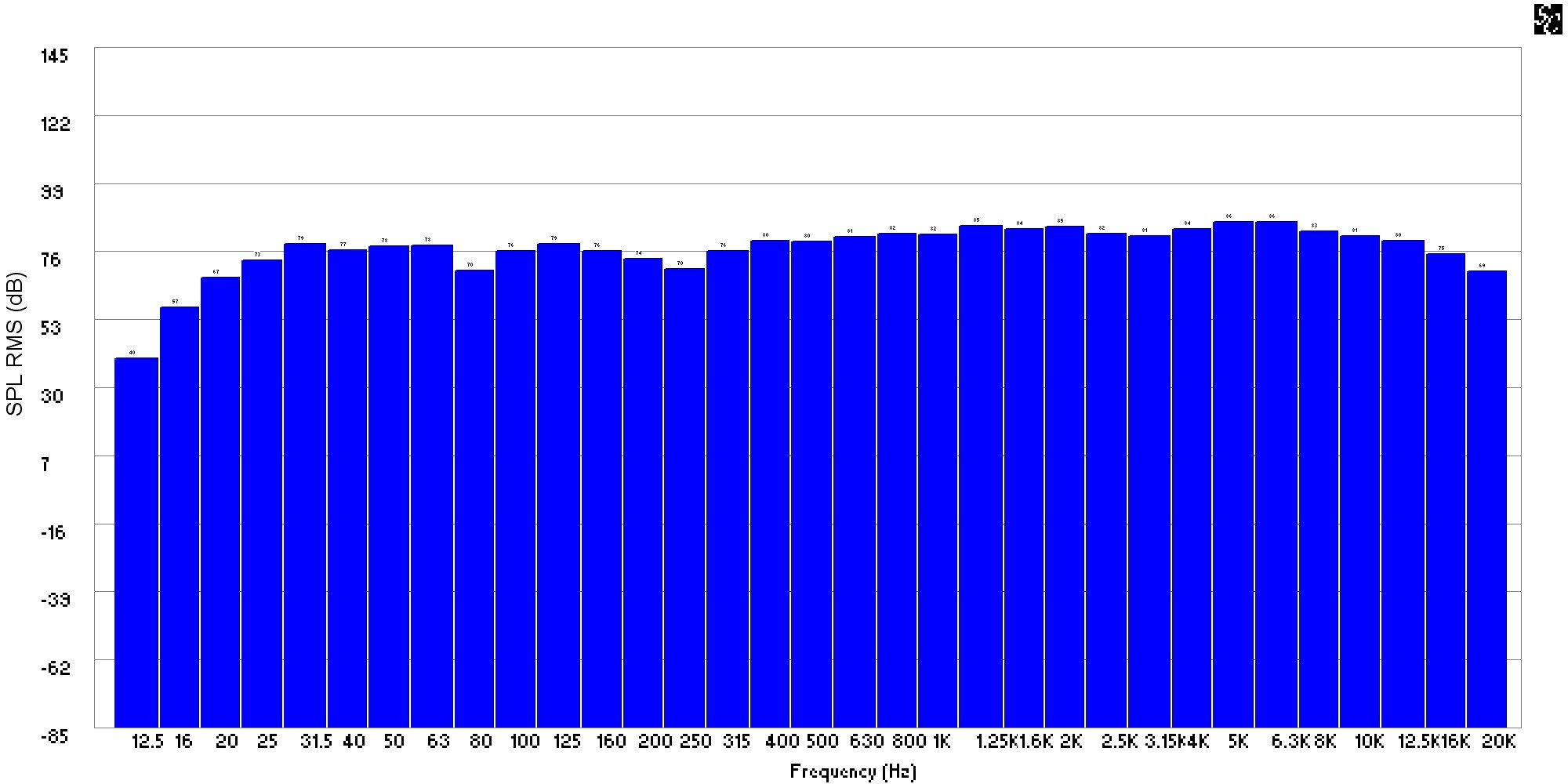

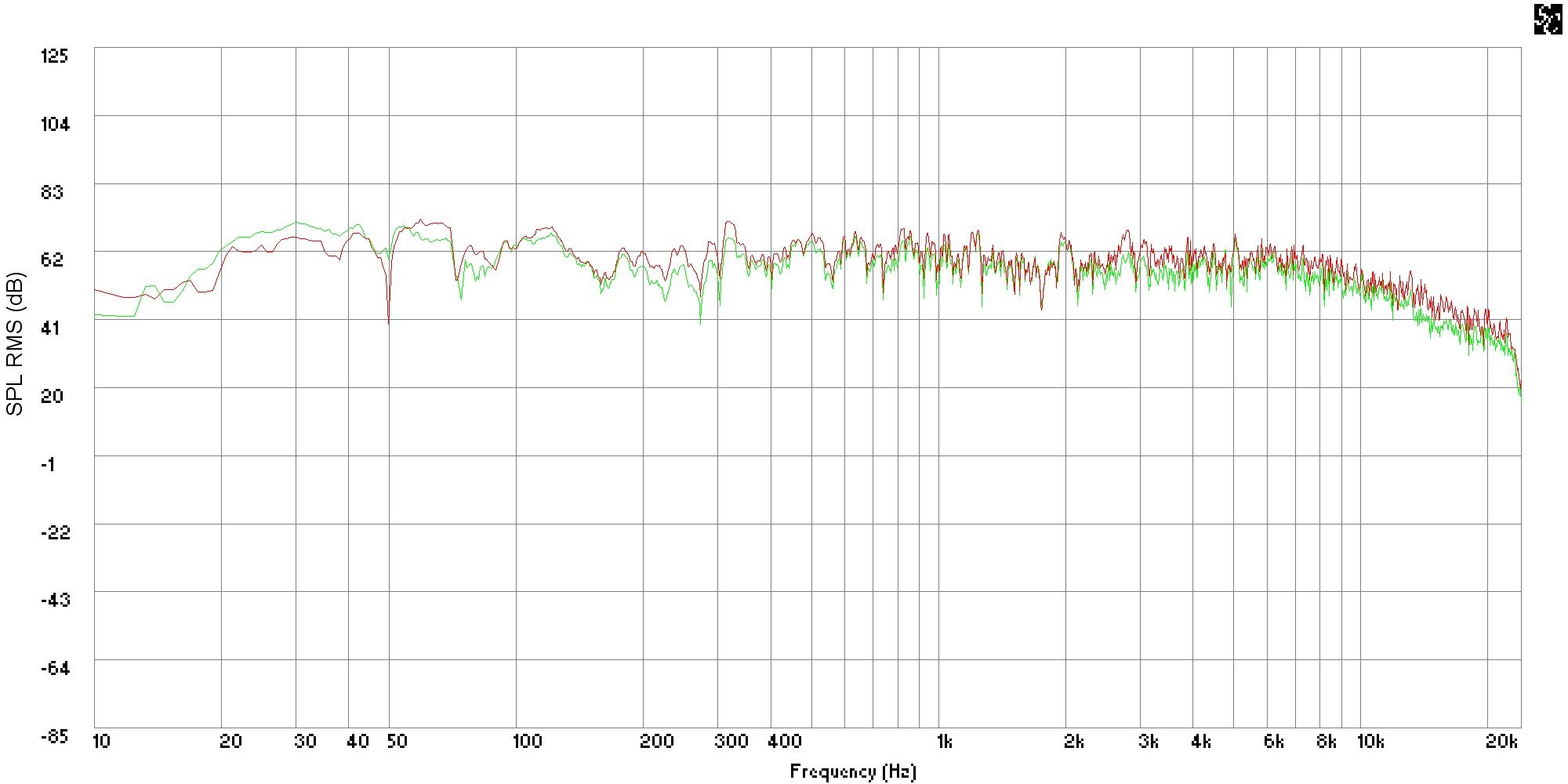

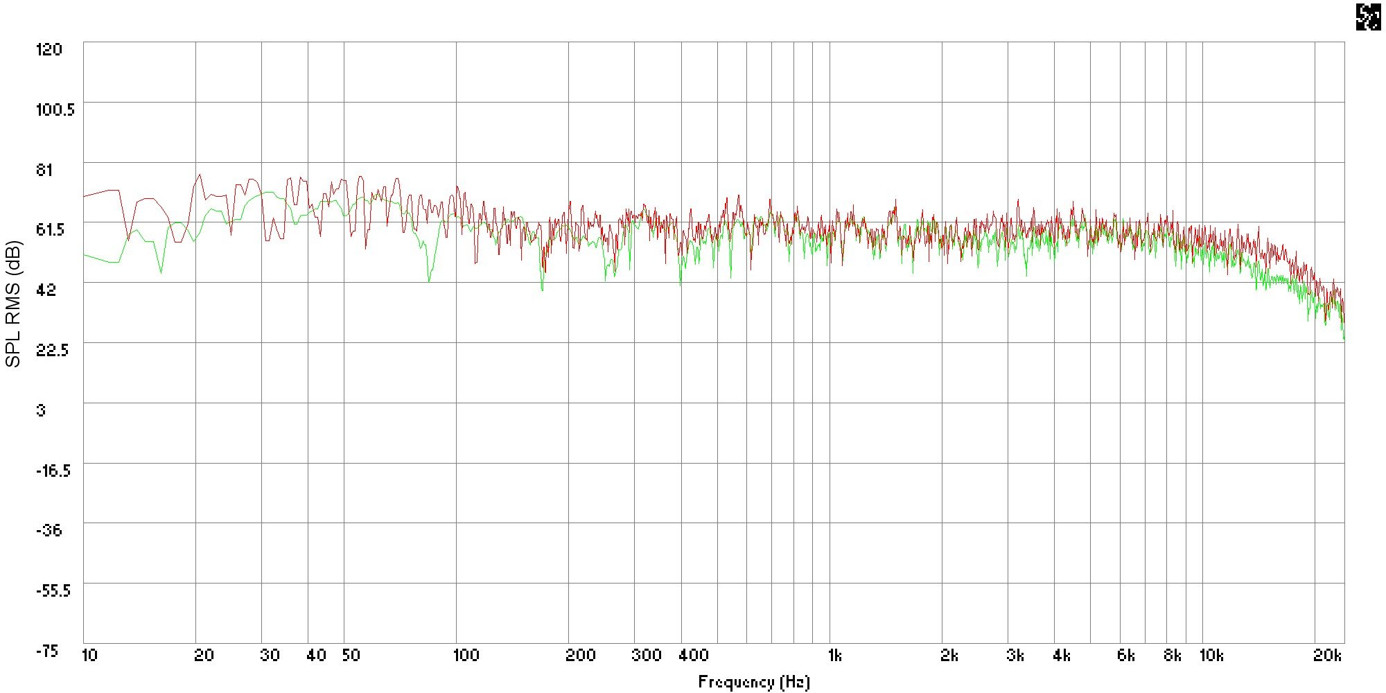

After some time with the receiver au natural, it was time to try out the Audyssey room acoustics correction included with the TX-SR805. Running the setup routine is as easy as plugging in the included test microphone and following some simple steps that mostly involve pressing the enter button on the remote and shutting up until the procedure is finished. Once complete, just about any system should sound better. How much improvement, of course, depends upon the state of the acoustic environment in the room before Audyssey is engaged. Poor acoustical environments will experience improvement that is more drastic and even relatively good environments will still have improvement, as no room is perfect.
With Audyssey engaged, I found some noticeable but not drastic improvements, mainly in terms of sound field solidity. This will be true for any room where some pains have be taken with the physical environment to minimize negative acoustical effects. I found a subtle, but noticeable increase in the coherency of the sound field in general, improved localization and envelopment, as well as improved low level detail. Discrete effects were more focused across the front stage, sound pans tracked more solidly across the field, and diffuse environmental effects more enveloping. The improvements also affected subtle sound effects and quiet sections of music scores, which were more distinct and spatially separated, not jumbled with other sounds when Audyssey was engaged. Improvements to the fullness and solidity of the perceived audio are attributable to controlling comb filtering from room boundary reflections.
One of the more noticeable improvements was that dialog simply sounded more realistic. As a combination of many detracting factors, realistic dialog is always tricky to get right; all too often, actors sound like they are talking out of a box. This can not be corrected in every circumstance, but Audyssey MultEQ XT goes a long way to putting on the finishing touches to get most dialog closer to that most elusive goal of sounding completely natural.

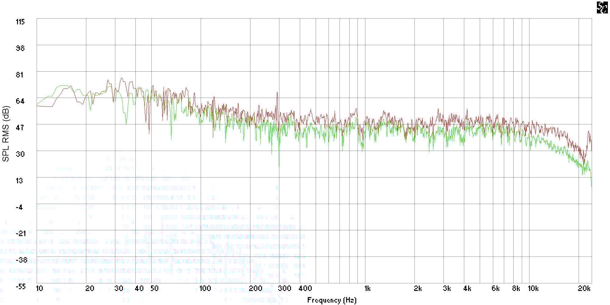

With DTHD and DTS MA capable receivers just coming to market, the configurations of currently available players assume no external decoding capability, so because of this I was unable to test DTHD directly. However, LPCM is inherently lossless meaning that all of these encoding schemes are theoretically identical; the only potential source of difference in the recreated waveform is the possibility of compounding discretization error due to the multiple decoding/encoding steps. Eliminating the additional conversion may prove negligible to the perceptible audio quality, but the potential to introduce unwanted error is always best avoided if possible. The main advantage of the lossless audio codecs like DTHD and DTS MA, now available with HD optical discs, is that they are identical to the studio masters but take up substantially less space than uncompressed LPCM.
Simply put, using lossless audio such as DTHD provides an audibly fuller sound than its lossy Dolby Digital predecessor does, and yet the sound quality is simultaneously more detailed and transparent, making it that much closer to natural sound. The sonic quality also no longer suffers from many of the artifacts that produce flat, lifeless sound reproduction. As a video analogy, many reviewers have cited an increase in the three dimensional illusion in HD video due to better separation of individual images because of improved edge definition; the same is true of the benefits to higher resolution audio.
Generally, I found that Audyssey produced improvements that were most obvious with HD audio sources than with typical DVD audio sources. The explanation likely resides in the fact that this is more detail to be affected by a less than optimal acoustic environment, so that when correct, a greater quantity of detail returned. As I discuss what the TX-SR805 was sonically capable of in the subsequent sections, I will focus on these sorts of improvements when combining a good receiver with HD audio and Audyssey capability.

In room acoustic testing of the TX-SR805 was performed both with and without Audyssey MultiEQ XT engaged for comparison. Audyssey acoustic calibration was generated using eight microphone measurements located at both primary and secondary listening positions as well as throughout the listening area.
Test measurements were then performed at the primary and secondary listening positions for both the left and right main channels at an SPL of 80dB at each listening position. The primary listening position is located approximately centered on the front L/C/R channels and at the approximate center of all calibration settings for time delay. The secondary measurement position is located to the left and forward of the primary position near the room boundary.
Comparisons of the in room frequency response results without and with Audyssey engaged are presented in two forms. First, a high frequency resolution overlay plot in logarithmic scale of both conditions is provided. The second form is a side by side comparison of frequency response without and with Audyssey engaged plotted at 1/3 octave bands. The 1/3 octave band plots consider the commonly accepted limits of human hearing to differentiate relative frequency variation and thus are more representative of the changes one might actually hear.
Figure 1: Overlay of front left channel at primary position with/without Audyssey
Figure 2: Overlay of front left channel at secondary position with/without Audyssey
Figure 3: Overlay of front right channel at primary position with/without Audyssey
Figure 4: Overlay of front right channel at secondary position with/without Audyssey
Figures 1 through 4 show the high resolution plots for each measurement position and speaker. Typically, all the plots show correction in the high frequency range where room absorption pulled the curve below the Audyssey calibration curve. We also see a general flattening out of response through the midrange and into the bass regions. The most dramatic change is in the left channel at the secondary position, also at the left of the room, where Audyssey made attempt to adjust the curve for room boundary gain in the bass region and balance it with the midrange and treble. It is here that we also see the greatest treble roll off correction.
Front Left Primary w_o Aud at 80 dB (octave_3).jpg     Front Left Primary with Aud at 80 dB (octave_3).jpg
Figure 5: 1/3 Octave frequency response without and with Audyssey of the left front channel at the primary position
Front Left Secondary w_o Aud at 80 dB (octave_3).jpg     Front Left Secondary with Aud at 80 dB (octave_3).jpg
Figure 6: 1/3 Octave frequency response without and with Audyssey of the left front channel at the secondary position
Front Right Primary w_o Aud at 80 dB (octave_3).jpg     Front Right Primary with Aud at 80 dB (octave_3).jpg
Figure 7: 1/3 Octave frequency response without and with Audyssey of the right front channel at the primary position
Front Right Secondary w_o Aud at 80 dB (octave_3).jpg     Front Right Secondary with Aud at 80 dB (octave_3).jpg
Figure 8: 1/3 Octave frequency response without and with Audyssey of the right front channel at the secondary position
The frequency response curves in Figures 5 through 8, plotted in 1/3 octave bands, show the changes without Audyssey engaged and with Audyssey engaged, respectively, for each channel and at each listening position. From these plots, the general smoothing trend with Audyssey applied can be more easily discerned. General changes in curve shape are consistent with the previous observations from the high resolution plots.
One additional item to note when using Audyssey, because it also corrects phase errors, frequency response alone will not tell the whole story. Flattened frequency response is responsible for some of the improved perception of more balanced and fuller sound, but it is the improvements in phase coherency that lead to improved imaging, focus, and envelopment in the surround sound field.
