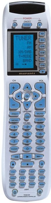

  • Remote: EL backlighting pre-programmed/learning remote

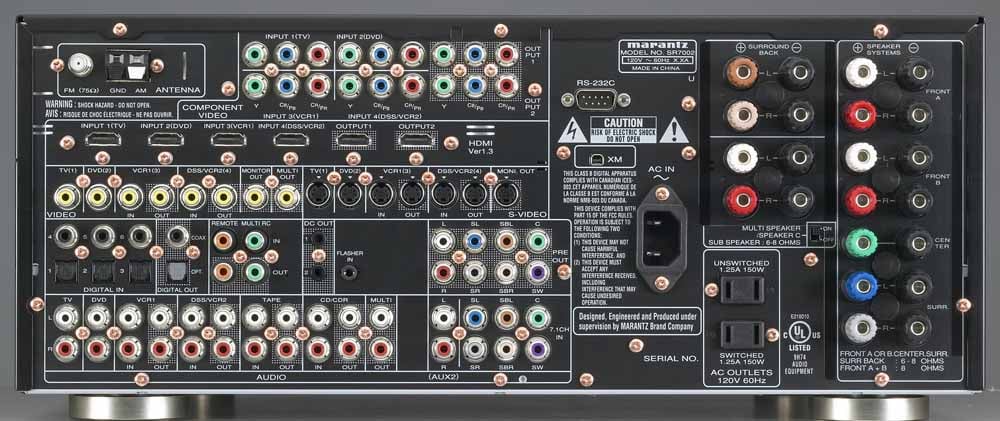

  • Video Inputs: 4 x HDMI (1.3); 3 x Component Video (100MHz); 7 sets composite and S-video inputs
  • Video Outputs: 100MHz Component video output, 3 composite and s-video outputs, Multi-Zone composite video output
  • Audio Inputs: 7.1 external wide bandwidth (100 kHz) multi-channel inputs, 5/7 Channel Stereo, DENON Link 3rd (SACD & DVD-Audio compatible), 7 assignable digital inputs (5 optical, 2 coaxial), 10 analog inputs
  • Audio Outputs: 2 optical digital outputs, 2 multi-zone stereo pre-amp level audio outputs, fixed or variable level
  • Additional Connections: RS-232C port for third party control Systems, remote I/O ports, 2 assignable +12V triggers, detachable power cord

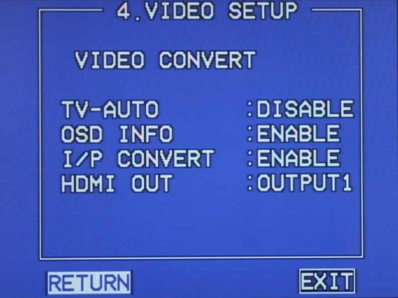

  • Only 480i/p upconversion via HDMI
  • Can use only one HDMI output at a time (not parallel)
