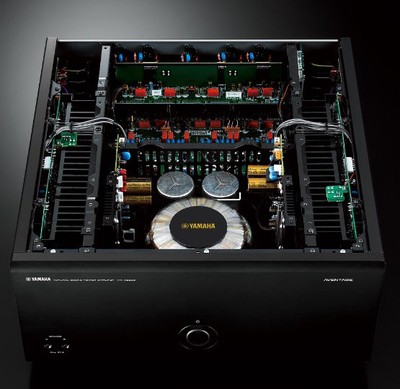

The MX-A5200 offers similarly impressive build quality with ample dual row heatsinks to keep ALL eleven 150-watt channels running cool. Like the MX-A5000, the MX-A5200 is has a symmetrical power amplifier layout, with left and right sides physically and electrically isolated to improve channel separation. The MX-A5200 features a Bridge Tied Load (BTL) option to boost output to the front-left and front-right channels to enhance fidelity and volume. The large toroidal power supply stands proud with two soda can sized power supply capacitors.
The CX-A5200 upgraded the digital section with two ESS SABRE PRO Premier DACs (ES9026 PRO), delivering 32-bit performance and balanced XLR preamp-level inputs and outputs.  Balanced XLR connections are available to connect the CX-A5200 to the MX-A5200 amplifier and source components such as high-end SACD and CD players.

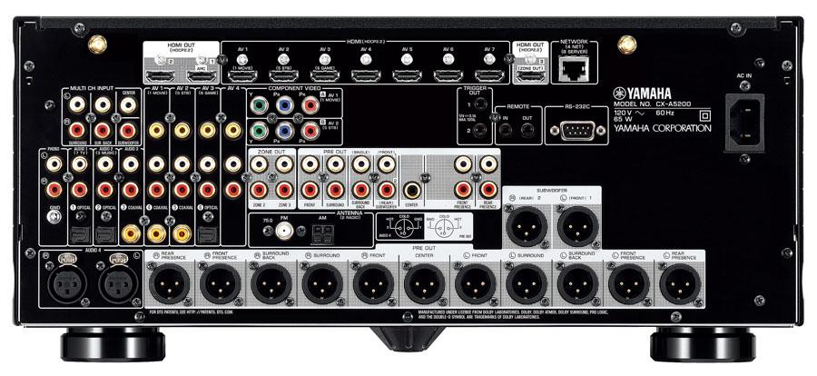

The CX-A5200 backpanel looks virtually indistinguishable from this model’s predecessor. The only major differences are the inclusion of an HDMI output for another zone yielding a total of 3 HDMI outputs and one less component video input for a total of 2 on the CX-A5200 model.

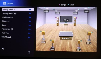

Yamaha CX-A5200 Speaker Configuration
Like previous models, the CX-A5200 allows for independent crossover settings per speaker group. Oddly if you set the main speakers to "small", the CX-A5200 still lets you configure other speakers to "large". I personally feel if the main speakers are "small" then ALL other speakers in the system should default to "small" as well. This will ensure the user didn't accidentally forget to set up the bass management correctly for the rest of their speaker assignments. Yamaha made a big deal out of me running YPAO to get the correct angle measurements essential for AI to work optimally. I honestly don't really know if it made a difference and find it peculiar that you can manually set every speaker parameter such as level, delay, bass management but you can't do that for angle. I couldn't even find where the angle settings were saved in the web editor app.
I have to give props to YPAO as it correctly identified one of my height channels as being out of phase. If I didn't run auto setup, I may have missed this wiring mistake during installation. YPAO did identify my front speakers out of phase which is common in some 3-way speaker designs that invert the polarity of a HF driver for proper summation. In this case, I ignored the warning message and proceeded.

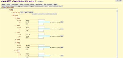

Yamaha CX-A5200 Manual PEQ (left pic: OSD, right pic: web editor)
The left pic shows a graphical representation of the manual PEQ filters I engaged for my large front speakers while the right pic shows the actual filter settings I entered into the web interface. All you need to do is enter the processor’s IP address/setup (ie. 192.168.1.64/setup) into your PC browser configured on the same network and you're good to tweak. What I really liked about this setup was that I could manually adjust filter settings on the fly each time I pulled a new measurement, all from the comforts of my office chair located in a different room from my theater. Yamaha provides 7 fully adjustable bands from -20dB to +6dB for each channel. They give you finely adjustable predetermined filter settings, but in the future I'd like to see the ability to enter any frequency of your choosing for even more flexibility.
Editorial Note about Filter Settings:
These predeterminated filter settings are actually the center frequencies of a common 31-band graphical equalizer, at 1/3 octave resolution.

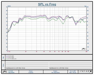

Bass Response at Listening Position
Blue: 2CH; Purple: DSU; Green: AI
As you can see in the above graph, with the Surround:AI engaged, the bass levels dropped about 6dB from the regular two-channel levels whereas with DSU engaged, the levels experienced a slight elevation in bass.
I sent this to Yamaha and they informed me that their Surround:AI system should only be engaged for discrete multi-channel audio signals, specifically for movies and sporting events, not music. Oddly if you look at the audio information displayed via the OSD once Surround:AI is engaged, it reads "Neo:6 Cinema" for two-channel sources so it's no wonder why it sounds bad for music sources.  However, when Surround:AI is engaged for multi-channel sources, it reads "Surround:AI" and even shows a graphical readout of the location the audio information is being steered around the immersive surround field. I didn't see this mentioned in Yamaha's literature about the adjustability or suitability for Surround:AI, but going forward, I reserved my listening tests with Surround:AI engaged to just multi-channel movie program material.

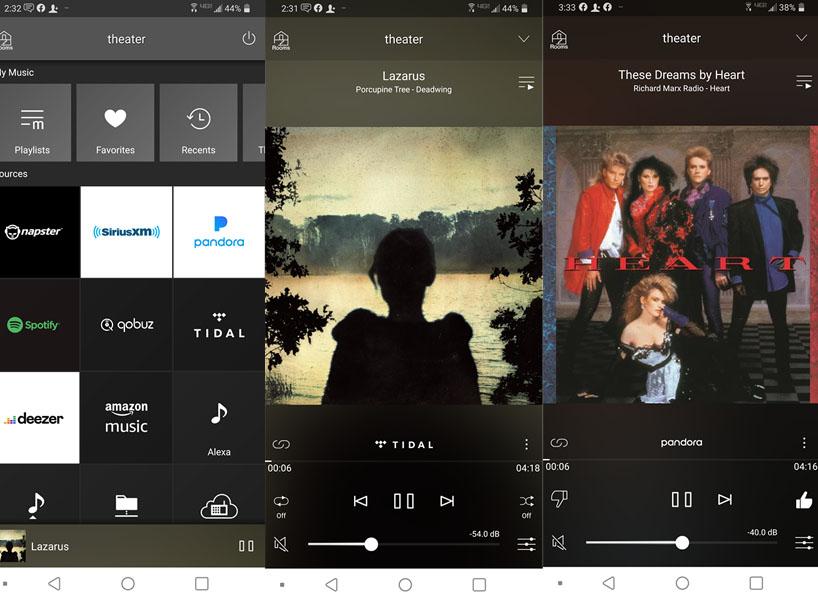

Yamaha MusicCast App
Yamaha has been incorporating a very powerful music management system into their AVENTAGE products for quite awhile now and they seem to keep refining it with each new generation. Although there is no hot key for MusicCast on the handheld remote, you can access this feature via a downloadable App for your iPhone or Android. Once set up, the CX-A5200 acts as a whole-home audio solution giving you the ability to push audio from Tidal, Qobuz, Pandora, Spotify, Amazon Music, a network drive, Bluetooth, AirPlay, etc. all from the comforts of your smart device to every zone of your home without ever having to turn on your display or projector.  Yamaha also has an IP based controller App allowing full function of the CX-A5200 from anywhere in your home as long as you're smartphone or tablet is on the same network. Amazon Alexa Skill is also compatible with voice functionality allowing you to turn the CX-A5200 on/off and some basic control for MusicCAST Skill if you're invested in that ecosystem.

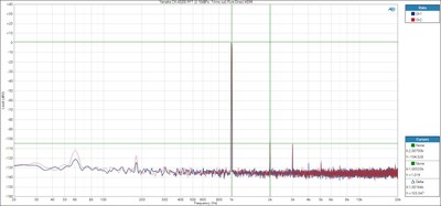

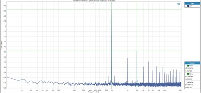

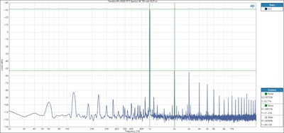

Using HDMI input, I plotted an FFT at 1Vrms via the XLR outputs and the resultant distortion was excellent with the 2nd order -105dB below the fundamental. At 4Vrms out, 3rd order rose substantially to -76dB (though still inaudible at 0.015%).
CX-A5200_FFT-HDMI.jpg\
Yamaha CX-A5200 FFT (-10dBFs HDMI in, 1Vrms out)

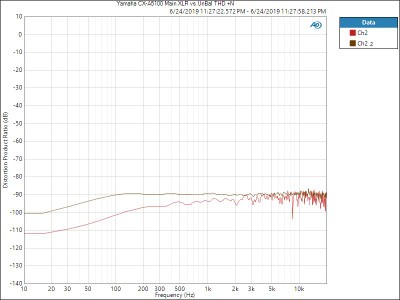

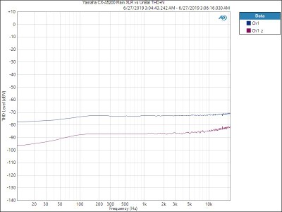

I wanted to verify if this problem plagued the CX-A5100 so I measured them side by side before swapping out my old CX-A5100 to review the CX-A5200.  I ran identical tests on the CX-A5100 and CX-A5200 to show illustrate the differences in distortion at 2.7Vrms output for XLR and Unbalanced. As a reference, 2.7Vrms is almost the full voltage required for the MX-A5200 to reach max rated power.
Yamaha CX-A5100 Main XLR vs UnBal THD +N.jpg Yamaha CX-A5200 Main XLR vs UnBal THD +N.jpg
Distortion vs Frequency Response Yamaha  CX-A5100  (left pic) ; CX-A5200 (right pic)
CX-A5100:
Brown: Unbal - 90dB @ 1kHz
Red: Bal -95dB @ 1kHz
CX-A5200:
Purple: Unbal -88dB @ 1kHz
Blue: Bal -72dB @ 1kHz
As you can see there's actually about a 23dB difference in distortion between the CX-A5100 and CX-A5200 at the same drive level and test conditions via the XLR outputs. The difference in distortion between the CX-A5100 and CX-A5200 unbalanced outputs was only 2dB in this comparison.
Yamaha confirmed my measurements and discovered the culprit to this increased distortion had something to do with how the volume control IC interacts with the XLR outputs. This is something they plan to resolve in future models but cannot make a hardware change to this current model.
While 23dB sounds like a really big number, it's important to note that the overall distortion level is still quite low for the CX-A5200 model and below the threshold of audibility in my testing. While I'm not happy about this result, as it certainly is NOT State-of-the-Art (SOTA),  it never diminished my enjoyment of this product even during my critical listening sessions. However, if you want the very best performance from the CX-A5200, I recommend using the unbalanced outputs for the front channels. This is the first time I've ever said this sentence in a product review so it's a rare recommendation given the performance characteristics I've observed with this product.

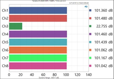

Yamaha CX-A5200 SNR (XLR outputs at 1kHz, 1Vrms)
Note: CH3 is subwoofer channel and should be ignored.
The Yamaha CX-A5200 exhibited a very low noise floor for almost every mode of operation. In Pure Direct with an HDMI input signal of -10dBFs, the measured SNR was > 101dB (a-wt) at 1Vrms output which is excellent. The analog input driven with 200mVrms produced 95dB (a-wt) at 1Vrms output. With straight mode engaged, the SNR dropped to 81dB (a-wt) indicating that the ADC in the CX-A5200 was not state of the art in performance like the DACs that were used for digital to analog conversion. In other words, if you engage the DSP for analog sources, expect to take a penalty in noise performance.

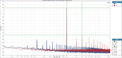

Yamaha MX-A5200 Full Power Bandwidth Continuous Sweep (250wpc, 8 ohms, Bridged)
The MX-A5200 packs quite a punch when the front L/R channels are bridged. Here you can see it hitting 250 watts/channel with both channels driven into 8 ohms, full bandwidth at < 0.1% THD+N. This far exceeds the 200watts/channel rating Yamaha gives this amplifier in bridged mode.
Yamaha MX-A5200 Full Power Bandwidth Continuous Sweep (388wpc, 4 ohms, Bridged)
The MX-A5200 almost doubled in power into 4 ohms which is impressive considering the strain a bridged amplifier must undergo as each half of the amp section sees 1/2 the load impedance (2 ohms). This is a lot of power from an 11-channel amp in bridged mode and certainly will give your main speakers good dynamic headroom when needed.

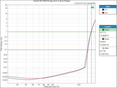

Yamaha MX-A5200 Power Sweep vs Distortion Test - 2CH, 8 ohms, Bridged
When bridged, the MX-A5200 went into beast mode, producing 250 watts/channel, two channels driven < 0.1% THD+N and 277 watts/channel at 1% THD+N. Into a 4 ohm load, the MX-A5200 produced 396 watts/channel, two channels driven < 0.1% THD+N and 444watts/channel at 1% THD+N.

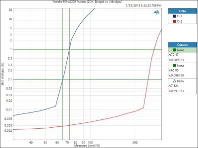

Yamaha MX-A5200 Power Sweep vs Distortion Test - Bridged vs Unbridged Channels, 8 ohms
If you're thinking you can be clever and just bridge one channel while letting the other channel run in normal mode so you can turn this 11CH amp into a 10CH amp with one high power channel, think again. I was going to do this for my center channel until I realized that Yamaha feeds both channels from the lower voltage tap on the transformer even if you only bridge one of the channels. This cuts the unbridged channel by more than half as you can see in the blue trace where the unbridged channel only produced 65 watts at 0.1% THD+N and 72 watts at 1% THD+N.
Note: If you're going to use the bridged feature of this amplifier, use it for BOTH channels.

The MX-A5200 was a bit bipolar in how it measured during my FFT distortion tests. I literally got a different reading each time I took it sometimes varying by as much as 10dB for the 3rd order harmonics during the bridged mode tests. I believe this was possibly due to a current biasing monitoring circuit that drifted slightly with temperature or loading conditions.
Yamaha MX-A5200 FFT Distortion Analysis (1 watt, unbridged-blue vs bridged-red XLR)
There is a bit of excessive power supply hum at 120Hz on the MX-A5200 (a few dB worse than I measured on the MX-A5000). This wasn't too concerning as I never once heard an audible hum even with my ear close to the speaker.
In bridged mode, the 2nd order harmonic rose 5dB and the 3rd order almost 15dB in bridged mode compared to unbridged. This was surprising to see as running an amp in a BTL usually reduces distortion products. We did see residual harmonics cancel out in bridged mode, however.
Yamaha MX-A5200 FFT Distortion Analysis (150 watts, unbridged)
The MX-A5200 produced similar FFT results at full power, unbridged, that I measured from the MX-A5000 previously.
Yamaha MX-A5200 FFT Distortion Analysis (200 watts, bridged)
In bridged mode, we again see the odd-order harmonics rise slightly, but 2nd order dropped almost 10dB. This is a very good result and demonstrates the amp’s good behavior when driven hard.
Yamaha MX-A5200 Distortion vs Frequency at 255 watts (2CH, 8 ohms, bridged)
To demonstrate how well behaved this amplifier is at high power, I swept two channels driven in bridged mode at 255 watts, 8 ohms and the distortion remained below 0.05% out to 20kHz. This is impressive considering this amplifier was only rated to deliver 200 watts/channel in bridged mode which this test exceeded comfortably by 55 watts/channel.

The distortion problem I discovered for the front main XLR outputs of the CX-A5200, although inaudible in my testing, is something Yamaha must fix in this model’s successor. I want to reiterate that this distortion problem didn't deter my enjoyment of the product or lower the overall subjective scoring I assigned it.

MX-A5200 Inside
Yamaha MX-A5200 Inside View -beautiful layout of dual heatsinks and large central power supply
For the MX-A5200, I think Yamaha missed an opportunity to really step up their game with this amplifier or its predecessor. Since they are getting into bridgeable amplification, they should look into increasing the unit’s power supply capability to realize its full potential. I'd like to see the next generation model offer the ability to bridge all of the channels instead of just the main L/R channels. In addition, unbridged channels should stay on the high voltage rails to not sacrifice power like the MX-A5200 does IF you don't bridge both L/R channels. With Monoprice and Emotiva being the only affordable alternatives for 11-channel amplifiers, Yamaha has a real opportunity here to bring unique differentiating features to their product that adds to their appeal of high reliability.
