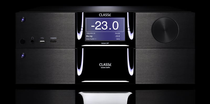

Classé Sigma SSP
  • USB audio up to 24-bit/192 kHz
  • USB (Host) charging capability 2 Amps
  • AirPlay supported formats
    • AAC (8 to 320 kbps)
    • Protected AAC (from iTunes Store),
    • HE-AAC, MP3 (8 to 320 kbps),
    • MP3 VBR, Audible (formats 2, 3, 4)
    • Audible Enhanced Audio (AAX, and AAX+),
    • Apple Lossless, AIFF, and WAV
  • DLNA supported formats
    • Apple Lossless (ALAC), mp3, FLAC,
    • WAV, Ogg Vorbis, WMA, AAC
  • Frequency response  8 Hz - 200 kHz < 1 dB, stereo digital bypass  8 Hz - 20 kHz < 0.5 dB, all other sources
  • Channel Matching  (Left to Right) better than 0.05 dB Distortion (THD+noise) 0.0005%, digital source/bypassed analog source  .002%, processed analog source
  • Maximum input level (single-ended) 2 Vrms (DSP), 4.5Vrms (bypass)
  • Maximum input level (balanced) 4 Vrms (DSP), 9 Vrms (bypass)
  • Maximum output level (single-ended) 9 Vrms Maximum output level (balanced) 18 Vrms Gain Range  -93 dB to +14 dB
  • Input impedance (single-ended) 100 kΩ (single-ended)
  • Input impedance (balanced) 50 kΩ (Balanced)
  • Output impedance (single-ended) 100 Ω
  • Output impedance (balanced) 300 Ω
  • Signal-to-noise ratio (ref. 4Vrms input, unweighted) 104 dB, bypassed analog source 101 dB, processed analog source (re. full-scale input, unweighted) 105 dB, digital source
  • Channel separation better than 100 dB
  • Channel matching (left to right) >0.05 dB
  • Crosstalk (any input to any output) better than -130 dB @ 1 kHz
  • Rated power consumption 35 W
  • Mains voltage 100-240 V, 50/60 Hz
  • Overall dimensions: 17.0” (433mm)  Depth (excluding connectors): 14.57” (370mm)  Height: 3.75” (95mm)
  • Net weight:18 lb (8.21 kg)
  • Shipping weight 25 lb (11.34 kg)

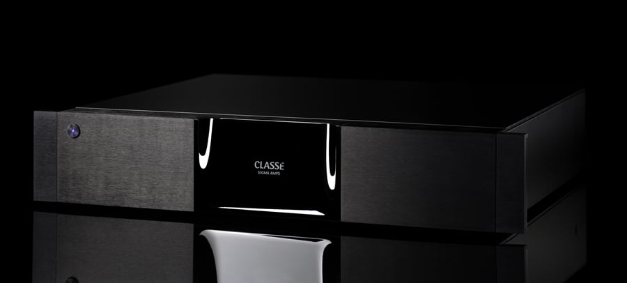

Classé Sigma AMP5 Five-Channel Amplifier
All tests un-weighted and 20Hz – 20kHz measurement bandwidth used.
  • Frequency response 10Hz – 20kHz, -1dB into 4Ω
  • Output power 200W rms into 8Ω All channels driven; 400W rms into 4Ω Any two channels driven*
  • Harmonic Distortion 0.018% @ 1kHz All channels driven to 1/8th power into 8Ω
  • Peak Output Voltage 113V peak to peak, 40V RMS no load; 113V peak to peak, 40V RMS into 8Ω
  • Input Impedance 100kΩ Balanced / 50kΩ SE
  • Voltage gain 29 dB
  • Input level at clipping 1.4Vrms Balanced/SE
  • Intermodulation Distortion >80 dB below fundamental into 8Ω SE
  • Signal to Noise Ratio -100 dB at peak output into 8Ω (AES17)
  • Rated power consumption 200W @ 1/8th power into 8Ω
  • Mains voltage 100V - 240V, 50/60Hz
  • Overall Dimensions Width: 17.00” (433mm)
  • Depth (excluding connectors): 14.57” (370mm)
  • Height: 3.75” (95mm)
  • Net weight 23.1 lb (10.48 kg)
  • Shipping weight 30.0 lb (13.61 kg)
*Each channel in the AMP5 supports 400W output into 4 ohms but the AC Mains/power  supply cannot support all channels driven simultaneously at this level, which would require over 2,500W and only occur under a special test condition. According to Classé, every channel easily drives lower impedance loads.

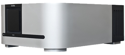

Classe-5300-amplifier
The smooth, sleek curves of the Classé 5300 Five Channel Amplifier

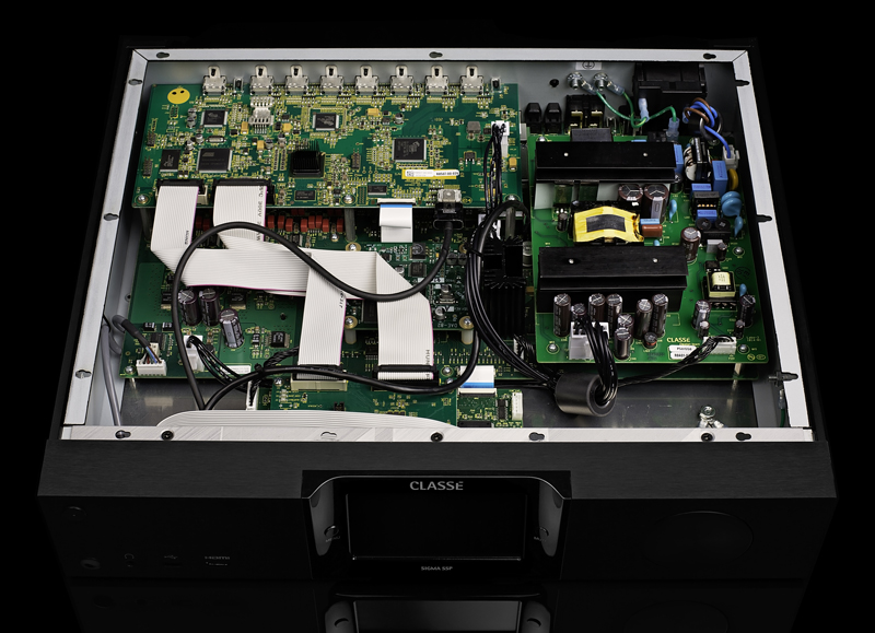

 I talked with Dave about the pedigree and circuitry of the Sigma SSP processor.  “The Sigma SSP shares common circuit blocks and critical parts with our more expensive Delta series CP-800 Stereo Preamp/Processor,” he said. “The digital circuits for USB, Network, Coax and Optical signal paths are literally cut and pasted from the CP-800. We use the same DACs for Left and Right channels as the CP-800, but there is one stereo DAC per channel (differential) rather than two (dual differential), so the circuitry is not as complex or costly. As an analog preamp, the Sigma SSP is extremely quiet and sounds beautiful. It also supports the same optional phono module as the CP-800. For anyone who wants a serious high-end stereo preamp that can integrate with AV sources and even provide multichannel processing, the Sigma SSP is a powerhouse.”

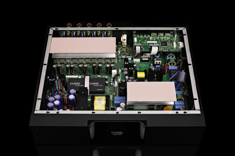

Classe Sigma SSP Cover Off
Top view of the Classé Sigma SSP's internal Circuitry

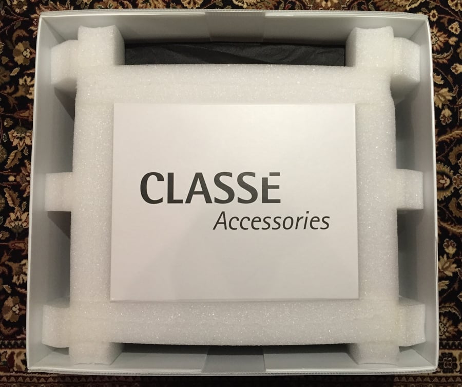

Unboxing equipment becomes a tedious rote for reviewers that it is senseless to write about.  So when something as pedestrian as unboxing equipment catches your eye, you know someone’s paid attention to detail.
Few companies understand how important it is to create a premium experience for their customers.  The box is part of the product experience. Apple is a well-known a master of this craft.  Not only does Apple meticulously design their products, but they also focus intently upon the packaging—from outer design and feel to each step you take to lift the product out of the box.
Unboxing the Classé review units told me that Classé's industrial designers paid attention to some of those same details.  The two boxes housing the Sigma SSP and AMP5 were identical in size.  The outer boxing reflected Classé’s nod to modern style and clean lines.  It was smooth and white with minimalistic detailing.  It eschewed the typical cardboard construction and feel you get with most AV products.  It felt higher quality.  Opening the box revealed a white, similarly branded “Accessories” box.
Sigma Box

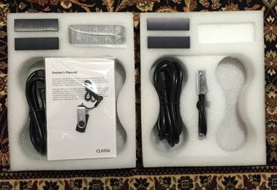

Included in the neatly laid out accessories box was as set of brushed aluminum magnetic caps for rack mounting (more on that below) and a Classé-branded black and silver USB stick that contains the user manuals for every Classé product.
There’s no paper manual included at all, which may not sit well with everyone.  The USB stick also doubles to provide firmware updates for the processor that are done via USB. Underneath, the Sigma SSP Processor and AMP5 were covered in a Classé branded black cloth.
Accessories box details
Included accessories of the Sigma SSP and Sigma AMP5

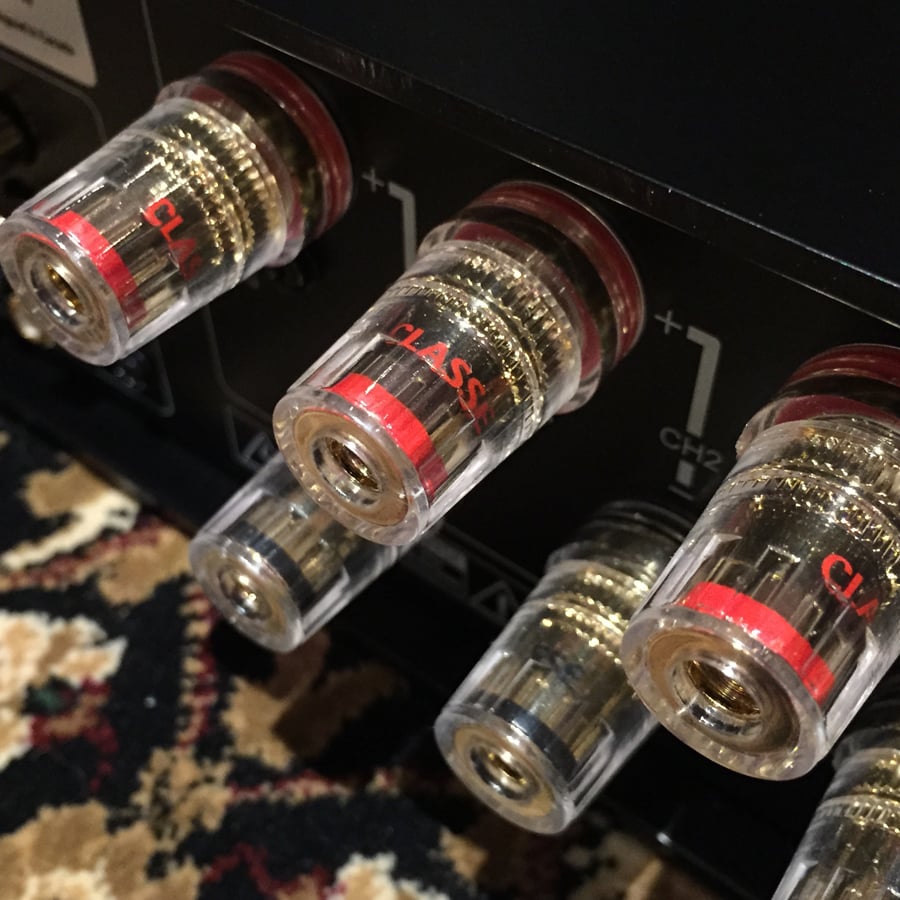

binding posts
The five way binding posts on the Sigma AMP5 are branded with the Classé logo showing meticulous attention to industrial design and branding throughout

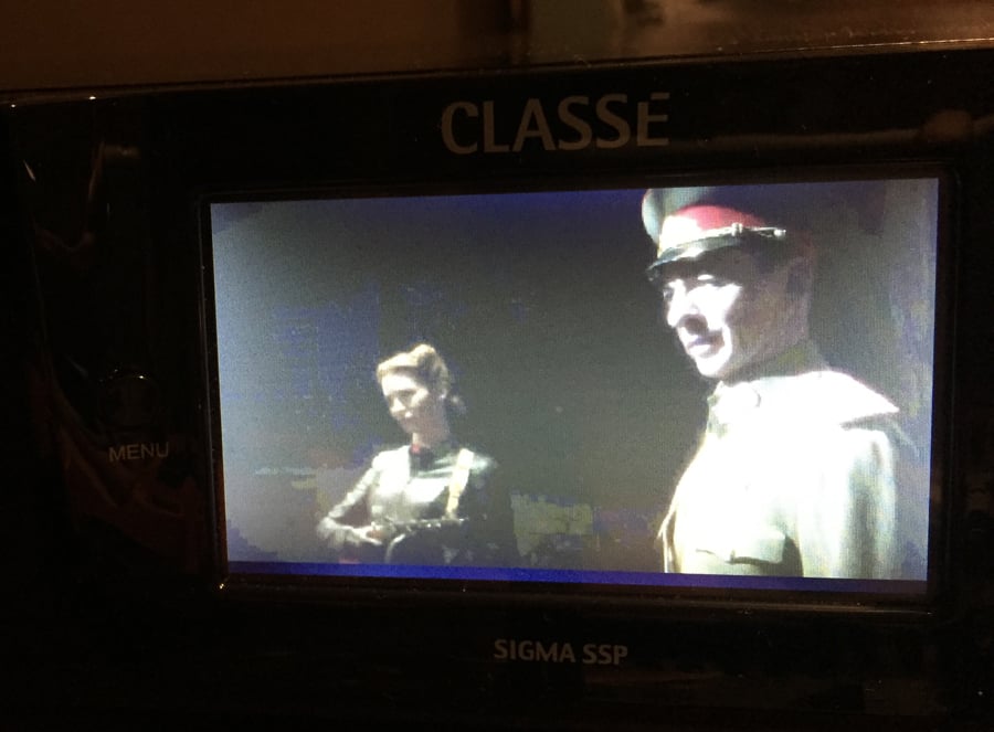

Real Time Video Preview
The TFT Display can show you a real-time video preview of your source
With a simple menu click, you can even use the TFT display to give you a real-time video preview of your selected input source.  If you are having HDMI problems you can see if the signal is arriving properly to the processor or if you have the Sigma SSP in a different room, you can monitor the input signal right on the unit for simple debugging.  Perhaps best of all, because it’s a software-driven display, Classé can update the menu offerings and features anytime with a simple firmware update.

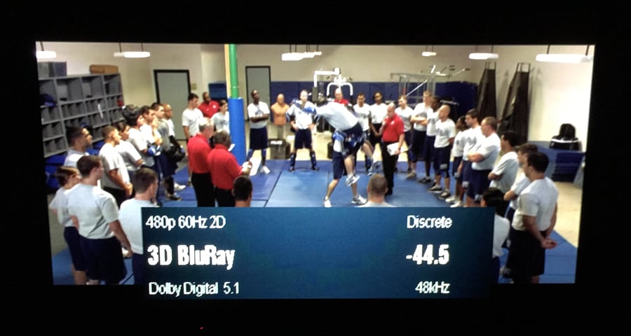

Sigma SSP On Screen Display
The Classé Sigma SSP's OSD is elegant.  It shows you the input source, incoming audio channels and sampling rate, volume, and video signal.   The OSD t takes up quite a bit of screen real estate, especially on older 480p sources.
In this way, even when an OSD message appears, the rest of the screen remains unaffected. While Classé’s OSD messages are rendered nicely on screen, they are quite large and can also become visually obtrusive.  The great news is that you can defeat the OSD in the display setup menu.

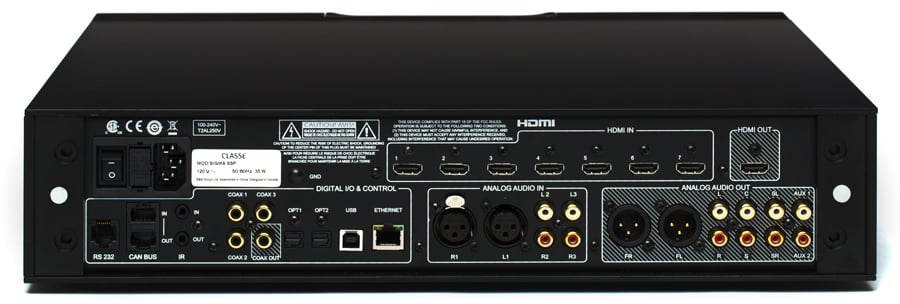

Even though Classé extolls the virtues of balanced connections in the manual, they are limited to the front left and right channels on the processor and channels 1 and 2 on the AMP5. The remaining connections are unbalanced. The decision to omit balanced circuits was largely due to budget and the physical restrictions of the Chassis.
I was curious about the overall circuit design of the units. When Dave and I got a bit more in-depth about the circuitry of the Sigma series he told me that the XLR connections of the units are fully balanced.  He went on to say, “In general for Classé products, we would never use XLR connectors without accompanying balanced circuitry.  For the SSP, you do accurately describe the differential output of the DACs and we maintain that in the analog path, volume control, etc. as well. For the AMP5, the amplifier circuitry is balanced for all channels through to the speaker terminals so even single-ended inputs are converted to balanced immediately on entering the chassis.”
The Sigma series embraces digital content delivery, but it does so only via Ethernet. There is no WiFi option available.  Wired connections are much more reliable with less latency.
A potentially major compromise with the Sigma SSP is deciding how to handle your setup.  The sixth and seventh speaker outputs are called AUX 1 and AUX 2.  You can use them in only one of the following configurations: as the rear channels in a 7.1 surround system; as front height channels; as a second parallel audio zone; or as a mirror of the front L and R speakers in a bi-amp arrangement.
Sigma SSP Rear Inputs
The rear view of the Sigma SSP with balanced L and R channels and assignable AUX 1 and AUX 2 outputs.  Additional USB and HDMI input ports are located on the front.

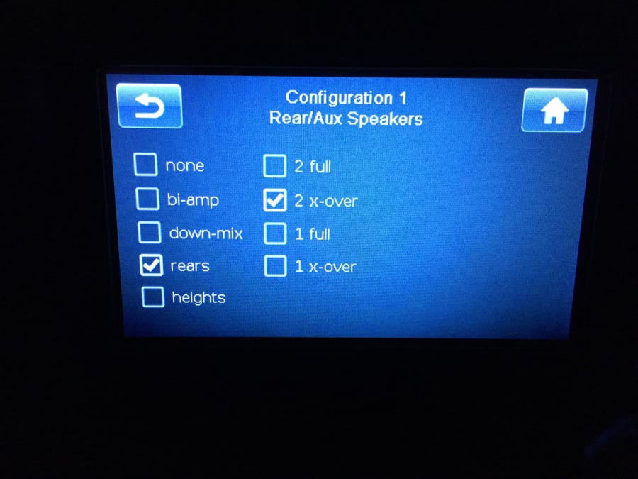

From the OSD, you can assign how the AUX output will function.  You can have the AUX speakers function differently for different configurations.

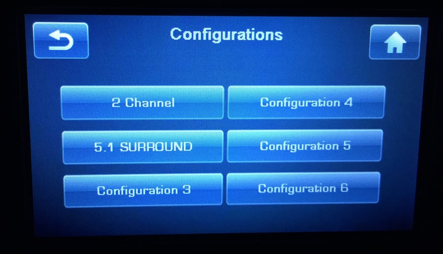

Input Configurations
You can easily create different configurations.  Each input is independently assignable.

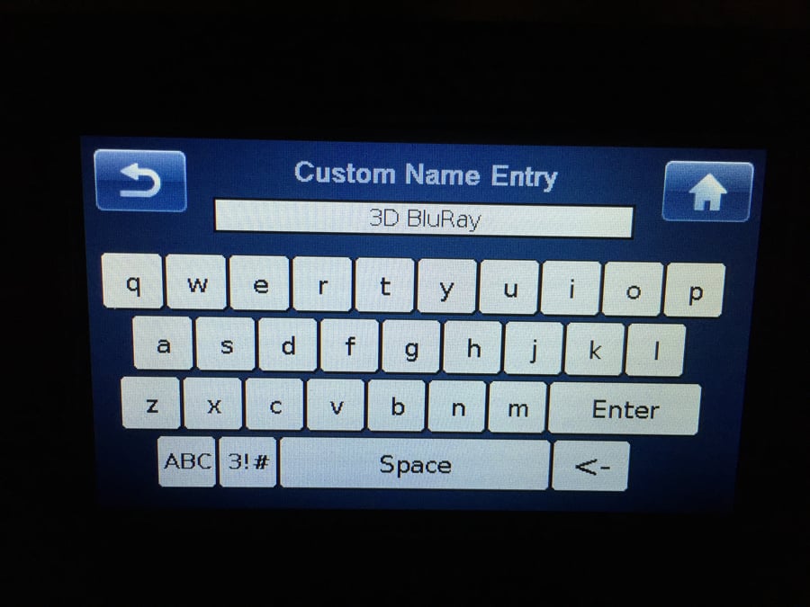

Via the OSD, you can custom name any input.  All custom names are reflected in the units's TFT display, the OSD, and the iOS app.
Remember, the Sigma SSP is incredibly flexible: all inputs can be custom named; inputs can be assigned on the fly; preferred sound modes can be set on a source by source basis; and settings can be fine-tuned to suit your specific taste.  Should you accidentally mess up your installation, dealers have the ability to archive/backup settings on the unit and then restore them at a later time.

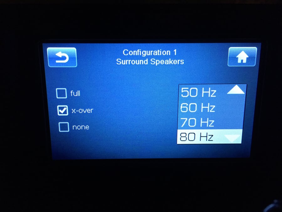

Crossover Frequency
The Classé SSP gives you flexibility on how to handle your crossover on each speaker.  You can even assign different crossovers for each speaker for each configuration.  You have complete flexibility.
Something as simple as switching sources or audio modes showed Classé’s rabid attention to detail.  Unlike just about every other vendor who gives you a blunt, hard cutover, Classé will fade the audio out and back in so that you do not experience any loud pops or other audio problems that I’ve experienced with other receivers or pre-pros costing thousands.  Who needs a butler when you have the Classé Sigma series?  Using the Sigma SSP and AMP5 was like being pampered with white-glove attention to detail at every turn.

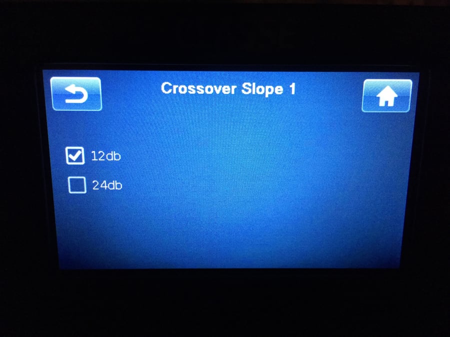

Crossover Slope
You can set manually set the crossover slope at either 12db or 24db to suite your taste and your environment.

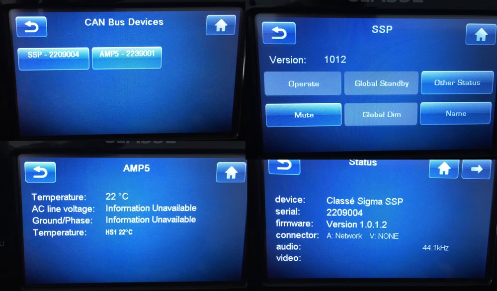

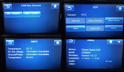

I loved the system’s CAN-bus (Controller Area Network) that allows multiple Classé components to talk to each other.  Connecting the CAN-bus controller with a standard Ethernet cable and the included RJ45-style terminator enabled the processor to give me real time status of the AMP5 and control it fully.  If I had multiple amplifiers or other components, I would have been able to select them from the SSP’s TFT screen and optionally control each one.
CAN-Bus
Via the Sigma SSP's CAN-bus controller, you can get detailed information on any Sigma-series component in your chain. For example,  I was able to get detailed information about the Sigma SSP and the operating temperature of the AMP5

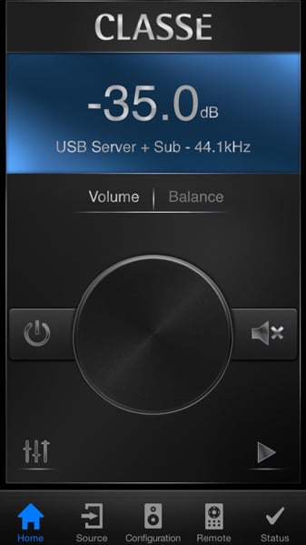

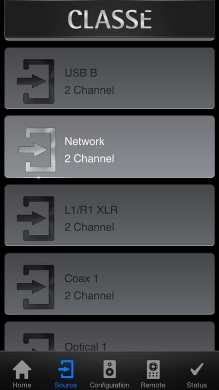

Whatever you do on the unit is available in real-time on the available iOS app. I found the app to be a sleek, streamlined option for users who want basic remote functionality and will not be using home automation solutions like Crestron on Control4 with their installation.  I was disappointed that I could not natively integrate the Sigma SSP with my Roomie Remote installation to test advanced automation.  For advanced functionality, an RS-232 interface via an RJ45 connection is available on the rear of the unit.  You cannot configure or automate the Sigma SSP from the iOS app.
iOS App
The Classé iOS app allow you to control all basic functions of the Sigma SSP.
