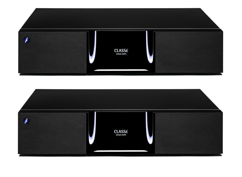

Beauty shots of the Sigma AMP 2 and AMP 5.

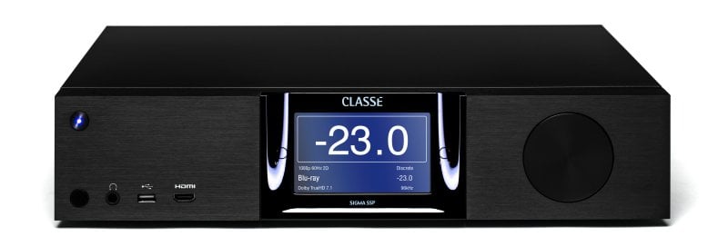

Beauty Shot of the Sigma SSP.
We make expensive products with long lifecycles, so we look closely at these things and move carefully. Once the hardware and software are mature enough to give a few years of stability and we have real native 4K sources to switch, we will offer an upgrade. Our SSP-800 was the first high-end SSP with HDMI 1.4 and we offered customers with original HDMI 1.3 version units an upgrade path, so I’d say we have some credibility on the subject. You don’t want to buy an HDMI 2.0 equipped unit today only to find that it won’t work once you really get some native 4K sources to switch. And be forewarned that that is guaranteed to happen.

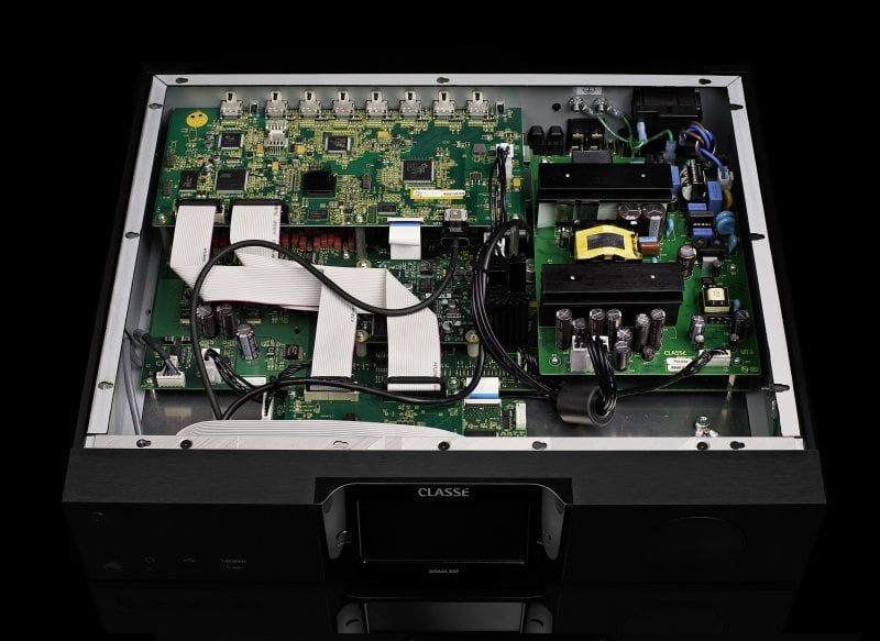

Audioholics: Will the Sigma SSP be upgradable to support new audio formats like Dolby Atmos, Auro-3D or DTS-UHD?
Classe: The Sigma SSP uses a Texas Instruments-based DSP that is contained on its own separate pc board along with other associated parts. This module may be replaced with a newer TI DSP with one or more 3D audio decoding features whenever it makes sense to do that. Customers will then have the option to upgrade if they feel they need to. We upgraded the SSP-800 from a single DSP to a dual DSP to accommodate HD Audio, so as with HDMI, we also have credibility offering upgradable DSPs.
It’s debatable how popular 3D audio will be among the target customers for the Sigma SSP, especially considering its 7.1 channel limitation. For dedicated theater rooms where a customer has four or five times the budget, it makes sense to pursue 3D audio. Why not? But similar to the 4K video situation, what you buy today isn’t likely going to be what you will want in a year or two anyway, so having patience and an upgrade path is a better long-term purchasing strategy and that’s what the Sigma SSP offers.

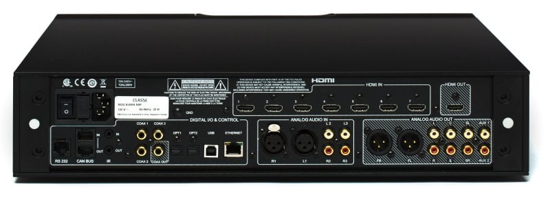

Audioholics: Can you please explain the design decisions behind omitting legacy video inputs in the Sigma SSP? Is any video scaling available for standard definition sources?
Classe: The Sigma SSP is differentiated as much by the connectors it doesn’t have as by those it does. The fact that it has an Ethernet port for streaming audio and IP control as well as USB host and device connectors but supports no analog video tells you that this is a forward-looking component. It will have the right connectors for your system for the sources and displays you’ll buy now and five years from now.
Analog video carries with it a high cost, both for the circuitry if it’s of good quality and the back panel real estate its connectors consume. The Sigma SSP achieves its high performance/price ratio by ruthlessly eliminating extras in order to fit the essentials into a slim, high-performance package. If someone really needs analog video, then the Sigma SSP is not for them, but I’d question why someone would be playing at this level with analog video sources or displays anyway. There are ways to accommodate it if you have a real need for analog video so for the few who do there are options.
We do not include any video scaling capabilities for several reasons. First, there are very few sources today that are standard definition, so it’s of limited utility. For those few SD sources that do exist, the display can and should provide the scaling. No sense adding yet another scaler to the system. The SSP is an audio product and video is handled as efficiently and sparingly as possible. In general, and this applies especially to Blu-ray players with 4K scalers inside, you should let the display handle the scaling. To create all that extra data and burden the transmission system with it makes no sense at all, especially when the people who designed the display (assuming it’s a good one of course) ought to know best how to scale images to suit it.

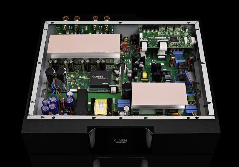

Audioholics: Why did Classe opt to go with a Class D amplifier topology with the Sigma series? Can you also explain the decision to utilize an SMPS power supply? Can you discuss the pros and cons of this approach versus a conventional Class A/B design with a linear power supply?
Classe: The Sigma AMP2 and AMP5 designs are based on the Delta series CA-D200 class D amplifier introduced earlier this year, so what I will say about these Sigma series amplifiers applies the to CA-D200 as well.
The short answer is that we felt that our own class D amplifier solution with Switch Mode Power Supply could offer the best performance including sufficient power for the intended application in this price range.
Top view of the Sigma AMP 2 with the cover removed.
Design is a process of choosing the best tradeoffs given the overall goals, so the choices you make at one price are often different than the choices you’d make at another price. For example, you can build class D amplifiers with power ratings of 100W or more at very low prices as evidenced by the choices made by designers of mainstream AVRs. Once you get above the lowest entry level price points though, linear amplifiers tend to have fewer sonic compromises. They are physically larger and less efficient than their class D counterparts however, so if factors other than price and power are important, class D may still win out. As you go higher in price it becomes possible to implement class D designs that address the sonic shortcomings of the less expensive class D implementations and at this level a real competition exists with the sonic merits of good linear amps.
The Classé design uses proprietary circuitry and DSP to effectively eliminate dead-band-time, which is the Achilles Heel of class D amplifiers. This is the time when both halves of the amplifier are off; it is similar to switching distortion in a linear class AB amplifier but more insidious. Even small amounts of dead-band-time results in high distortion, which leads to other design choices to try to control the distortion, which in turn begins a downward spiral of performance. By addressing dead-band-time up front we can have low open-loop distortion and apply only a modest level of negative feedback to optimize performance.
The SMPS with Power Factor Correction allows us to provide rock-steady supply voltage to the amplifier circuit and over 1,000W of power in an efficient and relatively small package. To achieve anything like this from a linear supply would cost far more, be quite a bit larger and not as efficient. The SMPS with PFC also has the advantage of pulling power from the wall more smoothly than linear supplies, meaning that any audio components sharing the same AC Mains circuit won’t even know it’s there. In other words, it helps the other components sound their best by not causing the AC to sag with demand and by avoiding high frequency harmonics that a linear supply would generate, polluting the line.
Our class D amplifier solution with SMPS and PFC give the best overall performance and power at this price while bringing other class D benefits such as small size, low heat and efficiency to the table. If you have double the budget or more, then we would see sonic advantages of linear amplifiers emerging to edge out the class D design, but even there it’s not an easy, obvious choice.
