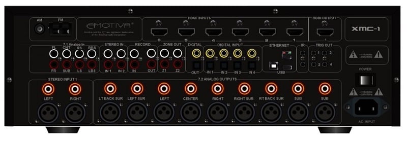

The new Emotiva XMC-1 is, according to the company, the "first product in a new generation of high performance digital audio products". Emotiva has been promising a new processor for years, and this is their fulfillment of that promise. Given the long development time, there is always the danger that it will hit the ground behind the curve. First, we'll look at the back.
emo_xmc-1_back
Emotiva XMC-1 Backpanel View
The XMC-1 sports seven HDMI 1.4 inputs (one front mounted) and one output. There are four pairs of digital audio inputs (coax and optical) and one pair of outputs. For those with legacy gear, the XMC-1 has 7.1 channel analogue outputs, each with a balanced XLR option. There is a bit of confusion on our part about the number of analogue inputs. Emotiva lists four RCA style. We see two that are labeled "Stereo Input 1", one of which shares a pair of XLR inputs. There is also an RCA Stereo 2 and Record in and out. We think that the two Stereo 1 RCA inputs are being treated separately on the spec sheet even though they share a label (the picture is obviously a rendering and not an actual photo, so labels may change). We doubt that you can use both the RCA and XLR inputs labeled Stereo 1 simultaneously. Then they are counting the 7.1 channel inputs as the fourth input. The way we see it, it has 7.1 analogue, and three stereo inputs, one of which you can use as either RCA or XLR.
The only really glaring omission from the back of the Emotiva XMC-1 are analogue video inputs. Nowhere will you see component, S-video, or composite video inputs. So, basically, all you early XBox 360 buyers (who haven't been red-ringed into a newer unit) and Wii owners will have to connect your video directly to your display. Not a deal-breaker, but certainly an interesting omission and one that may make some consumers think twice about the XMC-1... or this might be the new trend, who knows.
There are a number of other inputs and outputs, including four trigger outputs, two IR connections, Ethernet, and three different USB ports. There are two USB-A (the thin ones you are used to using), one front and one on the back. These can be used to update firmware or playback FLAC/AAC/WAV/MP3 files. There is also a USB-B port on the back (the square one) dedicated for high bit rate lossless streaming audio using the C-Media 6631 chipset. We can't find anything in the Emotiva product list that support such an input so we're guessing that'll be included in upcoming releases.
The Ethernet port can be used for firmware updates, streaming audio, and connection up to your computer for control. Control4, URC, Crestron and others will be happy to learn that the Ethernet can be used for drivers for their preferred control solution. The TACT room correction system (more on that below) uses the Ethernet port for their GUI interface.
For outputs, the XMC-1's HDMI supports both CEC and ARC. It is both 3D and 4K compatible. OSD overlays and setup menus are available without having to black out the image. There are 7.2 outputs in both RCA and XLR flavors. As mentioned above, there are digital audio outputs (both types) and a record output (RCA). For those with additional zones of audio, the XMC-1 has stereo RCA outputs for two additional zones. The Zone 2 (and stereo record outputs) have separate lossless analogue volume control. Zone 3, since it isn't specified, is probably without volume control.
